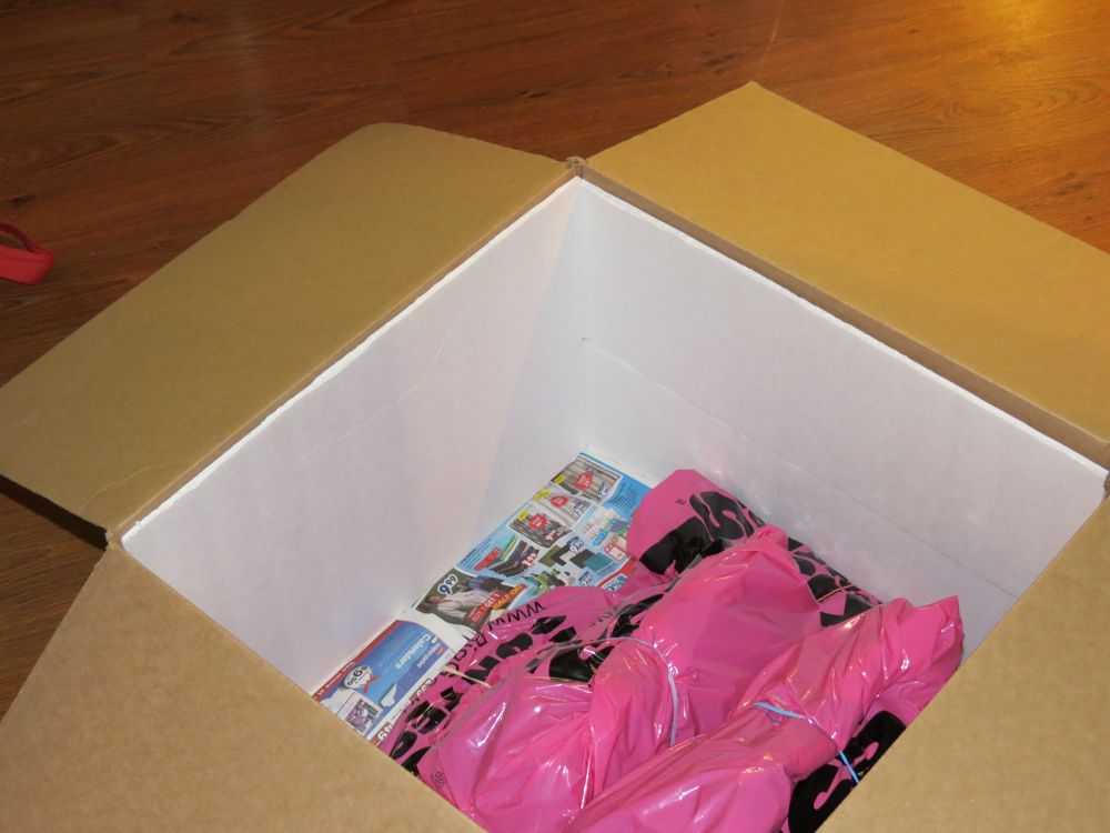

Your plan for a 4" driver in a 24" cornu is probably dependent on the size of the magnet. Maybe pulling back that first throat divider might not cause a major problem with the internal dynamics.
Thanks for the photo Bob. It does look like if I just reduce the length of that initial throat section it will buy me a little bit of space. The magnet is smaller than the cutout, but not by much. Again, this would be going off-design, but then 24 inches is already off the original design.
