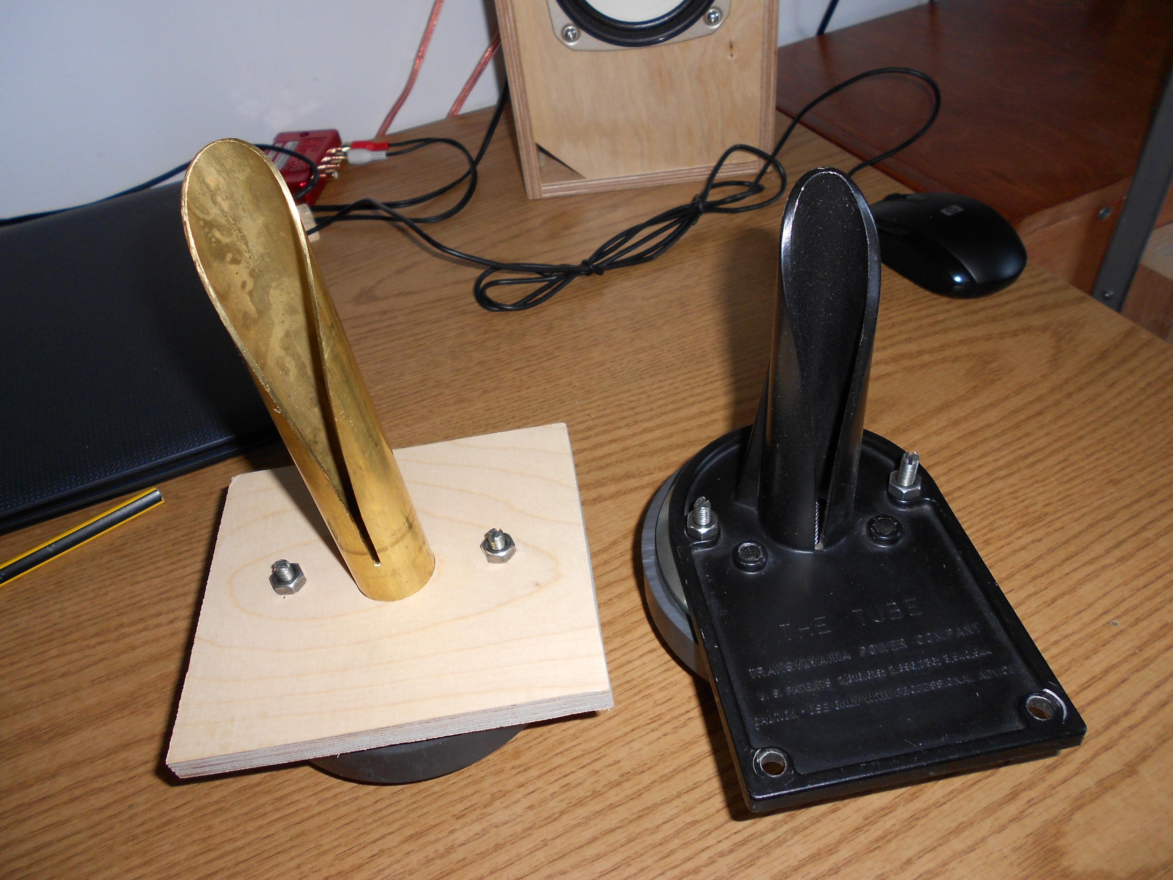

The Karlson aperture is generally used to gradually terminate a pipe, in order to avoid reflections. It works quite well, especially if you look at the impedance plot of the Transylvania Power Company "The Tube" HF waveguide, there are your two main peaks and almost no signs of reflections.

Seems to me like most of the K-slots pictured on the various iBIBk builds were small enough that a straight cut would have about the same effect. Too really do its thing, the K-slot has to be significantly large compared to the pipe it's trying to de-Q. Here is the K-slot in its purest form:
Transylvania Power Company "The Tube" and a similar-sized brass tube I made.
Yes, I believe they were largely for aesthetics rather than any supposed acoustical benefits. Might help a little.

The Transylvania Pipe would be an easy build in PVC pipe. Does it sound good and what kind of tweeter do you couple it to? A dome type or is that a compression driver underneath? Doesn't it have a strange spatial output profile? Looks very interesting though.
The K-Tube is a real good and natural-sounding waveguide IMO. Karlson-evangelist Freddy has been recommending them for years, stressing how easy it is to replicate it with schedule 40 PVC, yet very few people seem to have actually tried it. In the spirit of this thread, easy enclosure replication with foam-core, I'll also recommend an easy K-Tube replication with PVC. It's as easy as printing out and cutting a half-ellipse pattern to wrap round your tube and mark where to cut. The TPC tube is 5.3" long, 1" I.D. It really needs a compression driver IMO, but might work with a dome tweeter of the same diameter, I have not tried though. The radiation pattern is indeed asymmetric, with a wide dispersion. Listening angle is usually ~30° "down the slot side". It's probably what matches a Karlson bass/mid enclosure best and should work well with direct radiators or other midbass/midrange horns too.
