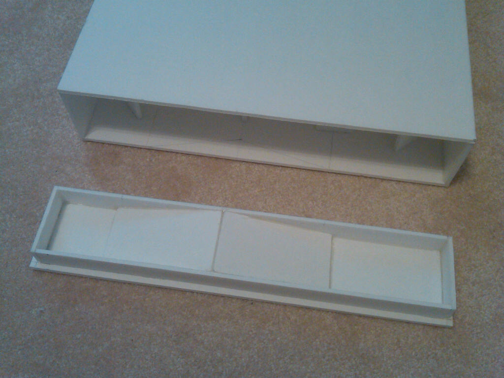

On my second FIB build I found that the "Contact Paper" (used to line drawers) works as an excellent temporary seal tape for foam core boards. It provides an airtight seal to adjust stuffing while being easy to peel off without damaging the facer paper of the foam core boards.

Below is a picture of the bottom cap on the FIB that I ended up taping with the Contact Paper.
The camping mattress may also be useful for a sound absorber/damping material for lining the wall directly behind driver?

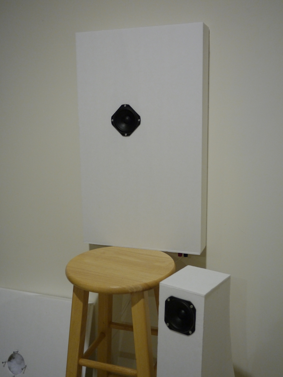

Completed Flatter is Better (FIB)
Here is a photo of my completed FIB next to the FH3-inspired speaker so you can get a sense of scale. It is 27 in tall x 16 in wide x 3 in deep and is a good size for wall mounting or covering with a painting or poster. I need to start decorating my speakers one of these days instead of leaving them in their all white glory. If you are interested in the FIB, the discussion is in the Terry Cain BIB thread. These sound very nice and they can get quite loud for how small the driver is. If you are looking for another wall mount speaker, this is an option.
Looks good! Bye-bye baffle-step!

Yes, one of my favorite reasons for wall mount speakers is no need for baffle step comp.

I might take a razor to the side of the FIB and cut a Karlson aperture in it. Start small and cut more as needed. Good test bed for experiments like this.
Looking forward to seeing your creation, and I am sure it's not a monstrosity.
