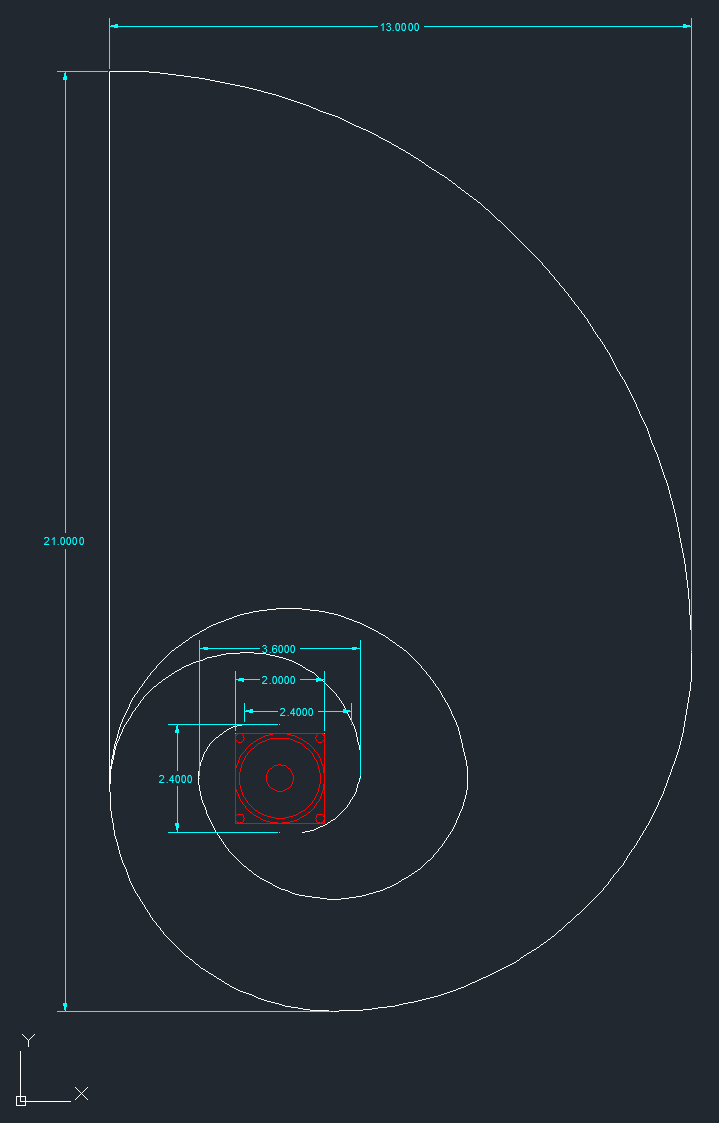

Ah realised I've been doing the calculations wrong.
The throat is the opening where the compression chamber connects to the horn right?
If that's the case, the formula would be:
fh = (c * S_throat) / (2 * pi * Vol_CC)
fh = (342m/s * 0.0035m^2) / (2 * 3.142 * 0.00154m^3)
fh = 123Hz
I guess it's time for me to sleep, made a mistake in the previous calculation, resultant fh should be 1233Hz.
How bout this for a change?
Tapering the end to close, and making the horn port(mouth?) wider.
Based on the dimensions of 21" x 13" x 3"(deep)
fh = (342m/s * 0.00464m^2) / (2 * 3.142 * 0.00034^3) = 743Hz
hmmm, doesn't seem to work, any suggestions?
Argh... hate the calculations. Guess I will just make a prototype and listen from there.

Ravener,
According to your drawing in post 1162, the compression chamber would be approximated by a circular chamber of 3.6 in in diam by 3 in deep = 0.50 liters. The throat area I am guessing is about 1.75 in across x 3 in deep = 34 cm^2. (You have a throat that goes to nowhere, which I mistakenly thought led to an output).
So fh = (342 m/s * 0.0034 m^2)/(6.284 * 0.0005 m^3) = 370 Hz.
370 Hz is a little on the high side and it means that lots of mid-range will come out of horns and cause phase delay problems with your ears and ruin spatial imaging. You can fix this by expanding the driver chamber volume by adding a sub chamber beneath the main horn connected with a hole, or add raised (hollow) suprabaffle above where you mount driver to boost volume. Alternatively, the easiest fix is to simply clamp down on the throat area by a factor of 0.75x - put a constrictor plate there (1.3 in wide gap). The horn expansion you have is good - it will result in quite a bit of gain in the bass notes. The mouth area/throat area looks approximately 10:1 - so not bad.

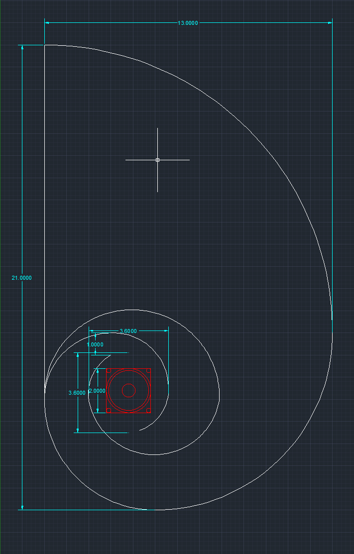

Tweaked the design a little, made the compression chamber rounder and the throat tighter.
fh = (342 x 0.00194m^2) / (2 * 3.142 * 0.00050m^3) = 210Hz
Seems rather reasonable...
Shall be starting work using this.
edit: upon looking at tractrix horns... mine seemed like an asymmetric curved tractrix...
