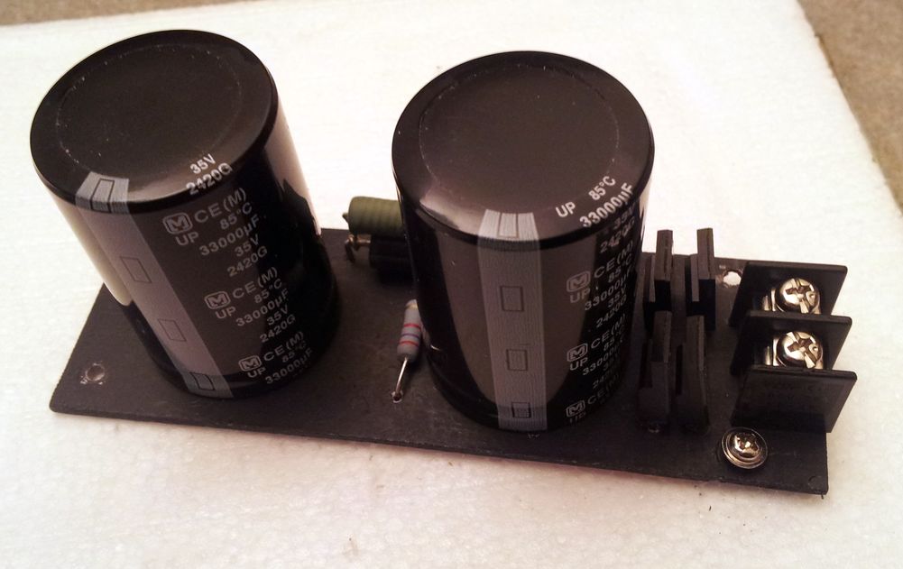

Update on Foam Core Amp -sound clips
I have an update on the foam core amp teamed with the FH3i speakers I recorded some sound samples that you can hear in this post:
http://www.diyaudio.com/forums/class-d/219730-tpa3118d2-12.html#post3425164
I am starting on the build of the sibling TPA3116D2 amp (50 watts/ch at 0.1% THD) using a PCB this time. Progress of that build will be in the same thread as above.
I finished my foam core amplifier and ran it with my foam core micro-Cornu's. I guess this makes it the world's first foam core audio "system"?

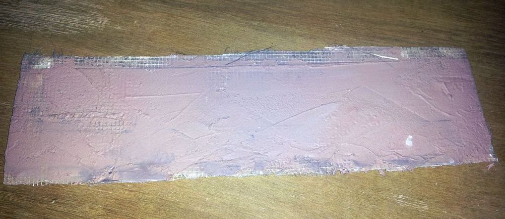

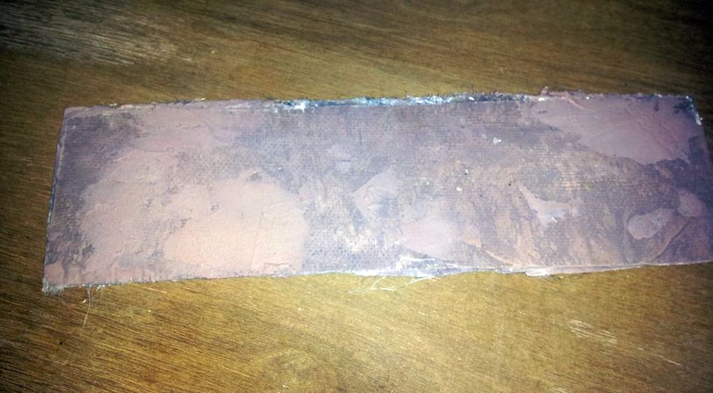

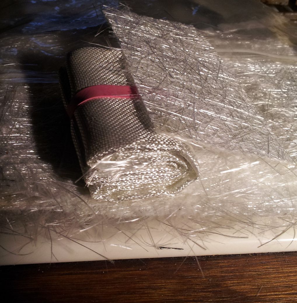

Did a home brew project last week that worked quite well. I had a bunch of leftovers from some auto body repair. I used two different fiberglass fabrics, the resin mix mashed and clamped between to pieces of aluminum (could also use smooth plywood) covered with old fashioned wax paper.
A little Bondo, some sandpaper, black spray paint and Voila! - Works as good as perf board. Not exactly foam board but strong, DIY and in my case, free
A little Bondo, some sandpaper, black spray paint and Voila! - Works as good as perf board. Not exactly foam board but strong, DIY and in my case, free![]()
Nice work Bob. You know, if you wanted to make the board stiffer without adding weight, next time wrap the fiberglass around the foam core board to give it extra spacing to put the fiberglass farther away from the center of mass and this stiffens it a lot - like a surfboard. And it would be a heatproof amplifier foam core board.
