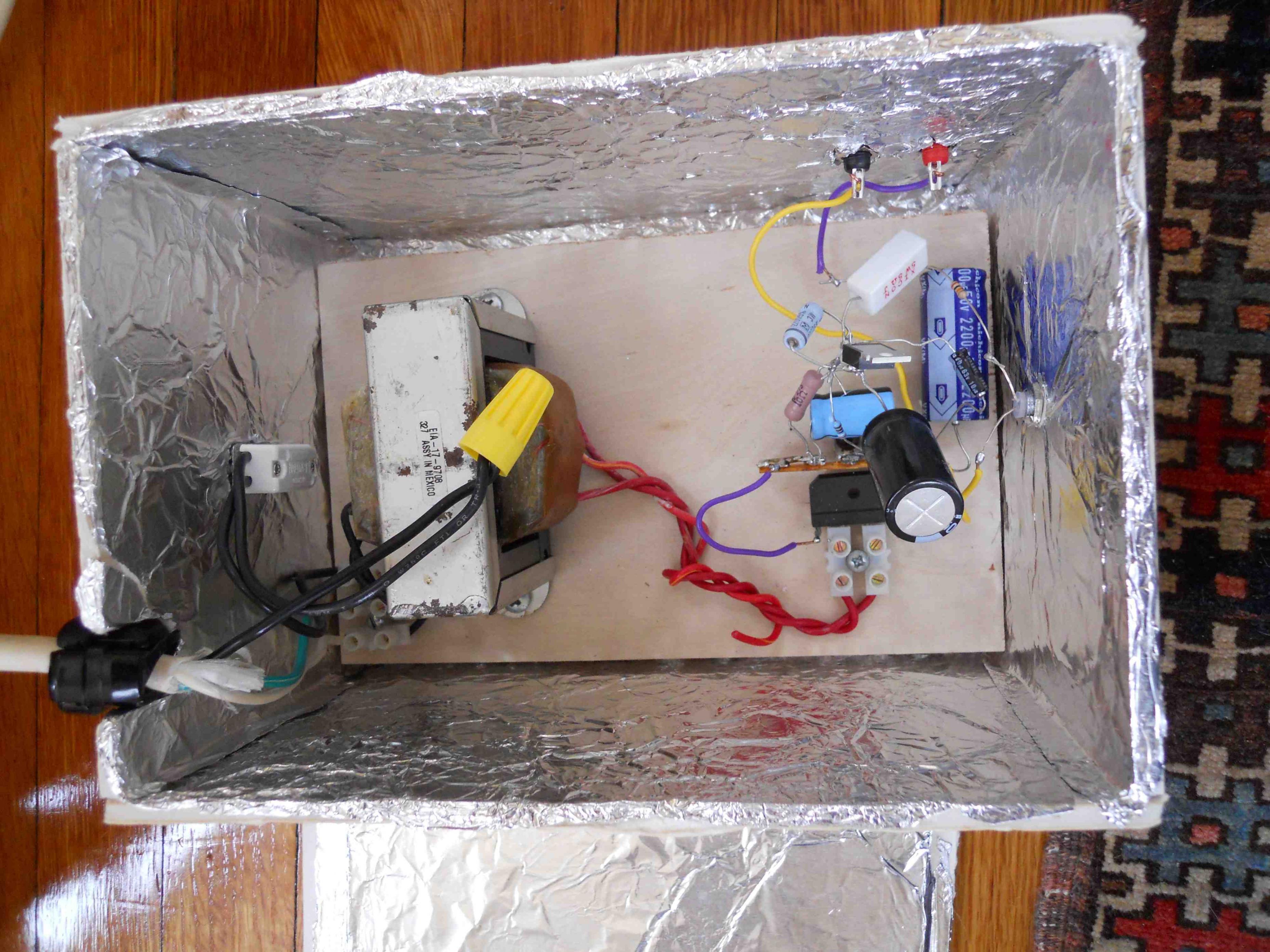

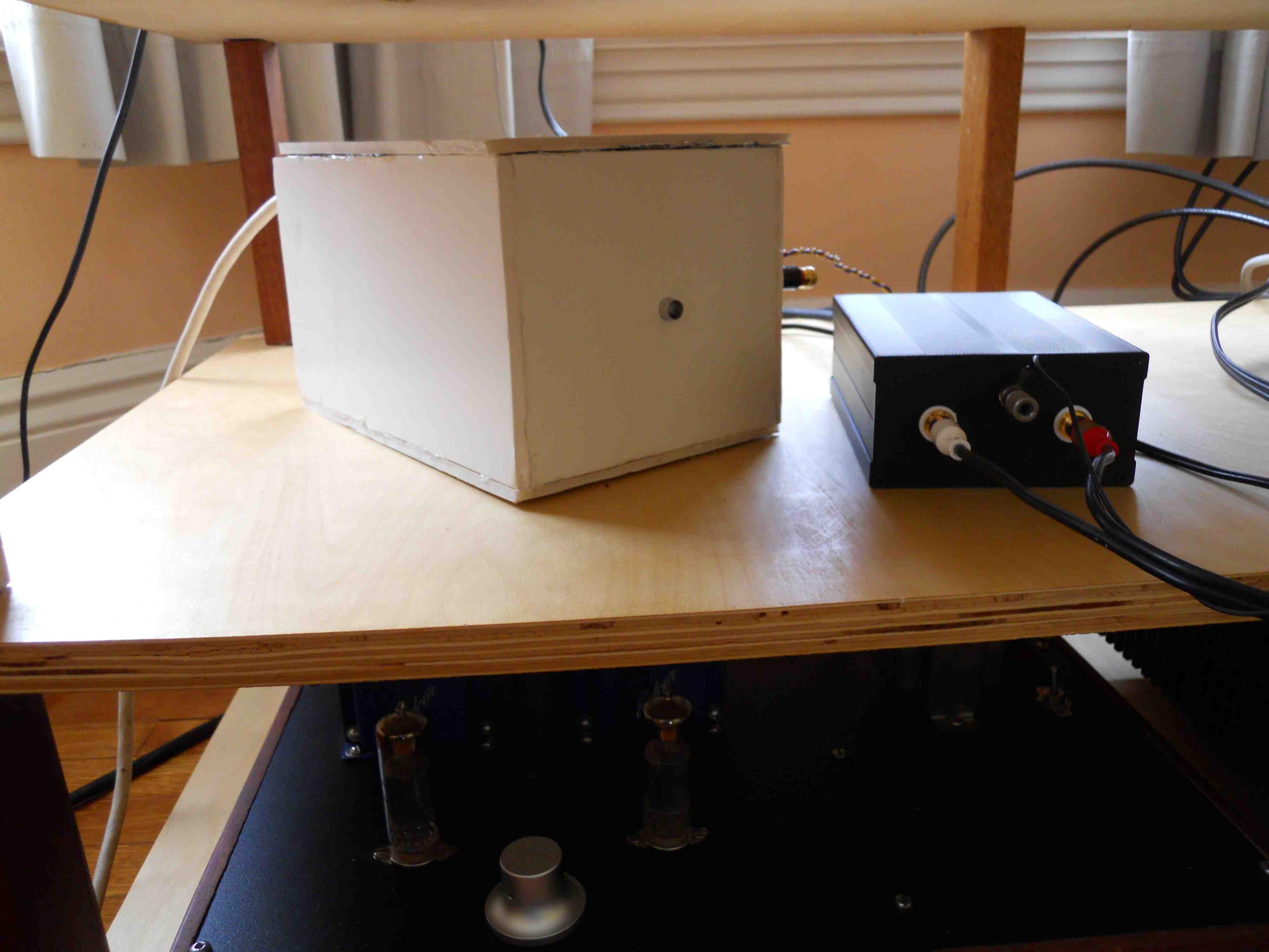

OK, just a tad off-topic. Built a breadboarded PS for my phono stage but I was getting some hum. Decided I wanted to try it in metal for some shielding, but I didn't have a metal box on hand. I built a box of foam core, lined with aluminum foil, then tried it out.
As it happens, the hum is coming from the TT and cartridge coils, and aluminum foil isn't a good shield for magnetic EMI, so the box did nothing for that. It did, however, let me do testing more safely than with the bare breadboard.
Built the box slightly larger than the board, dropped the board in, soldered a few connections, now I have a box with a switch and LED power indicator. Temporary of course, but functional.

Did you ground the foil? Without it grounded it won't do anything.
Hum in a phonostage is almost always a grounding problem, not PSU noise -- keep at it, you will discover the culprit, usually something simple.

6L6 is right, not connecting the aluminum foil to ground did nothing. Most project cases are aluminum so it is the RF that it is shielding. To block magnetic you need to use special "Mu-Metal" material.

Foil is connected to mains ground. Center tap on secondary floats as I've full wave rectified the old 25.3v filament transformer. Using a LM317 set to 24v (23.76 to be exact). Just trying to see if I could build a quiet, cheap PS for a project that needed it, to be honest.
