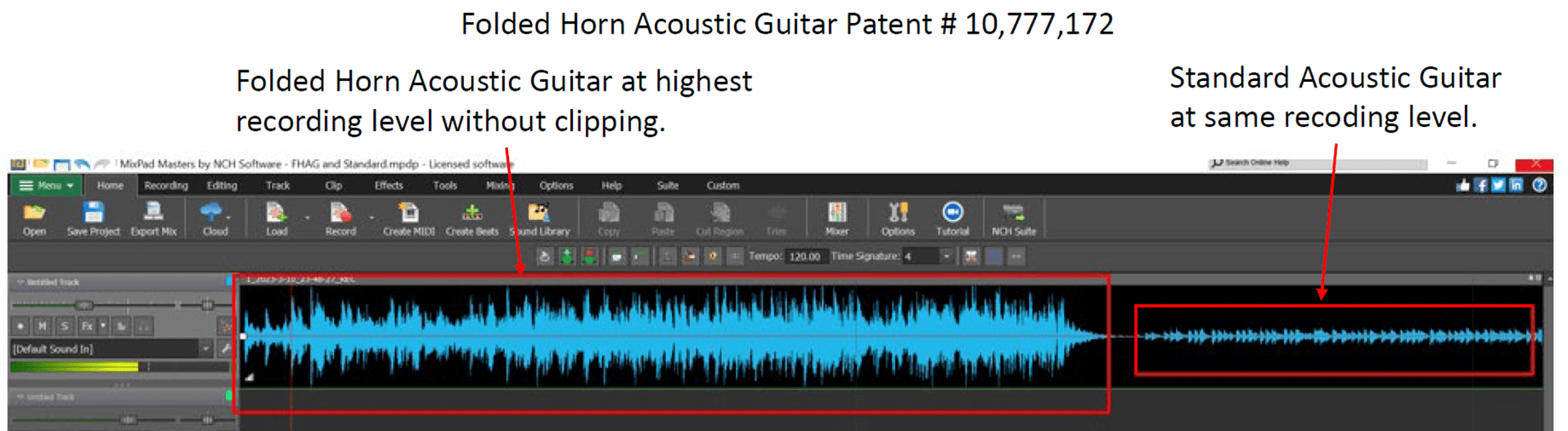

Hello all - link attached so you can hear the difference from standard acoustic guitar and Folded Horn Acoustic Guitar. I am posting this so you can hear the difference in dB level. This is my first try with a USB mic and the tone is not great, so do this is for power level ONLY, tone to improve later.
I also attached a PPT showing FHAG and standard acoustic guitar general recording levels, not the same song posted, but you get the idea.

I downloaded the file, extracted the "with horns" part in the middle to a separate file, the acoustic alone at the end to a separate file. Had REW do the frequency analysis of each, put on the same plot. Surprised to find some frequencies (ex, around 175, 2kHz) the SPLs are the same.
Using the math functions in REW, I then did A(horns)/B(no horns) to create the third trace, which I believe represents the SPL gain of the horns over frequency - relative to the guitar alone; playing that shuffle, in that room. (So when the blue line is riding right over the top of the red, the net sound added is zero) I also used 12th octave smoothing, otherwise the plots just looked like space dust...
Unsure if this is a correct, fair or whatever analysis. It seems to show the difference in SPL between the two recording sections over frequency. Or at what frequencies the perceived loudnesss increase is coming from - between those sessions, in that room. I'm assuming REW is plotting the peak SPL level it finds at each frequency in the analysis across the whole recorded file imported into it.
If the electrical signal from the amplifier was recorded along with the acoustic output of the horns, then using such an analysis, one could show the frequency response of the horns (in that room). FWIW, I can show you how I did it in Audmonkey (Audacity) and REW.
Thanks JJ! Very interesting, I see some frequencies have about 30 dB difference, also 20 dB, I see much of this. I have also seen the 100 and 175 Hz very high spikes from the acoustic guitar only, have posted this before. They are very peaky here, and the Folded Horn Acoustic Guitar is much smoother in this area, a good improvement. If those two spikes were removed from the acoustic guitar, it would look (and sound) smoother, then move it up 20 dB, all good.
I have never seen the 1,500 Hz to 3,000 Hz the same, ever, so not sure what is happening there, may not be accurate? Now the harmonics do meet at about 15,000 Hz on some songs, and others they never meet, but of course get close.
