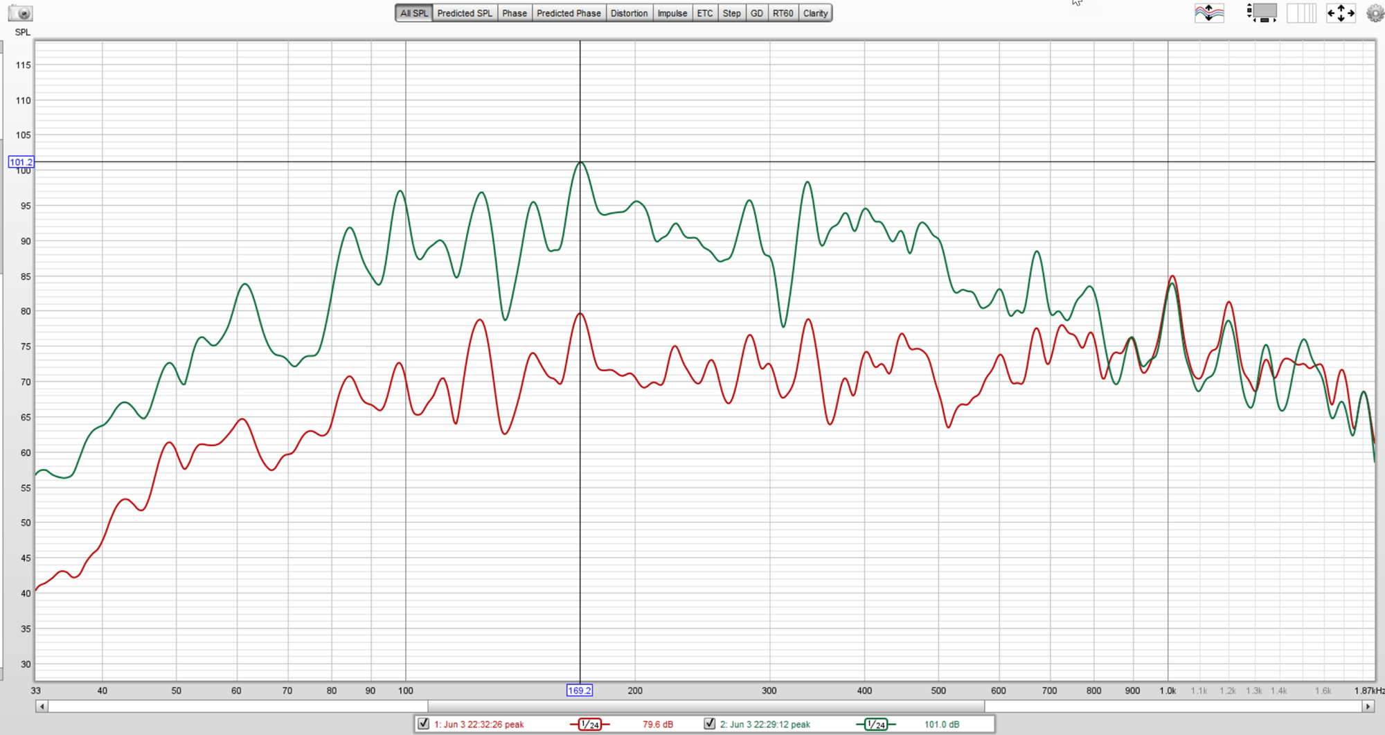

The above was posted last week, but this is a higher res snag up to about 2kHz only. This really shows the bass "going through the roof" as I have mentioned before. It is playing music from an iPhone through my guitar horns only, no guitar playing involved at all. The 3" drivers don't change much above 1 kHz, and they did not need to, it was all mids and highs without horns. Close the horns and wow, bass increase is incredible, and you sure can hear it.
As I have noted earlier, I believe an acoustic guitar can sound just a little too thin due to the high steel strings. The lower steel bronze wrapped strings do not have this problem. This added bass from horns really smooths out the entire sound, adds warmth, but still lets the high strings break through, not over bearing anymore. I was not sure if I could claim better tone on this guitar, but I am now very confident this is happening, along with 4X the power!
Obviously greater low end can be achieved with larger drivers, which I can not fit inside my guitar. I have read that digit processing can add greater lows, which I am not using, do not fully understand, and am skeptical about the results. I understand that "small" music systems use this, that is enough evidence for me, they don't sound so great.
The other way to get great lows from smaller speakers in spaces that can not be large is horns/waveguides of course. My experimentation is absolute proof that this works. I can hear it, and I have the data. I have discussed the 1/4 wavelength rule here before, and have never had a response. Research suggests this is critical, and now I believe it. 80Hz from a guitar has a wavelength of approx. 16 feet. 1/4 of that is four feet. I have two horns/waveguides that are each five feet long, does the trick.
I would love to hear comments about this, let me have it!

https://www.dropbox.com/s/2bbwgb45qdp8p94/Mono Pink Noise.wav?dl=0
A pink noise file. Download that, play it through your horns with the amp EQ flat, do the same frequency analysis in REW using 1/48th octave analysis.

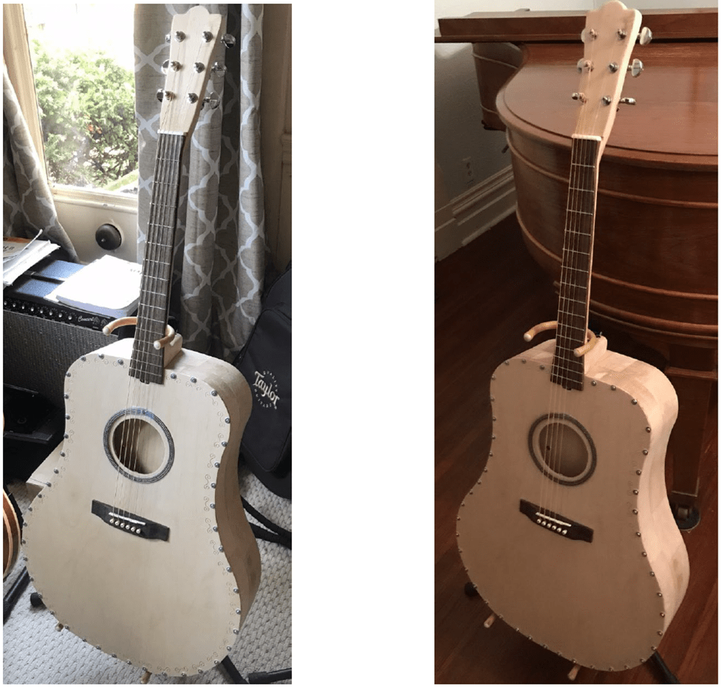

Guitar is assembled and strings are on, good news and bad news:
The bad news is my lower quality neck is warped a little. I knew this when it came off the CNC machine. I decided to use it and make mistakes on this neck. I was hoping the string force would pull it up, did not happen, sounds like *** due to fret buzz.
When I pushed this neck forward (as you can do with any guitar) the low E sting rings out, did the same with my Taylor, does not sound very different at all, good!
The good news is I have another neck, it is straight as an arrow, will not have this problem. I squared the wood up first, then CNC, based on the problems with the first neck, live and learn!
Also the soundboard is rock solid, no way in hell the force of the strings will affect the screws or soundboard, good news!
Two steps forward and one step back again, but very encouraged by the soundboard and I have a good neck (will machine two more of these).

I am working on my better neck now, looks great, will fix the string buzz problem for sure. I did say before my neck was straight as an arrow, and it is, this second neck. I used my first neck to experiment, and I am glad I did, because the sides got a little small at the top. Plus I just sawed some 5"x5"x24" Rock Maple pieces to bring to the shop Monday, CNC two more necks, now that I know what works. Have three bodies, need three necks, plus the body to neck fit is custom, so I can't use an "off the shelf" neck blank. When I did that first neck, I didn't know what I didn't know. I am good at getting things right the second time!

My new neck is great (straight as an arrow neck) fret buzz will be gone, so much better. All I can think about now is when this is finally assembled, please do not feedback, please! Oh the wonder, the joy, the fear!
