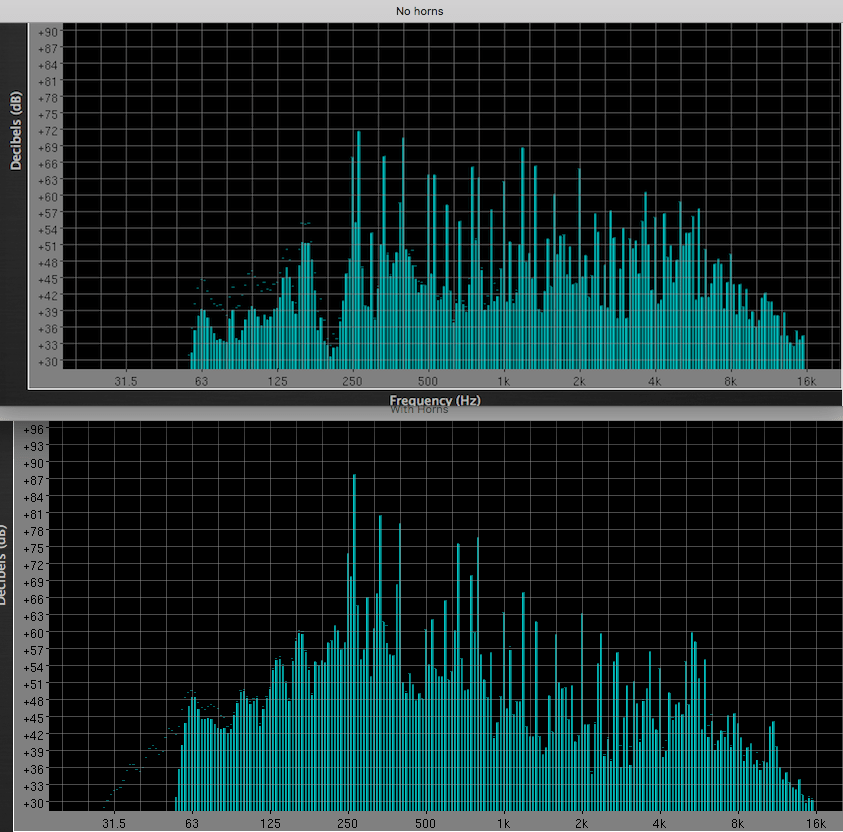

I assume you measured 200 Hz-1000 Hz, did not get a big increase above this eh?
That's what I heard, then looked at a the REW RTA to confirm.

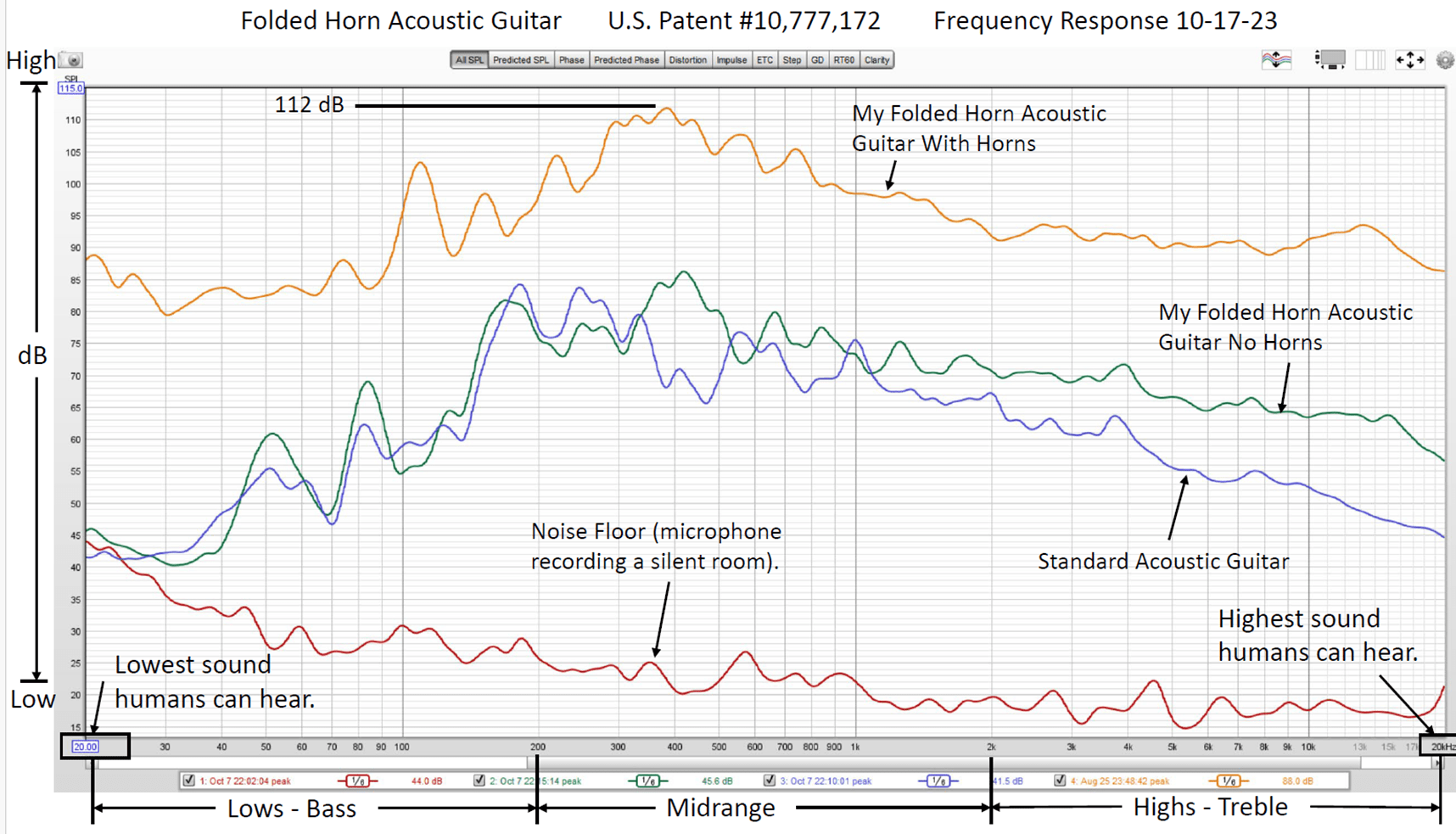

I agree it is more brilliant with the No Horns option vs. a standard acoustic guitar, measured that in the past. So yes maybe that is more from the light yet strong soundboard, and then everything goes up it dB with the horns, is this what you are hearing?

From what I heard and saw on the RTA, the horns don't seem to provide any gain in the upper range, the sound changes from "thin" to "middy", since the upper harmonics are not increased.

I know this previous data is not from the recording studio, but I have posted it many times. Looks pretty substantial to me. I really really wish I brought a measurement mic to the studio to get good data, but I just did not think about it, next time for sure!

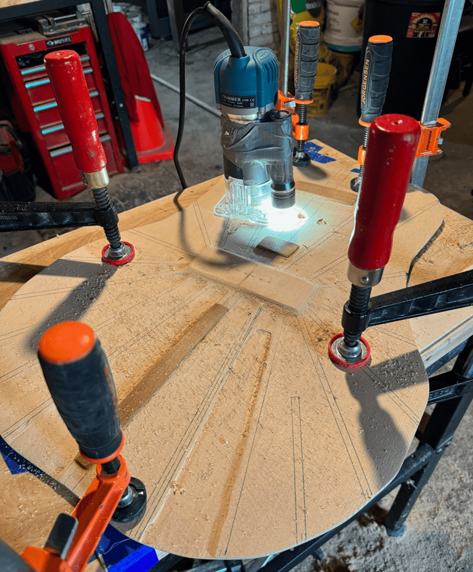

I am trying to finish up a Sitka Spruce soundboard with a palm router. Since my soundboard is so big, off the shelf is not an option.
I really like making everything from a solid piece, not glued on ribs. Gives the soundboard extra strength, and the ability to

JJ - you are correct, I did surrender those large spaces to the upper acoustic chamber, and it made a huge improvement. I wish I could make the upper chamber thicker, but then it would be to big and unplayable, would look like a mariachi guitar. I basically am out of room. Thankfully the Horns OFF option can hold its own for an acoustic guitar, pretty favorable, but not a high end Martin or Taylor for sure. Now with the Horns ON, that is where it shines. That often makes me wonder about the Fender Acoustasonic, which has a very thin chamber. I don't see how it is possible to get a favorable acoustic sound without the electronics, I need to try one.
I do play in my bathroom, thankfully I have one in my office, and when my wife goes to bed, it is the farthest distance from the master bedroom, so I use it often, love it. My recording techniques just need some improvement, that is for sure. Also I am not discounting your idea about two different horn lengths. I like it, just not easy to do, on my list like many other ideas I have seen on diyAudio!
BB - yes I hear you, but the guitar and piano both have strings and also a soundboard of course, so there are similarities. That said I agree they are quit different. I just consider the Grand Piano to be a very powerful instrument, maybe that is a better description. It is so big and loaded with thick beautiful tonewood. My guitar with Horns ON would not get lost in the mix with a Grand Piano. Horns OFF it would not have a chance, like any other standard acoustic guitar. Ok I will buy the apples and pears comparison, but at least they are both fruit! :ROFLMAO:

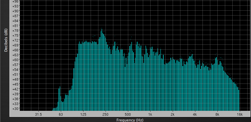

Since my impression of your April 2024 Folded Horn Acoustic Guitar Video .mp4 is so different from yours, just want to show you visually with some representative long hold time RTA screen captures what I hear.
For a “baseline”, here is your voice, it has more bass and upper harmonic content than any of the guitar sections:

That said, the “with and without” horn comparison clearly demonstrates the low mid boost the horns provide, and lack of any increase in the upper harmonics:

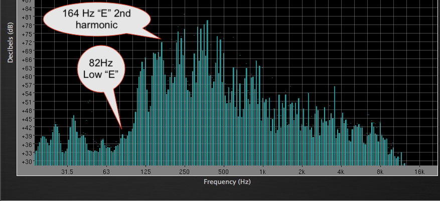

Listening to Casey on the blues song: the low E string is banging out the low end just beautiful, and when he goes up to about fret 12 on the 1 and 2 string, the highs are brilliant. Seems very obvious to me, that is why I claim it to be real in my video comments. If anybody has an argument against this, bring it on!
The level of the low “E” in the blues song was at a similar level to the rumble noise, the second harmonic ~164Hz is about 33dB louder- that's what you hear "banging out":
And the feedback bendy end, the little dots show what happened just before:

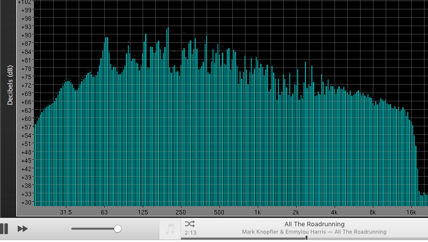

This Mark Knopfler /Emmylou Harris recording the wider spectra of bass guitar, vocals and other instruments fills in the gaps :
Anyway, that's what I heard ;)
Any way to repeat this analysis using REW? I know it has a peak hold function, but that's slightly different than "long hold time" in that long is infinite, versus maybe XX seconds or something. I couldnt find a "persistence" setting in the REW analyses.
