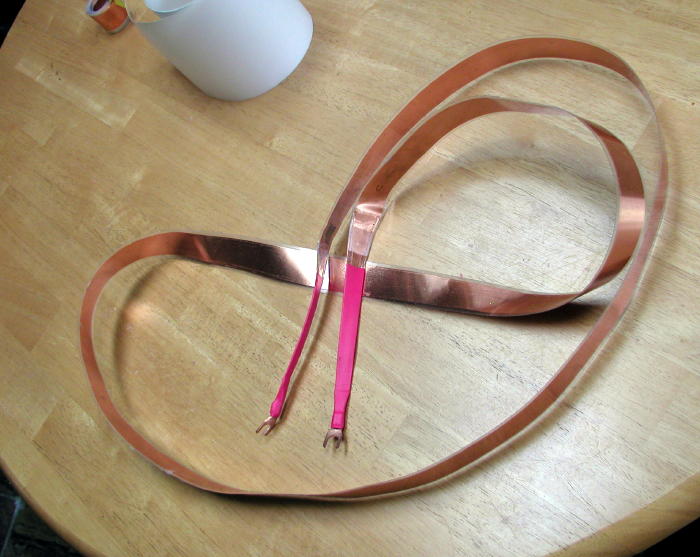

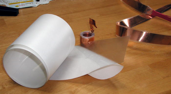

To insualate the foil, I used that plastic tape (with advesive on one side), I buy locally. It is 5" wide and I cut it into 4 strips, 1.25" wide. The foil is exactly 1" wide, so the plastic film tape can conveniently be attached to both sides of copper foil. I use separate cable runs for positive and negative side. Termination is done with Cardas spade lugs and heatshrink tubing applied.
The cost was about $30 for everything and it took about 2 or 3 hours to complete (both of my kids where giving me a hand and we had a lot of fun in a proccess).
As to the sound, I'll be cautious enough by saying that I didn't compare them to any other cables. But when I installed the cables in a system, I don't feel like I want to replace them. The detail is amazing, very good tonal balance and nothing that could be annoying. Highly recommended.

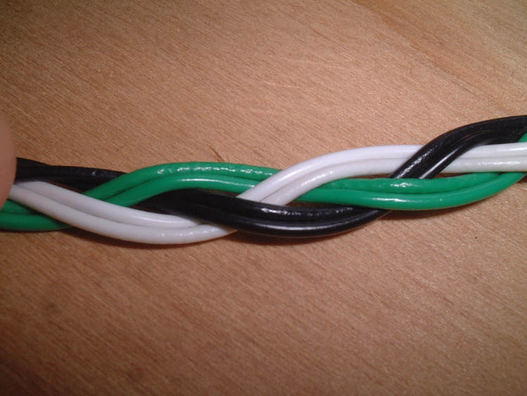

Looks interesting. i seen some stuff here at the audio store locally and it was very expensive. 2 conductor and it was laminated side bye side. about .5mm thick. and about 56.oo a foot i believe.
me im going to start making some of my own i like the idea of braided wires so im going to buy a few rolls of single stuff and weave my own.
here is the right cable from my cd player that i used for a while i like the colors. : O ) Now i just need to find more of these color's now..

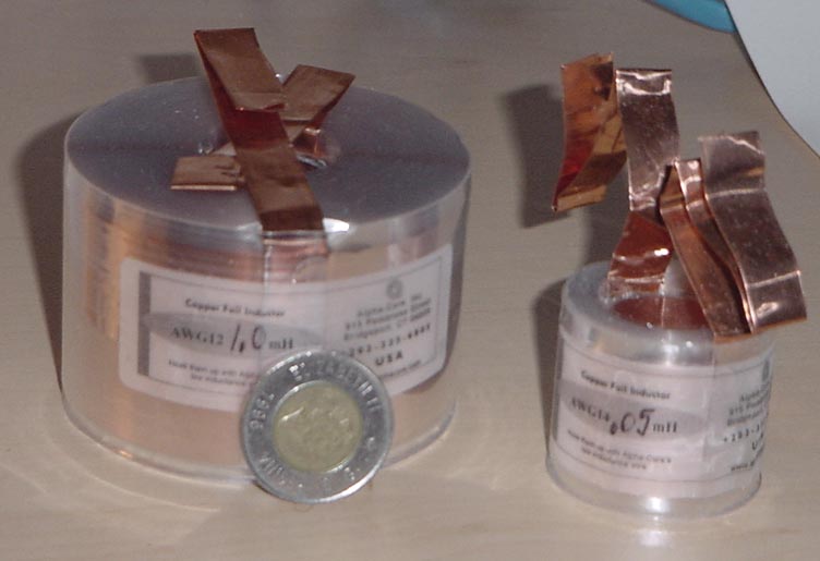

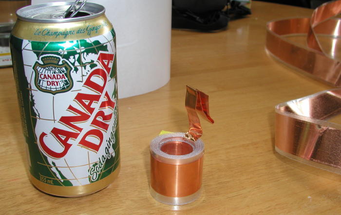

I used those 0.1 mH Alpha Core, 14ga inductors and one coil contains enough foil to make 4 lengths of 6' ea. It is also pretty thick and easy to work with.
Haha, way to think outside of the box. I see those are about $7 a pop...not bad! From the looks of it, it looks like they are already insulated as each layer has some plastic, or is it just plastic between each layer of foil...kinda like 2-ply toilet paper (lack of better example)
You said you used a 0.1mh inductor, do the bigger value inductors just have more windings, or do they have physically bigger foil?
Ex-Moderator
Joined 2002
Peter Daniel said:
They have more windings as gauge stays the same. To tell the truth I didn't expect so much linear feet of copper foil from such small coils.
There is a plastic tape between windings, but it's not attached.
Below is a special .05mH @ 14ga next to a 1mH @ 12ga. For Peter, I show a "two-ny" to gauge size with. The two-ny is a little over an inch in diameter and worth about $1.25USD.
