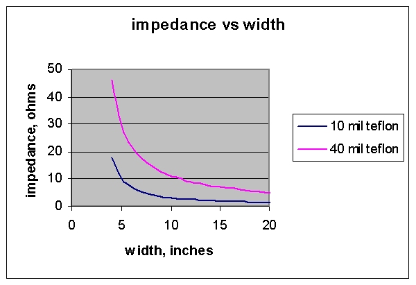

It is an excel ss..What do you wish as the independent variable?
DC, width, insulation thickness, inductance, or capacitance?

Here's a plot of wire energy storage vs cable impedance with an 8 ohm load....oh, I forgot..the energy stored is a result of 100 wrms into that 8 ohm load..and although in the microjoule range, that is significant w/r to a 5 to 10 Khz signal..
Cheers, till tomorrow....John (the magnet "clown" I was referring to)

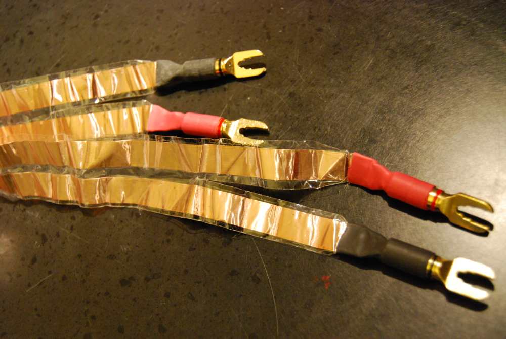

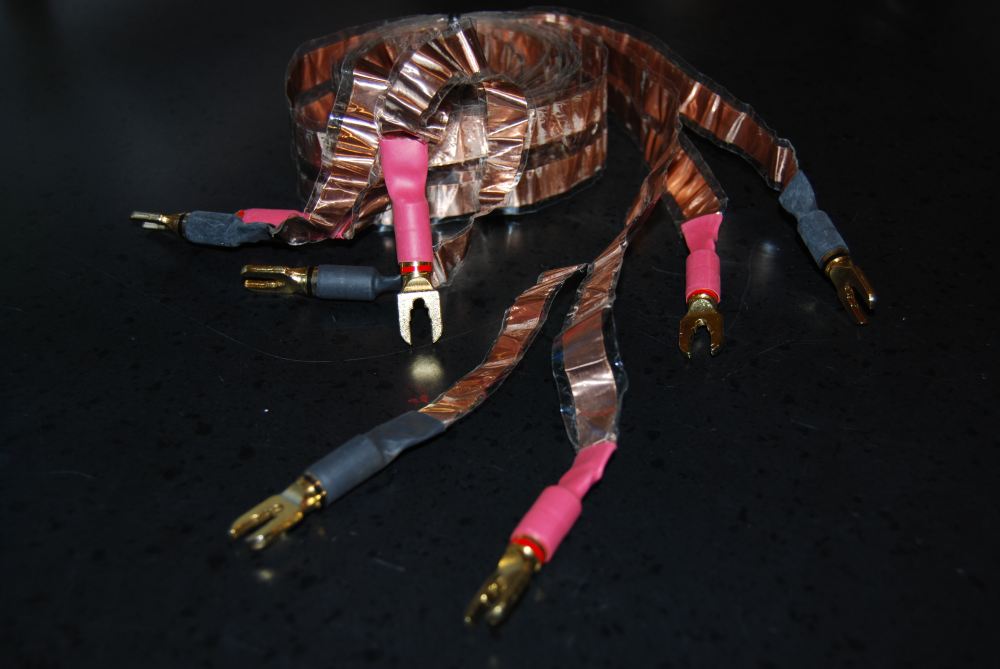

Hybrid fourdoor said:Heres some pics. These are current...after 3 years.
Very nice hybrid, but I have a few questions. ou said it was from partsexpress, but I won't order from them as Im in the UK. So:
1: What is the width of each of the copper strips in your cables?
2: Have you trimmed down the ends for the spades?
Finally, how do they sound ?
Im thinking of going for silver foil instead of copper with some cotton insulation. But it all depends on how my new amp sounds with my speakers this weekend when it is delivered.
You may have a hard time finding silver foil, Alpha Core hasn't made any in a few years. I just scored two silver inductors off of Audiogon.
My cables came out pretty ugly because I used mylar instead of tape. If I were to do it over again, I would use tape. Luckily, this was for a cabinet re-wire.
As for the sound, MUCH more highs and more detail all around. No loss in bass either.
Needless to say, I'm VERY happy. The only downside, poor recordings sound even poorer.
