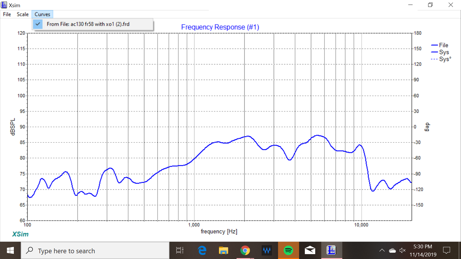

xrk971.
I looked thru forum questions and found out how to post a picture. The info I put up is a display of an .frd file from my measurement. I will go ahead and measure each driver separately and the two together and a near field on the woofer before I move anything. i am not experienced with measuring but will do my best. I also have an IR measurement. Howard
You don’t want to use any coil or cap for the baseline measurement. Just the drivers connected straight to the amp.
