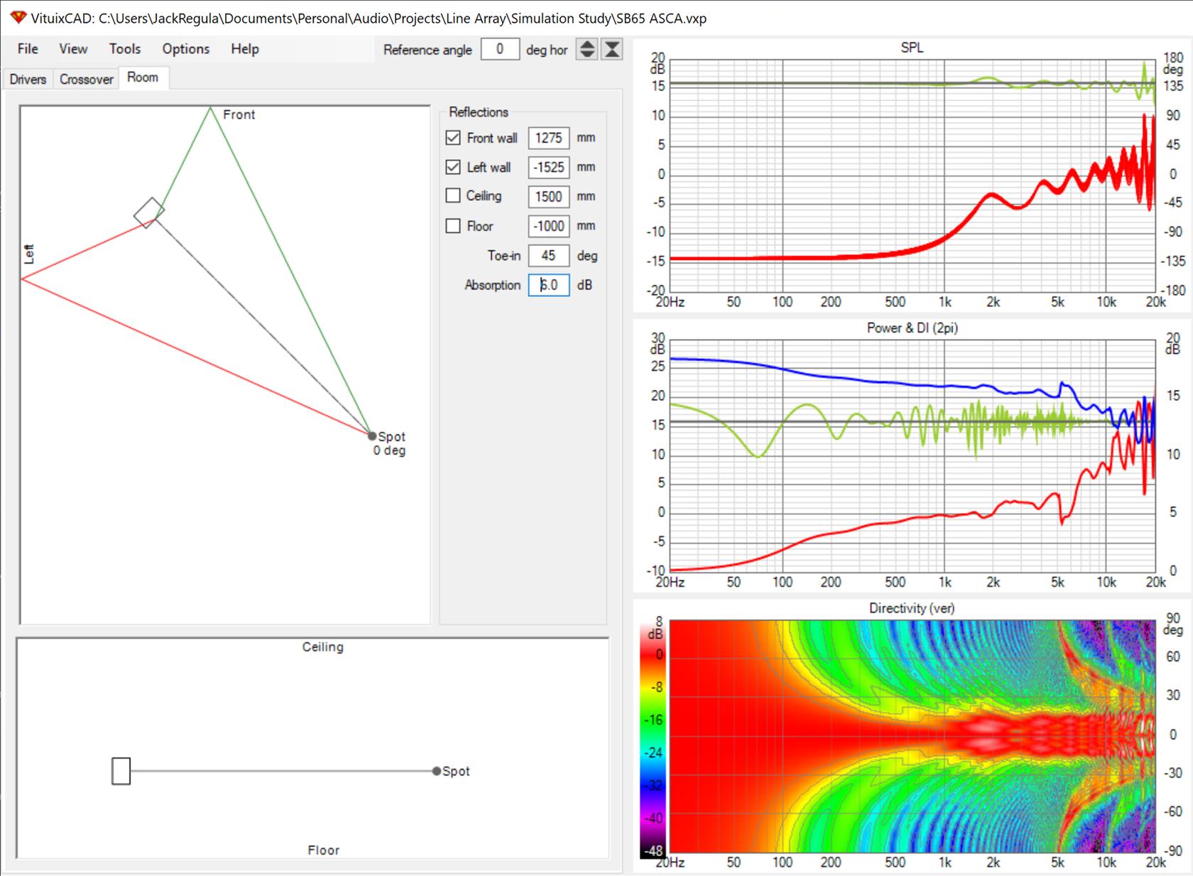

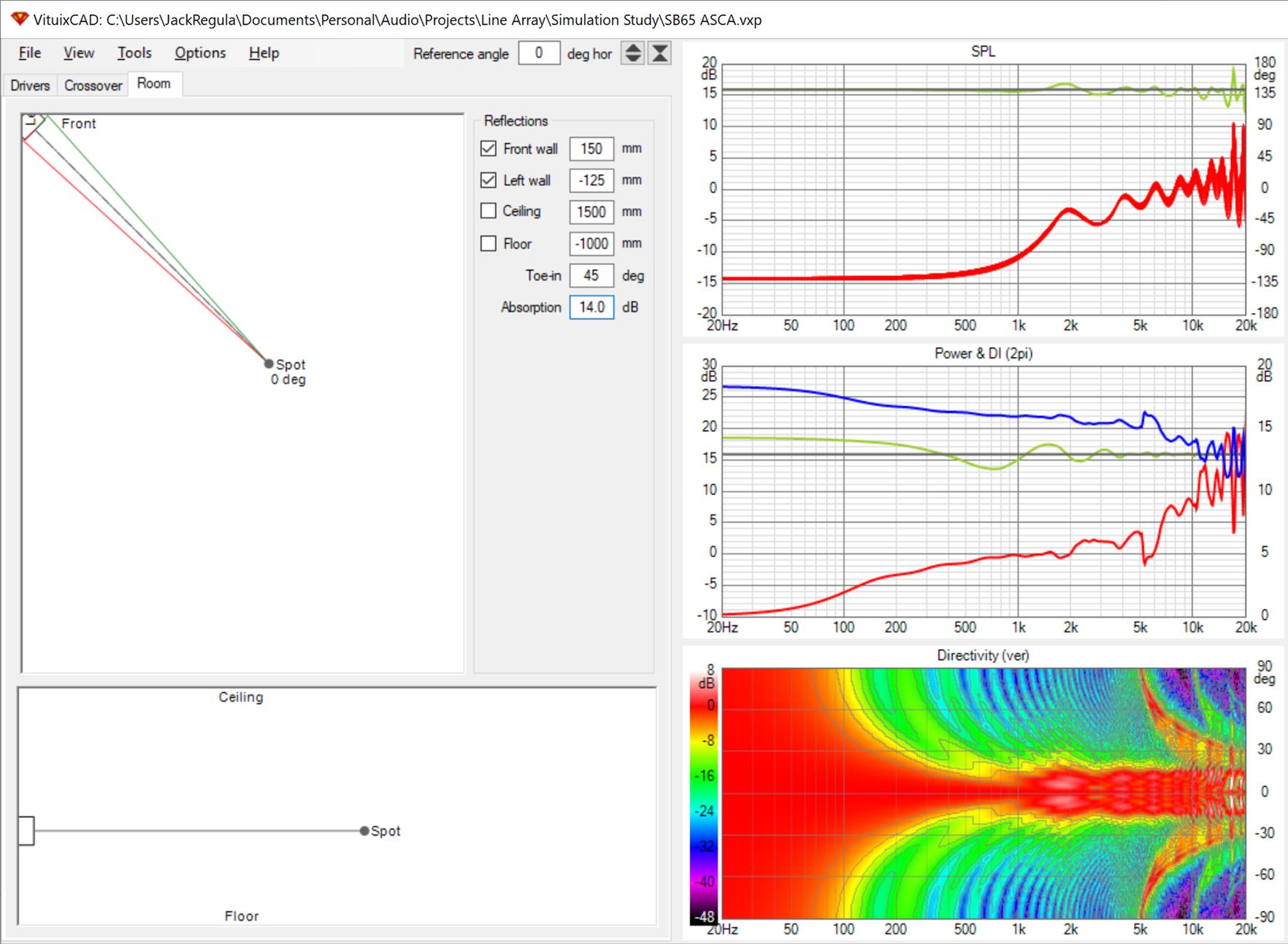

Now here is boundary contribution prediction by Vituix for my array location in front of the garage door (green trace in middle graph):
This showing a 71 hz null and another at 220. It does predict the hump in between that we see. 6 db effective absorption is a guess. There should be at least that much at 200 Hz, declining rapidly as frequency decreases.
Here is the boundary prediction for the array tight to the corner.
With 2" thick pad, I believe I can get to the spacings shown which push the first null out to 720 Hz and reduce the null to a slight depression of 2.5 db or so. At lower frequencies there is a lot more corner support than shown as absorption drops off rapidly.

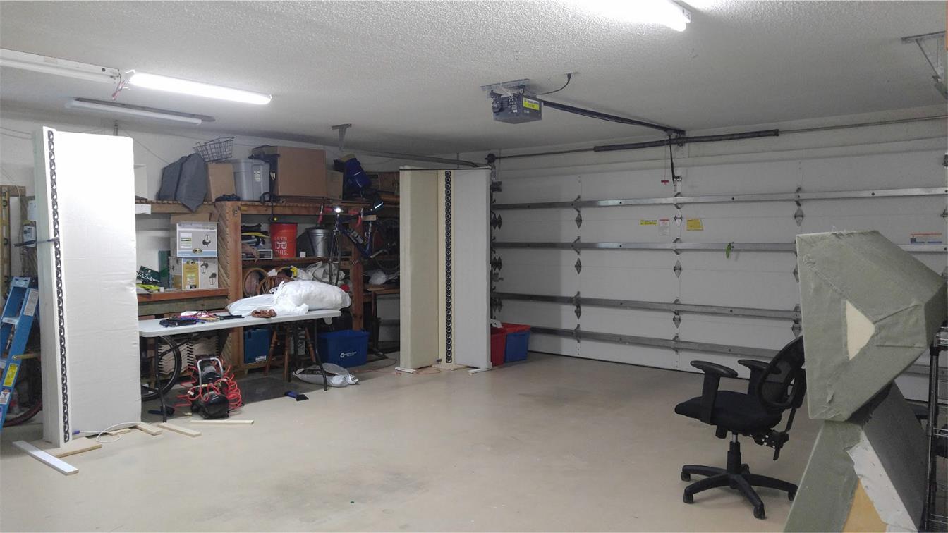

Yeah, now if only I had a corner I could use out here. There is one inside though.

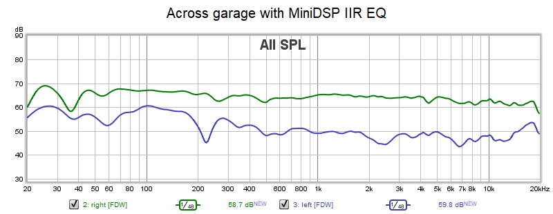

This morning it looks workable to rotate my listening axis so that sounds go across the garage . That gets one of the speakers away from the garage door where it restricts the opening. Any absorption I put on what are now un-insulated block side wall will benefit me thermally.
Ages ago it seems, I turned my room on its ear (well rotated it 90 degrees) because the 2nd array crowded the garage door too much and thinking it would be easier to treat the new rear wall.

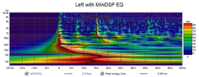

Since then its been a recovery operation trying to get back to where I was. the real challenge was implementing a circa 100 Hz XO in the presence of boundary interference near XO. Normally one would do this with outdoor measurements and/or nearfield of the LF but one can't nearfield an array...
But I persisted through several long days of trying again and again until I got something that seemed worth trying.
That isn't very impressive but it took all the miniDSP resources. Clearly there is work to be done both on the room and in DSP. But I listened anyway and was encouraged.

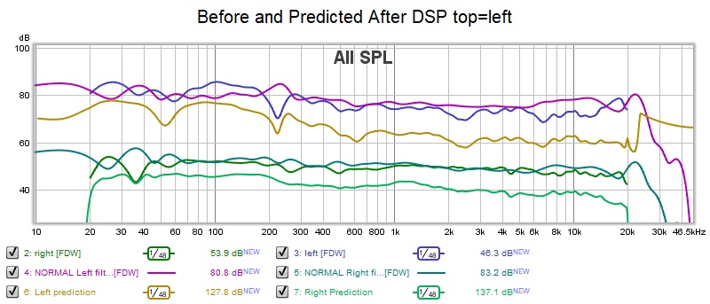

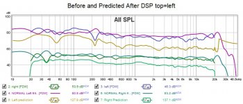

This morning I got up with more energy and did a quick run through DRC Designer.
Left channel
Right channel
DRC did a much better job on the right than the left but right was closer to begin with. This underscores the point that the better it is before DSP, the better the correction DRC does. That means more treatment. My 4" thick rigid absorbers don't go low enough, doing only a few db at 200 Hz. When I get time I will augment them with 8" thick pink and fluffy which porous absorber calculator tells me will be highly effective down to 100 Hz.
There is also a lot more to be done with DSP. This was just a quick check. Curious that DRC didn't flatten the phase at the low end.

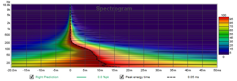

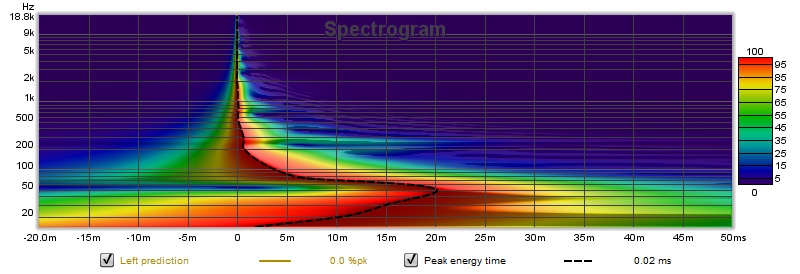

Left channel
Right channel
