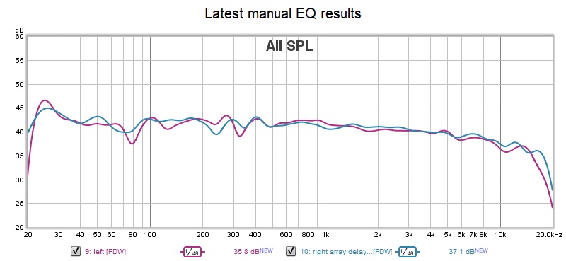

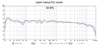

Since DRC was giving me a hard time, I went another round of manual EQ and got some surprisingly good results.
attachment.php
This is as far as I can go with MiniDSP resources. And this is the same set of absorber panels I've had for the last little while. And mono woofers, so all the woofers, left right and rear, are driven with both left and right inputs.

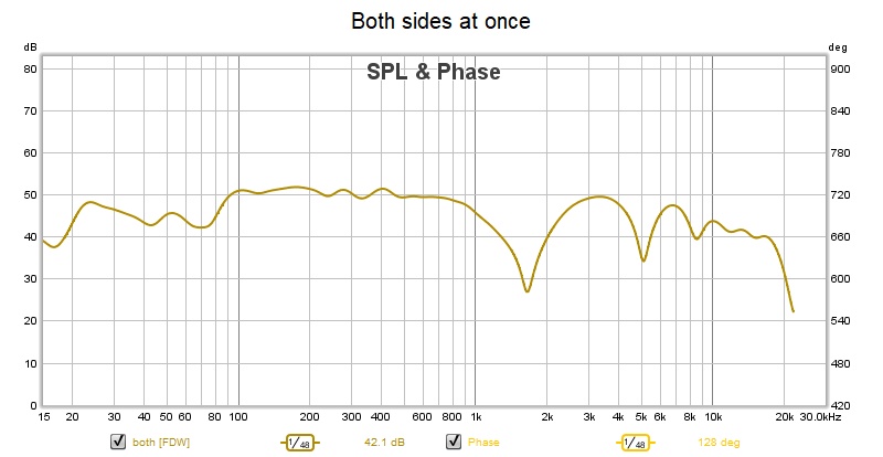

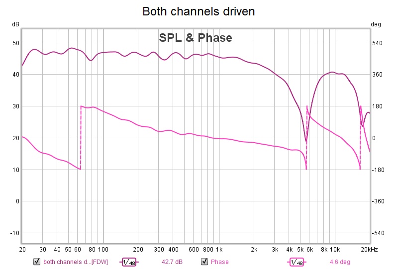

That is why I shouldn't have been surprised at what I saw when I measured both channels at once.
attachment.php
with both channels driven, the arrays sum in phase but there is no additional bass so I end up with the bass -6db. This is the kind of thing I typically don't think about until I bump into it. I would think if the same tones were present in both inputs, they would sum in the input side of the EQ and result in proportionally more output. Clearly that didn't happen.
Is it the miniDSP's fault or mine? I've got the soundcard to output on both L+R regardless of which array(s) I'm testing because I didn't want to have to reconfigure continually. Both L and R feed into each woofer. So with L and R driven and L and R summed in the MiniD matrix, I must in effect have a level of 2L when testing L's woofer. Which is the same level I get when testing both channels together.
I think what I need to do is reconfigure the sound card to output on L only or R only depending on what side I'm testing and to drive L and R together only when testing both sides together.
Congrats, looks amazingly good. 23Hz is most likely a mode peak, but that doesn't hurt. Humans can't hear it, but those real subsonics give nice realism and ambience that we don't get with most BR speakers. Sealed subs?
thanks! But its a head in a loose vise equalization. 12" front or back and things change quite a bit due to unsuppressed modes.
Yes, sealed AE TD15s near each front corner plus dual opposed TCsounds 10" woofers (with 29mm Xmax!) in rear.
Two more AE TD15s in reserve, now used as end tables in the house.

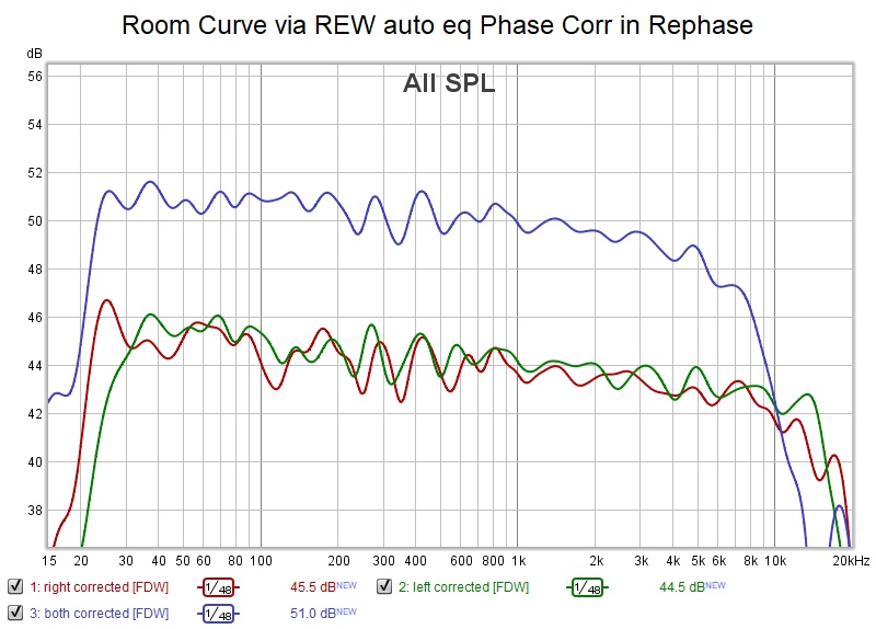

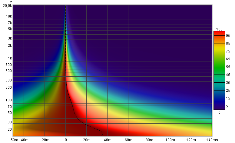

OK after several false tries I have had success with DSP/FIR.
I started with REW auto-eq primarily to apply a house curve and to balance the two channels. These arrays sound harsh without a house curve tapering of the HF. Then I imported into rephase. I then imported my measurements also and used paragraphic phase eq to flatten the phase.
attachment.php

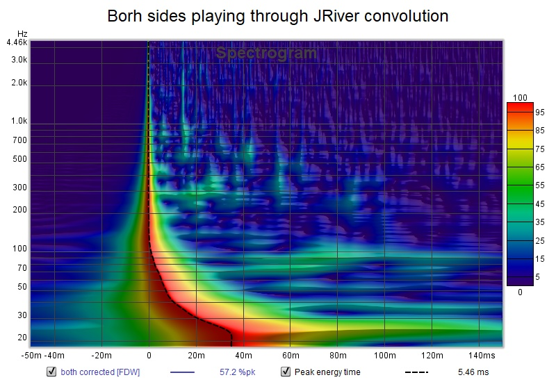

notice how nicely one channel fills in the others dips when playing both together. The +/- 2 dp swings in the lower midrange is where I'm still bothered by boundaries or modes so I didn't bother trying to equalize them. I'm impressed that REW also declined to smooth them, likely too high Q.
attachment.php
This is very listenable!. I don't think I can hope for much better until I do more to tame the room.
Very nice work, congrats. Bet it sounds great !!
I've never tried to measure combined left and right response like that.
It's interesting to see the faster HF rolloff with the combined, vs either of the individual channels.
Do you hear a tonal shift, combined vs single channel?
Sometimes I do, when I switch between trying mono and stereo. It's always song dependent, I never know which I will prefer. I guess it's about how phase combines.....
I think you need to measure with both to see what is going on in the bass, even with mono woofers. I see differences in bass response right vs left because I didn't catch an intervene in what auto eq was doing in that region. I should have ensured both channels were equed the same. OTOH, it worked out fine combined, except it EQed away below 25 hz unnecessarily.
At the high end the small path length difference results in phase cancellation between left and right and combing where the distance is great enough. You can see that by pushing the mic a short distance left or right and re-measuring. If you are persistent, which I wasn't, you can find the spot that is close enough to equidistant from both arrays to eliminate this effect.
So there is a definite tonal effect effect but the ears combine differently than what the mic shows in my dual channel measurement. Its cross talk from one side to the other ear and head shading as well. I think the "phase shuffler" thread explored this and ways to mitigate it. i'm not into that yet although Wesayso certainly is and I expect to get there as I work through other response optimization priorities.

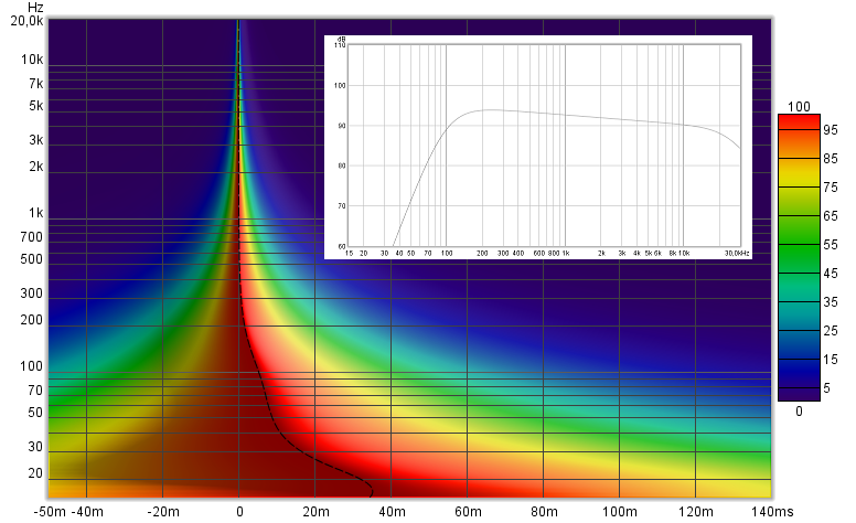

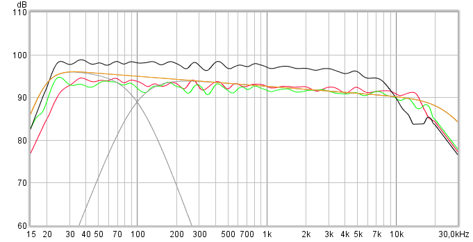

Traced post 347 responses and used VituixCad to convert those to IR plus made some ideal target curves in Rephase based on APL audio 7dB curve as seen below:
attachment.php

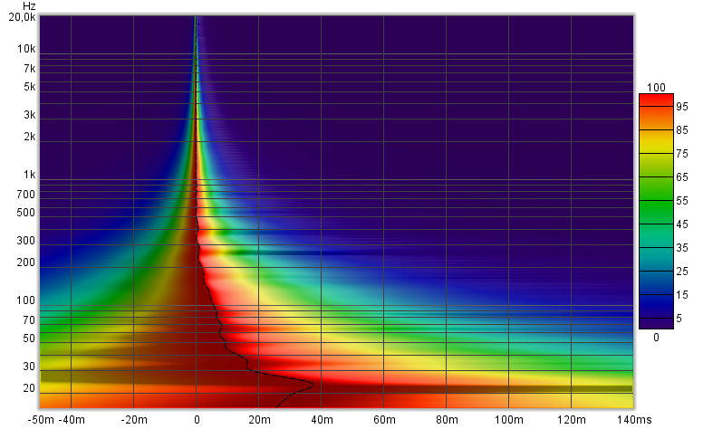

Traced IR of both sides gives below, notice the build up area:
attachment.php
This is measured graph where "Peak energy time" is probably fine but what happens to build up area, it is clearly missing:
attachment.php
This is the ideal target curve from a 96kHz Rephase IR based on APL audio 7dB curve with a 100Hz 4th order IIR XO point:
attachment.php
This is same as above using linear phase for XO point:
attachment.php

@BYRTT Your contributions always give me something to think about

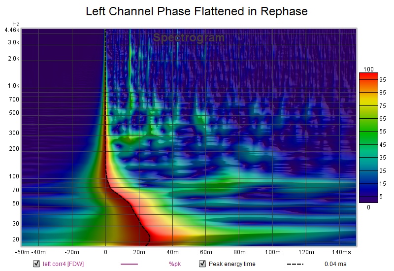

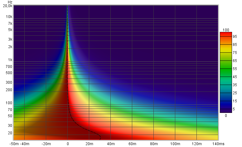

Your last picture looks like my individual channels, but cleaner. I did the XOs in miniDSP, IIR flattened the phase down to 50 Hz or so with rephase when applying the room curve.
attachment.php
I don't know what to make of you comment re' built up area missing. i do see what you are talking about. Its curious sure but i'm sure it will change when I add the bass trapping/damping and rear wall absorption I'm planning.
Guess i'm trying to find a reason for below : )
...and the bass doesn't feel as weighty as that flat response would lead one to expect.
...and in that previous post the analyse show build up is kind of fishy and could be the reason for your subjective comment above, strange thing is in amplitude graphs output is there but in time domain maybe "Peak energy time" is right but build up is completely missing, what the reason is i don't know but can think of if manual flattening of phase is off and we get this time distortion compared to ideal, also maybe sweep lenght setting in REW can have a influence which i don't know, but i sometimes seen when REW sweep lenght miss top end of live sweep we get some wrong or funny line up of results.
To put more light on missing build up, see below that even if you couple off all woofers and measure a clean HF bandpass from line array alone 100Hz-25kHz, we get plenty of build up:
attachment.php
