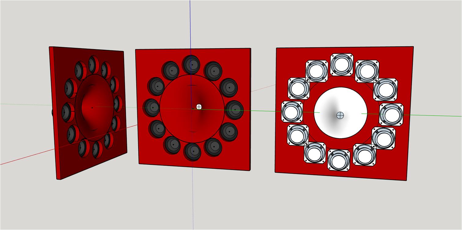

Full range line array for wall or corner placement

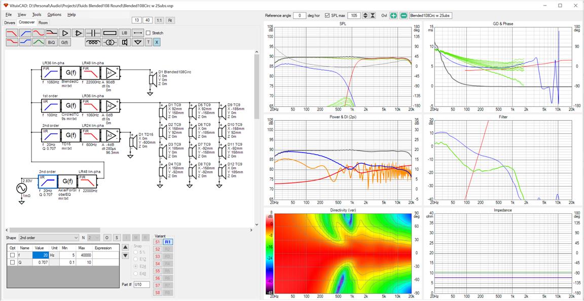

BlendedCirc on Baffle with TC9s
Not bad looking!
attachment.php
.5m square baffle
TC9s mounted on back on radius 40mm>waveguide

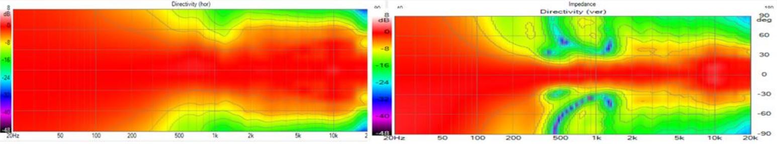

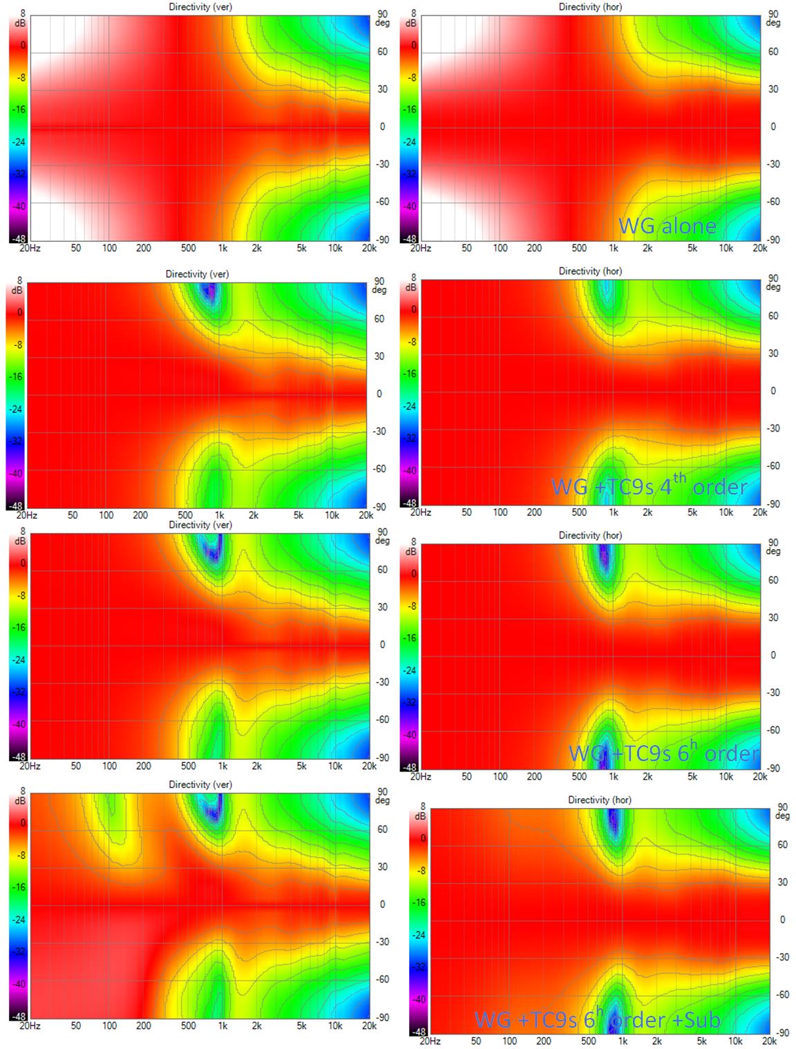

Here are the polar maps. All I did was copy and paste the sandhorn sim from a couple of days ago, pointed to the new waveguide, and repositioned the drivers inward.
attachment.php
The horizontal directivity is great and this is with a 1050 Hz XO, slightly higher which might be a benefit at high spl if the CD has to reach for 1 khz.
There is clearly some work to be done on the vertical directivity. The sub can be moved up or down somewhat and the overlap between it and the tc9s can be played with but what it really needs is an upper woofer or upper and lower midwoofer arrays replacing the TD15

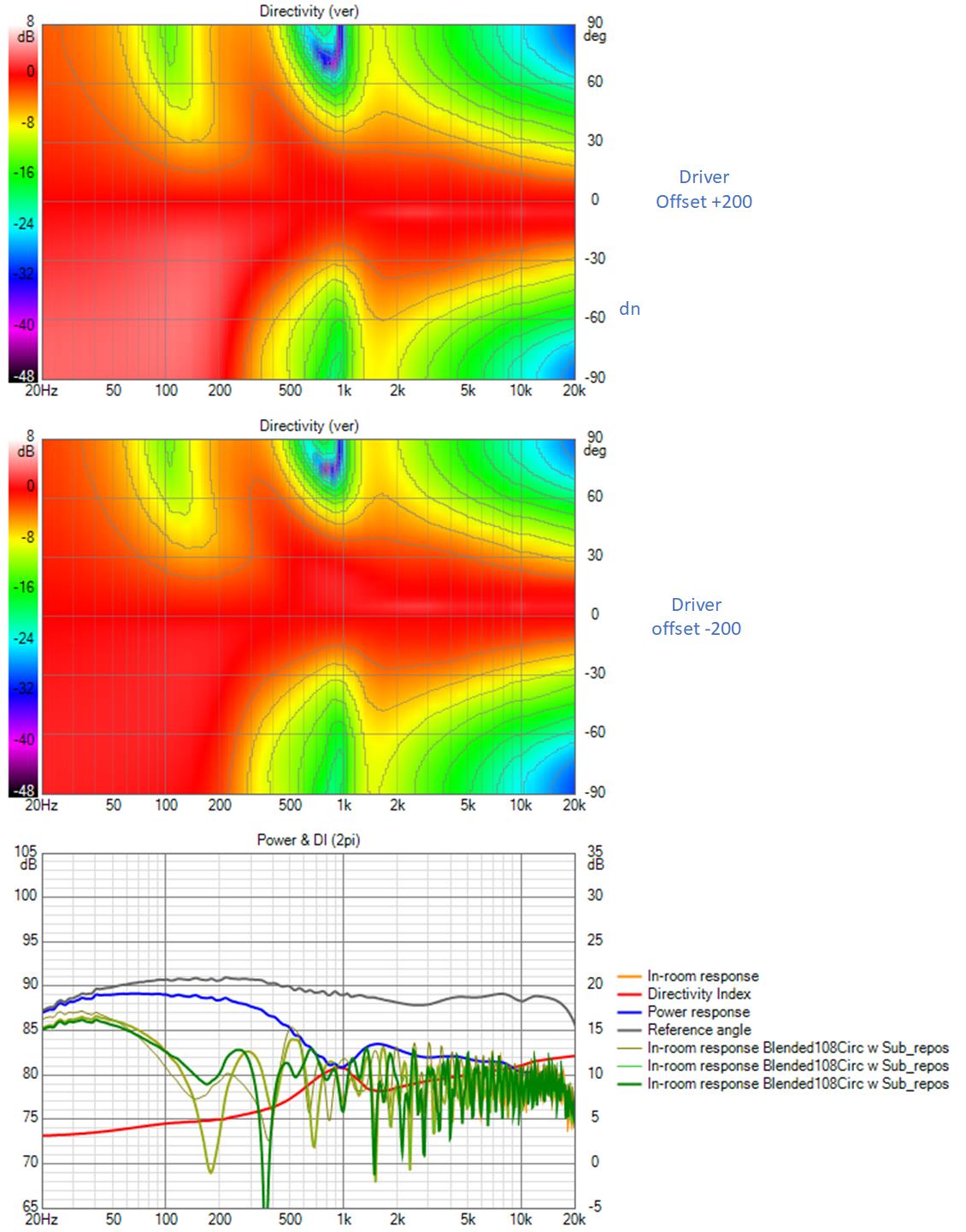

a good question. here is a quick and dirty answer.
attachment.php
The center of the vertical window moves up or down with the drivers but the inroom response still shows floor reflection nulls, as shown in the overlay traces in the lowest graph.
I think upper and lower woofers playing up through 500 Hz or so are needed to fix this.

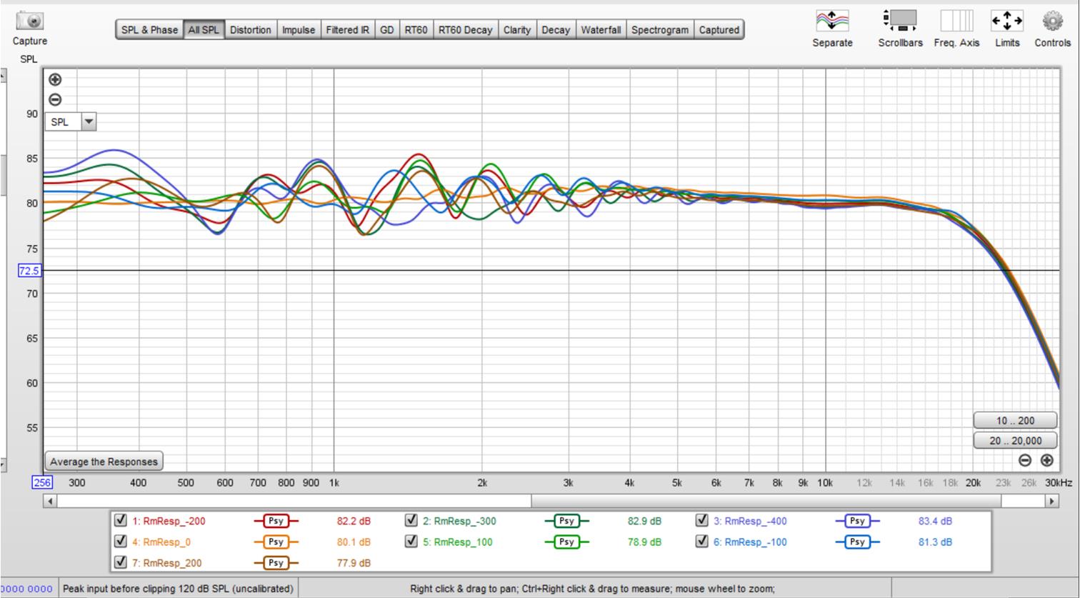

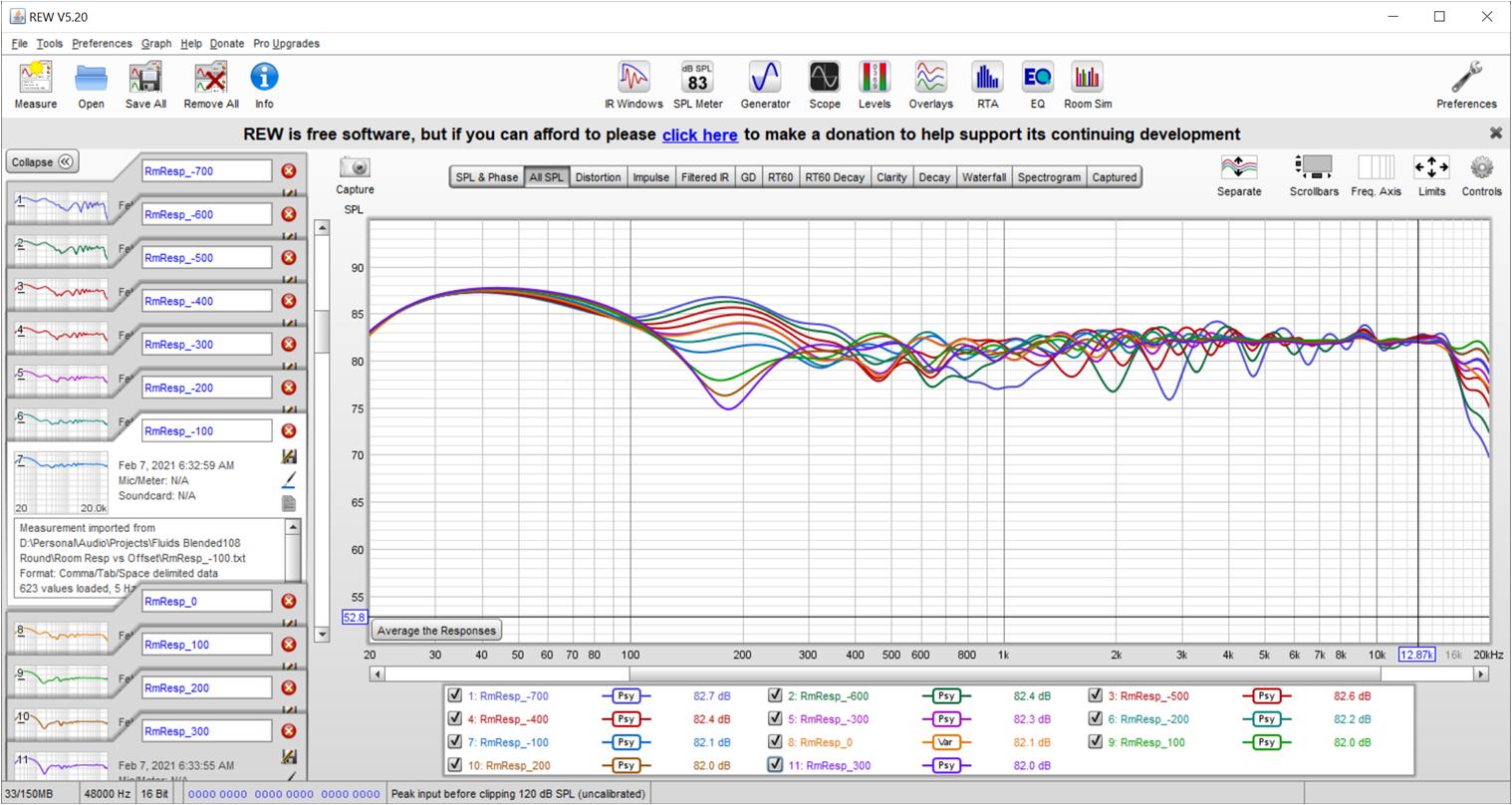

I optimized the woofer height and the overlap between the tc9s and the woofer. This gave me fairly decent vertical polars.
attachment.php
but when I looked at the EQed room response vs vertical offset I saw it had too much variation with the vertical in the overlap region
attachment.php
OTOH the constancy of the directivity in the waveguide range is amazing

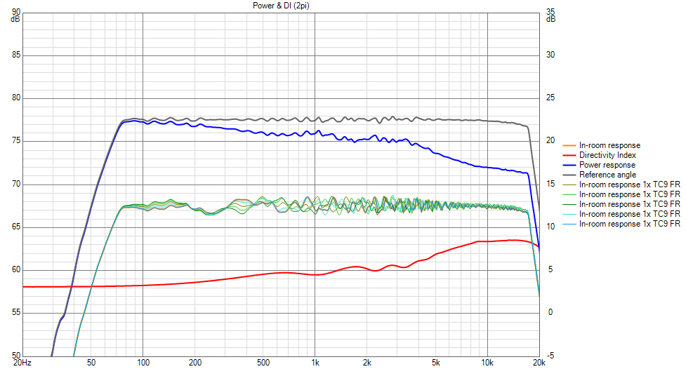

Just a note, If you look at a single TC9, equalized, it will perform as good on that top end as a good horn. It won't have the SPL capability though.
attachment.php
A single TC9, from -200, -100, 0, +100, +200 with floor and ceiling absorption at -20 dB.
But... and it is a big but... For everything below the crossover to the waveguide, I like the results of an array better than what was shown so far.
Way more even/uniform under differing circumstances/heights.
I do think we need the vertical spread of drivers to be able to keep that.
I don't know that I agree with that, the directivity of the TC9 is fixed by it's size and shape, it is neither constant or steadily rising, for a single driver it is not at all bad but it does not have the control of a good horn.

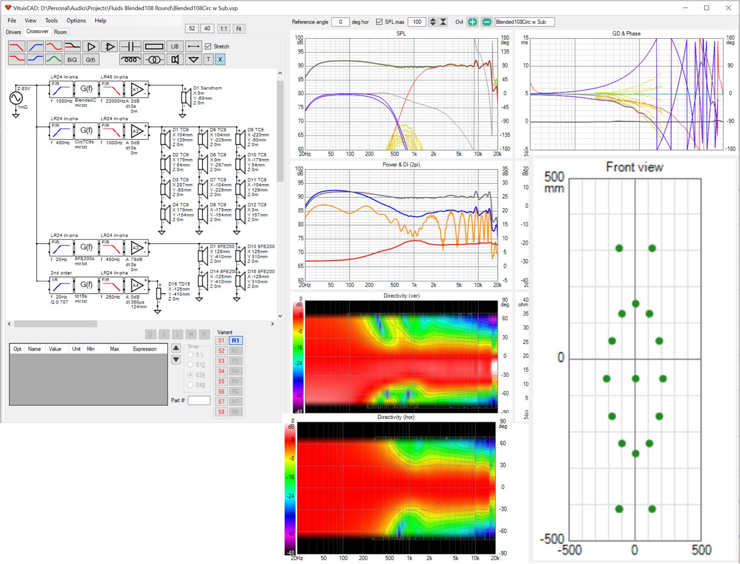

The waveguide needs help in the vertical dimension and thus the circle of TC9s. That wasn't enough help. The next step is to expand the array, replacing the 15" woofer at floor level with pairs of 8" woofers above and below the TC9. These have to be as close as possible to the TC9s to give a good cross to them circa 500 Hz; perhaps 6.5" drivers would have been better. With those added drivers close to the tc9s, the result loses vertical control around 250 Hz and so we will see the room having too much influence there. Putting additional drivers at floor level helps marginally but what is really needed is another complementary pair at top and bottom. So we are back with something as tall as or almost as tall as a line array which stands to reason if you want the same vertical control.

This will show you what I simulated and polar maps.
attachment.php
The equalization isn't perfect but the polar maps are normalized so its sufficient for our purposes.

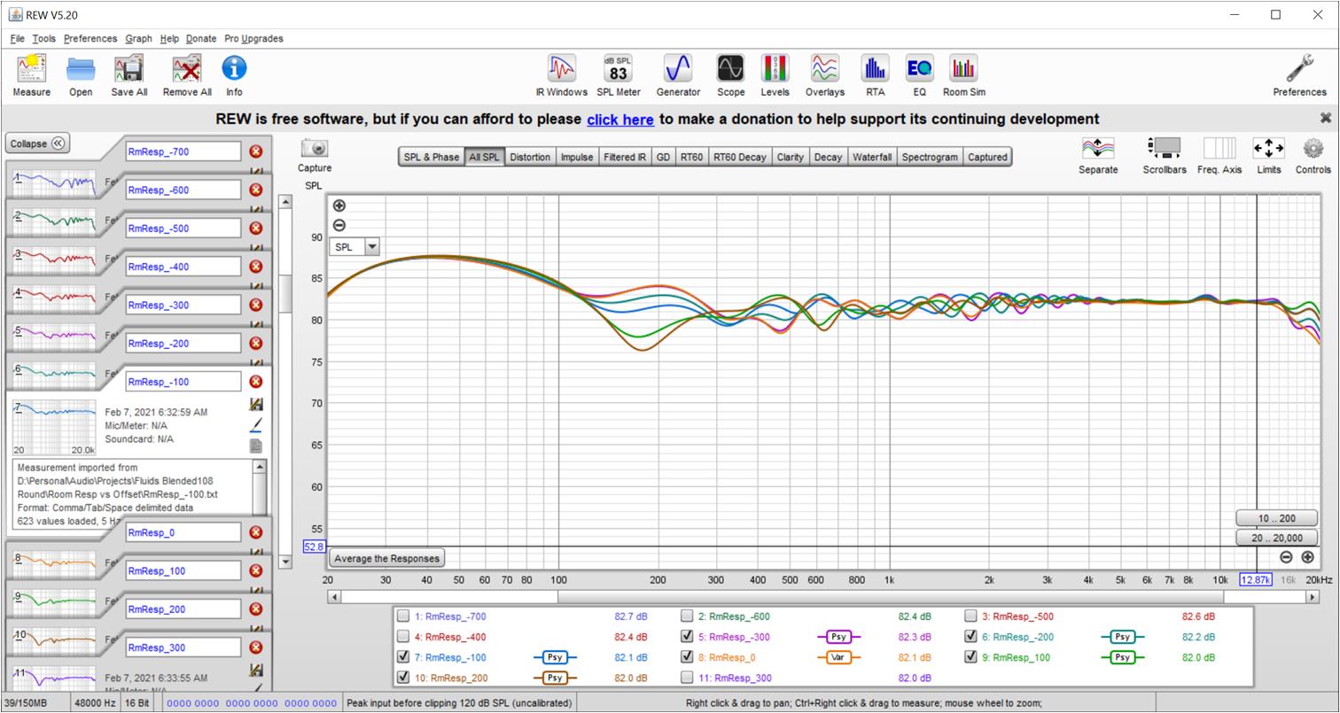

Here are the room responses with vertical offsets, first around the seated ear height and then over the full range of seated through standing
attachment.php
attachment.php
BTW, these room responses were taken with the speaker in a corner, with wall, floor and ceiling reflections enabled and only 2 db of absorption.
I think the 1 kHz ++ range is compelling. Below 1 kHz the room has too much influence; the loss of vertical control around 250 Hz stands out. Fluid has provided me with data on larger waveguide which will definitely help in the 500 Hz to 1000 Hz range. Improving around 200 Hz means making the ensemble taller but that is under the Shroeder limit and the room is going to have its way regardless.
