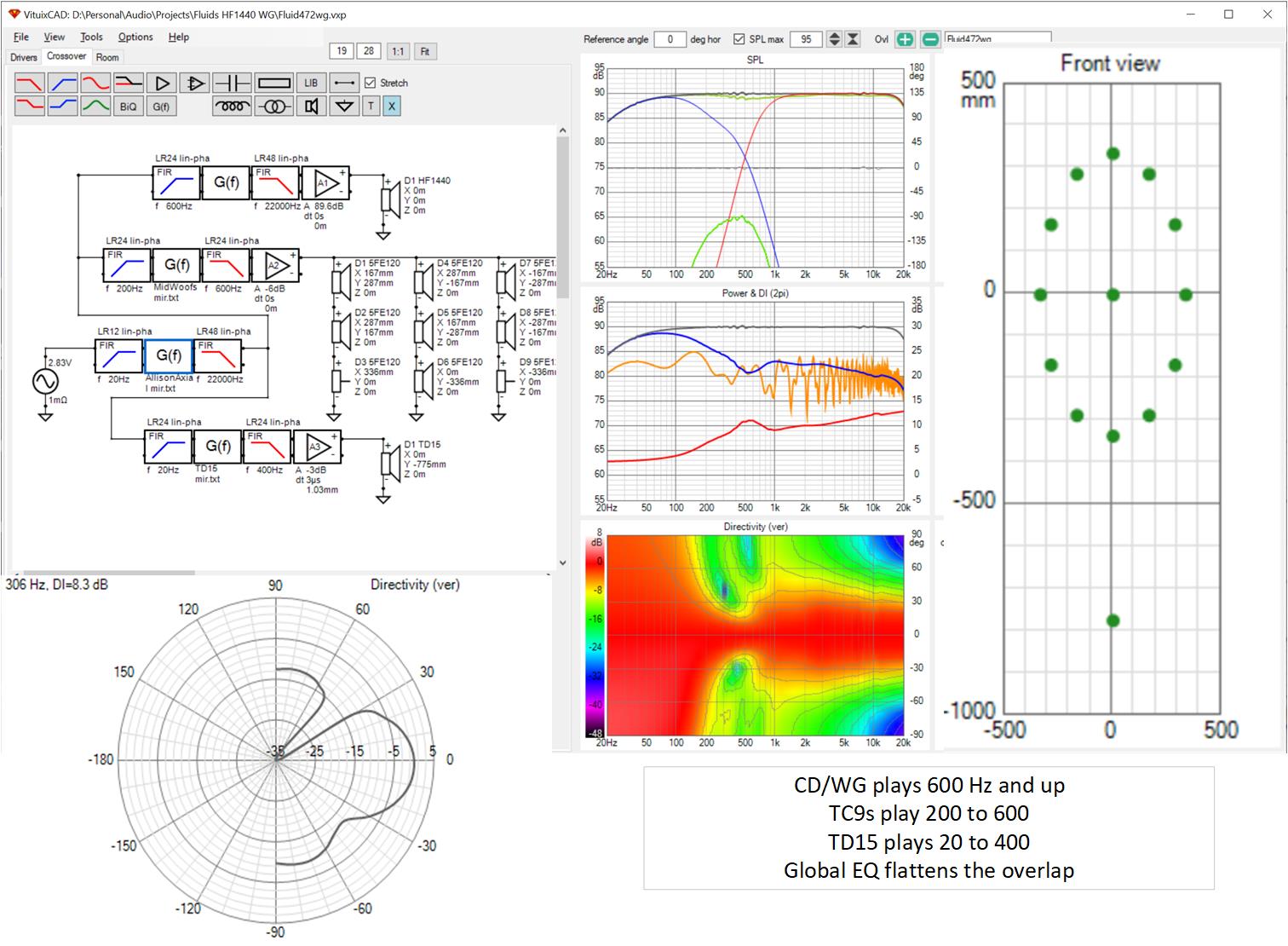

Could you try the Allison arrangement of crossing the TC9's above the notch frequency so only the woofer is contributing and being on the floor would not give a bounce in the same way?
I have tried that and the result wasn't worth showing. I will repeat it (later) and remind myself why. I think there is simply not enough room to work with.
If I don't cross over the wg by 600 Hz, vertical pattern control is lost. That means the TC9s would only get to contribute from say 400 Hz up, not even an octave. And then the null moves upwards with vertical offset...

allowing the woofer to overlap the TC9s removed/moderated the ground bounce null but produced a narrowing of the vertical polars in that region. since then, I've bee trying to moderate the nulls without narrowing the polars. The narrow polars might be the best tradeoff in retrospect

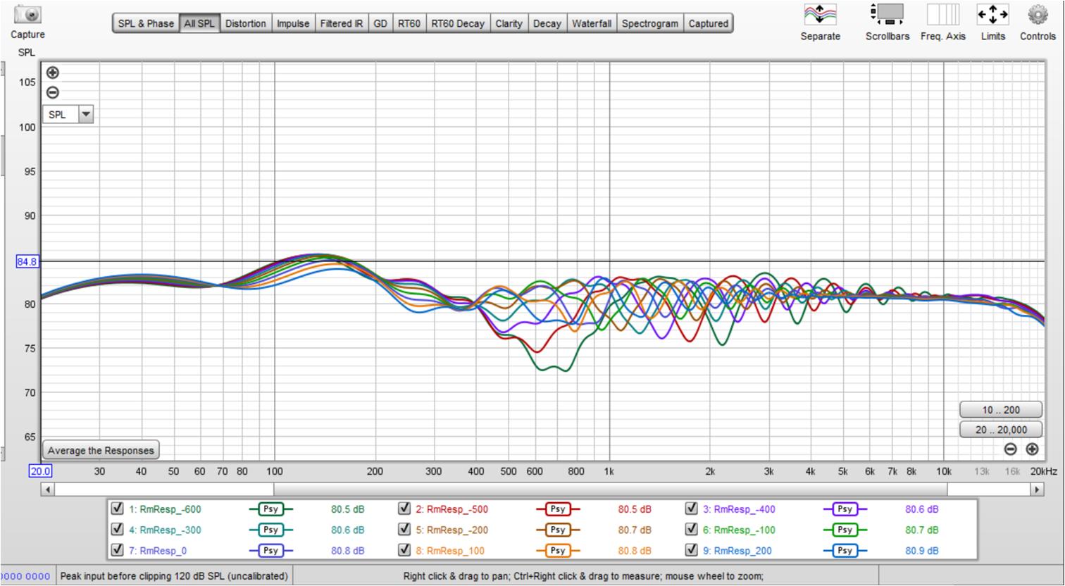

I neglected to flatten the room response before simulating. The bass is amazingly well correlated. The worst is around the 600 Hz XO between CD and TC9s and really bad there just up around standing ear height at the 3m listening distance

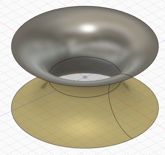

I can see an application for a similar arrangement in a flat baffle or a rolled over waveguide
I think its more about concentricity than about the slit. The slit mostly saves space on the baffle. The concentricity, especially the way I've been doing it, makes the distance from each driver in the array to points along the waveguide axis the same. I've promoted bandpass/slot loaded in the past to reduce CTC, mostly to deaf ears.
I think going to slots on my clock face baffles would definitely improve aesthetics, make for an incremental reduction in CTC, but I would have less confidence in Vituix's abilty to model. Vituix can model a high aspect ratio rectangular diaphragm which could be rotated to tangency to the waveguide rim at each driver location. Vituix accuracy won't be an issue to the extent that radiation from the slits is omnidirectional. It certainly will be at right angles to the slit, so perhaps I should try it.
I like the idea incorporating slits/slots in the rollback of a freestanding waveguide. You would want them far enough out on the rollback so little energy would diffract around and down into the waveguide but not so far as to cause a shadow on axis. The slits can be narrower than on the Genelec if limited to passing to 200 Hz as in my latest or even 100Hz. A system with a free standing roll back edge woofers incorporating midwoofers using a woofer for a stand, with extended pattern control compared to a synergy could be quite attractive.
Re' my explanation
It was simply wrong; applied to some other idea I had discarded. As soon as I looked at the simulation and saw the narrowing of the vertical polars in the low mid range, I realized that I had discarded the idea on that basis alone and hadn't looked any deeper.

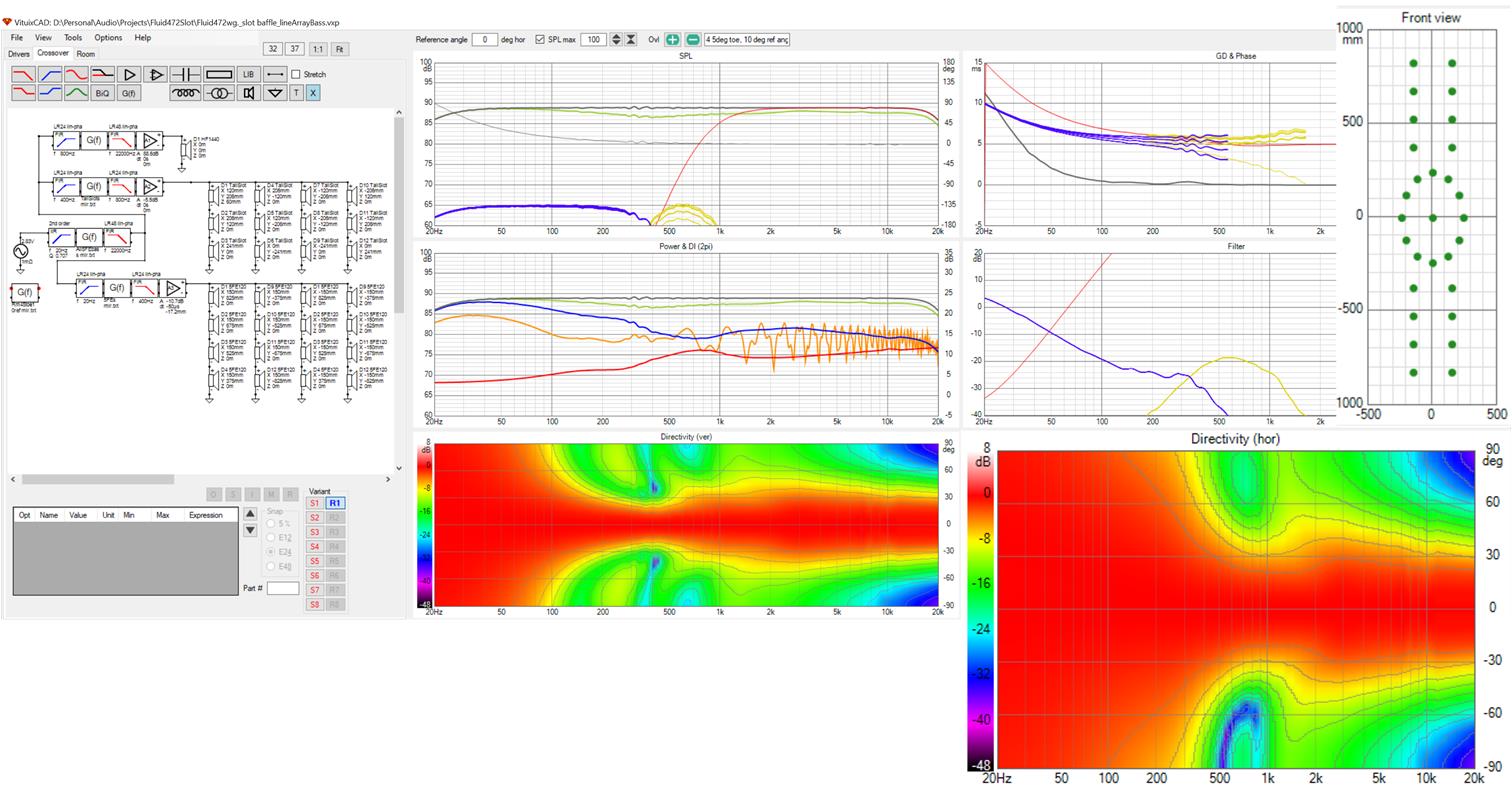

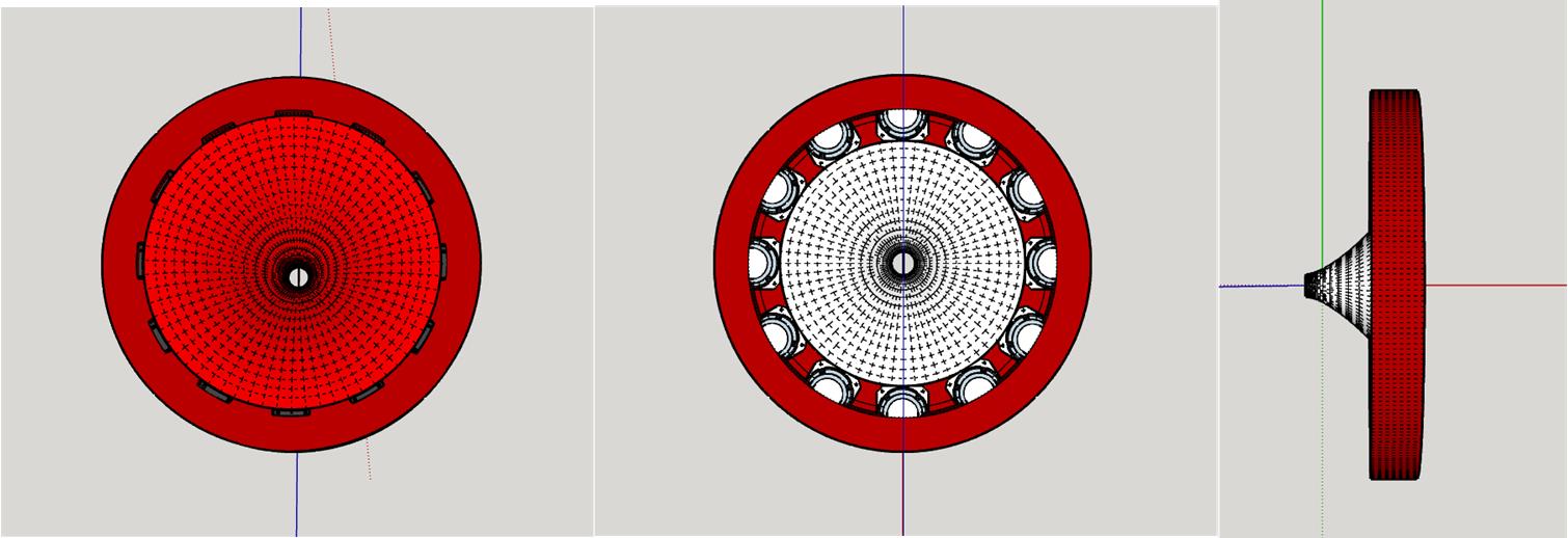

I took a stab at modelling the slot mids in Vituix. Since they are being used in a frequency range where the directivity is determined by mouth dimensions, I modelled the slot as a 10mm wide by 58 mm tall rectangle and placed 12 of them on the baffle touching the rim of the waveguide and rotating each for tangency. HornResp was "OK" with this slot area even modelling and OK with only 1L per TC9 back chamber given 200 Hz XO.
The slots reduced wg-mid CTC allowing me to raise XO to 800 Hz. The mids take over from the wg at a higher frequency where it has better pattern control but don't extend the pattern control lower as did the full exposed cone mids.

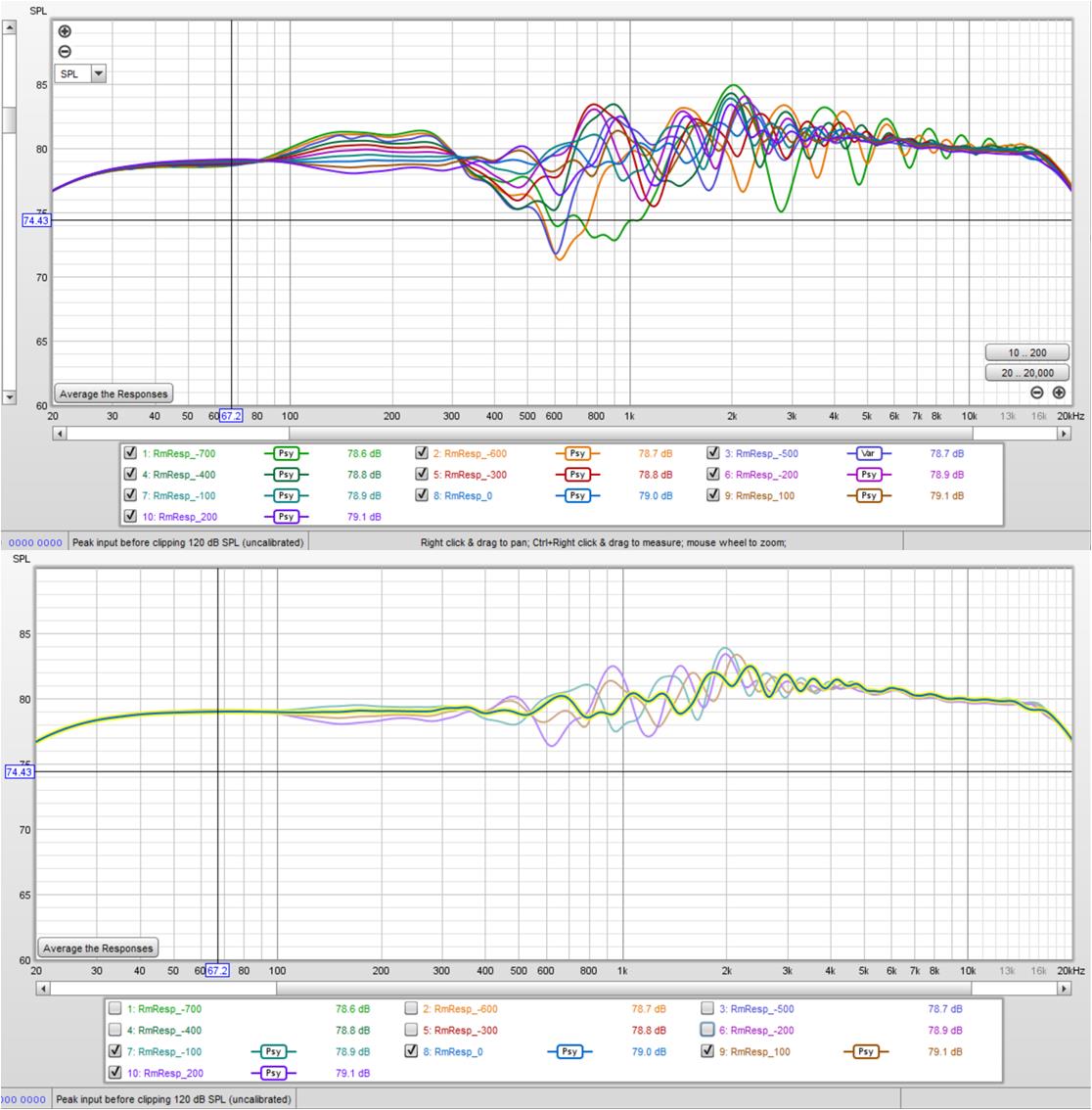

But I still had pesky floor response dip circa 300 Hz. Said dip can be filled with EQ and the EQ holds fairly well for +-200mm seated height variation but I wanted to do better.
I tried line array bass with double lines (to maintain H control) of 5" midwoofers above and below the clock face. XO to them is at 400 Hz. They overlap the TC9 slots that play 200 to 800 Hz. This seems to have done the trick!
The faint green line in the top graph is the listening window average response for a +- 30 degree window. It shows that the narrowing in the midbass of the vertical window isn't problematic.
You can see driver placement on the baffle in the far right of the composite screenshot.

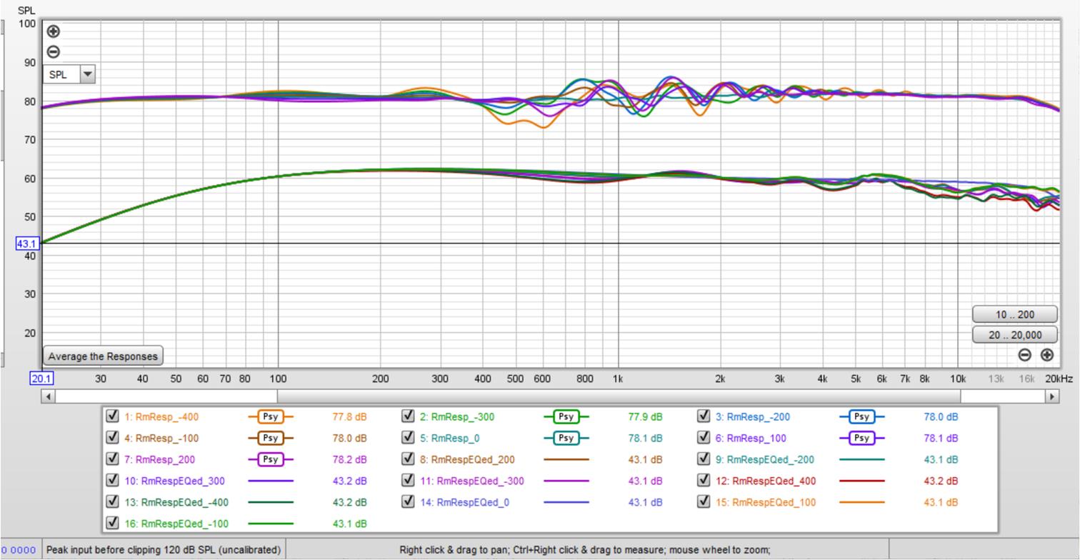

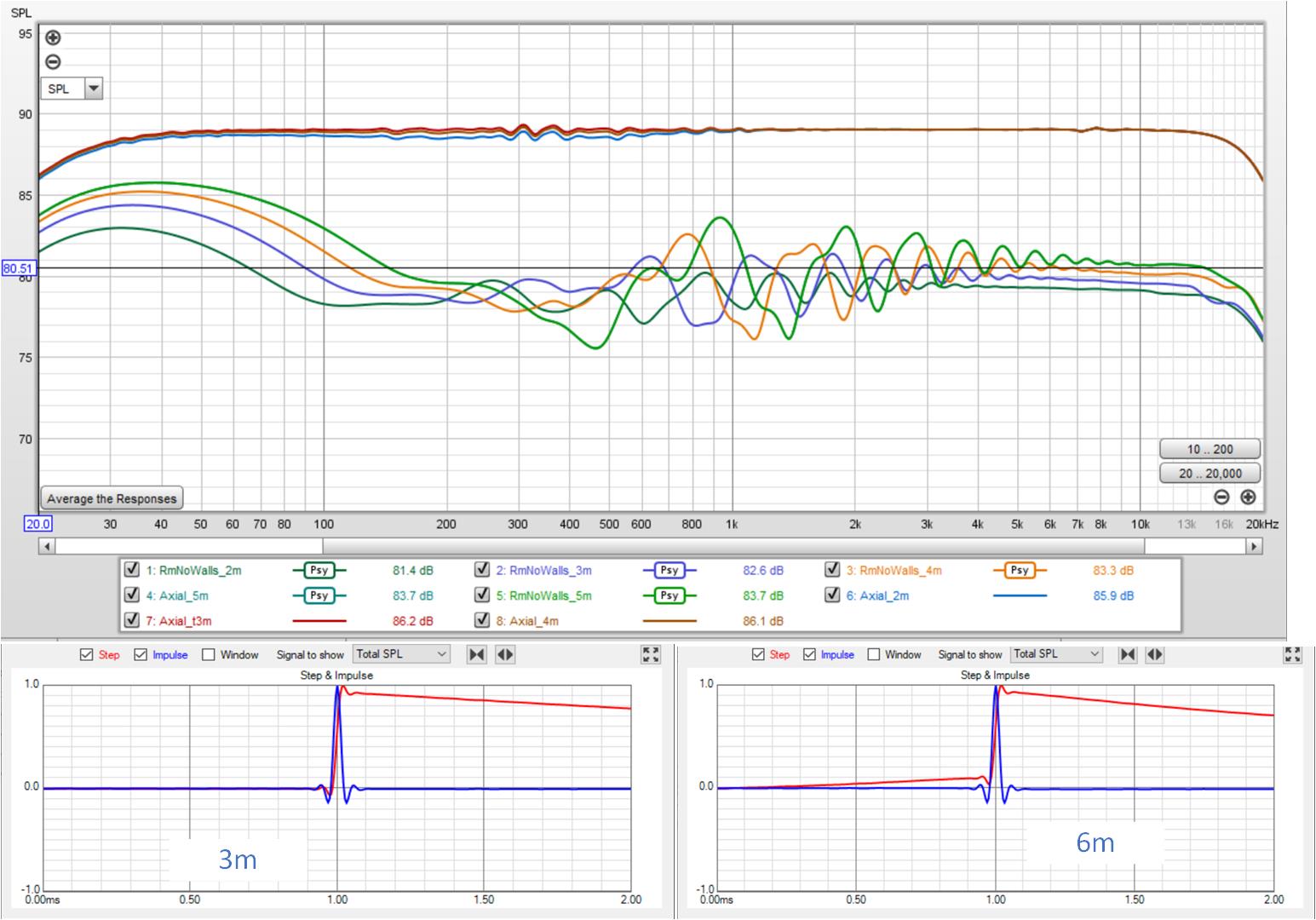

Here are the room responses for a tight in corner location without absorbers on the wall.
The 300 Hz dip is completely gone. There is more variation than I would like in the 500 Hz to 2 khz region. This is entirely doe to reflections; simulated anechoically the response is as clean as the waveguide's abec simulated response. The XO between wg and TC9s even holds over vertical offsets.
pay no attention )) to the 3db hump circa 2 khz. I forgot to smooth the room response in REW before using it as an equalization reference in Vituix

Responses vs listening distance
Since this has array bass and monopole top end, let's look at response vs listening distance:
top group are the direct beams; bottom group includes the smoothed room responses, 2m-5m listening distance. No wall reflections included, just floor and ceiling
