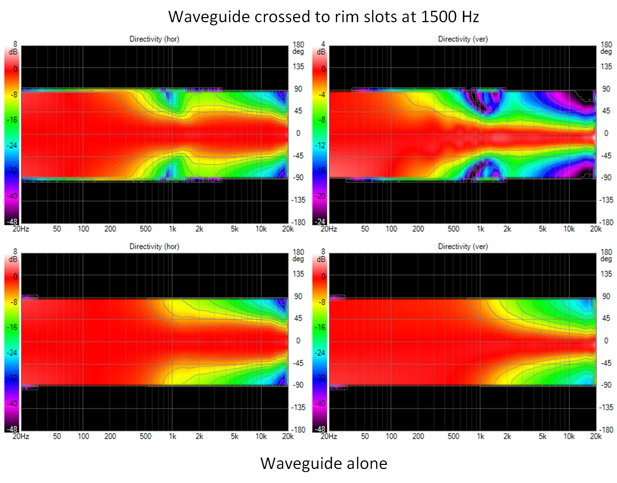

This the part of the response where the waveguide can be seen to be losing vertical control, it is fairly smooth and not sudden but it does start quite high up. It's one of the reasons why Earl doesn't like rectangular waveguides.

Here is the waveguide vertical map
attachment.php
It widens gradually as frequency decreases. You've identified the point where the rim slots take control. I would have loved to have moved the XO a little higher to eliminate that fringing but vertical sidelobes start to appear

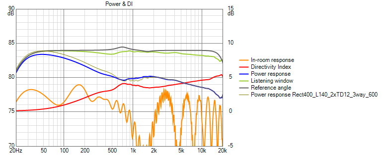

Despite what I said earlier about wanting a high XO. I reduced the belly in the power response near 1 khz by .5 db by reducing WG XO to 1200 Hz.
attachment.php

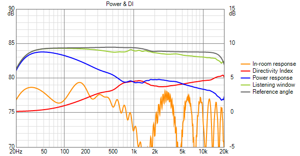

Its not ideal; its a compromise, probably tilted too far in one direction.
I hear what you said about narrowing the horizontal; that may be the one thing left to try. I don't want to go too much narrower; I want at least a 60 degree wide forward beam. Is it the waveguide or the rim slots that need to be narrower? the belly in the PR and the peak in the DI are in the rim slot region

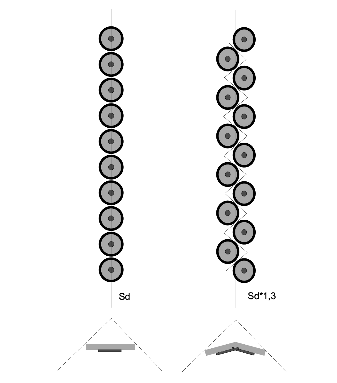

While you are into some funky pattern - what about this? Would it have any benefit from the asymmetry / averaging (?) in the line except for cramming in more Sd on the same height?
that would narrow the H pattern, if that were desirable. Unfortunately, what one would like to do is narrow the pattern down low without affecting its width up top where beaming occurs. Overcoming beaming is one of the reasons, waveguides at center of arrays are considered.

I wouldn't argue with that except for what I see with these rim slot driver arrays. Take a waveguide whose pattern control frequencies are determined by its mouth size. Add a row of small drivers firing through slits on the top and bottom edges of the waveguide, like I did here, and the pattern control frequencies are extended by about an octave for a 10% increase in height.

The images from that post weren't there but I can see more in the ones you posted later. It looks like the main mismatch is between the horizonal of the rim array and waveguide. So either narrowing the guide to meet or bringing in the array. That maybe easier said than done and a compromise might need to be accepted.
There is a vertical mismatch where the array is gaining directivity and waveguide losing it at different rates. A change in waveguide profile or array position might help but you could well end up chasing your tail there too 😉
If there was a way to move the vertical null from the array higher there would probably be a better match without changing the waveguide.
If you let go of trying to control the ceiling a two way with axisymmetrical guide crossing as low as possible to a similar size woofer seems simple and sensible 🙂
You'd need closer spacing from the rim drivers to catch the null originated from the wave guide letting go of the pattern. Which would mean you'd be creating a Synergy like horn to be able to do that. As it stands, the vertical null is in the worst possible spot if you ask me. It is right where the cross talk dip is in a stereo triangle with an averaged sized head.

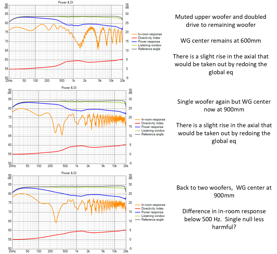

One woofer below is going to have a floor bounce null.

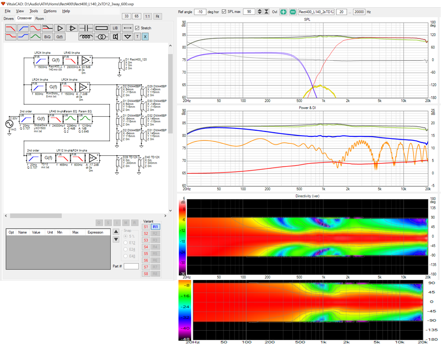

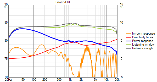

Here is where I am now after optimizing directivity matches as best I could:
attachment.php
This looks a lot better at reduced vertical scale. When the DI is flattened/plateaued in the XOs region, the peak in the axial is 0.8 db, reduced from 1.8 db. Compromising, I'd have a .4 db peak in axial and corresponding dip in the power response.

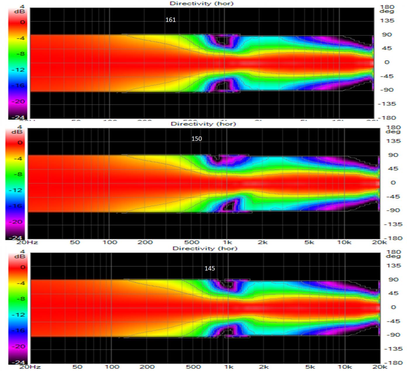

How did I get here? I went to bed last night resolving to walk down the array width in small increments to get the best H match - at the 1500 Hz XO. The differences were small but the best match seemed to be with the outermost drivers at +/- 150mm
attachment.php
Going back to the vertical, pattern I looked for the best match at the XO between the rim slots and the td12s. I looked the 600 Hz XO frequency I started with but got an improvement by incorporating some overlap between rim array and woofers
attachment.php

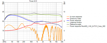

The lower the slope of the woofer low pass, the higher the narrowing of the vertical pattern goes. I put in a narrow slope low pass at 465 Hz, left the original 600 Hz filter in place and made up the energy gap with global eq. This (strangely enough) accounts for much of the improvement.
Chances are I can get a better vertical match by bringing the woofers in closer. They are at the limit given construction constraints for direct radiators. As horizontal slots, they could be closer...I should try that.

I agree though that Vituix predictions are pessimistic, the higher in frequency the more so. That is why I think pushing the first order floor null out past 1 khz by lowering the speaker/array center helps. At that frequency a good carpet has some hope of absorbing enough to mitigate the null but also because it is more likely to be filled in by the reverberant field.
I will go look at your sim of that again (or my own, I think I have a Vituix model somewhere). If I'm going to have a floor null no matter what I do short of a Crumboo or full H-array, that might indeed make sense - but the rim slot array enables a lower crossover.
