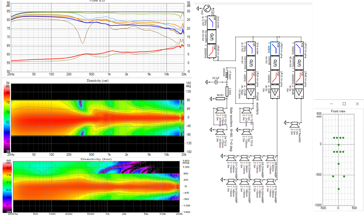

I see what you mean, it does give the impression of something more like the Beolab 90. In the directivity plots the nulls can be moved around, screenshot attached for anyone who hasn't seen it.what claims? "steerable acoustic directivity" seems exaggerated
I like the idea enough to build it with the drivers I already have so a simulation will be the next step. A big round horn with a HF1440 on top of a cardioid woofer box seems like a reasonable ideaIf it does act like the VituixCAD prediction it would work quite well with a horn reaching low enough. (be it a horn with rim drivers or Synergy or just a big (two way?) compression driver)

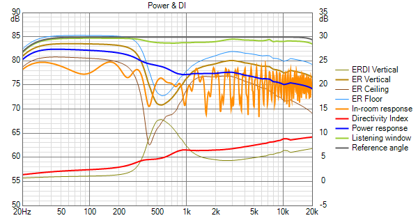

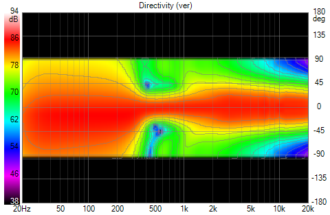

Its not as good as the 20H, 15V listening window curve in the previous posts would have you believe. These have axial and in-room overlays for 0, 5, 10, 15 degrees reference angle:

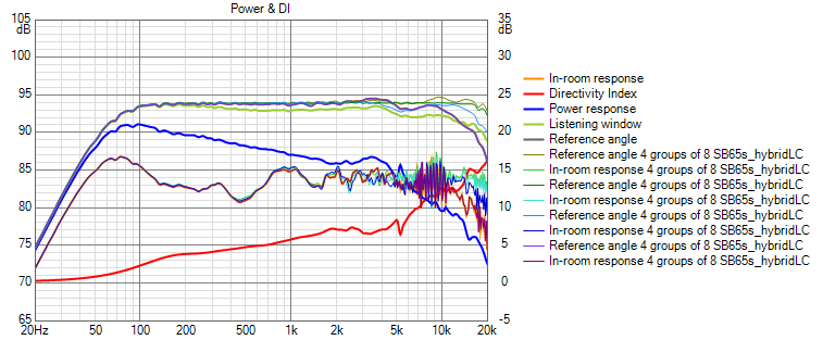

The arrays seem better below 5 khz over the same H window, if I model with 20 db wall absorption. Without the wall absorption, large boundary nulls appear. Above 5 khz the narrowing H window of the array is apparent.

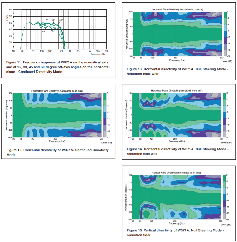

This time it is attachedIn the directivity plots the nulls can be moved around, screenshot attached for anyone who hasn't seen it.
There is some more information and a look at the GLM software and some results as part of webinar on the W371A. The link is to a recording no need to register.

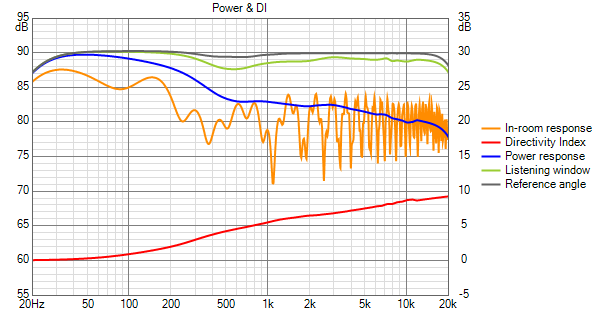

All I've been doing for the last several weeks is trying to get rid of the lumps and bumps in the DI and power responses. They seemed small but nothing I tried eliminated them completely. The question in my mind bcame what is good enough?

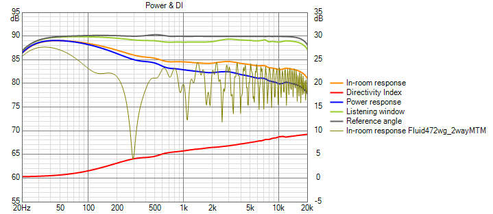

I attempted to answer it by re-looking at a conventional 2-way waveguide speaker to see if it justified all the extra work I was doing. For a W-waveguide-W configuration, 12" woofers at 300mm CTC, I found nothing to complain about except the floor/boundary null.
On my first pass through these sims, my goal was to eliminate that boundary null. I thought it would be easier than it turned out to be. Floyd says quite clearly that its not worth the effort. I wasn't aware of that particular quote but I was aware of the underlying theory/argument as discussed by Wesayso as well as in the quoted text. While I wasn't sure to what extent it was true, I have understood that the primary benefit of line array like vertical directivity may not be listening so much as when taking measurements at the listening position. That is a significant benefit especially if the speaker is large or if doing the kind of DSP processing that W does.
This simulation shows that if you disregard the boundary null(s), (and have a good waveguide) then its not hard to get a smooth DI and power response. With this as a standard of comparison, I can see that nothing I do to ease the room integration should be at the expense of the smoothness of these curves. I've been moving in this direction for some time now. With your two posts, I would say that redirection is complete. Where I will end up, I can't say but I will be steering differently.

The shape of the DI in general somewhere around 3dB per decade is quite similar to the JBL 4349. While that has some odd crossover choices which make the measurements look ordinary, the subjective review from Amir was quite positive. This post shows a spin with both horizontal and vertical DI as separate traces.

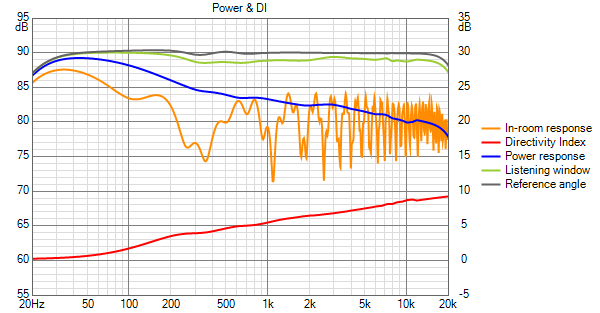

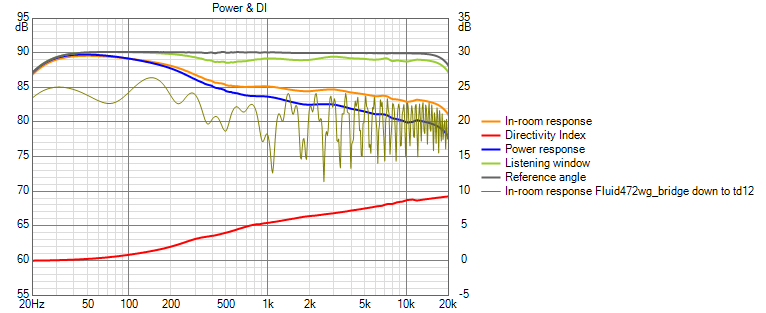

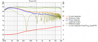

here is what I get with 3 12s in front
Better? not really and not good enough. That deep narrow null in the original sim is likely less audible than the shallower wide dip.
My intention was and is bridge drivers around the waveguide with a big woofer at floor level covering up to where the floor null would otherwise be. The rim slots were supposed to do this but for some reason the rim slots have a rising power response which when joined with the falling power response of the waveguide leaves a hump in the power response, albeit less than 2 db tall

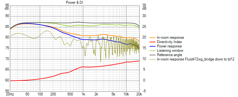

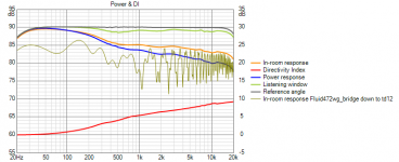

If I change the high pass on the two 12's flanking the waveguide to 400 Hz, I get this which is what it would look like with bridge drivers.
Now the question is what to use for bridge drivers as clearly two husky twelves aren't appropriate; perhaps pairs of 5FE120's, my favorite 5" drivers.
here is what I get using pairs of 5FE120s above and below waveguide at +/-200mm, bridging down to TD12 at -700mm from wg center.
The further up I move the XO to the WG, the better the in-room looks in the 500 Hz to 1 kHz region. I started at 650 Hz and left it at 800 Hz. You can see that the power response and PIR are just starting to develop a hump around 3 khz, like it did with the rim slots. The hump increases its height with XO frequency.
The advantage of the larger axisymmetric WG is that it holds vertical pattern lower than the rectangular, allowing this hump to be largely avoided. The rim slot array isn't able to correct the vertical pattern of the rectangular waveguide all the way up to 3 khz because around 1500 Hz, it develops vertical lobes due to CTC.

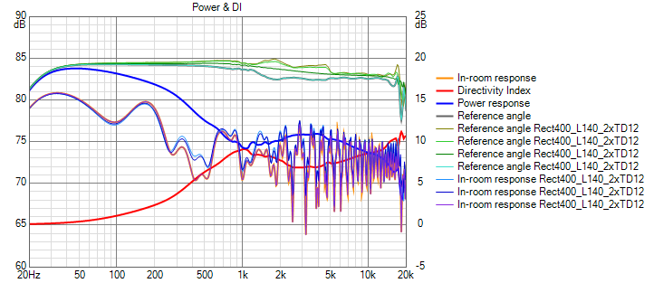

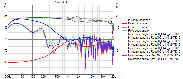

The quad 12" cardioid woofers suggested by Fluid and Kimmo may be just what the doctor ordered used with a waveguide on top
This is my rectangular waveguide with rim slot drivers on top of 2 12" front woofers and two 12" side woofers making for a cardiod response below 500 Hz. The DI has two minor peaks. The one at 300 Hz is associated with a ceiling null. The one near 1 khz is where the rim slots start vertical lobing and cross to the waveguide.

I get a similar but nicer simulated response with Fluid's larger, 472mm dia. HF1440 waveguide and rim slots. The larger waveguide makes for a smoother transition to the woofers evident in the vertical polar map.
I've always like cardioid but couldn't bear the thought of the endless cut and try for passive cardioid. Active cardioid done per Kimmo's hints is more attractive, but it does make for a larger, heavier, more expensive cabinet.
