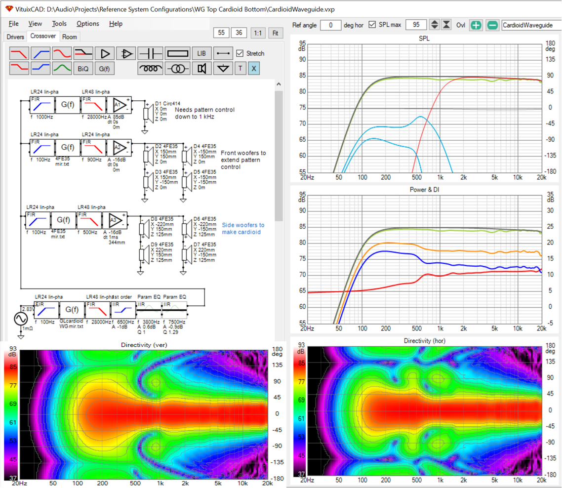

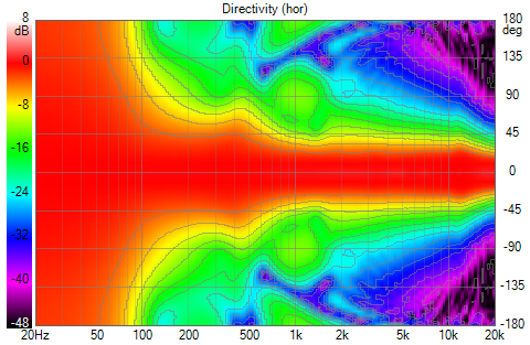

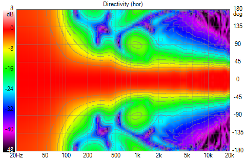

In all honesty, I like the above result (horizontally) better than the second graph showing nulls at the side. The graph right above shows a nice pattern control with even and smooth behavior even further off axis. Which is the energy that would lite up the room.
Horizontally I think nulls at certain parts of the frequency curve could create an unbalance in room sound. More so in the horizontal plane than vertically I would think.
As these are suggestions/sims for free standing I'm a bit surprised how far you intent to use beam steering horizontally. I know/realize I use absorption to get much of the same effect, but I do wonder how wide the ideal pattern should be for a free standing speaker. In other words, it's awesome that you can steer it by that much, the question really is: should you?
That is a very good question...and the answer is it depends. If the main beam is too narrow, then I might need to add ambience speakers. Who do we know that has done that?
I agree that the graph right above has very attractive polar maps (that is what I was excited about yesterday PM but I forgot to press the final button to post it until this morning) and that the cardioid gives impressive pattern control. I did not perceive the cardioid's side nulls below 1 Khz to be problematic, although they might account for the small dip in the power response in the 500 Hz to 1 Khz octave. Even the sim you liked has horizontal nulls to the sides above 1 khz. In fact both sims are pretty much the same above 1 khz, which is to be expected as they use the same waveguide.
As to beam width, I'm between a rock and a hard place. Axisymmetric waveguides have proven superior in these simulations because the rectangular/elliptical shapes lose vertical pattern control too soon. With axisymmetric WG, you get the same pattern for both V and H, which isn't optimal, at least not for a large room. In a large room, you want a wide H and a narrow V. The H reflections will have a long delay and contribute positively to the sound. In a small room, the H reflections would be too early so you go for a narrower pattern. That is the "it depends".

Still think there's merit in the patterns from the graph above. It would be even better if the 'islands' seen beside 1 KHZ would be at ~1850 Hz. Wouldn't hurt to have a little more (side) energy there.

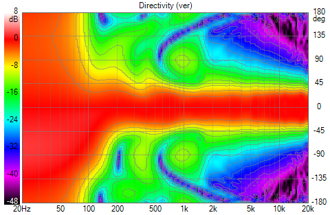

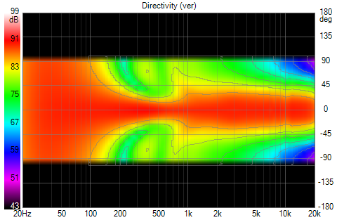

The verticals aren't bad either:
The vertical beam width is higher than I'd prefer in that it just moderates, doesn't prevent a floor null at 3m listening distance
The RECT400 WG I had been using is ~ 80H 40V (or was intended to be) . I couldn't make it a cardioid just by adding side woofers; will try again with different front woofer configuration...

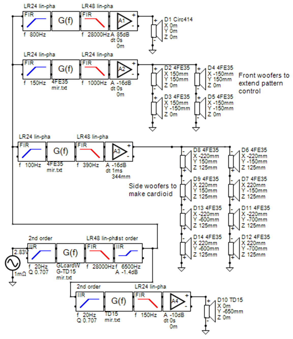

I like the (for me
) relatively straightforward if not actually simple 4-way XO. It is 4 ways but each way just needs to be equalized flat. Delay for the cardioid is done via DSP delay rather than by IIR LPF. Both delay and filter cutoff frequency can be used to fine tune the directivity. The amount of overlap among waveguide, front woofers and floor woofers also tunes the directivity. There is a final global eq to adjust the axial response to target. After equalizing axial flat, I shelve down 1.4 db first order at 6500 Hz to flatten the high end of the PIR, predicted in room response.

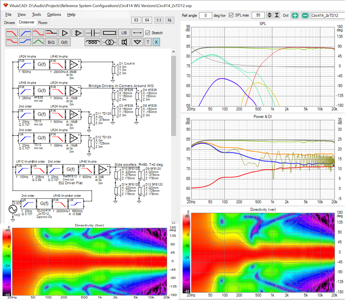

Another day, another iteration on the waveguide and the crossover. In this version, the WG plays 600 Hz up, so the exit has to be 1.4" for HF1440. The 4 front woofers play only 450 Hz to 1 Khz, so they can be as small as DMA45's, for 105db peak SPL. The 15" woofer is moved up off the floor a bit and plays up to 450 Hz, reducing the primary floor null.

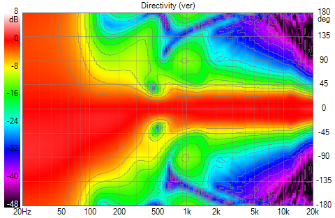

The far off axis nulls have been removed from the H Polar Map
The vertical polar map shows a narrowing at XO but remains tall enough for a good standing response

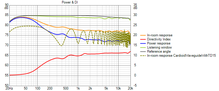

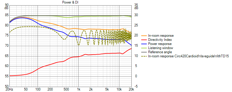

The PIR is flat without tilting axial except in the top half of the top octave. The power response and DI are as good as I've seen. It does narrow at HF, though. There is still a small floor reflection dip, much reduced from the prior version

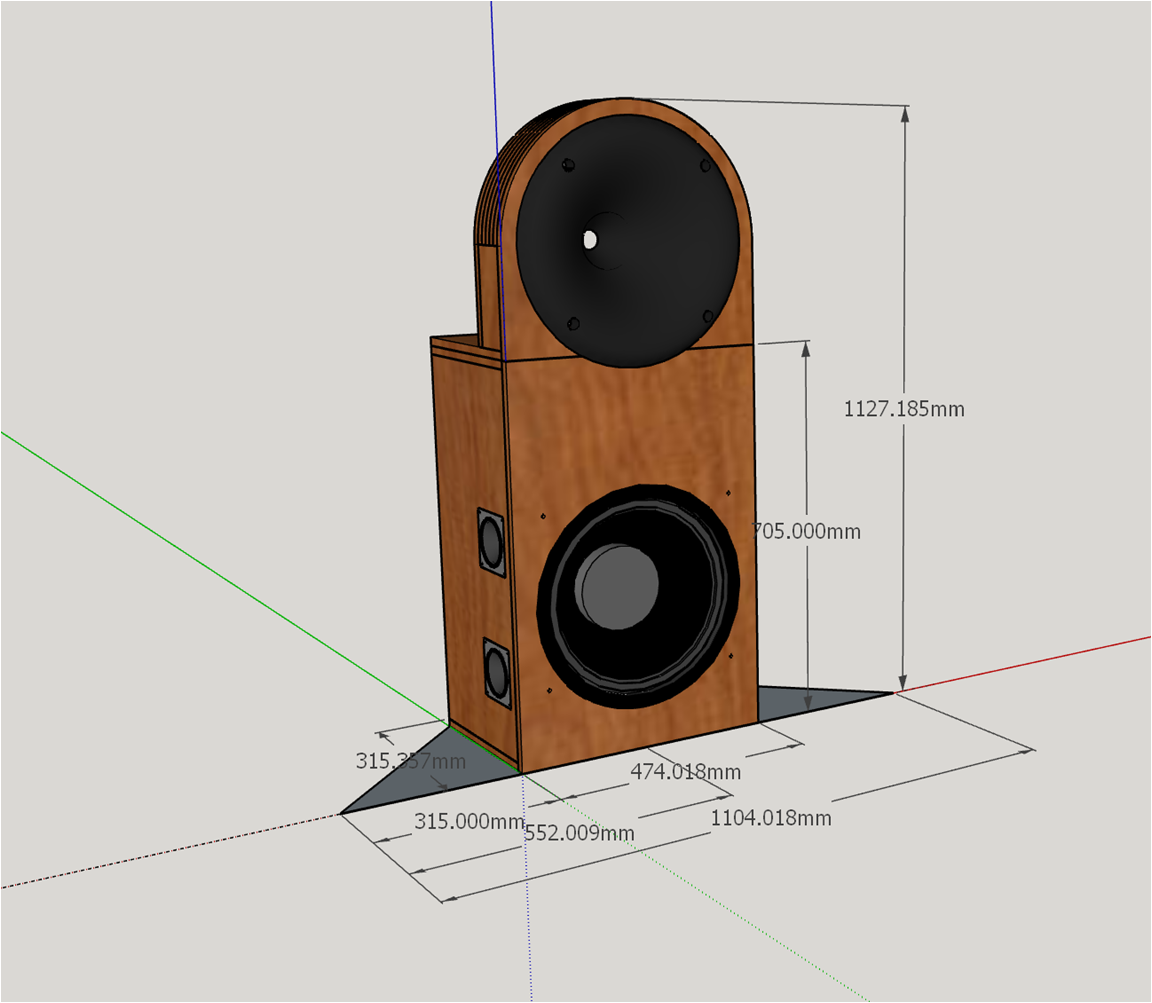

Finally, I have an idea what cardioid costs in terms of footprint. The box is only ~30mm than the corner box and only 315mm deep. It does not sit deeply in a corner though. The interior partitions to create sealed spaces for the 4" side woofers also brace the front baffle.
The waveguide will have a 180degree rollback, the bandpass front woofers will play through holes in the flattest part of that roll back, and (hopefully) the outside edge of the rollback will be outside the outside edges of the woofer....

Vertical narrowing?Big WG with big woofer needs bridge drivers to avoid narrowing at XO due to CTC.

I called it narrowing at XO but better description for this example might be directivity mismatch
This is 12"W - HF1440wg - 12"W at 400mm CTC, crossed at 600 Hz

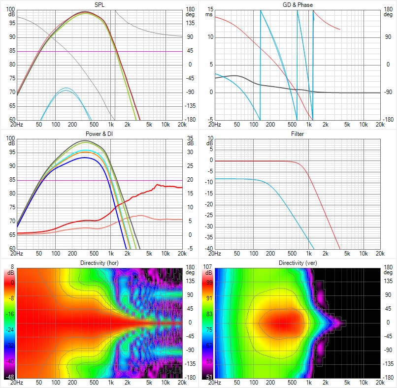

Could you show me a graph of the pattern of the cardioid side woofers just by themselves with everything else turned off?
Yes, that looks good; except for the lack of response below 100 Hz. I didn't want to give that up. Thus the high pass in the side woofers and given they are being high passed, they don't need to be large.

Here are my side woofers playing solo viewed from the front LP

Its matching the vertical directivity of the waveguide in that region that leads to a floor null. The rim driver minimizes CTC. You can then get the vertical directivity you want by choice crossover frequency and slope and overlap of the waveguide, rim drivers and front woofer. I deliverately narrowed the vertical window in the 300-500 Hz region to limit the floor null (post 1338) vs best directivity match (post 1328)

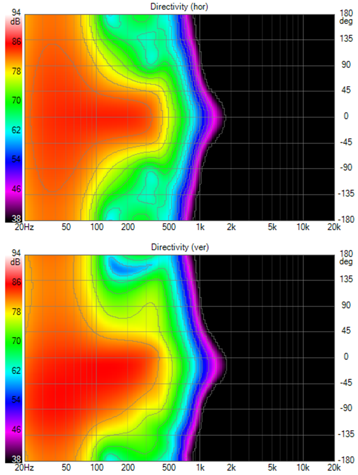

The side woofers allow you to have a cardioid response above 100 Hz while response to the front remains flat down to 20 Hz, or however far you equalize.
Here are polar maps of the front and side woofers playing without waveguide and rim drivers:
I played with the Sketchup drawing today.

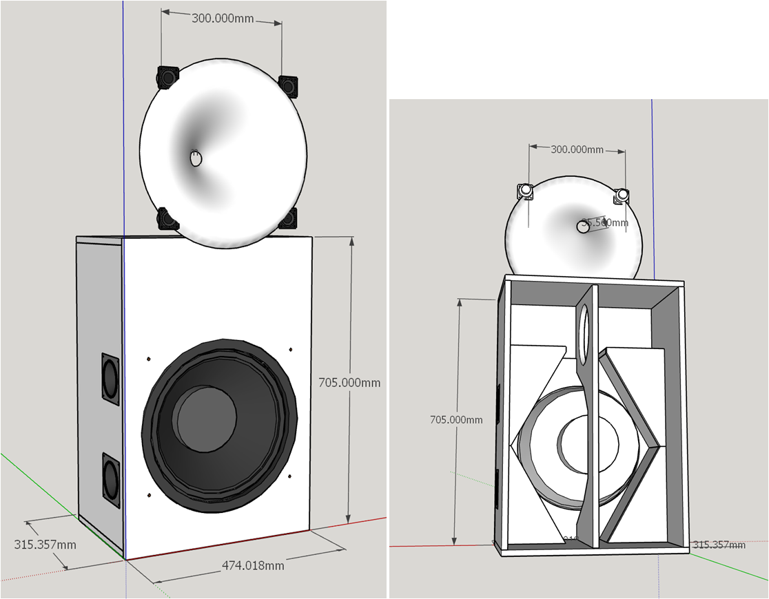

There is only so much you can do aesthetically. I hid the rim driver holes (1cm) diameter in the waveguide roll back and gave the cabinet a round top.
There was room so I upgraded the rim drivers to DMA70, which have 3x the Sd of the DMA45. Will likely use the space behind the waveguide for the computer and amps needed to run it.
The grey triangle shows how it fits in a corner.
