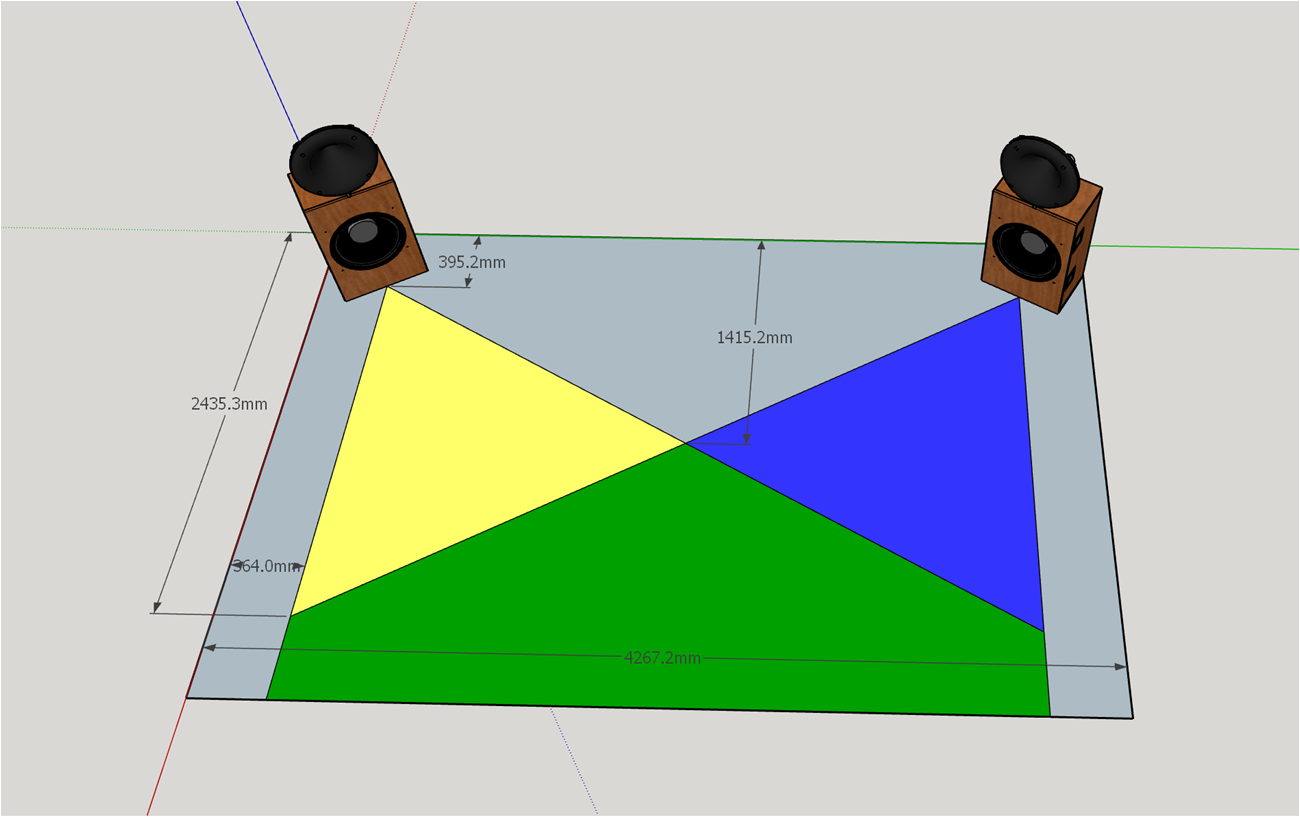

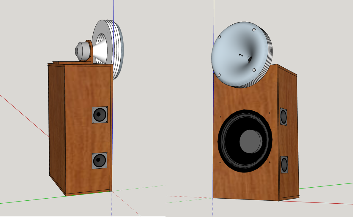

I played with the Sketchup drawing today.
There is only so much you can do aesthetically. I hid the rim driver holes (1cm) diameter in the waveguide roll back and gave the cabinet a round top.
That baffle shape will not work as well as a flat baffle or an actual rollback. Putting a big roundover on it would help, it's the cylindrical shape behind that creates an issue.
The grey triangle shows how it fits in a corner.

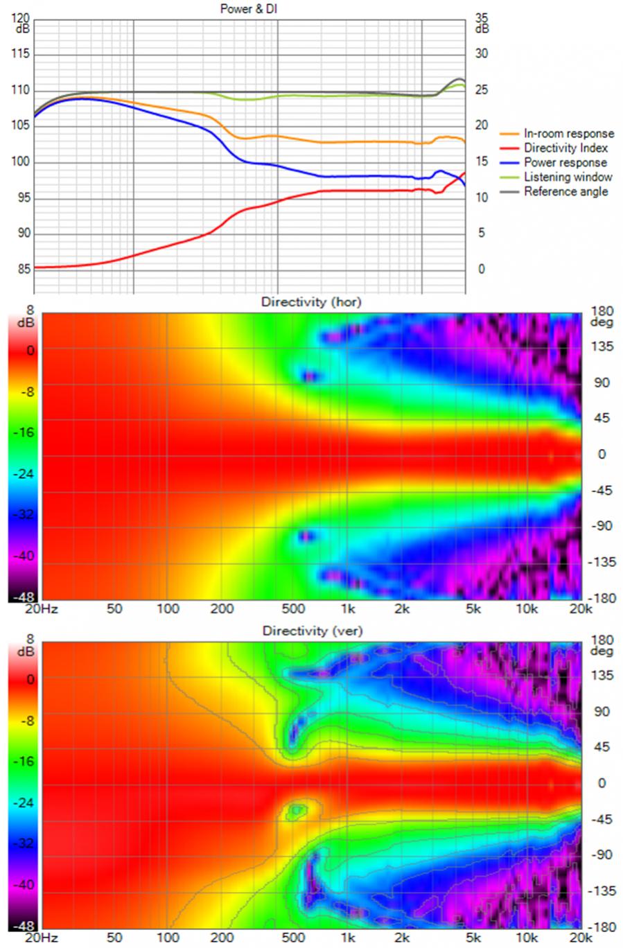

Have you simulated the corner space? I would have thought the cardioid needed some room to breathe.
Yes, that looks good; except for the lack of response below 100 Hz. I didn't want to give that up.
There was no driver EQ, that is the raw response of the drivers in fairly small closed boxes. There is nothing much below 100Hz to keep 🙂 That is where I hoped the rear sub driver would come in. I was trying to keep it simple and get the pattern working as I got all sorts of rubbish the first time I tried. If I did EQ the Faital the natural rolloff of the Sica's Enclosure would probably be enough to made smaller to target it.

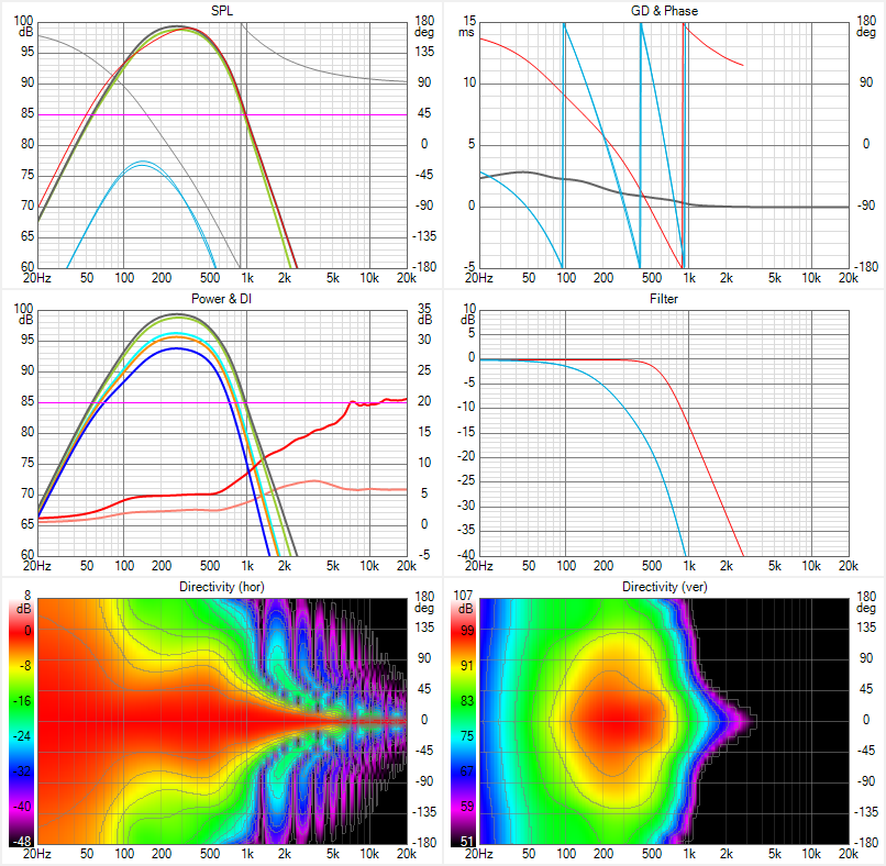

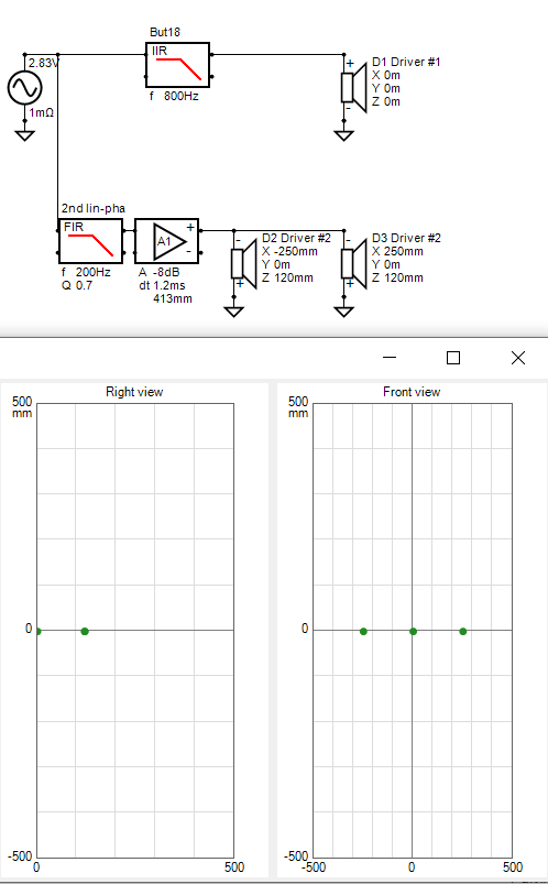

What exactly was your sim? I thought it was just front and rear woofers but your response mentions Sicas. Are you using them on the sides?
Cardioid needing room to breathe? I don't know; I'll have to see. I can give it 1m or so If I have to. Vituix tells me a little bit about operation from a corner but not enough to make me completely comfortable. It would tell me more if I took the time to ask it (i.e. record response over +/-90 degree reference angles)
That sim was a 15" Woofer with two Sica five inch side woofers

As the baffle I had thought about the idea of side woofers being placed either side of a standard rectangular at waveguide height rather than being embedded like you used in one of the iterations.
The depth of a regular enclosure helps to maintain directivity to a lower frequency if you can't use a true rollback. Anything in between simulates like a worse compromise to me.

The previous one was quite mild being not that much different to a 15" woofer by itself and I hadn't cascaded the low pass filters.
This one gets a pretty flat DI over the range of interest but the normalized polar is less pretty. Same arrangement different filters, level and delay.

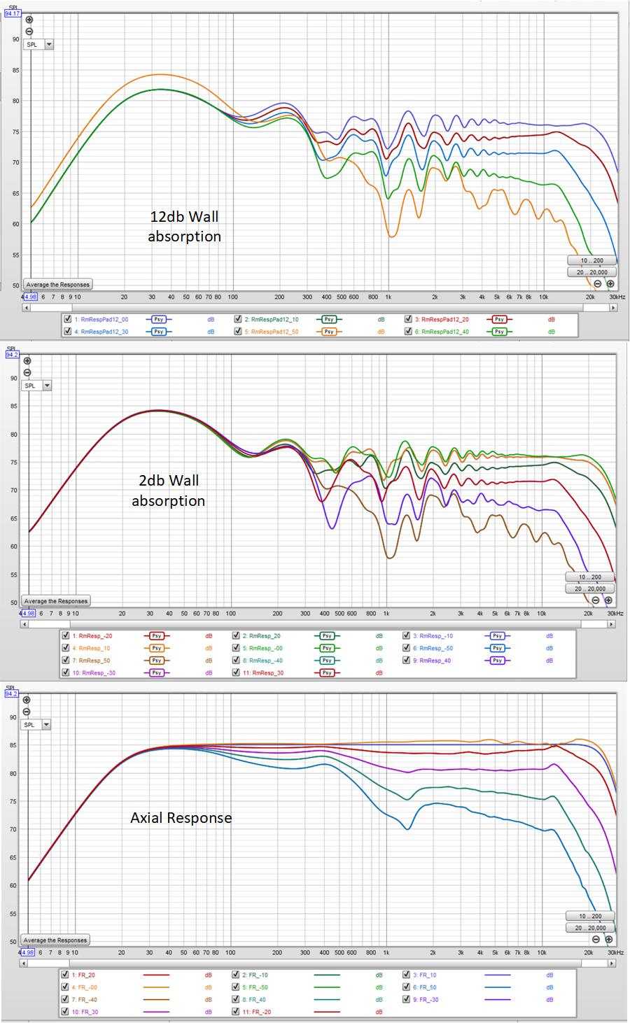

These 3 graphs are Vituix's answer to the question re' the effect of the proximity of the walls. The bottom graph gives the waveguide's response vs angle w/o regard to the walls. Keep in mind its a +/-30 degree waveguide. These are 10 degree steps with response normalized at 10 degrees off axis.
The top graph shows the in-room response with 12 db absorption on the walls. The middle graph is the same but with 2 db wall absorption.
attachment.php
These show I don't need wall absorption as the responses within the +-30 degree beam are more highly correlated without it.

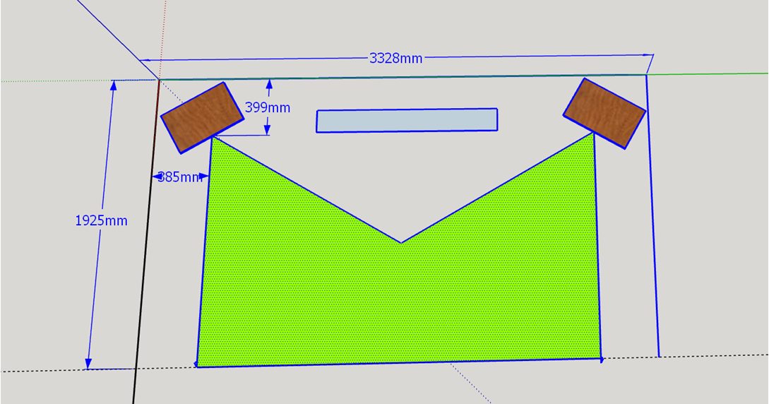

Doing the room response made me think of room placement. The room response was taken with 45 degree toe-in which of course doesn't work with a 60 degree beam. You toe the speaker in so the edge of the beam is parallel to the side wall. With these box dimensions, you find you need to sit with your head 400 mm from a side wall and >~2m from the front wall.

A better room placement diagram:
attachment.php
This one uses the full cabinet image. The rolled back wavelength is suspended 2" above the woofer cabinet almost invisibly. It has 4 rim drivers on its back, playing through the rollback. Those drivers will have 3D printed cups to close their backs.
I deleted the upper side woofers with almost no discernable effect most of which was repaired by increasing the vertical separation of the remaining side woofers.

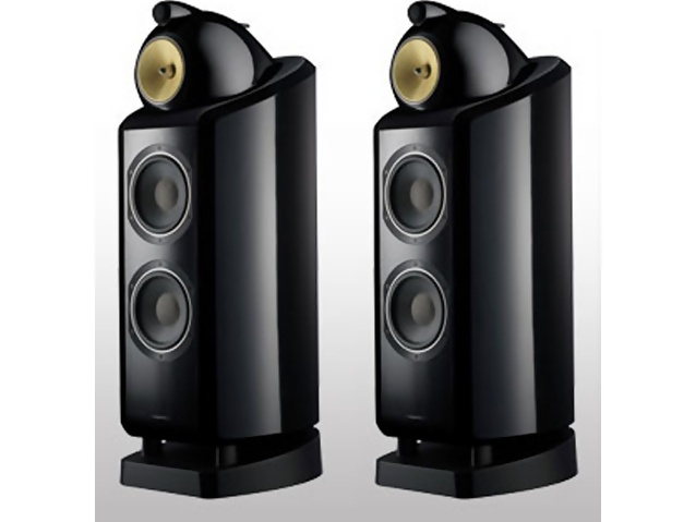

I think a baffle would have a fairly significant effect but I haven't simulated it to have a direct answer. You could angle the woofer cabinet up under the waveguide a la B&W 802 D3. I like the idea of something similar with a waveguide where the mid and tweet is.
attachment.php

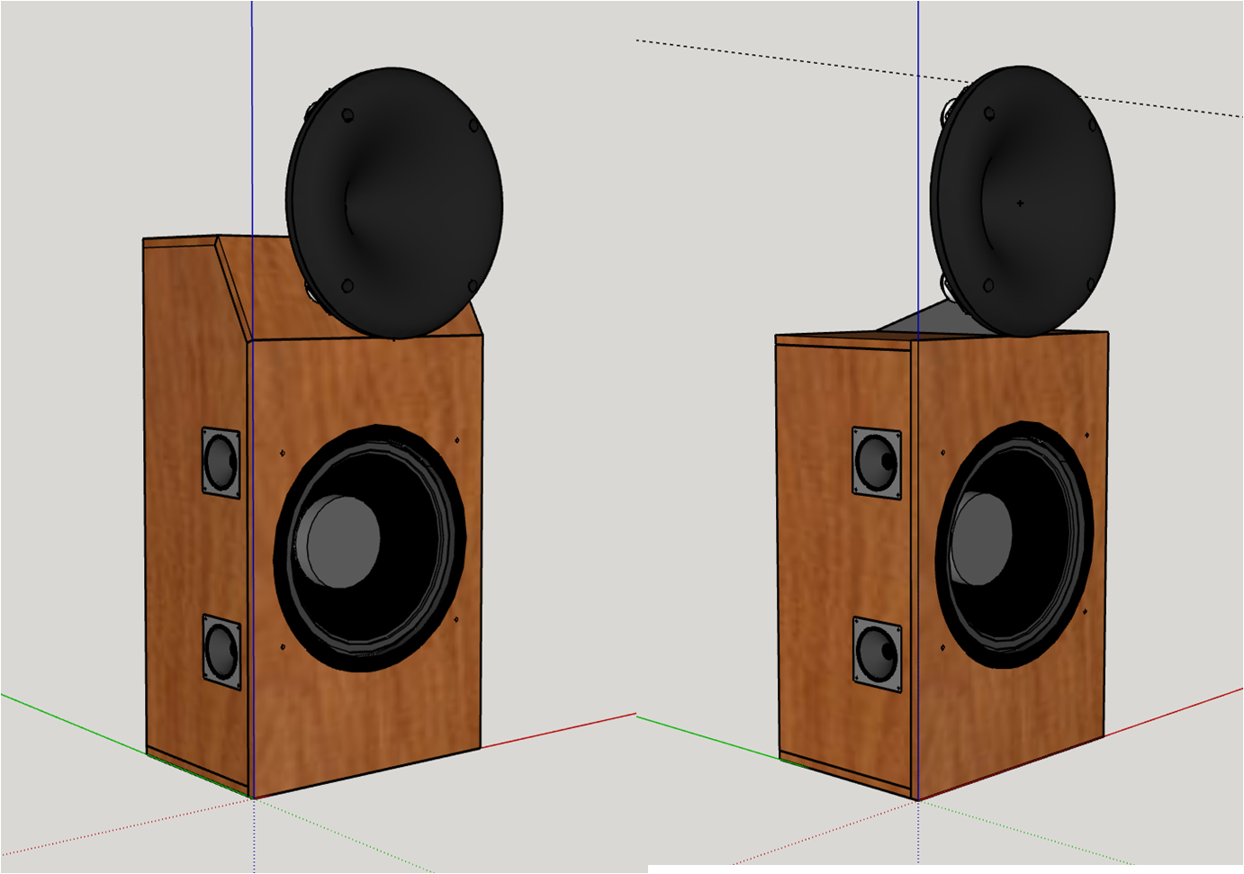

I'm afraid I could never match either of those finishes. When it comes to tilt top vs flat top at my level of woodworking skill, its a question of which is ugliest.
attachment.php
The one on the left needs only about half the power at the low end of the equalization curve but it has a kind of looming presence. I think I'll just buy a bigger amp if it turns out I need one.

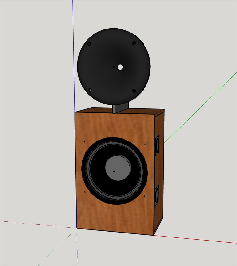

The design continues to evolve:
attachment.php

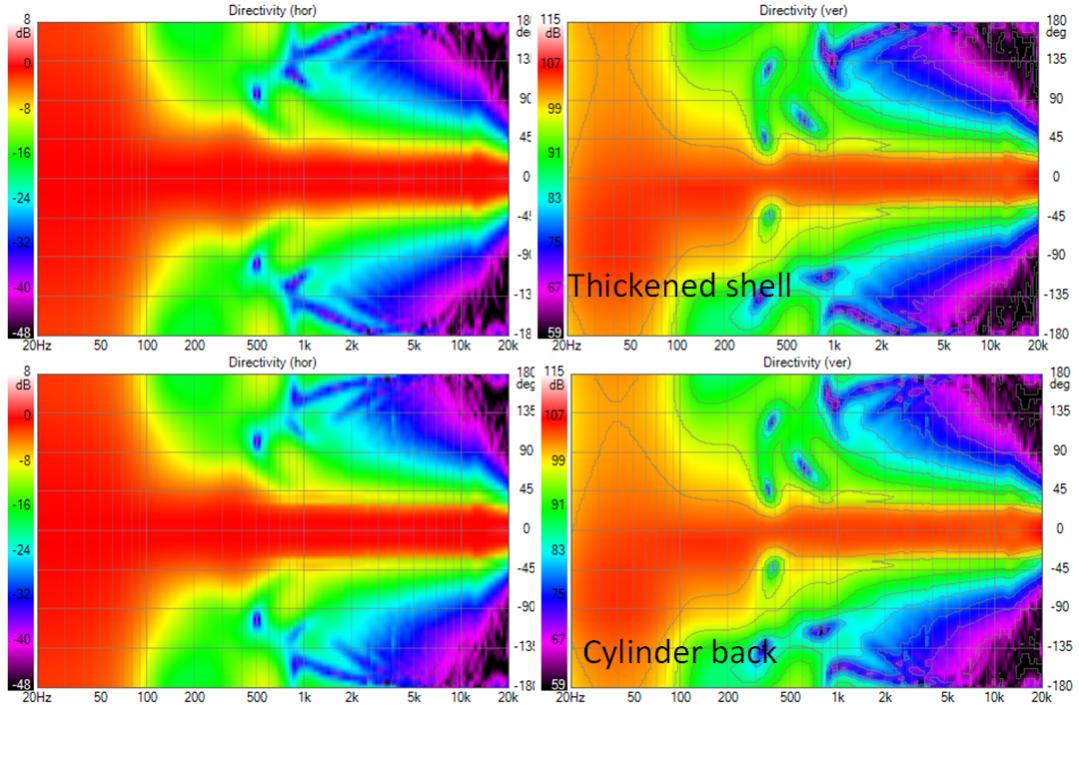

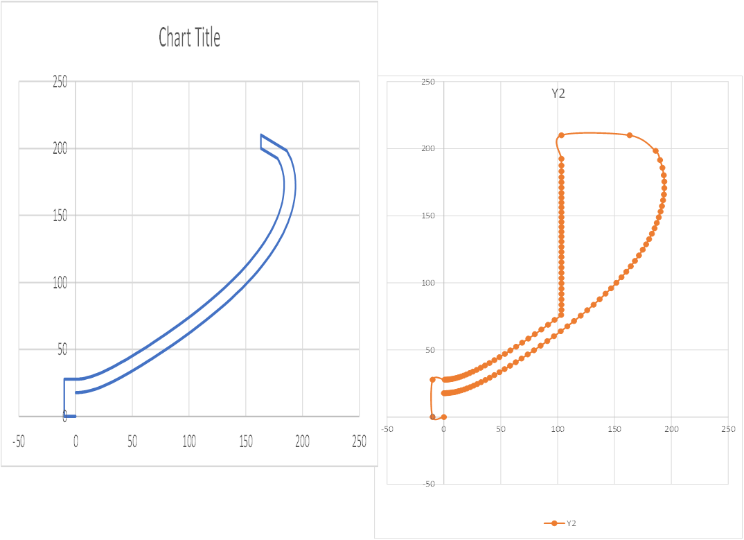

Having drawn that, I needed to model the cylindrical back added to the waveguide to enclose the rim drivers. After several hours in CAD that accomplished little more than learning a little more Fusion360, I realized that all I needed to do was to modify the nodes.txt file that defines the wg profile. This is best done in a spreadsheet where you can graph to see the effect of your changes.
attachment.php
There was very little change to the Vituix simulations, a slight improvement in the H polars:

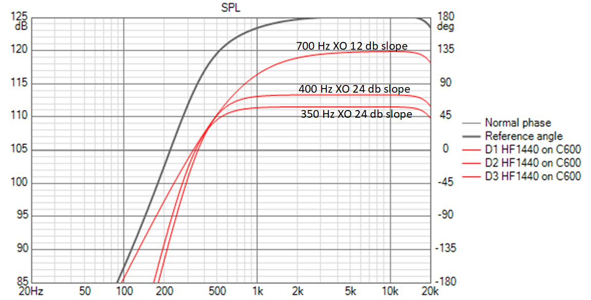

With that bass cabinet and the wg set forward as shown, its possible to use a much larger waveguide, cost and fabrication considerations aside. The sketch is for a 420mm diameter WG. Here are modelled results for a 600mm WG
attachment.php
With a 600 mm WG and a 400 mm woofer, you get a 500mm CTC. The WG alone gradually widens starting at 1 khz and reaches 90 degrees at 250 Hz. The lower the XO, the better as the woofer is less directive; a stack of two of them would be better.
One could run an AXI2050 that low but then needs a 2" exit waveguide. While I was going through this thought process, discussion in ATH thread discouraged use of 2" exit due to HF beaming concerns. This brought up the question of how low an HF1440 could be used in a home environment. That obviously depends on how loud it is played:
attachment.php
At my 80-95 db avg listening level, stress on the driver is well below what would exist with data sheet minimum XO of 700 Hz with 12 db slopes even at 350 hz XO.

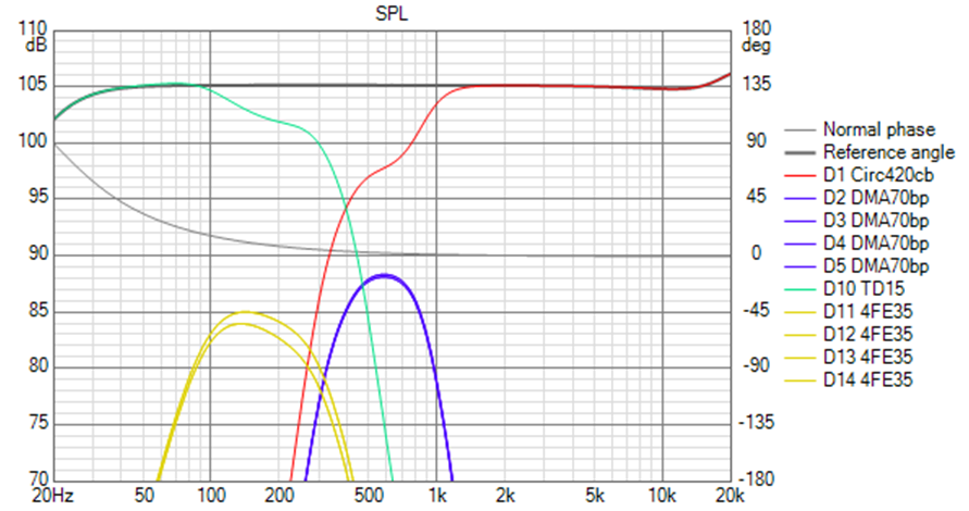

The rim drivers are more of a concern; I still have to ABEC them on the waveguide. Back a few months, I did a sim with fluid's help that showed the rim driver holes don't have much effect on the waveguide's polars. What remains to be seen is how much rim driver energy goes down into the waveguide and is reflected back from the CD's phase plug. With the 600 mm diameter WG, I wouldn't need rim drivers....
what about the rim drivers?

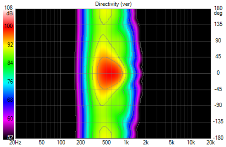

the waveguide has a length of 199 mm. The HF1440's phase plug is right at the exit so the round trip reflection path is twice that for a potential null frequency of 432 Hz. That is right on the edge of the initial pass band for the rim drivers, but I recently lowered the rim driver high pass to 350 Hz, which gave me less vertical narrowing at XO .
I have predictions of the bandpass driver's directivity from HornResp and Vituix Diffraction. From the latter:
attachment.php
radiation at angles more than 90 degrees off axis is about 10 db down. It can only create a ripple in the response, not a null. Furthermore, multiple drivers overlap in this range, allowing the ripple to be equalized.
attachment.php
Woofer and CD cross at 400 hz at about 10 db down. The rim drivers support the CD between 350 Hz and 800 Hz. It looks like the rim drivers are well below the CD in amplitude but that is deceiving. Each of the 4 rim drivers are plotted separately by Vituix, on top of each other. A single trace representing their sum would be 12 db higher. The support by the rim drivers makes it safe (and sound) to operate the HF1440 with such a low XO, in addition to the safety provided by not listening at PA levels.
(this doesn't mean I don't need to ABEC the rim drivers on the waveguide. It does mean I don't expect to find a problem when I finally get do that sim.)
