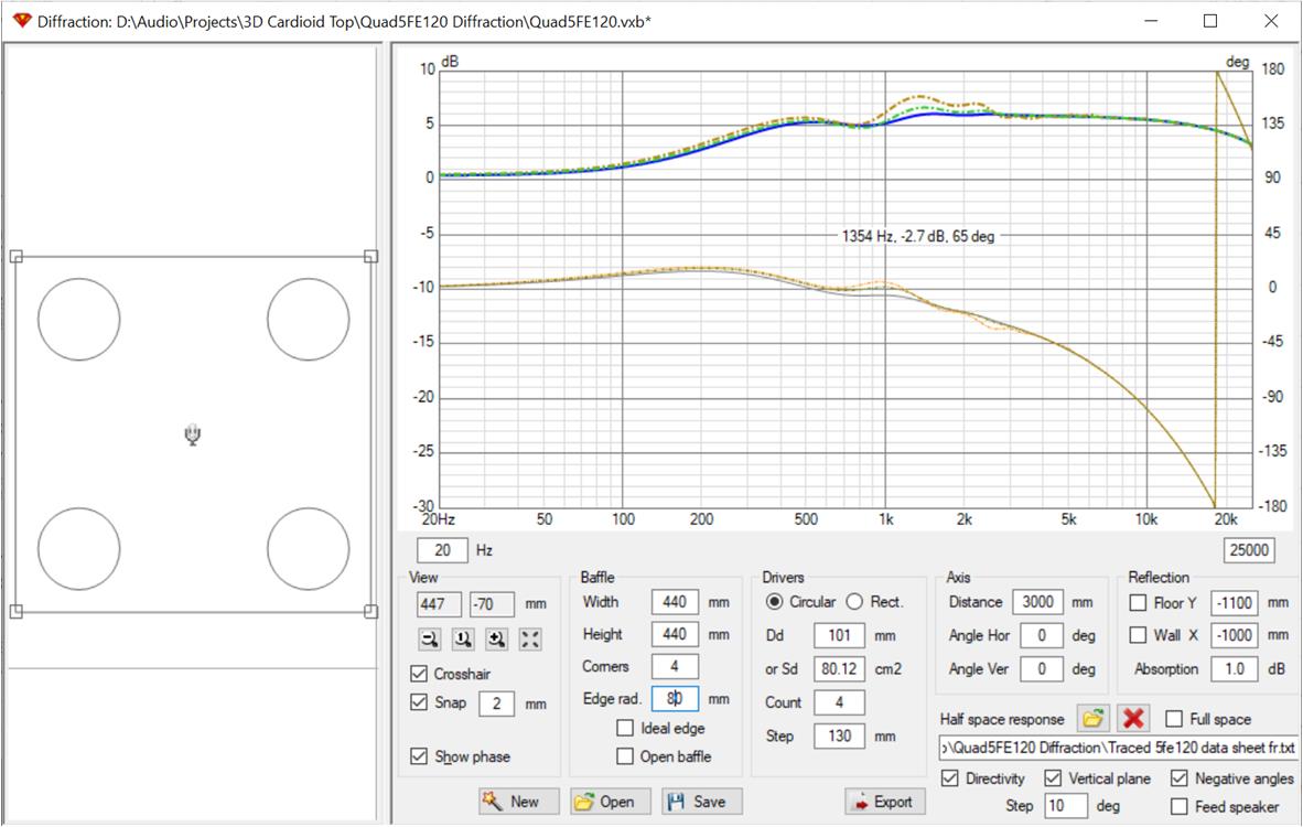

Vituix easily shows how significant the baffle edge diffraction is for the woofers in the current design.
attachment.php
I overlaid baffle step responses for 0, 40 mm and 80 mm edge radius. Below 700 Hz, there is less than half a db of difference and in a region where the room and boundaries have a larger effect.

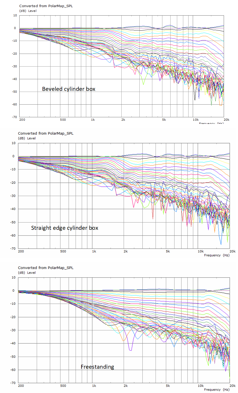

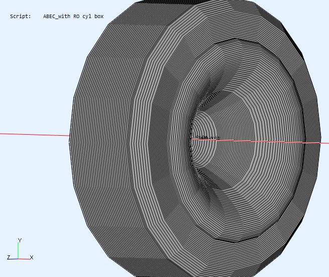

I've redone my sims and the results aren't as bad as I feared, given mabat's results but not as good as I had hoped.
I simulated a straight edged cylindrical box and a beveled edge cylindrical box with a 20 mm bevel. This allowed me to stay asymmetrical and avoid all the meshing problems fluid has noted.

I'm not terribly surprised at the results that the response is affected below 2 khz. That is where the waveguide pattern is widening. I am surprised somewhat that results above 2 khz are affected. Granted its only a db or so but still there shouldn't be any radiation going backwards to return from the baffle.
Would a roundover instead of a bevel be any better? Another cup of coffee and perhaps my brain will be up to the challenge.
Would a rectangular box be better than cylindrical? I think so but that is much harder and longer to simulate.

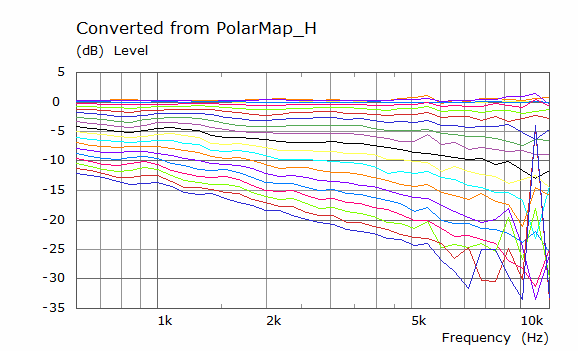

This is what the HF1440 guide I sent you before looks like in cabinet with a 36mm roundover right on the guide as shown before. Above 5k you can see the mesh instability creep in as this is a full 3D sim not circsym.
attachment.php
Despite the apples to oranges issue, I loaded the directivity files of the beveled cylindrical box into the Vituix simulation for the 8-woofer, square baffle box to get a feel for the effect of its imperfections at the system level.
attachment.php
Normalizing to the presumed 10 deg H listening axis, I see a +1.5 db, -1 db variation over a 20 degree H listening window.
Equally if not more disturbing is a 2 db bump in the power response and DI around 1.5 khz and a slightly smaller one around 3 khz.
Perhaps as Kimmo suggests, the box shape (including the waveguide and RO vs terminated in baffle) can or must be tuned to optimize the directivity. I think terminating the waveguide in the rounded over baffle will definitely look better at this level but then I'll also have to deal with a cancellation null from woofer radiation returning from the CD's phase plug....

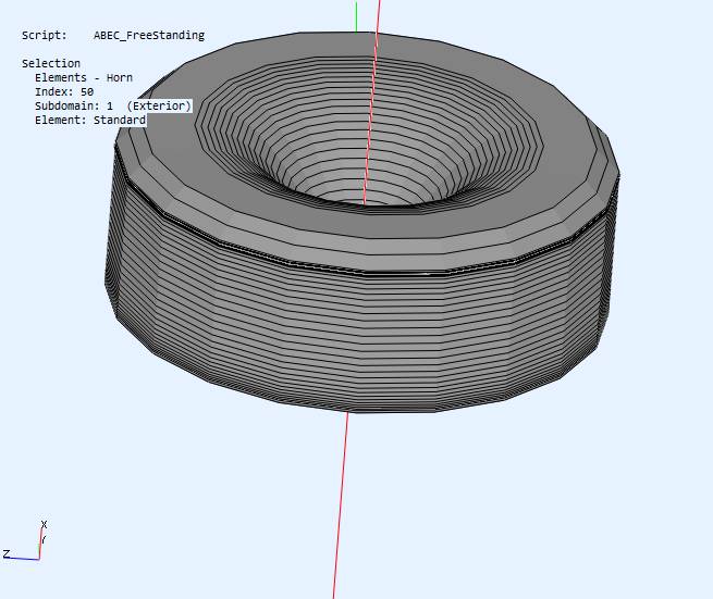

I produced the same diameter waveguide without a rollback and repeated the simulation in the beveled cylindrical box. the woofer ports would be centered in the flat part of the baffle.
attachment.php
That is a 20 mm bevel. Looks like a 40 mm bevel would be better. Diameter would need to increase to support that.

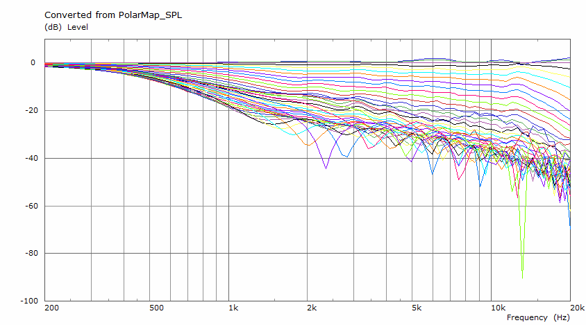

The abec simulation of the waveguide free standing, without a baffle:
attachment.php

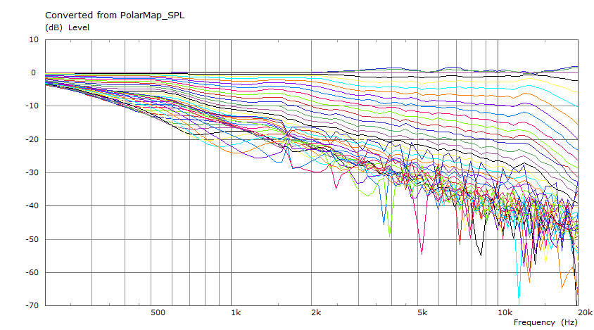

abec with baffle and beveled cylindrical back/box:
attachment.php
Its the slightly rising response off axis circa 1.5 khz that suggests to me a larger bevel would be better.
Finally, pointing Vituix at the directivity files, I get this response:
attachment.php
The power response and DI curves are smoother than for the rolled back waveguide but the polar maps show more pattern widening at 1.5 to 2 khz than I would like. Some of this, I think, is due to baffle step and will be reduced with a larger bevel or roundover. I could also make the waveguide larger to just fit within the rollback. Then I would have woofer ports within the waveguide.

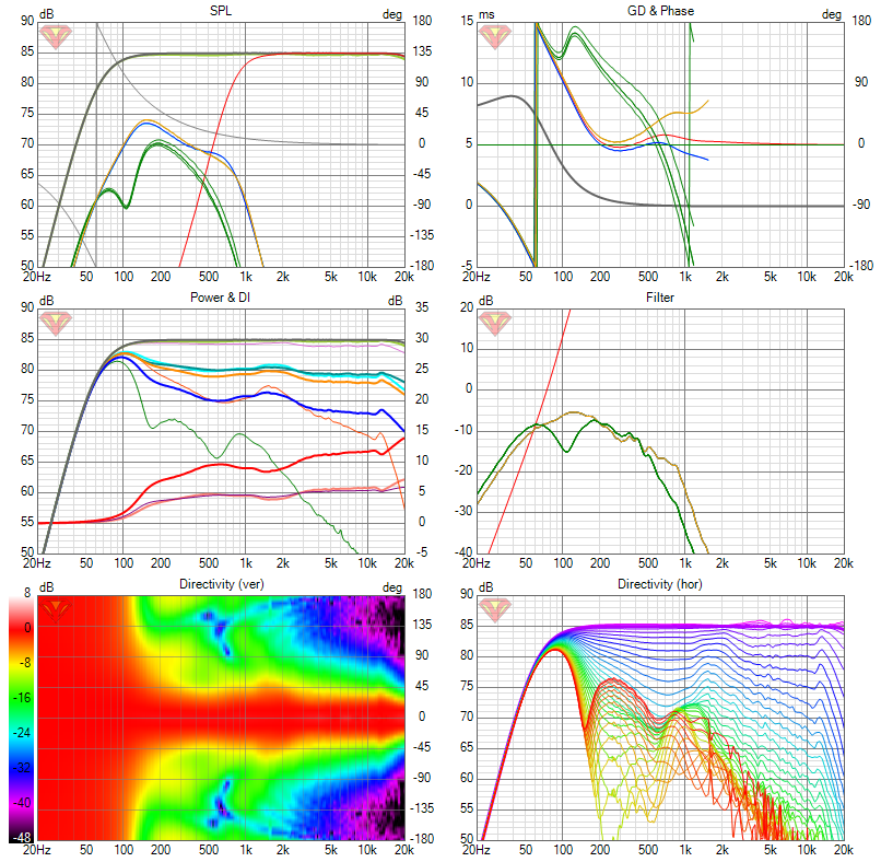

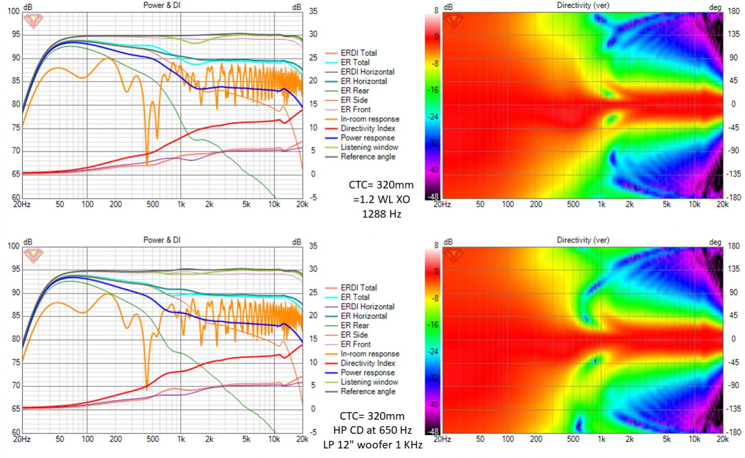

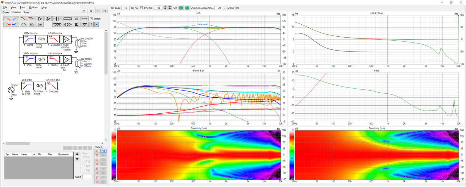

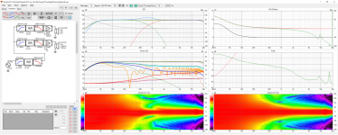

I was intrigued by conversations in other threads about CTC = 1.2 x WL at XO being optimal. This didn't seem right given my prior focus on reducing CTC so I decided to try it myself. I modelled a 2-way using my 300 mm axisymmetric round waveguide and a 12" woofer and played with CTC.
attachment.php
The top row of the drawing is with an LR4 XO at 1288 Hz which corresponds to CTC = 1.2 * WL at XO with a CTC of 320 mm.
The bottom row is with an overlap between CD and woofer. The overlap gives a better directivity match at XO. This one looks better to me. For neither case is the vertical polar map pretty but the power responses and DIs are fairly smooth.

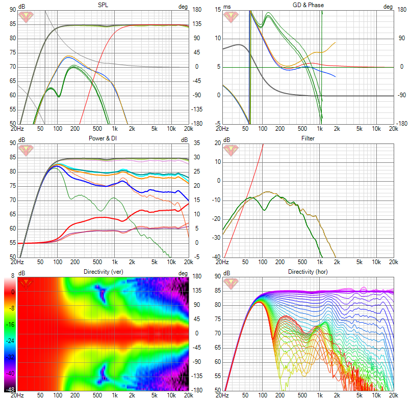

Encouraged by the latter I worked a little harder on the model and XO and ended up with this:
attachment.php
This model has the woofer behind the waveguide with some overlap. The waveguide will be free standing (on a stand) on top of the rounded over woofer box. I will likely put thick felt between the baffle and waveguide where this overlap exists; over a wider region if it helps. I'm not modelling the baffle so its effects are unaccounted for in this simulation.
This model has everything I was looking for except for high directivity below 500 Hz. Its so much simpler I have to consider which is easier: cardioid or convincing my wife to allow some room treatment?
The dashed blue line is the FR before correction by the global FIR eq. This flattens the response at XO and corrects the phase. There is excess phase to be corrected due to the setback of the woofer and me adding delay to steer the forward beam in the vertical direction.
Not sure I really follow the text of what you tried but the last graph looks to have a pretty nice response. I believe that would be a good sounding speaker everything else being equal.
Whether the difficulty in construction or increased cost of extra drivers etc. is worth it to extend the directivity I don't know.
Yes, that is the thing. It is outstandingly simple but should sound good; it just lacks the directivity down low that eases room placement and reduces/eliminates need for boundary treatment. Its good to know what it costs to get that directivity. The simplicity without the directivity calls the worth of that directivity into question, even for me.
As to what it is more clearly: Its my 300 mm diameter waveguide with rollback in a cradle sitting on top of TD12X woofer box with the woofer as close to the top of the box as possible. The cradle allows some fore/aft adjustment of the waveguide and some up/down adjustment to allow the waveguide to overlap the woofer a little.
How much overlap? I get the best response with a CTC of 250mm. At this CTC, the lip of the waveguide would overlap the middle of the surround roll by 30 mm. It (really just the vertical directivity near XO) only degrades slightly without that overlap. The question that isn't answered by Vituix is how the proximity of the waveguide affects the woofer's pattern (and vice versa but not anticipated to be problematic)
I would build the woofer box with the TD12 rear mounted and the cutout 30 mm less than the sqrt(Sd/pi) in radius - slightly bandpass. Then I design the cradle for the waveguide to drop the lip of the waveguide down over the edge of the woofer box to meet the edge of the opening. Perhaps I use some felt on the lower rollback of the waveguide...
