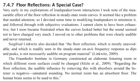

He specifically mentions that having no floor bounce "will sound" unnatural. It makes me wonder why no one complains about head phones and unnatural sound 😕.
I have the utmost respect for Floyd Toole and the research he has done but some of the comments made in that thread and some other's recently seem to draw conclusions that are not completely supported or at least don't account for every variable. With Toole being such an authority in general his comments carry much weight and will be repeated as gospel.
For example the Fraunhoffer Institute study is quoted as saying that removing the floor reflection was deemed unnatural. I haven't read the whole paper as I can't find it anywhere but there is a section quoted in another ASR thread.
An Enticing Marketing Story, Theory Without Measurement? | Page 4 | Audio Science Review (ASR) Forum
This describes using a 50mm absorber to reduce the level to below the ITU recommendation. So they changed it but did not eliminate it.
Toole's book has a section on it attached below. His own experiments found it to be a non issue. Are we to believe, Toole's own anecdote, the Franhoffer institute's conclusion, Soren Bech and the Archimedes Project or something else.
attachment.php
More challenging is the discussion on lateral reflections.
I have tried this both ways and I prefer to absorb the lateral reflections. It provides a clarity and preciseness that I prefer over the wider vaguer presentation with lateral reflections. If I was predominantly an Orchestral listener I would likely have the opposite opinion. I don't see a simple right or wrong answer to this one.

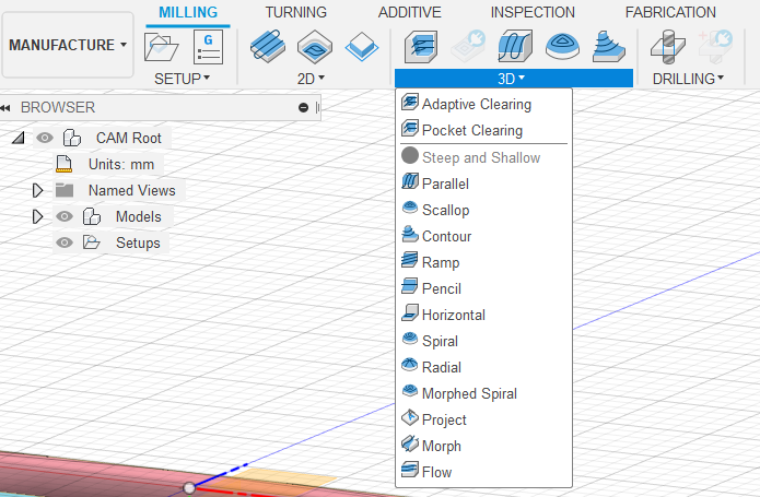

Yes I have. My original plan was to use the stepped approach with 36mm sections and that still seems sensible if the waveguide is in a box. Making a free standing guide is more difficult. The 3D printing kit approach interests me and I will explore that too. Everything has to be finished in some way and that often ends up being a big part of the total time spent.
what software would you use to generate the tool paths for the stepped approach? I don't think VCarvePro can quite get there - it can do 2.5D and "brute force" 3D but I don't know how to get it to do a mix of the two.
Well, I am learning it, pieces here and there, but no more than I have to because I'm 10x quicker in Sketchup if I can do it there.
Fusion's 3D milling menu looks richer than Vectrix. I should give it a go.
OTOH, when I work with a CNC shop, they generally want to make their own tool paths so my efforts in that direction are to get a time estimate and to complete the virtual prototype. The typical CNC shop uses SolidWorks.
