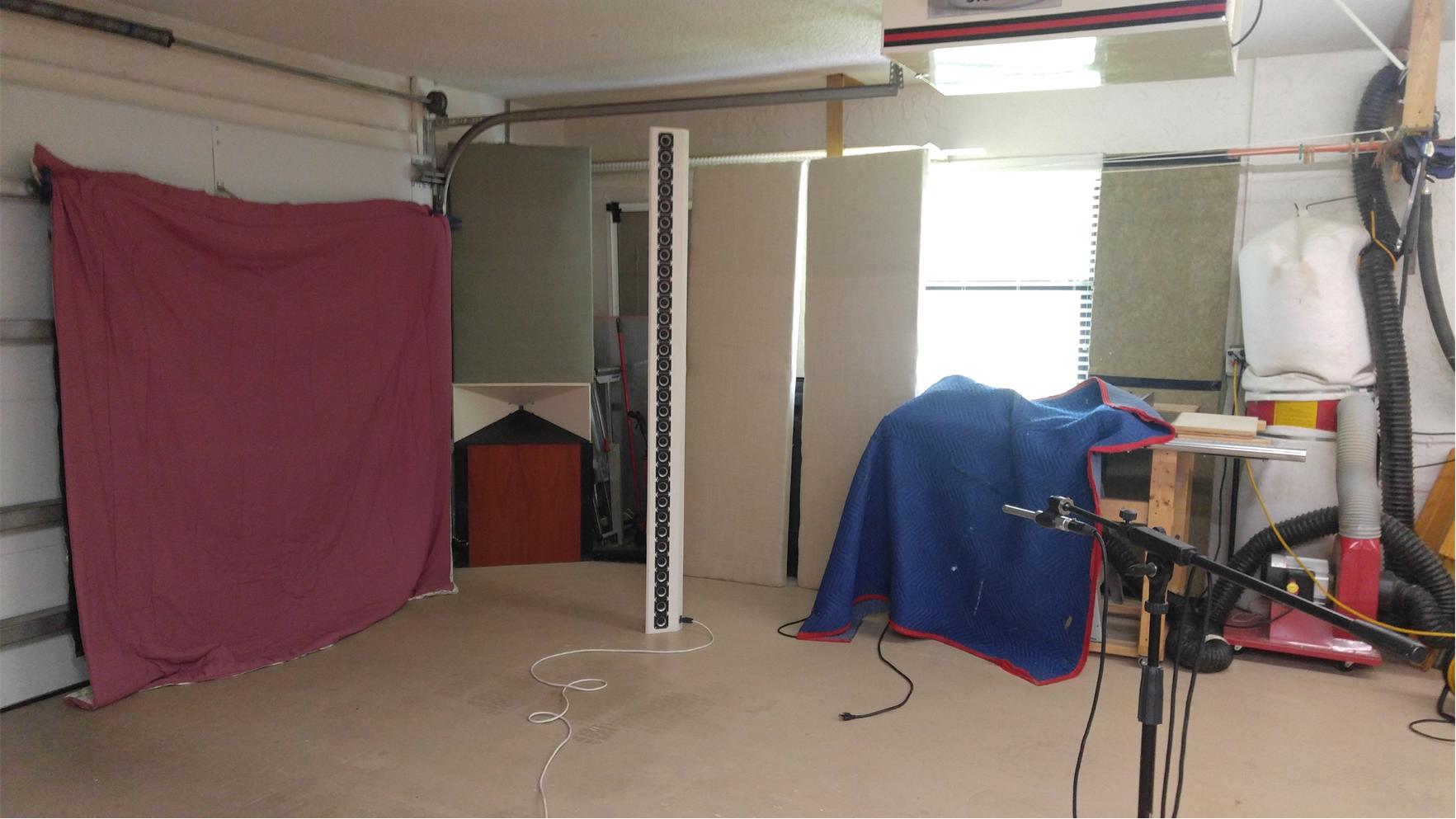

I built 2 more 2" panels and tried them out with the array both against the garage door and out in the room.
For the against the door case, the array was resting on a 2" panel resting in turn against 4" girders on garage door.

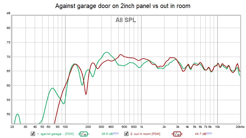

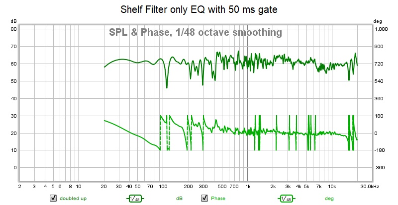

The responses with no sub and only shelf filters, FDW5:
In both positions, I had some near side wall boundary nulls that my 2" panels were ineffective against (not surprisingly). Against the door, there was some ripple 300Hz ++ which was due to the hurricane braces on the door holding the panel away from the door surface, mitigated by using multiple panels across the door. It turned out I didn't need the blankets on the door shown in the picture. I regret not taking a picture of the against the door case.
From a measurement perspective it seems like a tossup between the two positions, acoustically likely another story, which likely can be changed with ambience speakers.

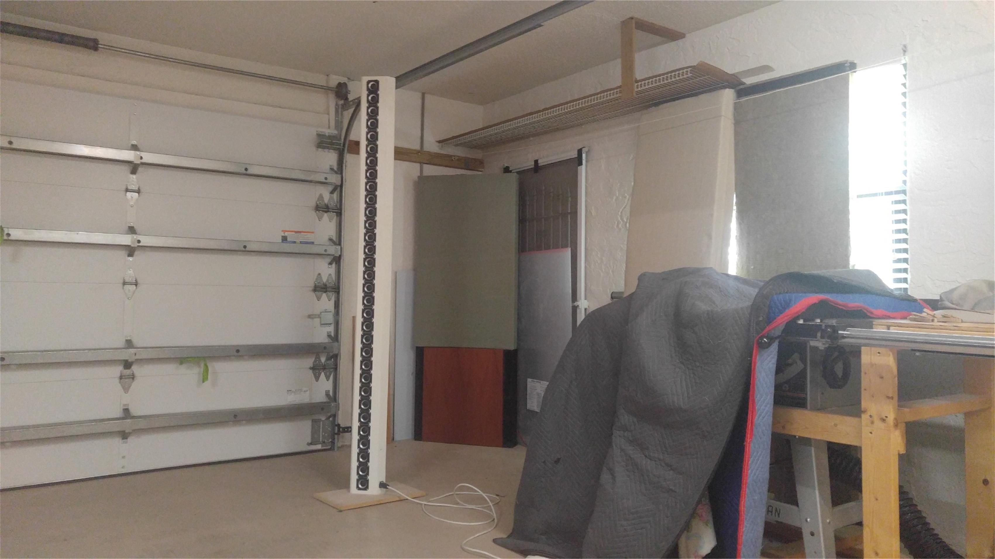

I'm going to need to add a base to my array before I go much further with it out in the room, I already knocked it over once!

I moved the array back by the garage door, integrated the 15" corner woofer into the system and then lifted the front sub up onto the countertop when I realized the 70ish Hz mode was a ceiling reflection. Happy that didn't cost me my back.

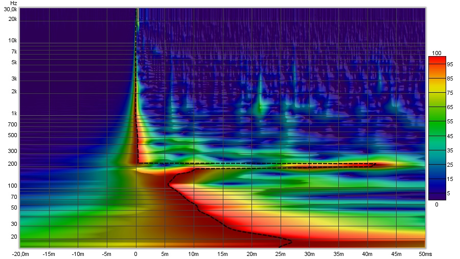

I got a surprise when I opened my default FDW5 window wider.
The 200 Hz first reflection null no longer dominated and a narrower null near 100 Hz appeared!?. Looks like I'm going to need thicker panels....
Murphy placed that first reflection point right on my window!

Yes it does... is it there when you measure the sub by itself or the array by itself?
You might get away with some shifting of energy.
If it is pretty consistent off axis some DRC excess phase correction might help too.
Upload a raw IR and I'll apply my cocktail of correction to see what that does.
First you'd need to see what it does under different angles, can it be fixed with DSP or should it be left alone...

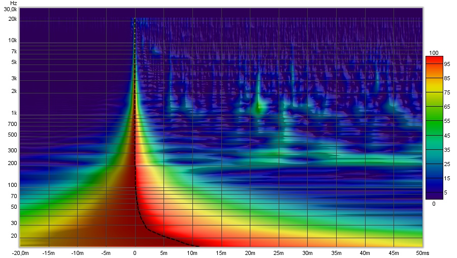

Its there all around. I measured in 2' circle around my primary LP and saw artifacts at that frequency in all positions but changing with distance from array and angle. I think my first step is garage door insulation; perhaps 3.5" thick denim or fiberglass over entire door if I can decide what to cover it with. Its the array, not the sub which XOs at 100 hz

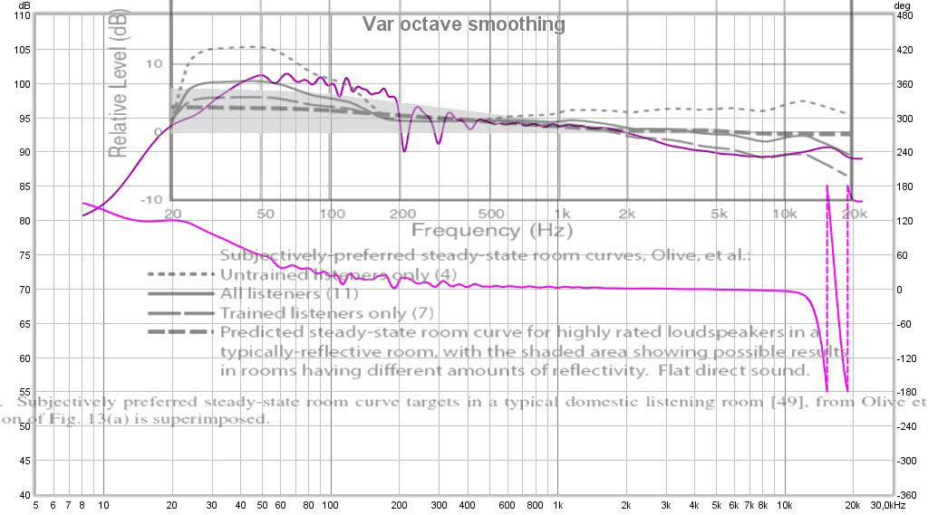

Here is a zip of the .wav I passed to DRC

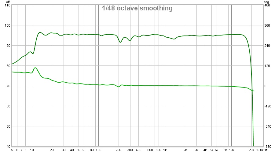

The original input:
Here's a quick prediction after the DRC step(s):
A link to both steps within REW:
measurements.zip - Google Drive
Now all that would be needed is to apply some EQ and a target.

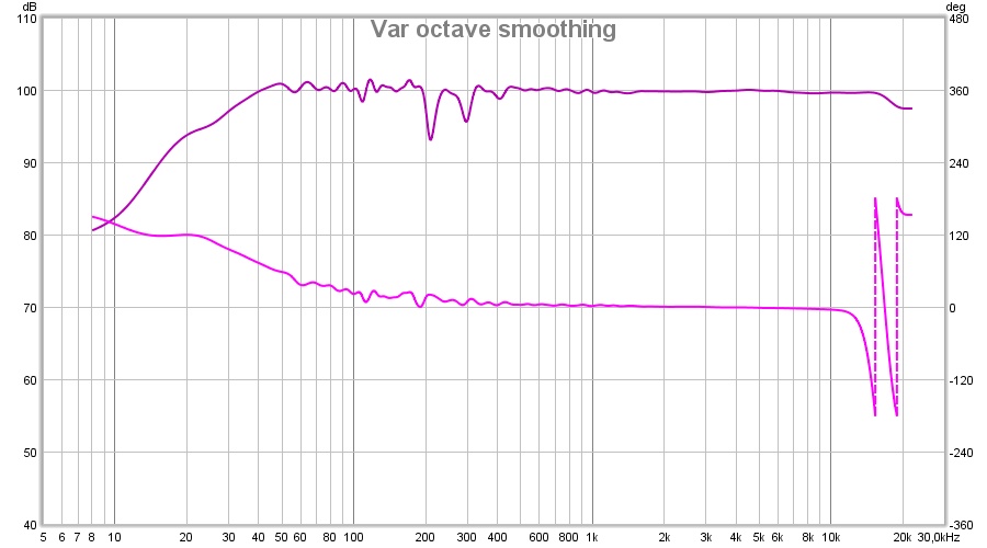

The frequency response in a 6 cycle view:
And a longer gated window of 25ms with Var smoothing (Which I'd use for EQ/target):
After applying a 25 Hz second order roll off and some quick EQ the 25 ms gated plot looks like this (Var smoothing):
See attached FIR filter, converted back to 96000. All my operations were run at 44100. Light EQ applied (all that I'd use), all that is missing now is a target (house) curve...

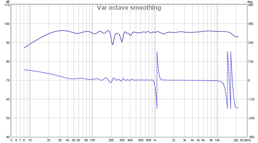

With a target applied:
See attached FIR filter. A couple of warnings though, I see a couple of steep correction peaks at 110 Hz, 400 Hz, 16000 Hz and 17800 Hz. Handle with care . You could shave those down if this sounds decent at all. Same goes for the previous correction FIR file, as all I did with this one is add a target curve.

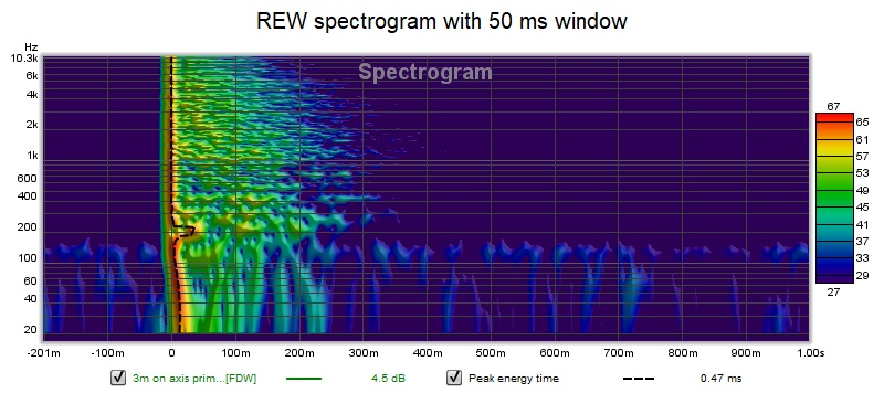

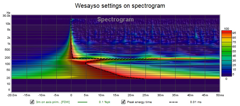

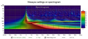

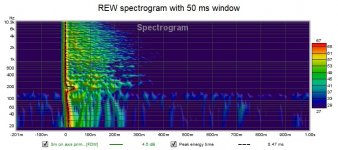

wow! echos last forever
Looks more like background noise or a measurement artefact below 100Hz as it is there before the peak and all the way through
