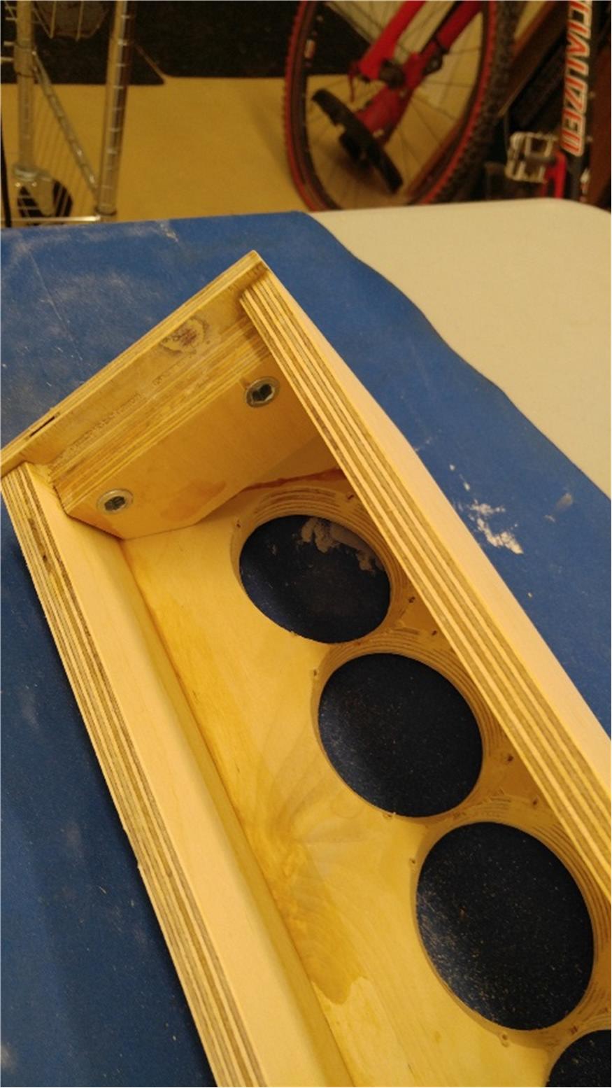

I prefer to use hurricane nuts and then hold my breath each time I loosen the bolt. 🙂
Seriously,I've had good luck since I started gluing them in.
I do have some of those inserts tucked away somewhere. I'll dig them up and use them if it looks like they would fit.

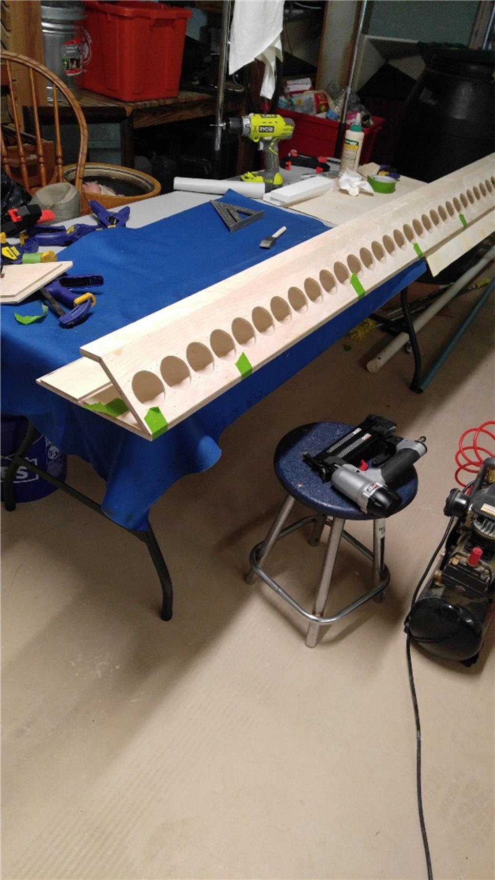

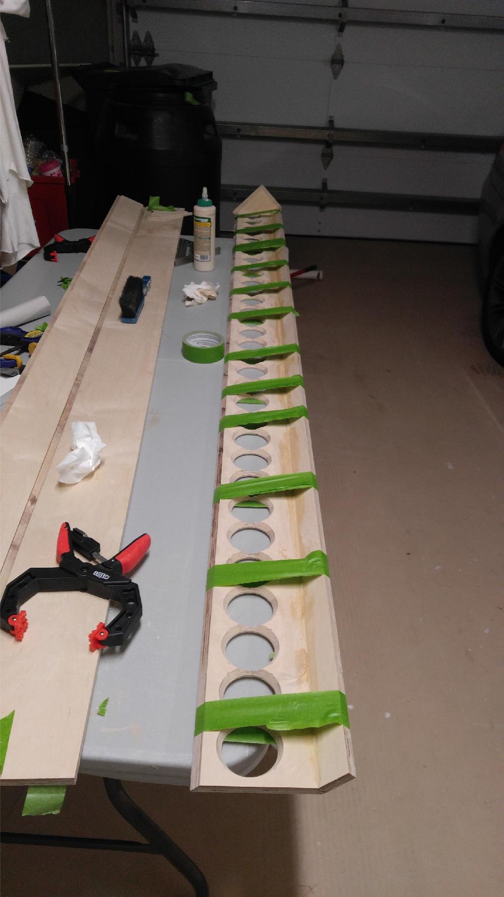

went ahead with the tape method of miter joint. Thanks Mark. This looks tighter than the first one, which I did with clamps.
attachment.php
Lots else to do while I wait for the glue to set...

But I'll sleep better with threaded inserts in the base instead of hurricane nuts.

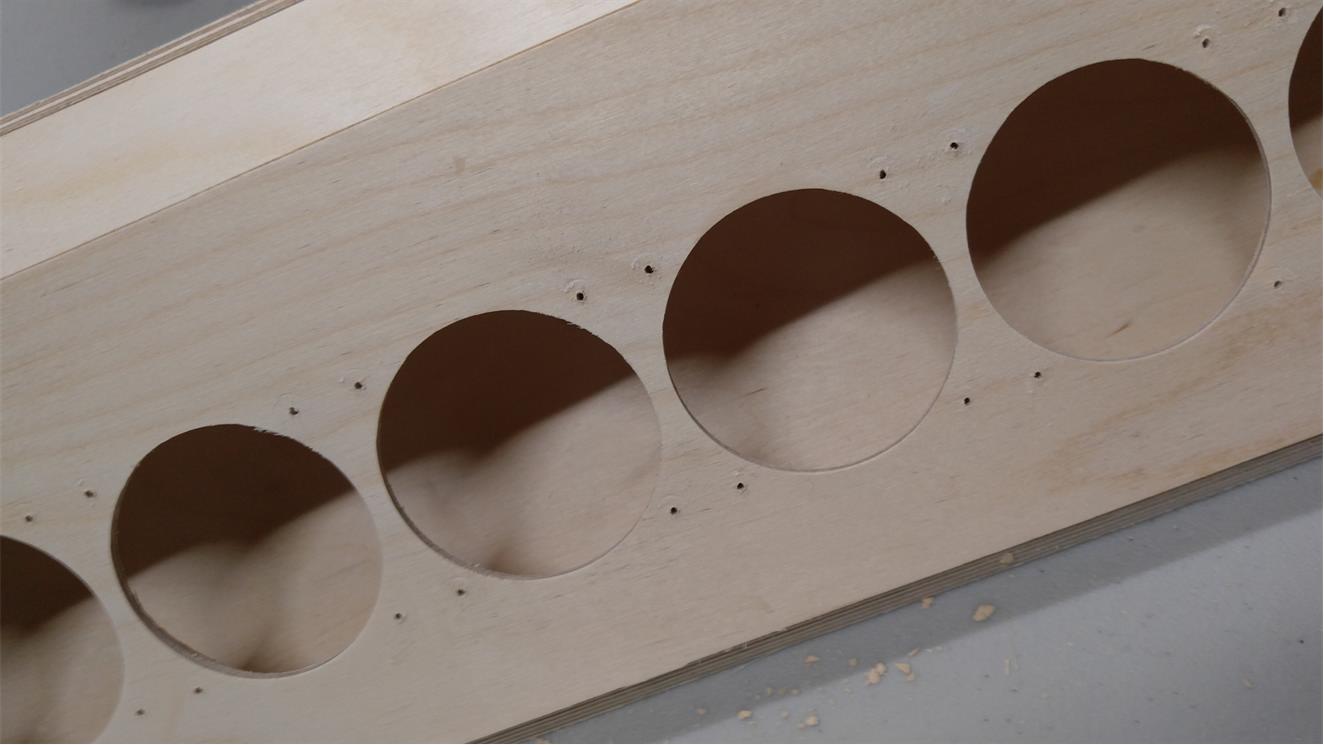

Here is a close up of the baffle with the tape clamped mitered joint and showing my recovered 1/16" pilot holes.
attachment.php
Next step: gluing the other side of the baffle to the back plate. I won't use many clamps here, I'm going to tack it down with brad nails and then maybe I won't feel like I have to let the glue dry overnight before moving on.
Next step: glued and nailed and waiting for the endplates being prepped with hurricane nuts (my inserts were too large)

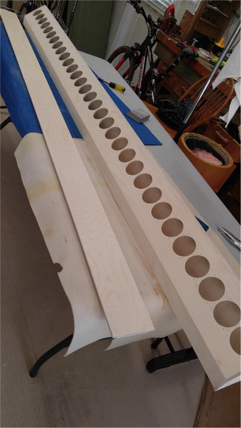

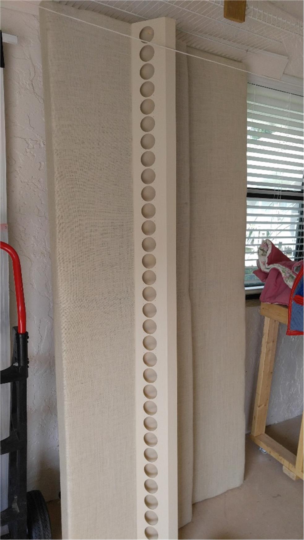

Its ready to have the drivers mounted, except I need to paint it first. Its been two days prepping for paint as I had some filling to do and kept finding more that needed to be done.
attachment.php
and I went for threaded inserts, literally to Home Depot, only 1.5 miles away. glad I did. it was so much easier and clearly more robust.
attachment.php

I painted it to match the absorber panel fabric, which missed its intended match to the walls but happily turned out to be an almost perfect mate to the floor tiles.
attachment.php
Imagine the line of black and silver driver cones...if that doesn't work I'll have to wrap the entire tower in fabric.

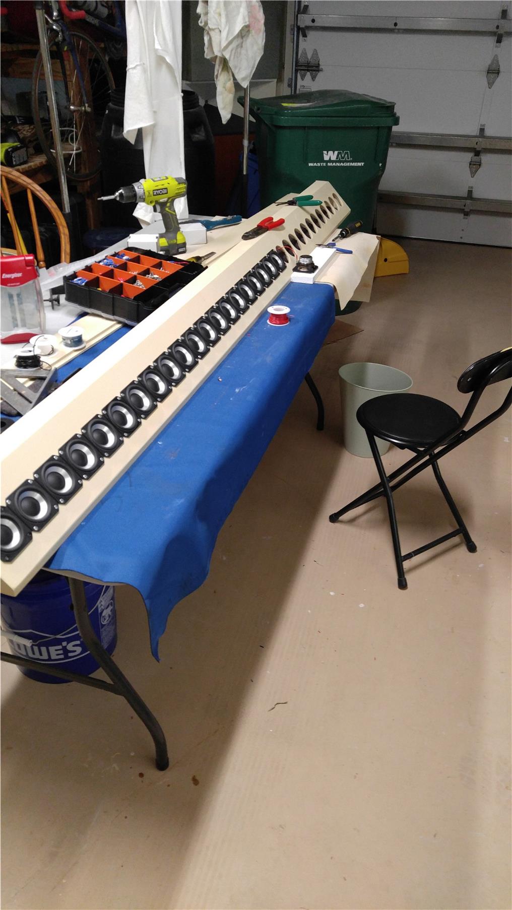

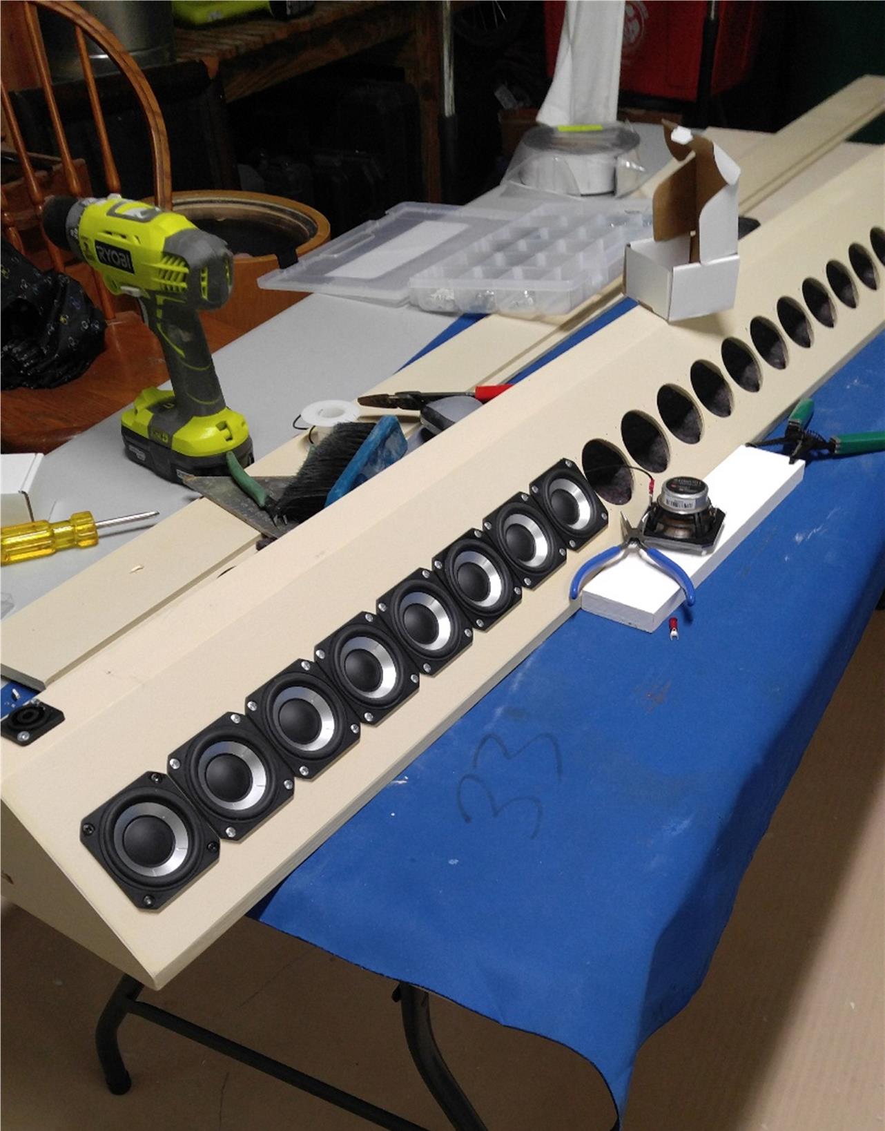

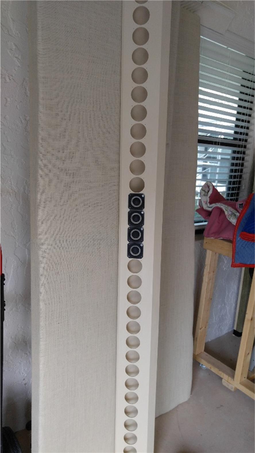

Mounting and wiring up the drivers proceeded without incident until I ran out of the correct gauge hookup wire.
attachment.php
Notice I've painted the heads of the mounting screws of the first driver black. I want to get a better/smaller brush before doing the rest of them.
progress!
Twelve drivers to go but I need a break!
attachment.php
While McMaster Carr gives me overnight delivery, stuff ordered on the weekend doesn't ship until Monday arriving late Tuesday. While waiting the garage ate 200' of speaker wire as I endeavored to get all the cables to the arrays and woofers off the floor.

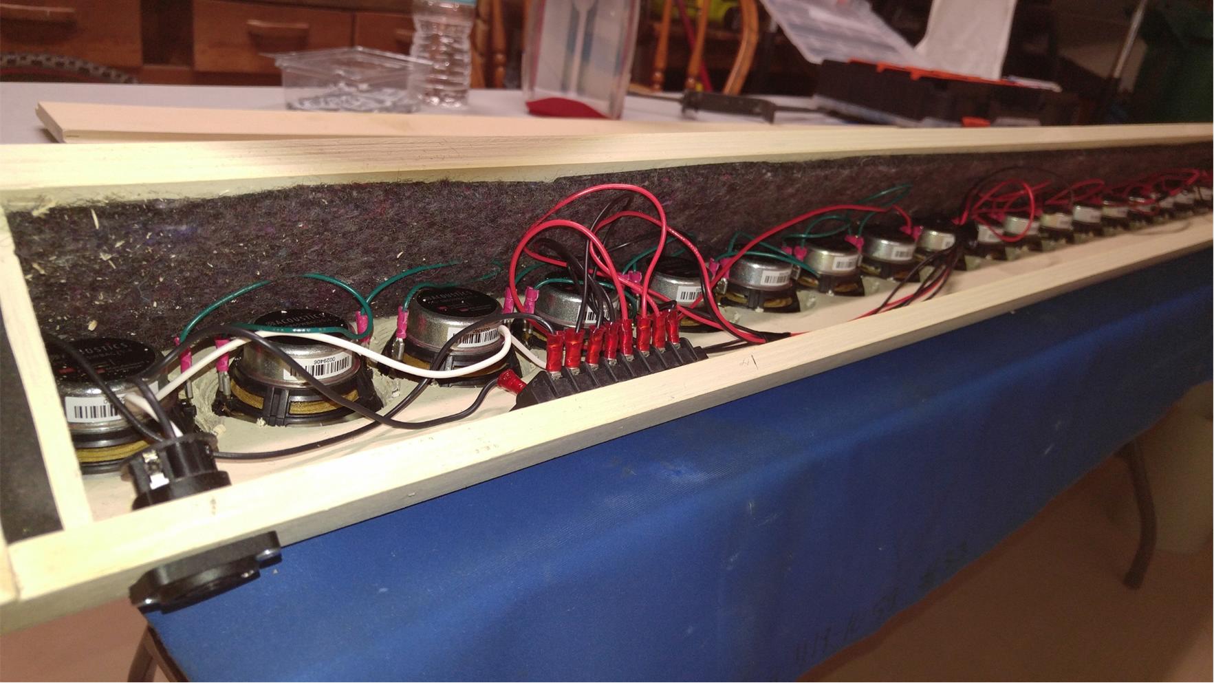

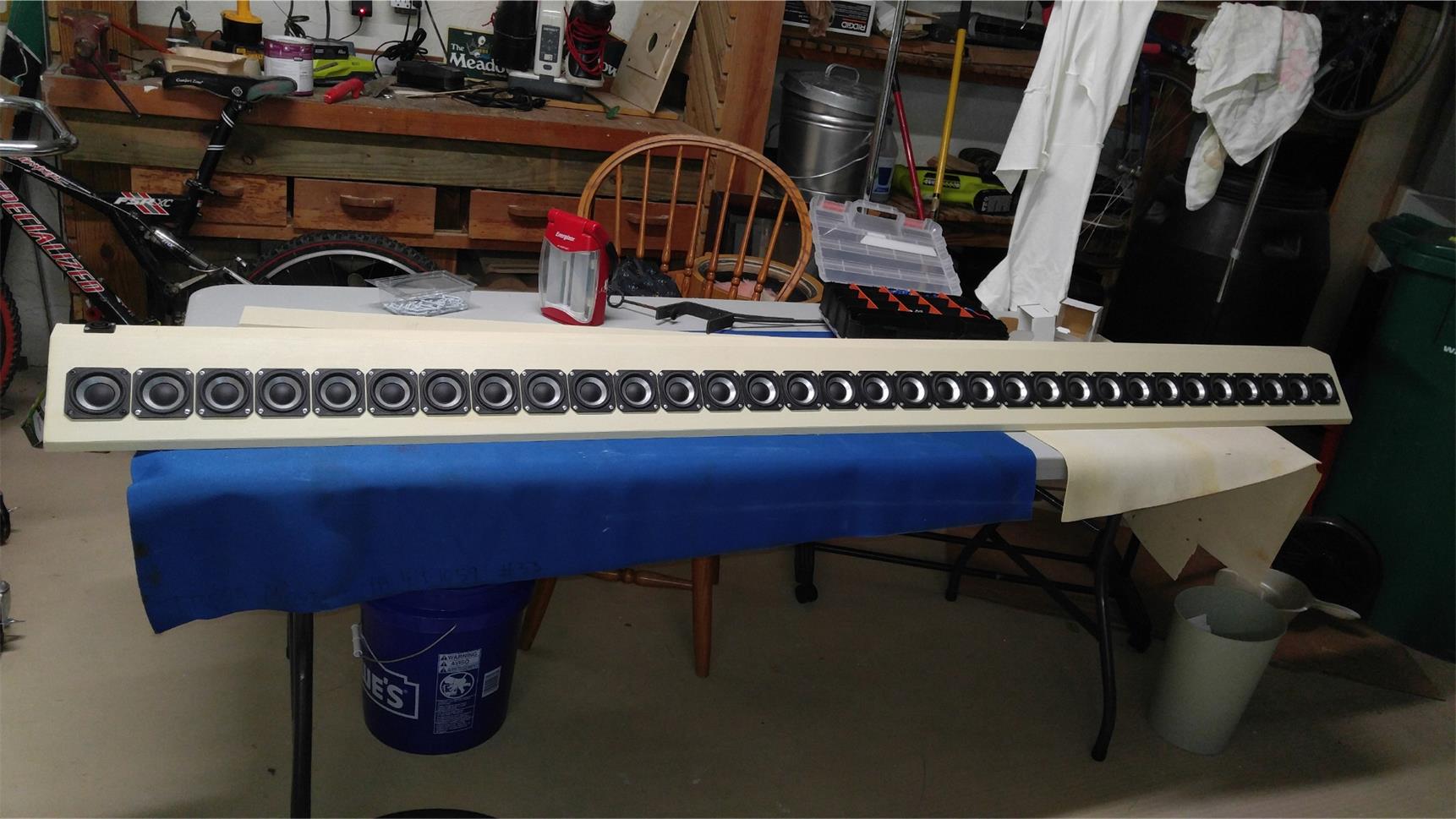

wiring done
I've got all the drivers mounted and connected
attachment.php
but I need to dress the wires a little and stuff the cabinet with fiberglass before I button up and make music. That is 1/4" of soft felt on the wall behind the drivers.
attachment.php
Groups of 8 drivers are wired in series with ~7" jumpers between adjacent drivers, extra long to allow me to grasp the unmounted driver's terminal with needle nose pliers while pushing the terminals on. The paralleling is done at the terminal block.
