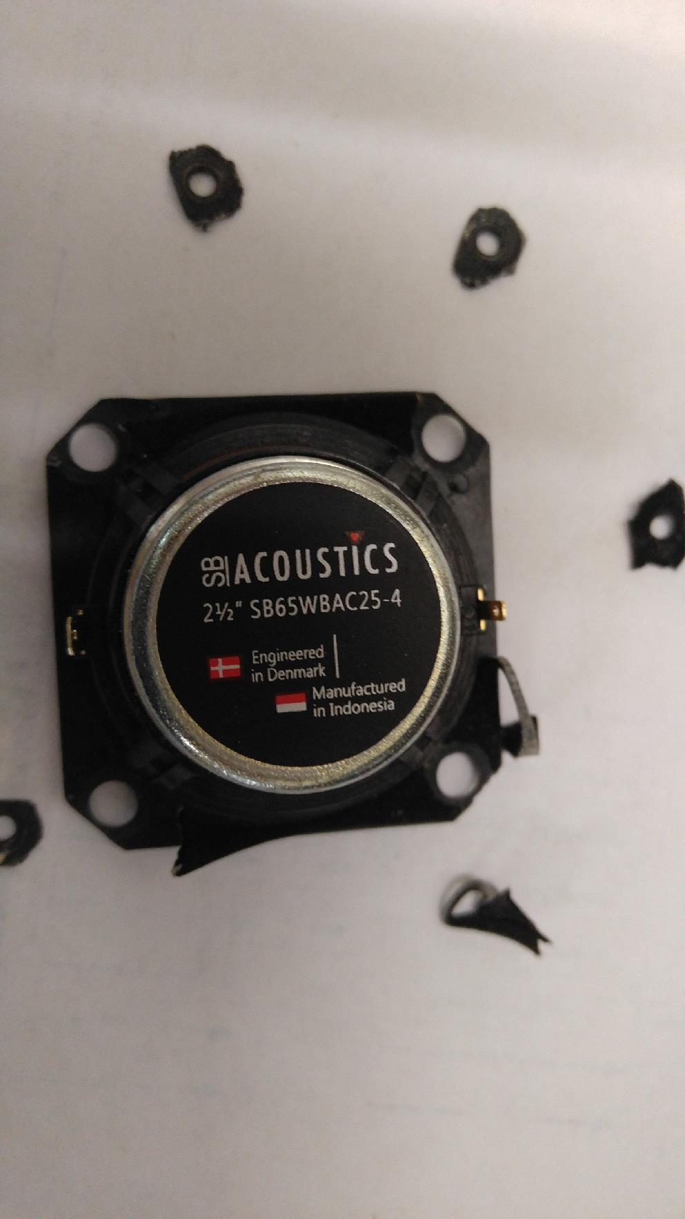

those little bits of plastic surrounding the driver broke off from the back of the driver mounting holes as might happen if the driver were smacked sharply on the back of its magnet with a hammer. of course nothing like that ever happened.
This was the top driver. The only thing I can think of is that when the array was knocked over and landed on the driver face, the delta MV over delta t on the top driver was too much for it. The array stopped abruptly but the driver kept going enough to fracture the plastic. A little bit of handling when I removed the back panel and there it was just hanging off the face of the baffle.
I looked at my early, pre-crash measurements, including one in same/similar position, and I don't see signs of that 200 hz null or early roll off in them.
I have one more virgin driver but I have to wait for the wood filler I put in the driver mounting holes before I install it

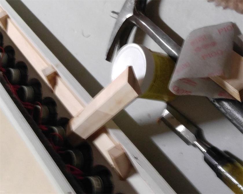

It seems there is no end to my troubles. Last night I glued in some vertical supports spaced along the joints. This morning I was unsatisfied with that and so cut some pieces to fill in between those supports:

Just finished gluing linear strips in with PLmax.
Spent a lot of time scraping off paint to be sure of a strong joint.

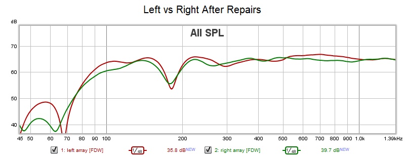

Finished repairing the split seam and replacing the broken driver. Put it all back together and found I was right back where I started from, perhaps a little better off.
attachment.php
The 180 hz null is a room mode. The concern is the 3 db difference circa 100 Hz. Perhaps I can live with that but I would dearly love to explain it.

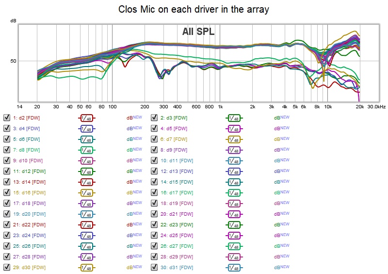

So I did a bunch of things but the only thing that bore fruit was to clos mic each driver in the suspect array.
attachment.php
Drivers are numbered from the ground up. The first 8 showed anomalous responses. They are all wired in series. Investigating, I found a bad/loose crimp in the chain. When I fixed it, the anomalies went away.
But I think I know what is going on. Notice how the bass responses spread out over a 10 db range. (sorry about the scale). The drivers closest to the ends have the lowest responses. Some of that response variation might be due to mic placment but I think there is a pattern there.
The array interior is a single continuous space fully stuffed. I thought the stuffing would be sufficient to prevent lengthwise reflections but I can't think of anything else that would explain this behavior. If this is true, why then does the other array have a different and better response. I'll have to clos mic its drivers also. (tomorrow)

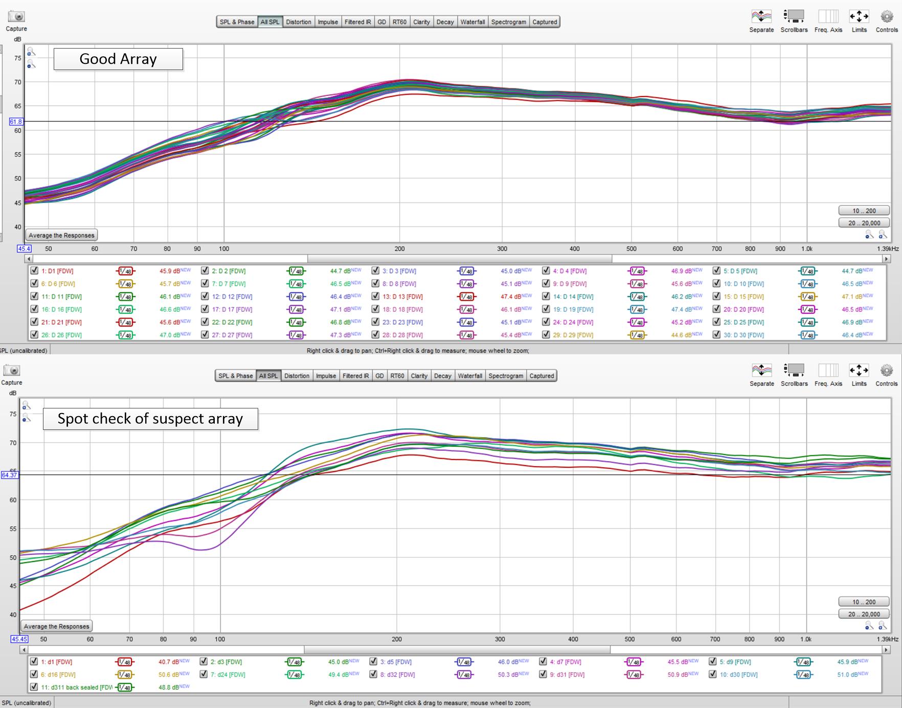

I completed a clos mic of the good array and present it below with a spot check of the suspect array after I repaired the loose crimp.
attachment.php
I see that the spread of 100 Hz SPL levels is much greater on the suspect array and that two drivers, and perhaps a third, are responsible for most of it. The worst drivers are 32, 31, and 1. All are at or near the ends of the array, supporting the reflection theory but they might just be weak or damaged drivers. I have one more spare that I can sub in.
But even 3 bad drivers out of 32 can't be responsible for a 3 db loss in output

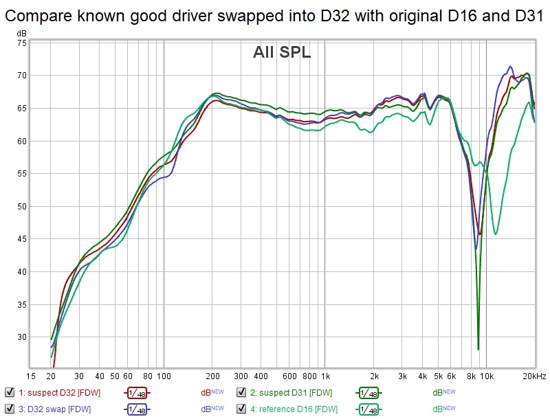

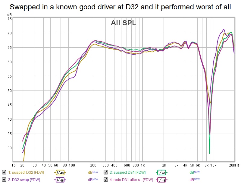

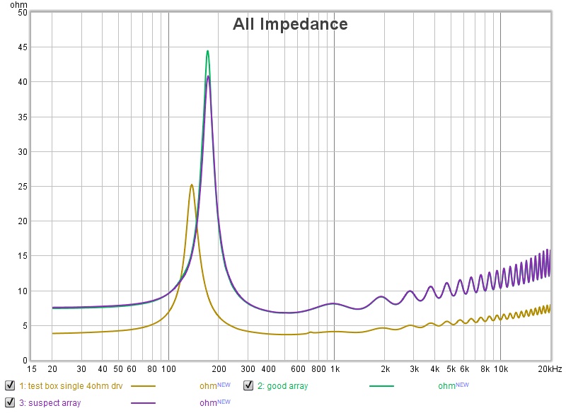

with a finger pointing squarely at D32, I swapped in my original sample driver from my test box to that location and retested. To my mind blowing surprise that known good driver performed worst of all.
attachment.php
I measured at D16 for a reference furthest from an end. Its SPL was in the middle of the group at 100 Hz, which argues against the reflection/end effects theory.
attachment.php
