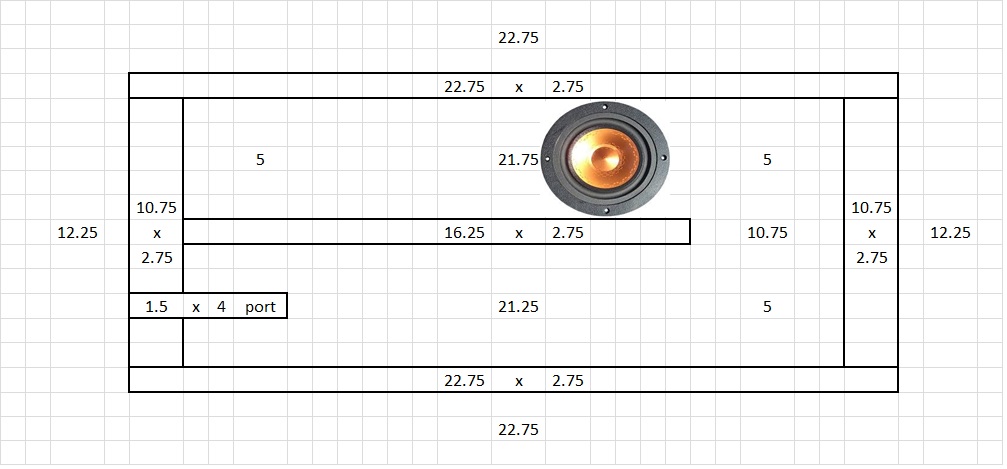

After the results with my chucked together prototype (3 pages back) I was sufficiently impressed to do a better build. Fractionally resized but keeping to the same principles of vent dimensions and length I've built the new ones in Baltic Birch. They're a little deeper than your original design (10cm)
I got the local timber merchant to cut the 9mm birch ply to my sizes for the external panels and, not being blessed with routering skills I doubled up the baffle panels and used two different hole saws to make the driver cut outs so that this time I could recess the Alpairs
Taking earlier advice I've lightened up on the stuffing - it looks the same but it is more fluffed out.
There were a couple of voids with these dimensions so I stuffed them quite tight with the damping material.
Cable is Chord Odyssey soldered direct to the drivers with no phono sockets between drivers and amp.
The finish is beeswax. Have to say I'm pretty impressed with these speakers. Compared to the prototypes they are a touch more transparent all round and bass goes deeper, probably because of better construction, no leaks!
Anyway, thanks once more for posting this design, it's given me just what I needed for the hobby room.
Cheers, Ian

Nice looking speakers! Seems like you have a lot of wasted space?
Thanks. Re wasted space, only the two vertical bits filled with wool in the pic above are voids. The horizontal part is the closed end of the MLTL or have I misunderstood what you mean?
Great job! Beautiful speakers and so glad they are living up to your expectations. Good idea to make a rectangular baffle - that will reduce the baffle diffraction effects and make it smoother. Making the drivers flush is what is helping the transparency. Your little bit of "wasted" space probably did not need any wool - filling with sand to give mass to the speaker could also have been done. Having that extra space is worth the improved response smoothness from having a rectangular baffle is a worthwhile trade.
Wasted space = poly filled voids. Here is a rectangular box with the 42.5" transmission line length, 2.75" depth, 12.5" speaker placement, and no wasted space.
Yes, that works but I think he wanted driver centrally mounted. Looks better and less baffle step loss for bass.
That's true, I did want the driver in the middle for aesthetic reasons and besides the void matches parts of my brain - at least it means I don't get too excited over trivia
Actually BP1 I like your design proportions and may try it one day so thanks for posting.

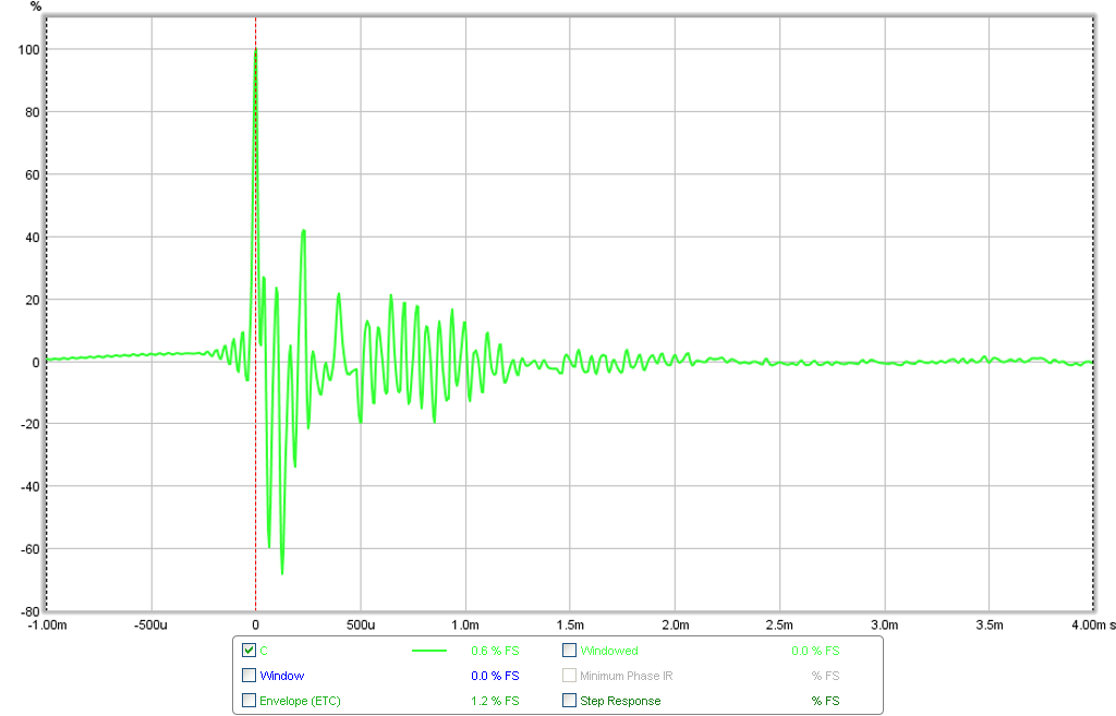

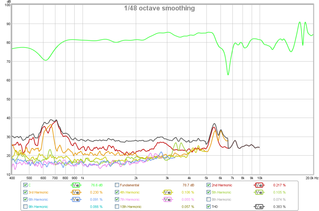

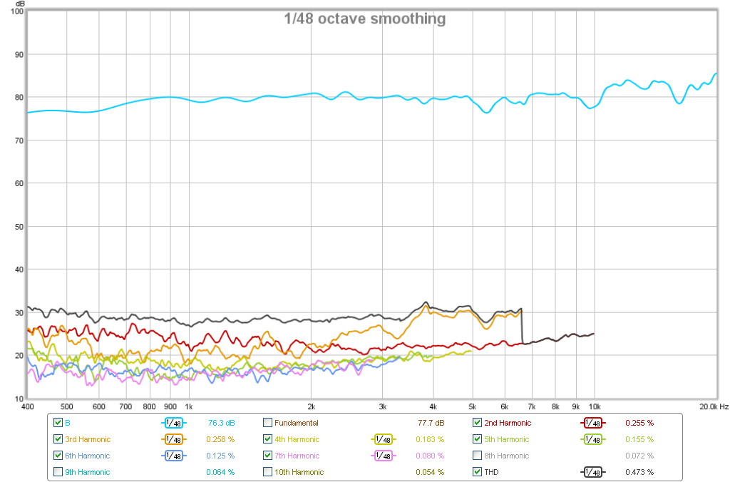

Measurements reveal that driver has some special voicing and some of it is same scheme as CHN70, unfortunate drivers datasheet present a vertical 120dB range and seems hard to read or useless.
xrk971 shared some nice data at comparison threads for small full rangers and A7 paper was present at round 3.
You asked if anyone has an opinion, well think in that data the HD peak 600-700Hz plus very unique voiced frq response and ringing IR is some the cause.
A7 paper FR & HD: (linked from http://www.diyaudio.com/forums/full...2in-4in-drivers-round-3-a-24.html#post4418888)
Compare to B80 from same thread:
A7 paper impulse response:
Compare to B80:
