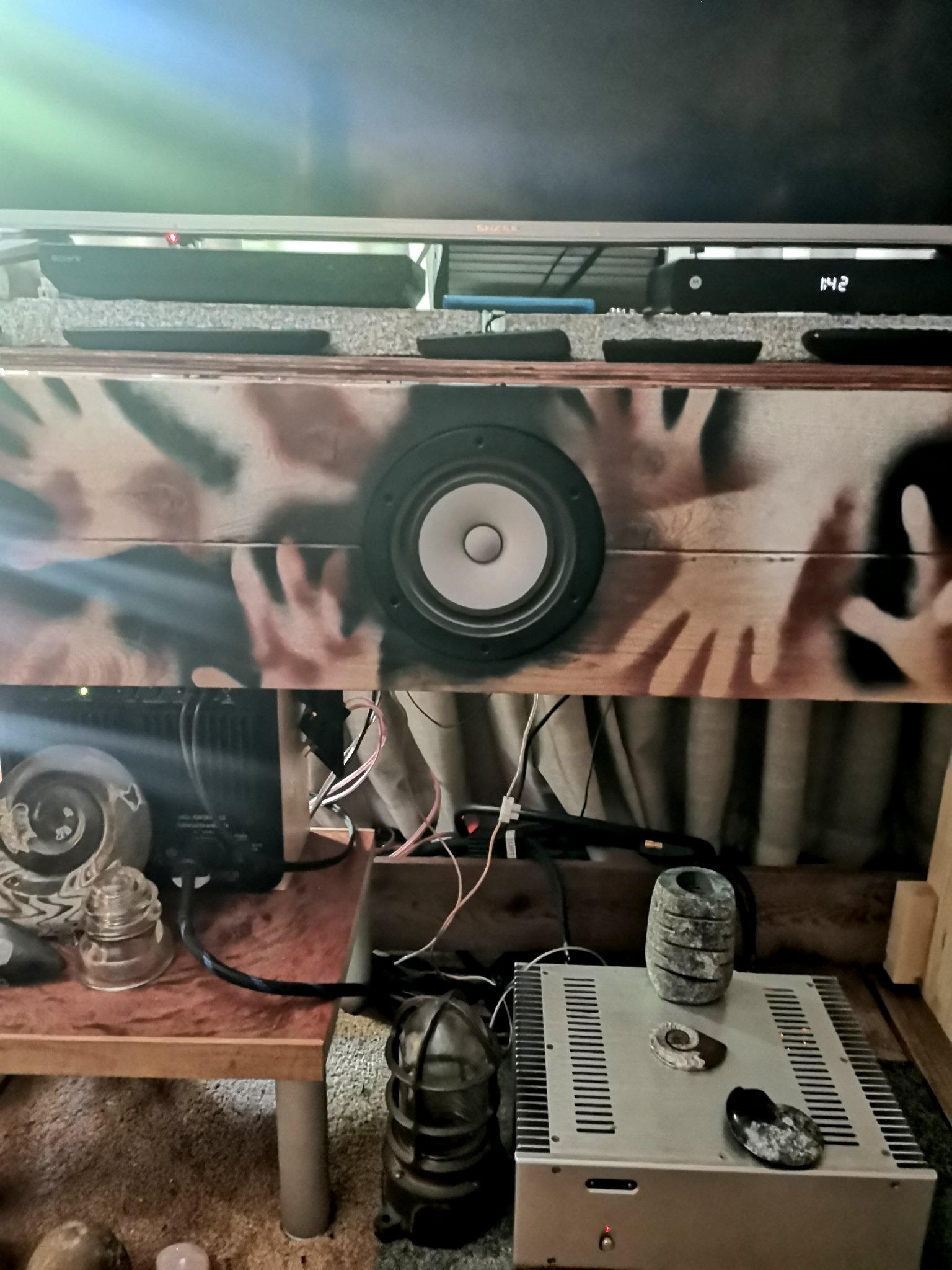

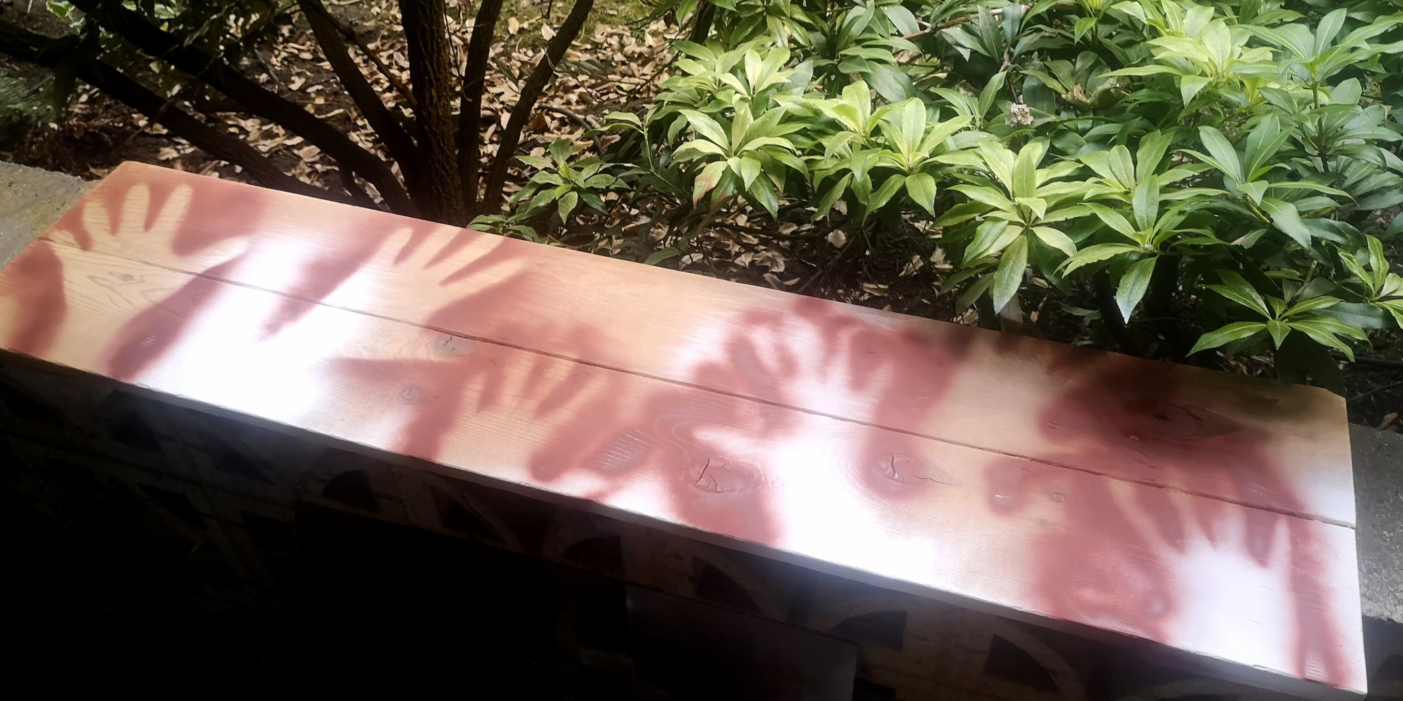

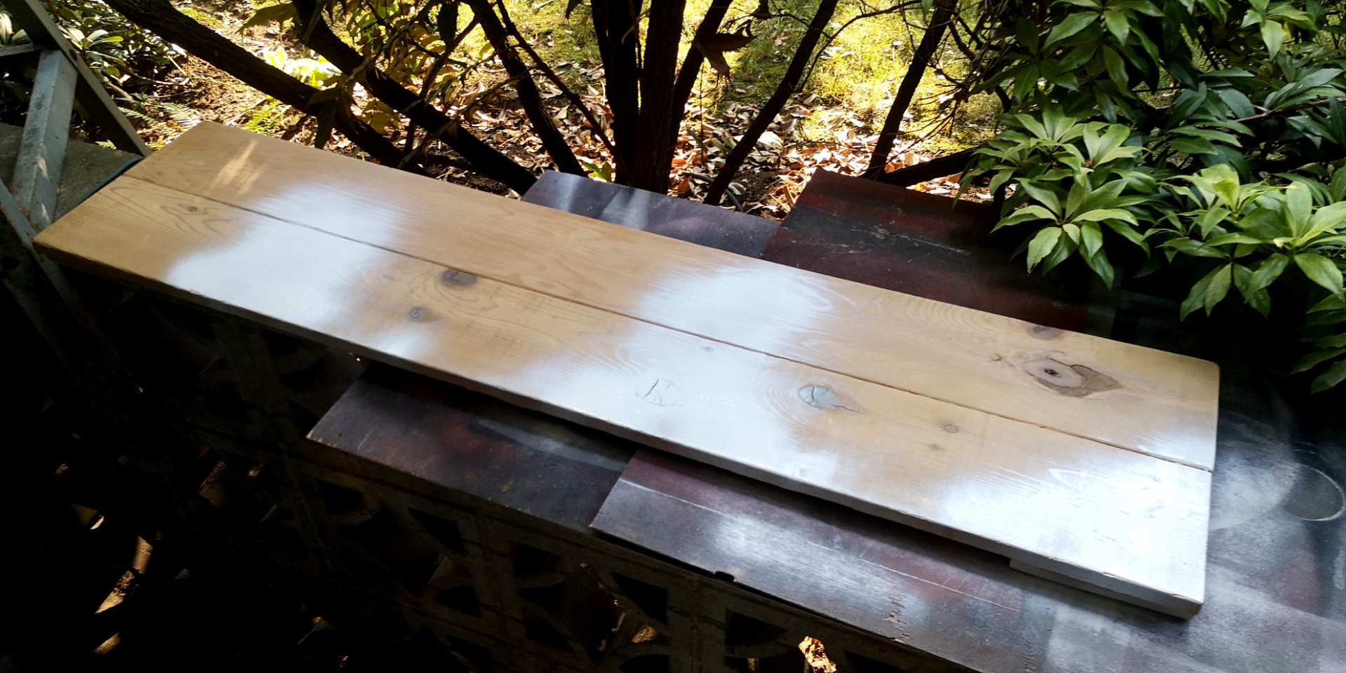

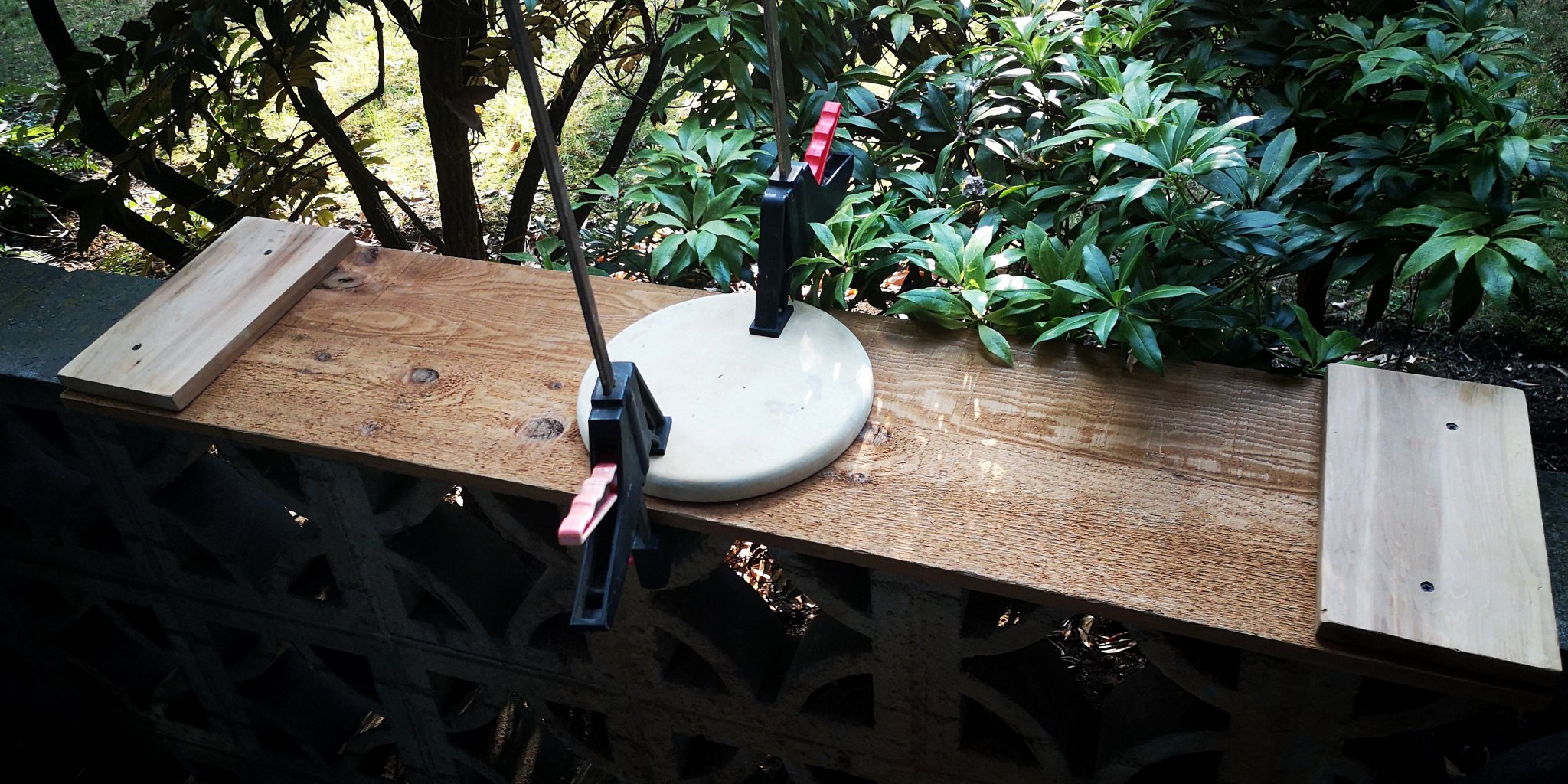

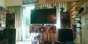

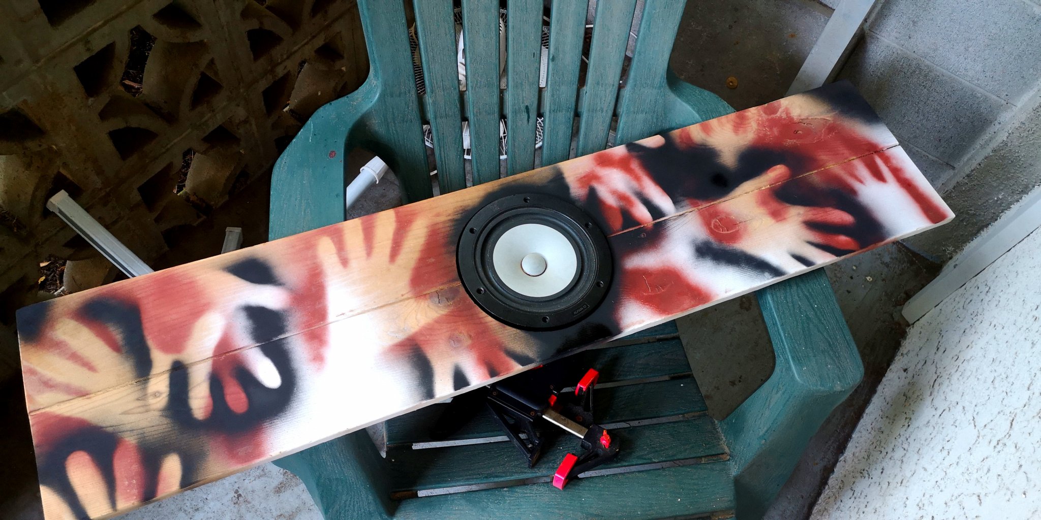

My non surround passive centre channel, open baffle to match my stereo pair.
Got the idea reading about some RCA Living Stereo 3 channel recordings, and figured, why not me?
No need to give up my stereo all in one system, and it works shockingly well with hard panned movie Foley effects.
Still no plans to go surround sound, but this is fun.

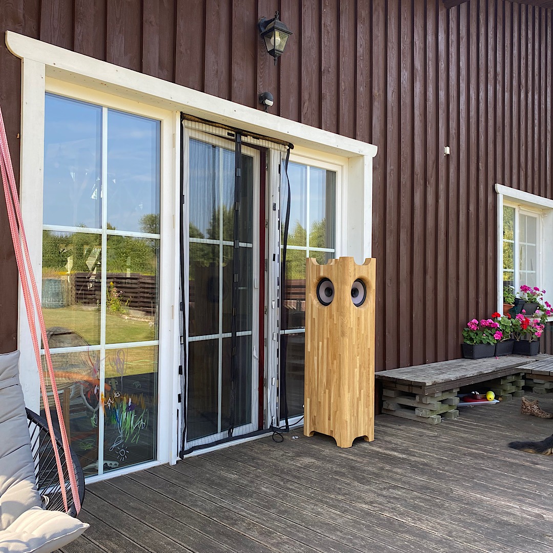

What a surprise! The speaker was designed to benefit from wall reflections and it works amazingly well. But decided to take outside to listen to it. I was expecting sound to be close to ordinary single speaker playing music. (In frontal direction of course)Because side reflections more or less are missing. But i was amazed how much more live they sound. I closed side drivers with thick blanket from my sofa to compare. Standing in front of the speaker difference is big.The sound stage is wide compared to closed side drivers. That was very unexpected for me. And of course all other directions are a lot better which is not a surprise. I can say the speaker fits small in room spaces and large open spaces as well😀

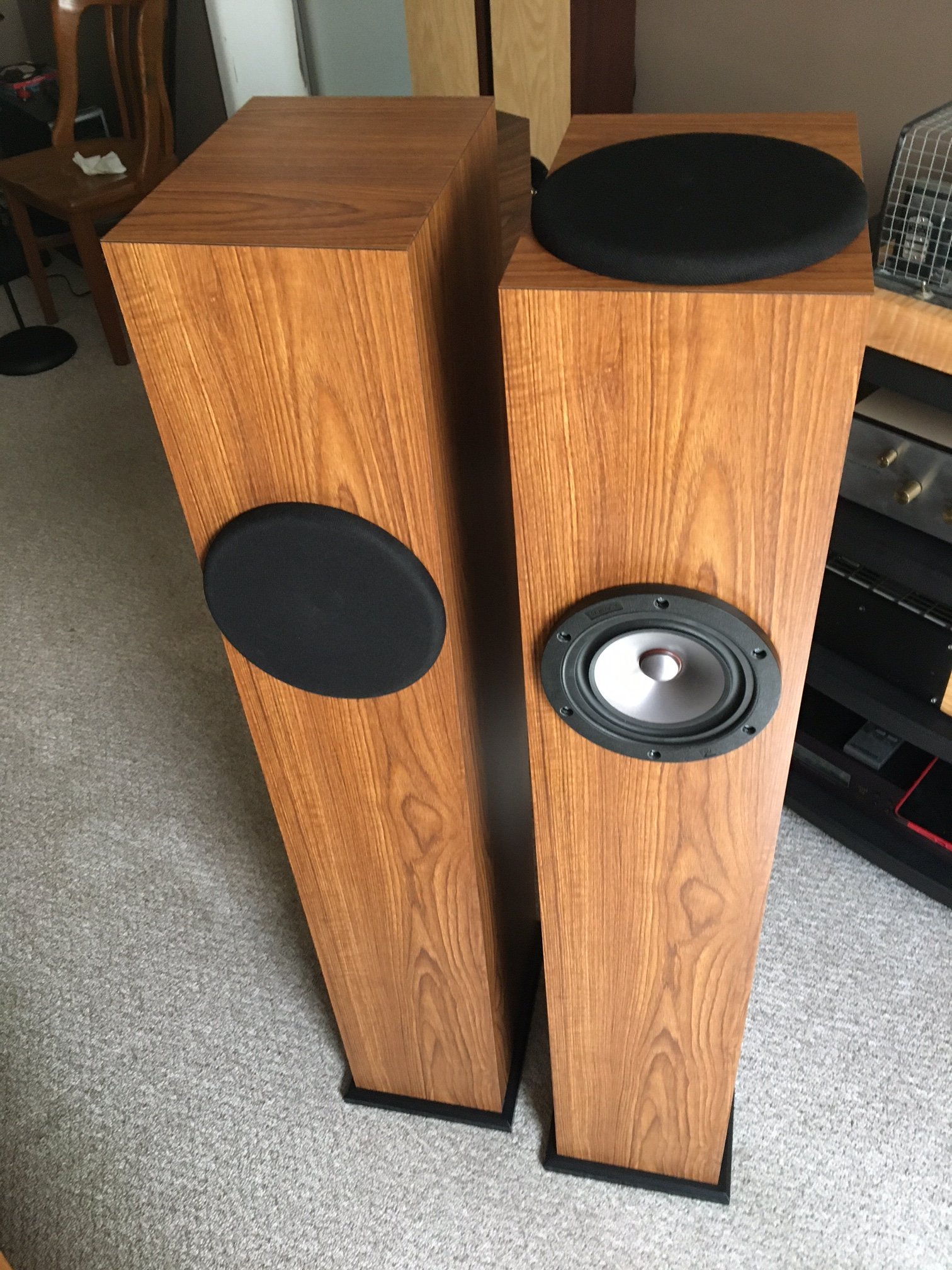

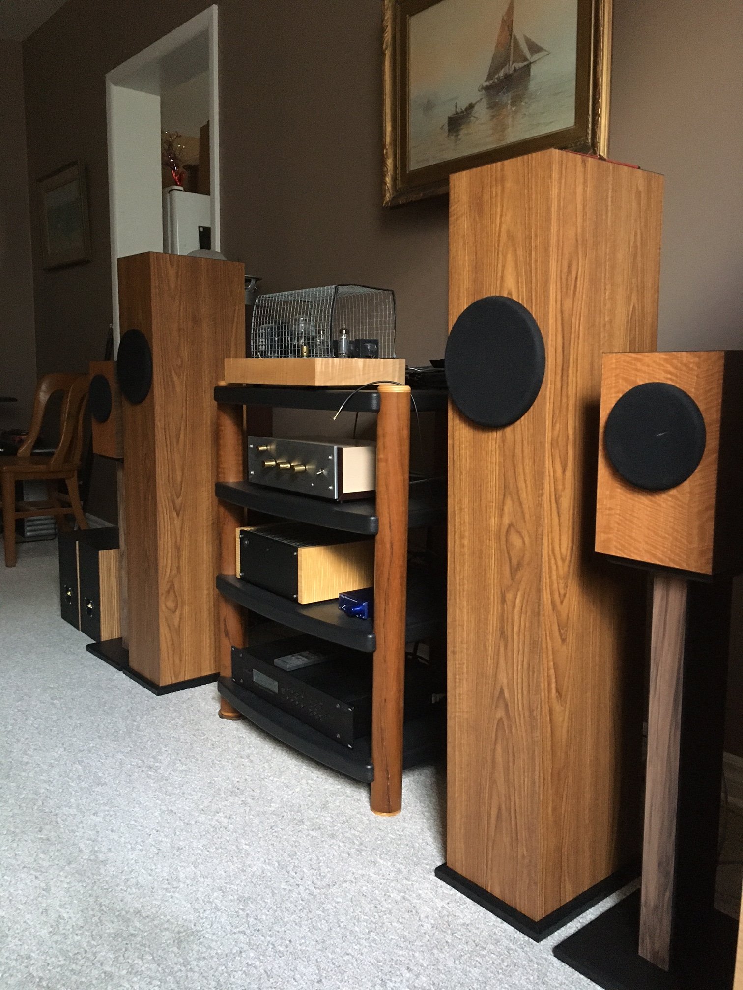

Not a photo, but this was just a 13 by 7.25 inch sealed column, about 3 feet tall with a driver on each of the long faces, and one of the blanks facing me.
I originally made it as a sort of less locateable summed centre channel, but it was quite good relying on sidewall reflections as a stereo player with a sub.
The 12P has always seemed a little bright for me, at least compared with a 12PW, so the sideways orientation may explain why I liked it so much.

It's just on an open baffle integrated into my tv stand. The power amp runs the left and right speakers. The right return connects to the centre negative, and the left positive connects to the centre positive. It's subtle, but for me worthwhile.
