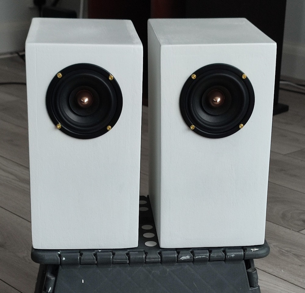

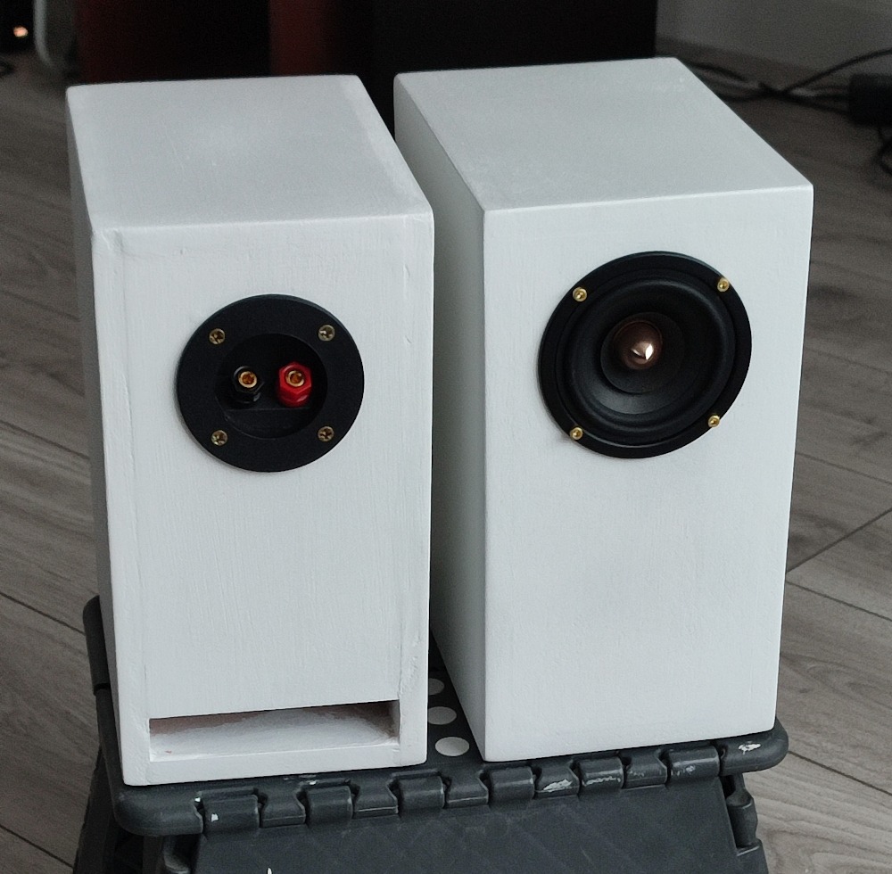

I made small, 3" full range speakers, built with 12mm mdf board. Toy speakers, made as a gift for my niece. They are cheap and easy to do, work with cheap class "D" amp, with build in Bluetooth.

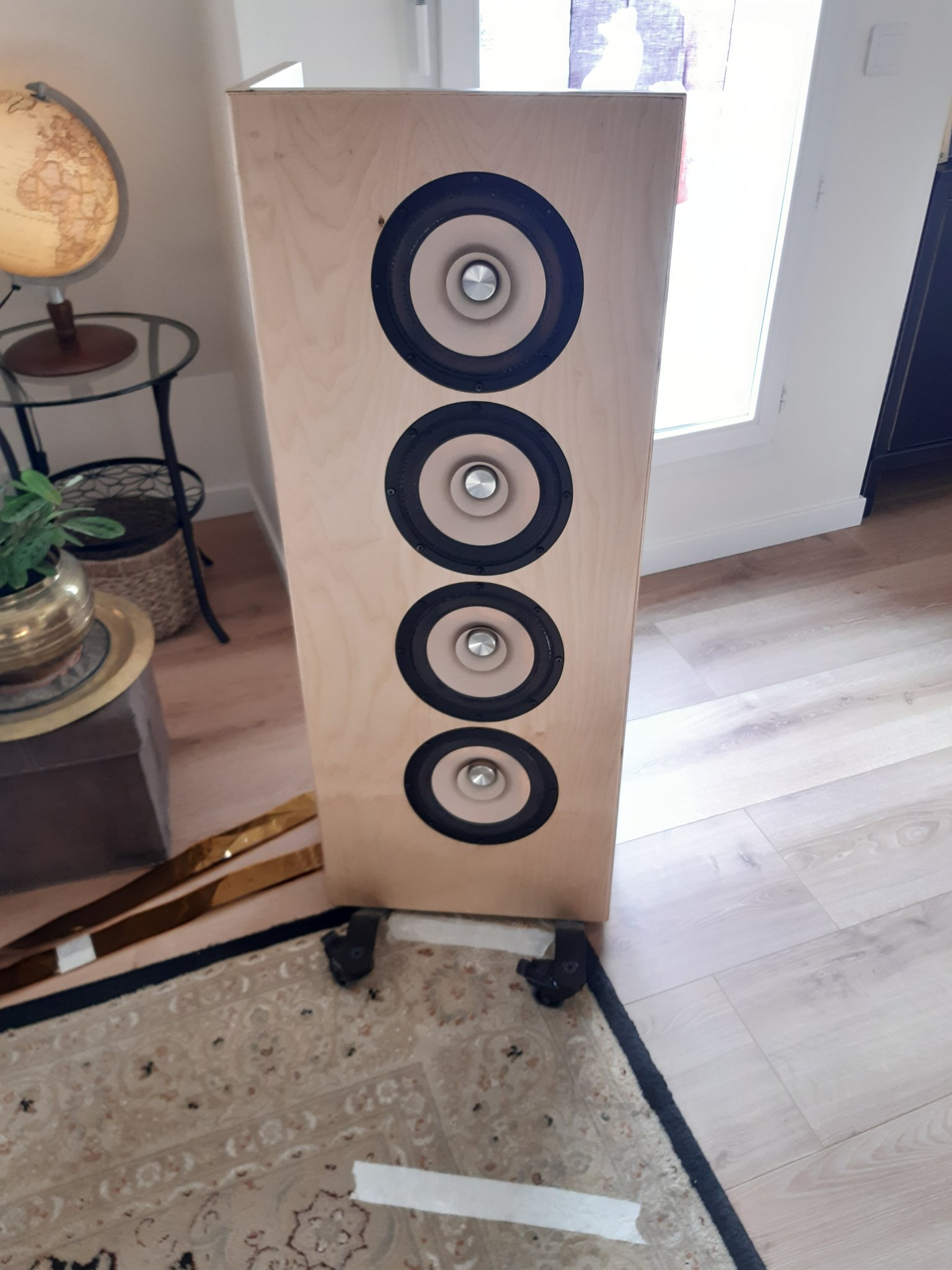

I build open baffle speakers with 4 Tang Band w8-2145 per baffle, based ECdesigns' "design". Satisfied with the results I got a carpenter to make a nicer version.
I recently made a few recordings of the speakers, which are powered by ECdesigns' DAC/Amplifier, and give a pretty good idea of the type of sound which I would qualify as natural and transparent.
The Tang Band drivers perform well in this configuration, and offer a linear response. I do have a few humps in the lower bass (at 40 and 75 hz) on one speaker, as a, result of its placement and room modes.

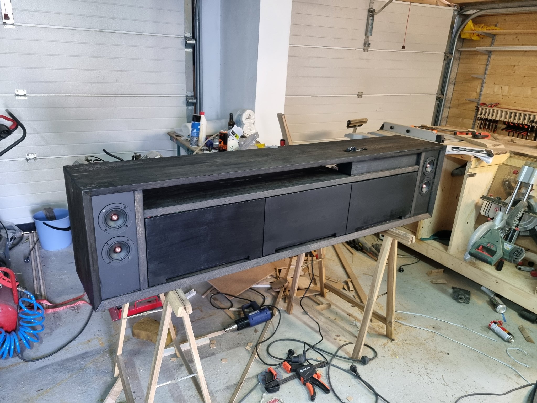

Know I should have cleaned my garage before taking the pictures.

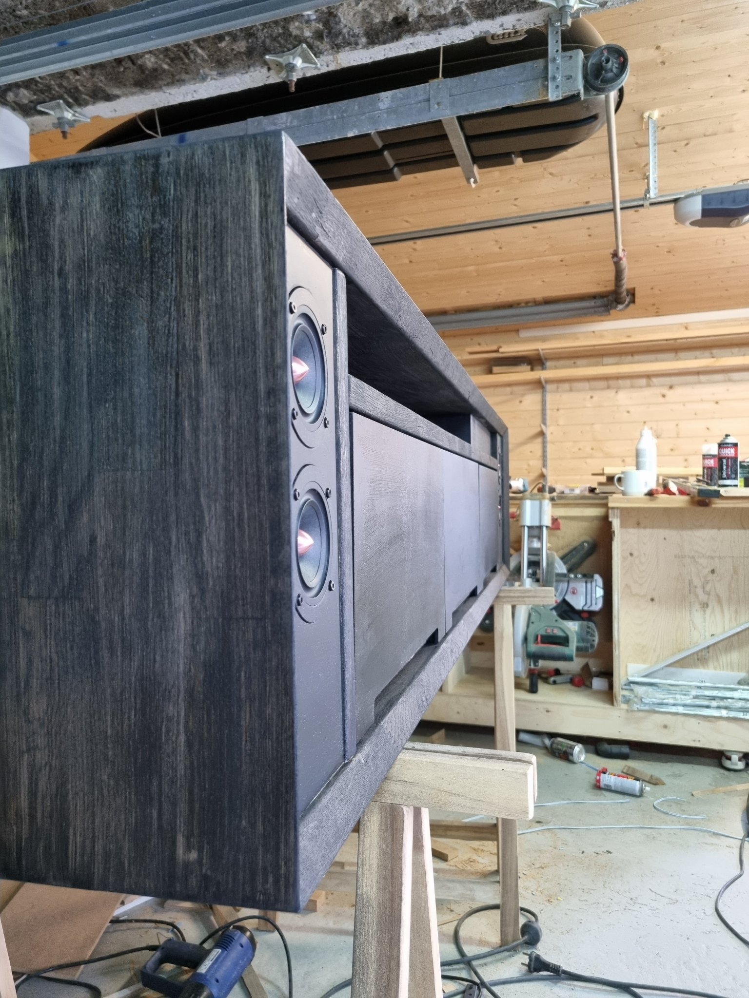

A media console with two drawer (left and center), a built in sub amp and power distribution for TV, set-top box etc hidden behind the right false drawerfront.
Built with an Arylic 2.1 AMP (a little "beast" of a small amp, with DSP...).
2x Dayton PS95 in closed boxes for the monitoring, and a Dayton DCS 165 as downfiring sub, in 18l vented box.
Small build video
Unfortunately I forget to take pictures, so not all parts of the precess is documented ;o)
