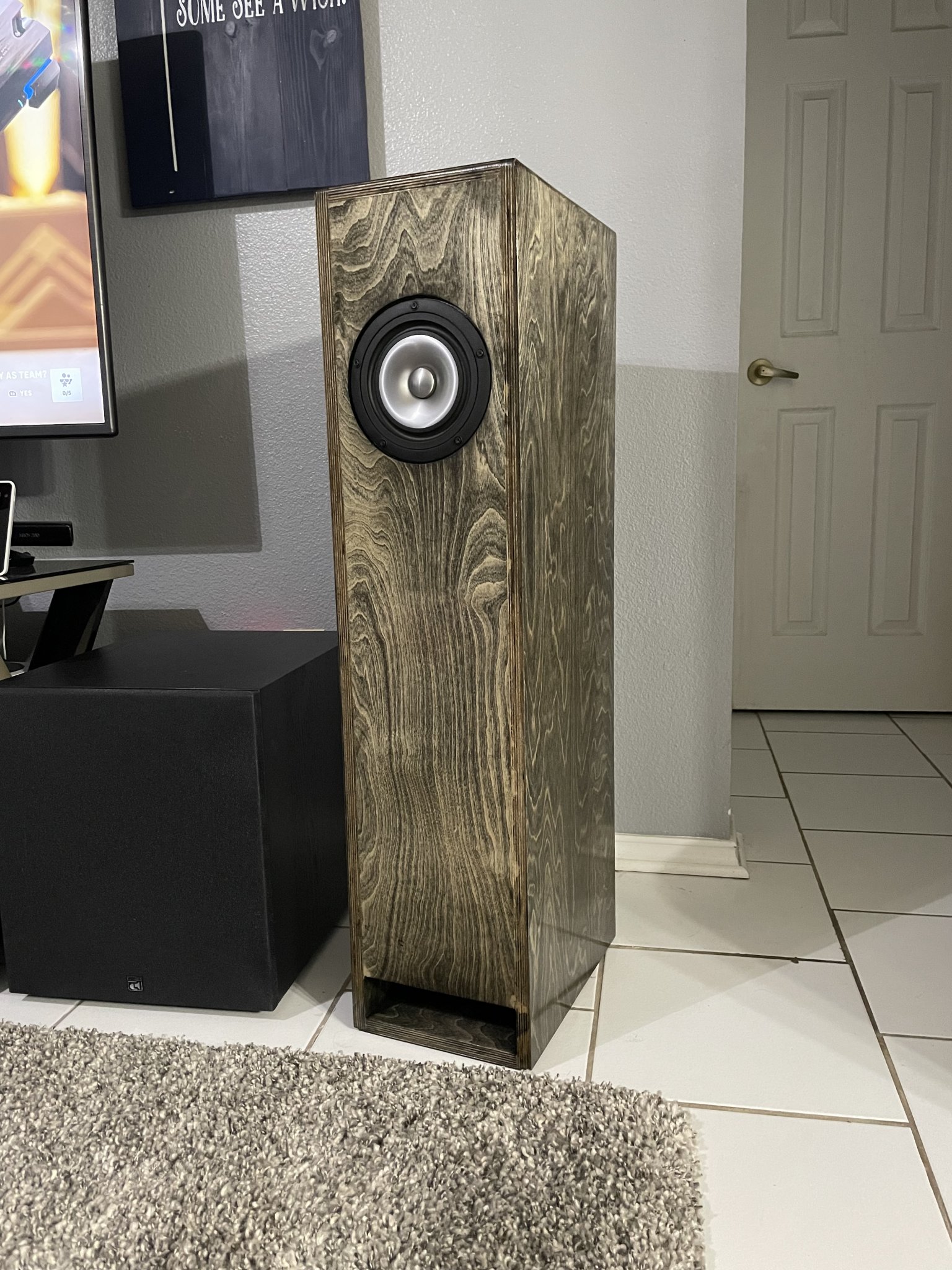

Just wanted to say thank you to such an awesome community and share my first build. I was introduced to Markaudio drivers a couple months ago by my father-in-law with a 3D printed enclosure for the CHN-50s. I had never heard a full range driver so magical and wanted to build a pair of towers for my main listening setup.
Spent a lot of time reading through posts here and landed on the Pensil 11. Built with 3/4” Baltic Birch, stained with black gel stain and finished off with polyurethane. Added the vertical brace from the Super Pensil. Could not be happier with the sound!

I think that you are on the right track. These enclosures are pretty easy to build and when I think of it, that is the most logical way to build. I mean, when I built the Klipsch corner horns, I never saw so many angles in my life. The results were amazing, but there has to be an easier way. For me, this is it.

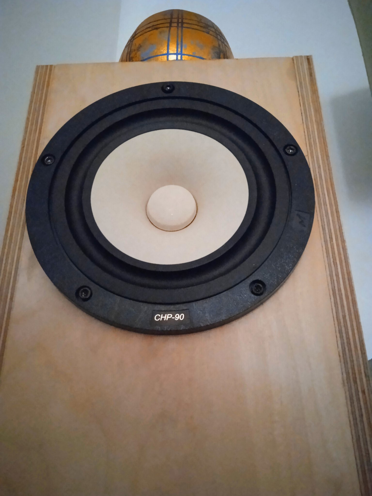

Frugal Horn Mk3s + Markaudio CHP90 Mica
Wouldn’t it be happier in FHXL?

FH3s are all I have.Wouldn’t it be happier in FHXL?
