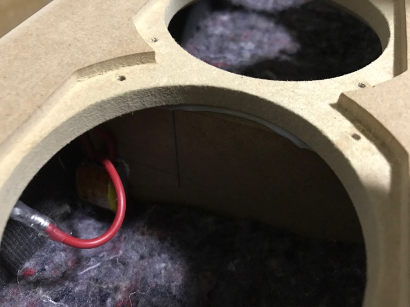

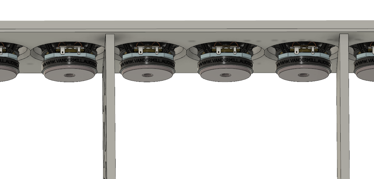

It appears you have the chamber perfed into five segments with each segment braced at 3/5. Given the 3.5" spacing, I hope the dividers have clearance for the backsides of the drivers. It's pretty tight in there.
Yes I do, I have an exact 3D model of the enclosure of which there are a few pictures posted on the first page. There is more space than you might think the dividers are 9mm thick.
597610d1486466257-full-range-tc9-line-array-cnc-cabinet-cabinet-v6-behind-baffle-chamfer.png
None of this is an accident and a lot of thought and effort went into getting the dimensions correct, don't worry everything fits as it should 😉

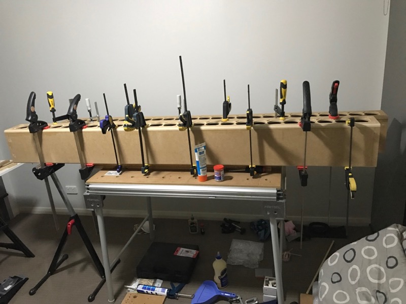

Building a line array is no easy task however you do it.

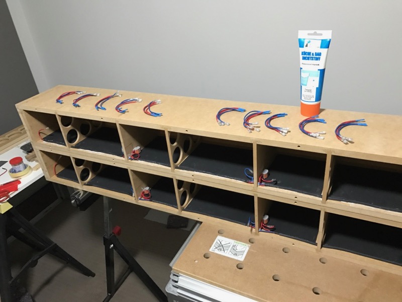

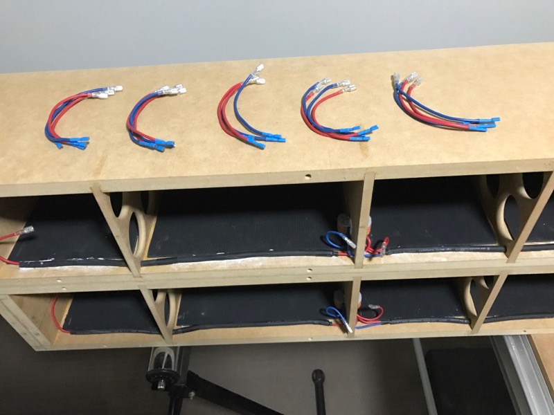

I have been working on some of those boring and tedious jobs in the last few days. Preparing wiring for 50 drivers is very ordinary work, reminds me of a summer job I had in an electronics assembly factory.
The parallel wiring for the spine is fixed in place and the series strips have been prepared.
You can see I used a different glue method for the bottom one because the top one turned out to be a mess. It makes no difference and will be inside the speaker but still...

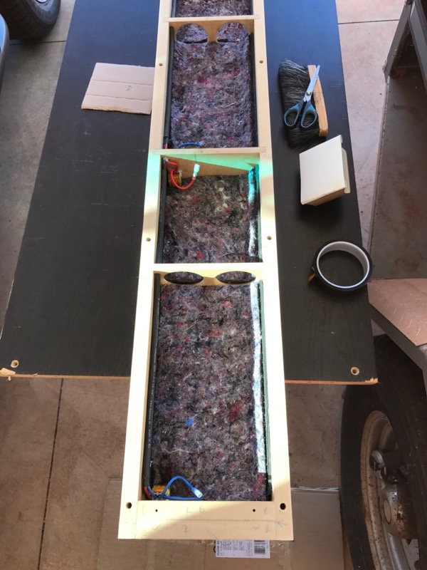

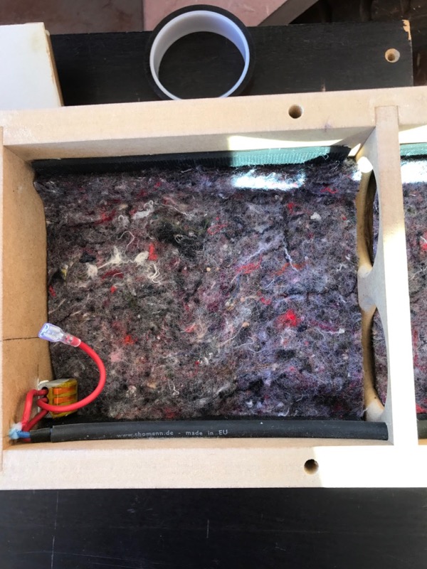

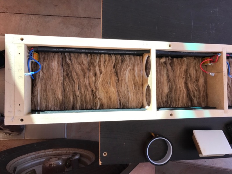

Pretty good progress made today

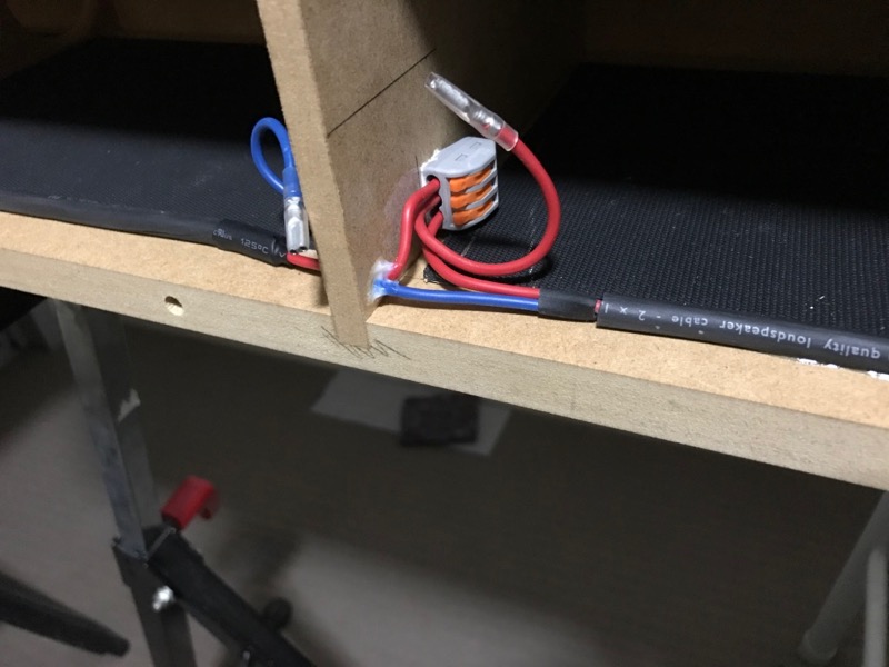

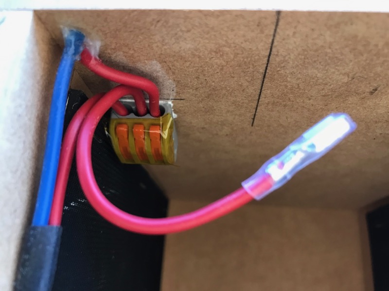

I put some Kapton tape over the lever terminals to make sure they don't get loose over time
attachment.php
I cut the fibreglass to a template this time to make it more even throughout the cabinet
attachment.php
I recut the felt too for the same reason
attachment.php
attachment.php
No going back now the baffle is glued on!
attachment.php
I used some silicone glue on the dividers to take up the gap where the driver hole chamfers meet to keep the compartments separate
attachment.php

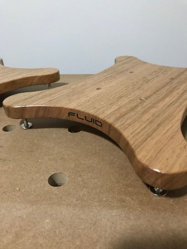

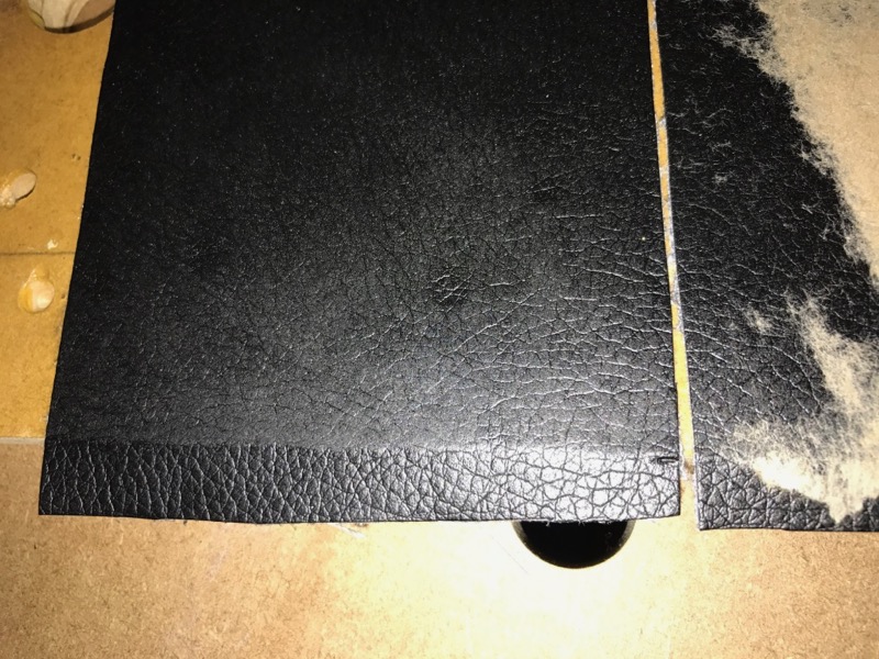

More progress
The bases are finished, they look very nice and the grain has come out quite well, couldn't resist a little bit of branding 😉
attachment.php

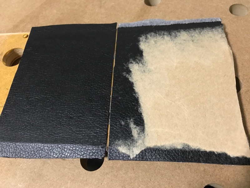

Lucky I did some tests of gluing the leather look fabric otherwise I might have ended up with a brown paper finish 😱
attachment.php
It takes quite an amount of heat to reactivate the PVA, too much heat and the plastic melts or the glue goes straight through and adheres to the heat shield.
The second test was done with baking paper on top of the fabric and an old cotton T shirt to create a heat break. Getting the right amount of heat is tricky.
You can see in this image that some parts have suffered from the heat and the leather grain pattern has flattened. Not an issue cosmetically as it will be covered by the fabric sock but still I would prefer it to be as good as I can make it.
attachment.php
