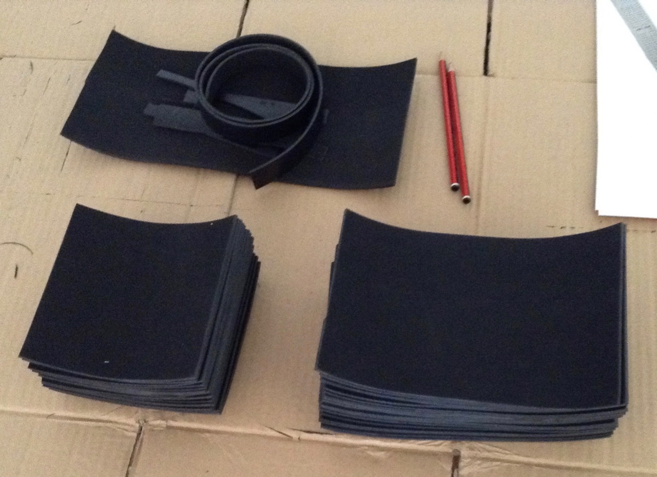

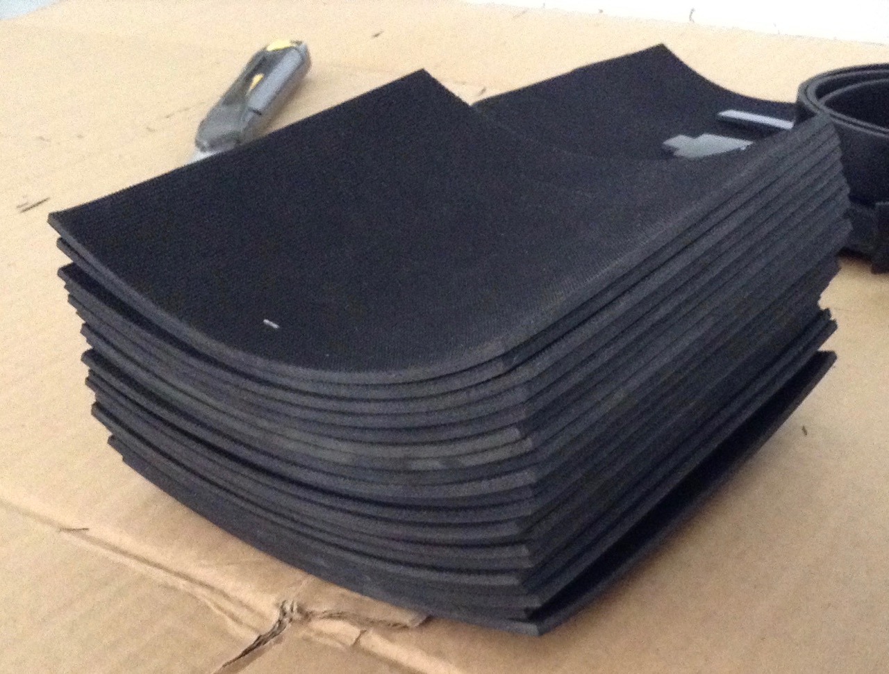

Rubber Damping Cut
Some progress today, I have cut the rubber sheet up into the correct size segments to go on the side walls.
Sorry for the grainy pictures. The rubber is now sandwiched between the cabinet parts for a few days to try and take out the slight bend in it from being stored rolled up for a long time.

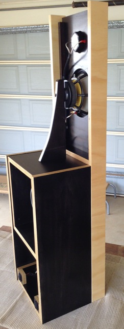

Next is to get the top and bottom plates glued together and some dowel holes drilled in the sides for alignment and strength when glued. These are the parts that are hard to get done by CNC as they are on the edges.
I have had to think of how I can glue it up in stages as it takes a lot of clamps, I have quite a few but not enough to do a full cabinet all at the one time properly. Because of the length of the panels I really need two clamps per brace along with almost the same amount again front to bak to keep everything aligned.
My plan is to
1. glue the top and bottom parts to the side with the dowels,
2. glue the back on
3. glue the braces in (then organise the wiring and fill with damping)
4. glue the front baffle on with some dowels for strength and alignment

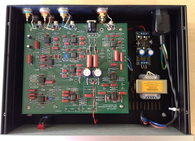

I have built two sets of Linkwitz dipoles. I started with Orion, an analogue crossover and LM4780 chipamps. The original painted MDF cabinet I made took some damage when moving house so I rebuilt the cabinet in a different style using hoop pine plywood and solid oak strips. I think it looks much better. It is hard to compare the sound as I have never heard the different cabinets in the same room. I also put the crossover in a nicer looking case.
As is always the case it took me so long to make the first Orion cabinet that Linkwitz had come up with a new version by the time I was finished. The LX521 was supposed to be better so I decided to build one and see. I wanted to use a DSP as the analogue crossover had become expensive and limited, Najda fitted the bill so I built one into a case with a linear power supply. I felt the chipamps were a little underpowered and could trigger the spike protection before the woofer gave out so I built an 8 channel Hypex amp to allow the LX521 to become 4 way active. There is also a picture of the LX521 in my current living room.
I was really impressed with Orion when I first built them, partly because it was the first really top notch system that I had owned, it was truly full range in comparison to the bookshelf speakers I had before and the room they were in let them work very well. The right channel had the rear wave firing into an adjoining room, the left channel also had plenty of space to the side wall and there was a good distance behind the listening position to the rear wall so there were limited early reflections.
I had moved twice by the time LX521 was completed fully and the room they are now in is much less dipole friendly. Rear wall is closer, side walls are closer and the rear wave contributes much more with a reflection off the front wall. The 45 degree toe in and dipole nulls to the side help control the side wall reflections and limit the damage from the TV and cabinet to some extent. Due to the dimensions of the room and the fact that it is smaller lead to a few bass notes being boomy until the placement was tweaked a little to minimize the effect from room boundaries.

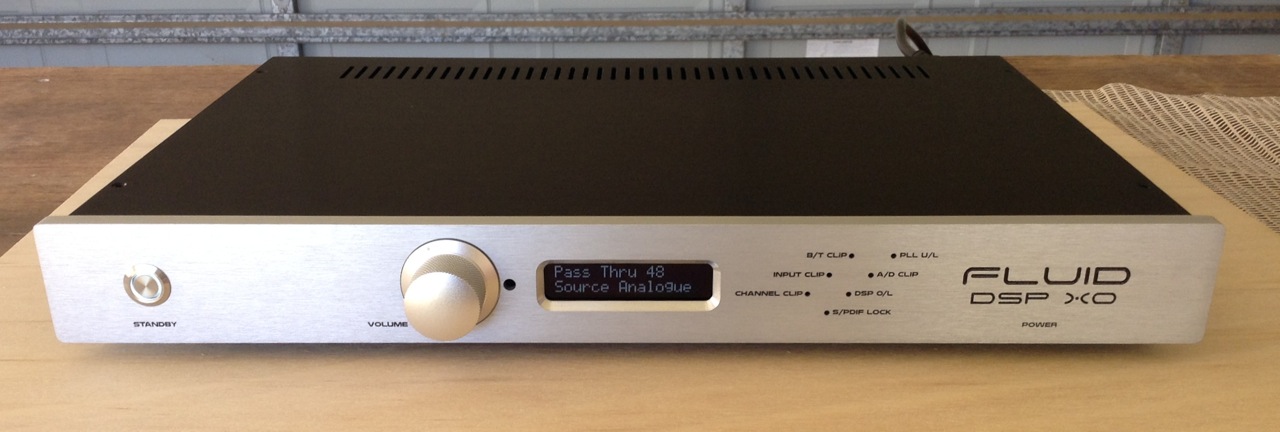

The LX521 has less dipole boost down low in comparison to Orion, I used the DSP to create a digital crossover for Orion and it was not as good as the analogue one. I found it very hard to avoid clipping in the DSP with bass transients and it was often tracks that I wasn't expecting to clip that did it. I had to apply too much digital attenuation and even with the analogue volume control in Najda with 15dB of boost to make up the gain, resolution was lost in the converters and it just sounded wrong. The analogue crossover had no issues with the boost needed.

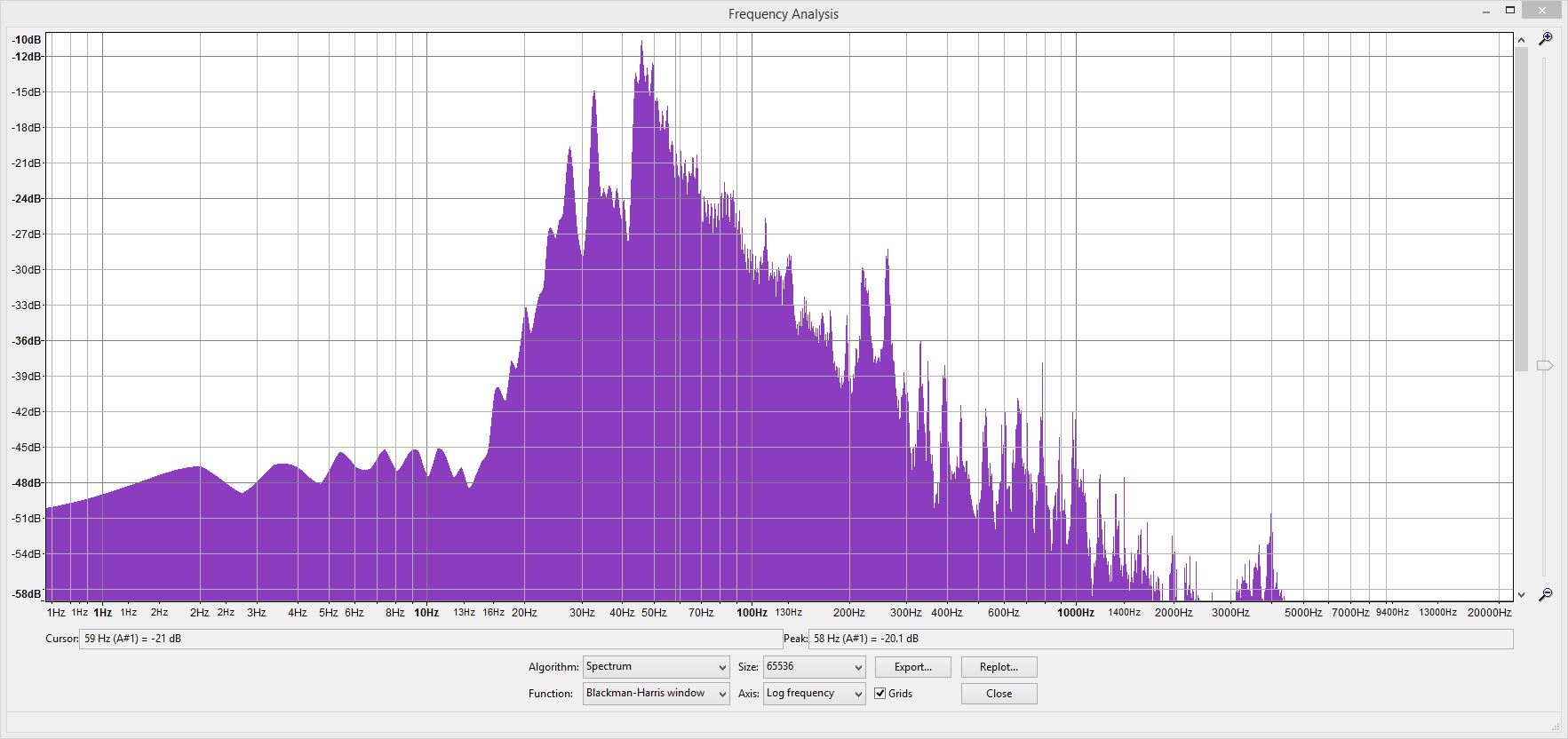

This track has a significant amount of very low frequency energy in a synthetic base line. It really makes the dipole woofers move!
This is the spectrum from Audacity
Wesayso if you are reading this have you tried either of these two tracks on your arrays? If you have I would be interested to know how they handled them.

The LX521 is IIR with digital delays and no all pass, Orion is analogue with all pass filters to time align. Both have a considerable amount of EQ to compensate for the dipole rolloff as well as some mild EQ for driver correction.
Both could have a rephase filter created to undo the phase turn or a full blown linear phase FIR version created. I can't see myself making a linear phase crossover though as it doesn't make sense to me, too many taps needed to control the dipole EQ down to nearly DC.
Others have made efforts to make linear phase versions and I don't hear much from them saying it is any better. I wonder if the benefit comes when you have controlled the early reflections or avoided them by near-field listening like you do. Perhaps the more reflective in room nature of the dipole masks the benefit you and wesayso have found, just speculation though.
