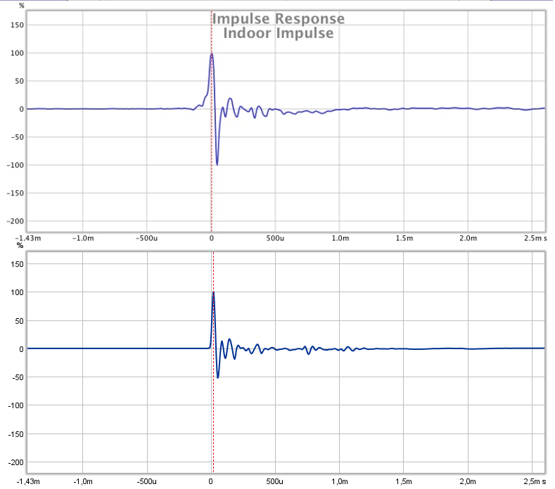

Maybe it means nothing but notice your IR have kind of soft take off at attack side of IR, same had xrk971 before he went from think it was Dayton UMM-6 to miniDSP UMIK-1 USB microphone. Could it be sample rate converting inside Windows or hardware sample rate converting in your chain somewhere, below visual show what i mean in upper one is your single driver from post 394 verse lower one that is mine TC9 single driver measured in 192kHz chain and scaled as close to yours as eye could tweak.
Interesting observation Byrtt and you could be right. It is definitely not windows because these were measured on a Macbook Pro ;) The Najda has an SRC built in like most DSP's and it cannot be switched off. It can only be 48, 96 or 192KHz.
I have left REW set to 44.1 forcing the SRC to kick in. I can change REW to 48KHz and retry. I can't listen to music that way as it is all in 44.1 which is why I didn't bother in the first place.
The scarlett is set to 44.1 because that was what I did the loopback calibrations at but that should not be an issue because the audio has gone from digital to analogue before that rate change happens.
I am using a Sonarworks calibrated measurement mic into the Scarlett, I don't have a USB mic.

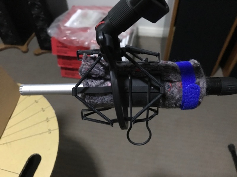

Fine view i just FELT :D it was so easy to do and probably look great from outside sock.
I had the same thought but it is not easy to form the edge of the felt I even found it difficult to get a clean cut with a knife. I used a very sharp pair of fabric shears and than did a good job. Because of the length of the line a wavy line stands out a lot.

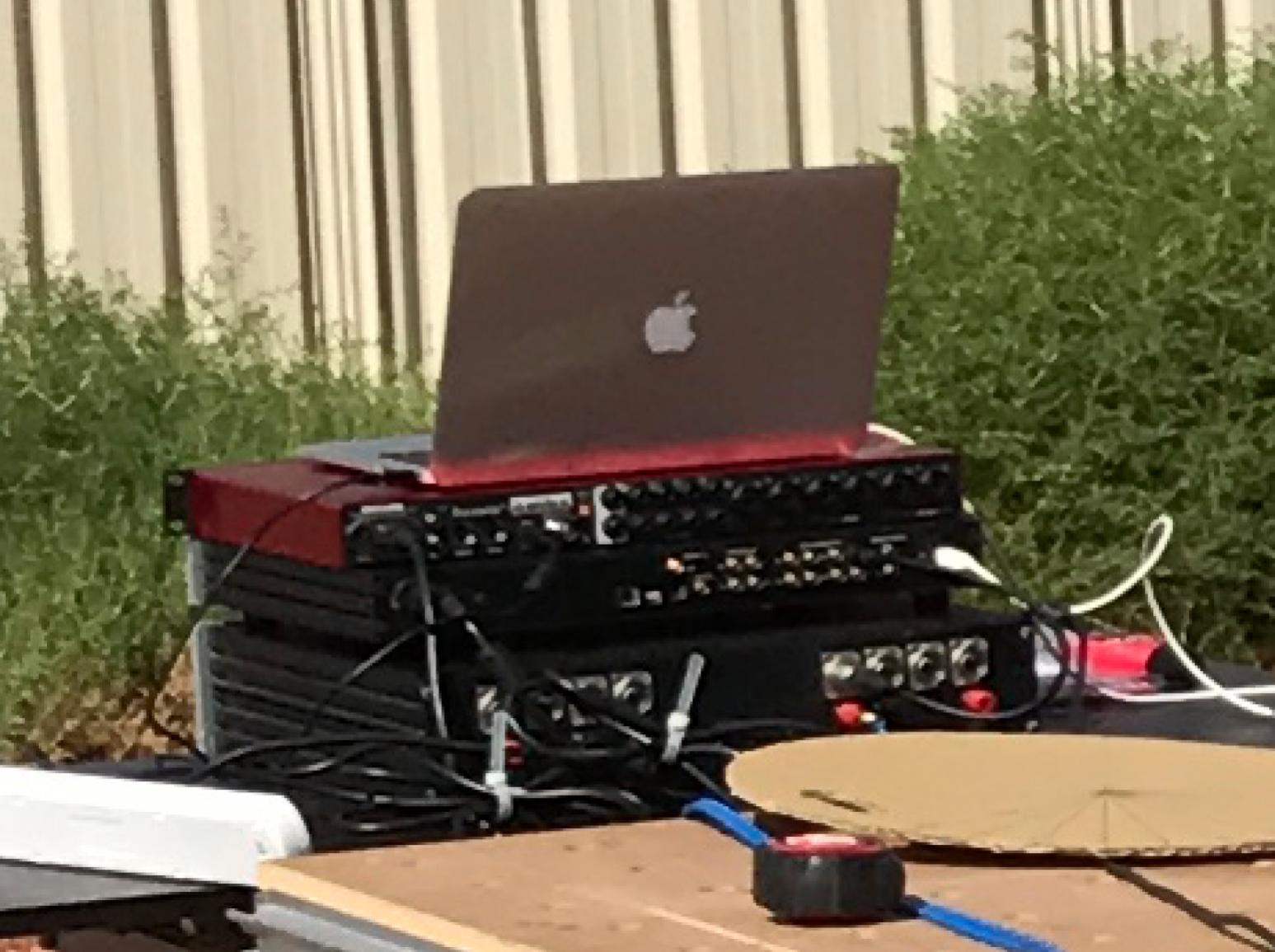

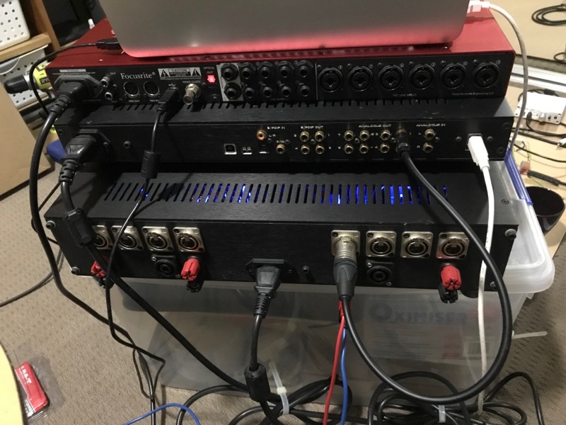

This is the best zoom I can get on the picture to show the back of the equipment. White USB cable goes from Mac to Amanero inside the Najda as a source. Other USB cable connects Mac to Scarlett Interface. The Najda has a short RCA to XLR connector to the Hypex amp. Mic cable goes direct to the preamp front connector on the Scarlett. Gain on the preamp was set mid range to get a decent signal but avoid excessive noise. Blue cable is banana to speakon not connected to speaker in that picture.

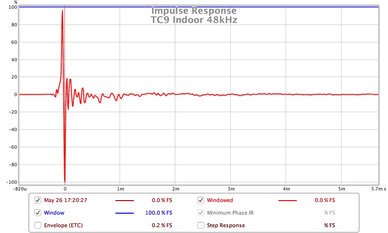

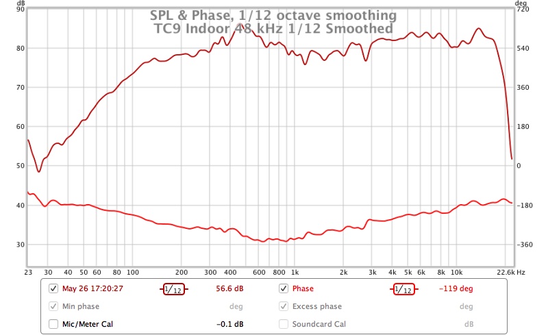

Well it is not a mismatch in the sample rate causing the issue, I have tested with everything set to 48kHz and the part before the impulse is still lumpy. There is a pretty high background noise level in my house which I was not really aware of before putting a microphone in there.
I might try reducing the mic gain and upping the measurement level to see if it makes a difference.
It could be that the SRC chip in the Najda is responsible regardless of the sample rate. I will try and test with another DAC although I don't have an analogue volume control in working order at the moment which might make that less successful.

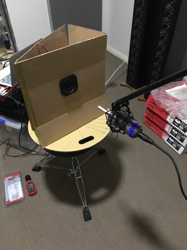

Here are some better pictures of the test setup for Byrtt and the frequency response and impulse of the test measurement at 48kHz. And for Perceval it worked for me so maybe try the latest version of REW and see if it works for you.
Back of the test rig
attachment.php
TC9 Cardboard Baffle
attachment.php
Mic in felt, inside mic mount that it was not designed for
attachment.php
attachment.php
attachment.php
attachment.php

It's strange though, the peak that hits 100% is the downward one.
Not like BYRTT's measurement:
I do think it's caused by something in the chain somewhere. I've seen enough TC9 IR's to assume they should look like BYRTT's bottom example.
I'll add another thought, my DAC connected in USB mode never measured as cleanly as it did with SP/dif.
