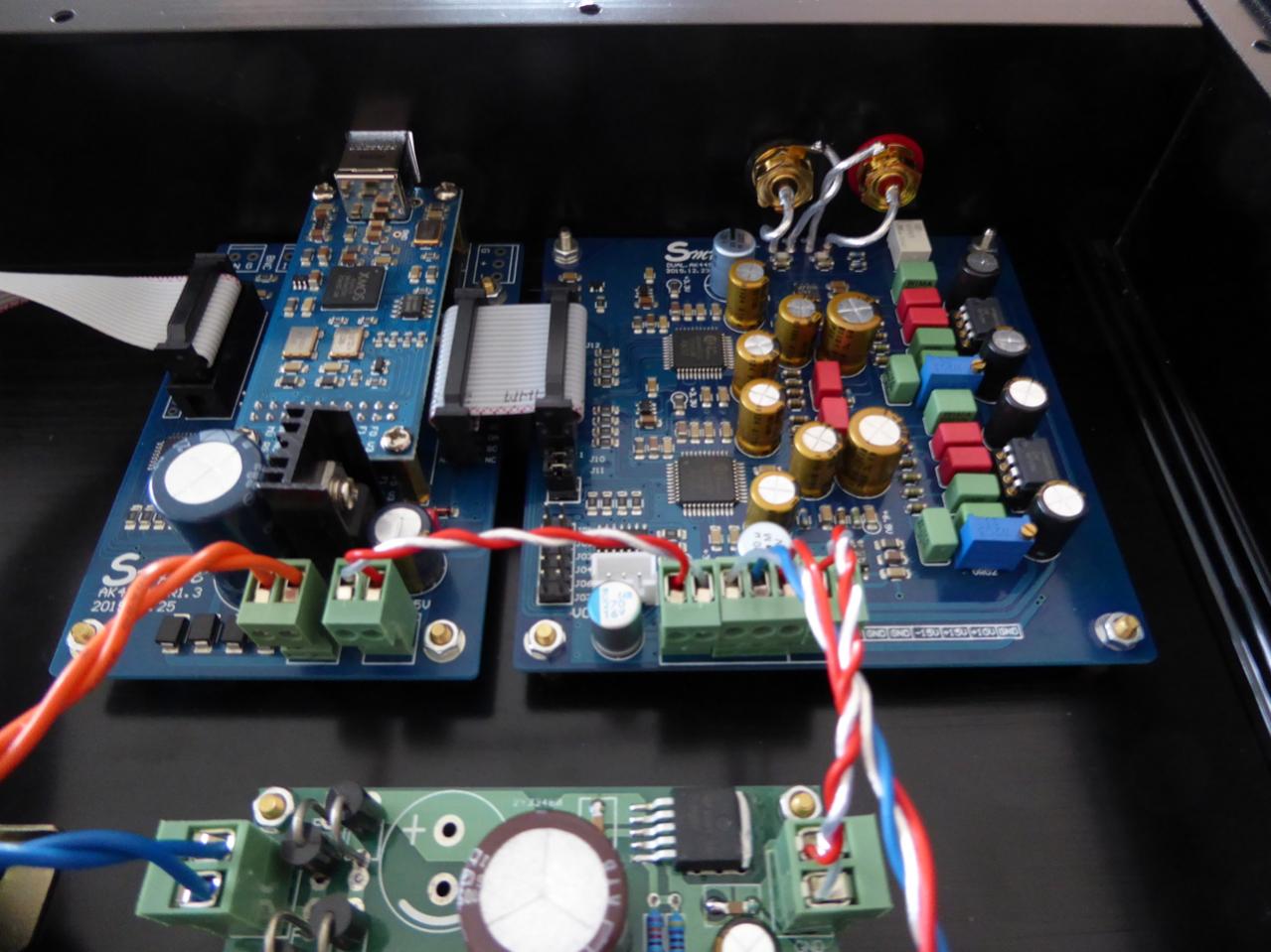

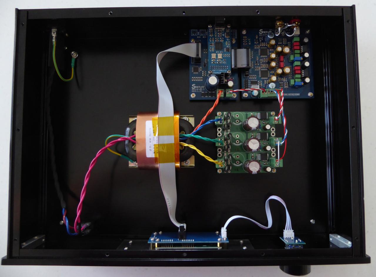

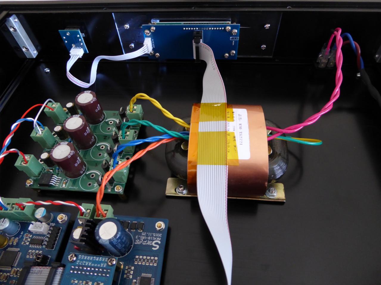

Sounds like a nice DAC you have there in that AK4490 : )
I mistyped it is actually a dual AK4495 DAC and for the price I paid for all the components it sounds great. The USB input is why I was happy about the USB2 driver because before I had to turn off driver signing to install it. Here are some pictures basically the same chassis as the LKS DAC.
I plan to get one of those remote volume boards I mentioned before from Taobao that use the New Japan resistive ladder volume chips. If that doesn't work well I have a relay controlled resistor board I can use instead.
It does different to the LKS ES9018 that I built, but that cost quite a lot more and I'm not sure I could actually pick which was which in a blind test.

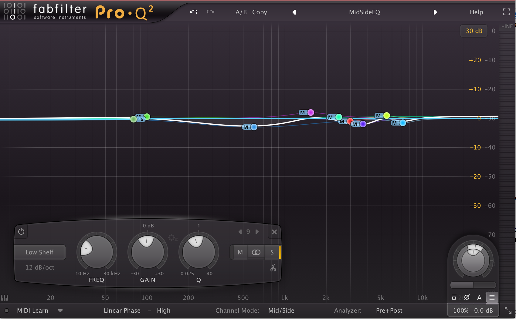

Mid /Side EQ has worked well for me I don't hear any tracks where it doesn't make things sound better, it does need to be linear phase EQ though to have the desired effect.
I tried a correction based on single position measurements and an average of ear positions. That did not work well and sounded very "processed" I put that down to the fact that my room is untreated and leaving more of the room in the measurement forces DRC to try and fix it which does not work out well. If I was to use a single position measurement I would have to dial back the correction and make it much weaker.

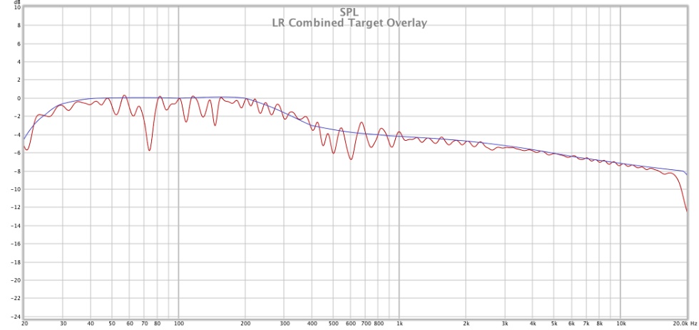

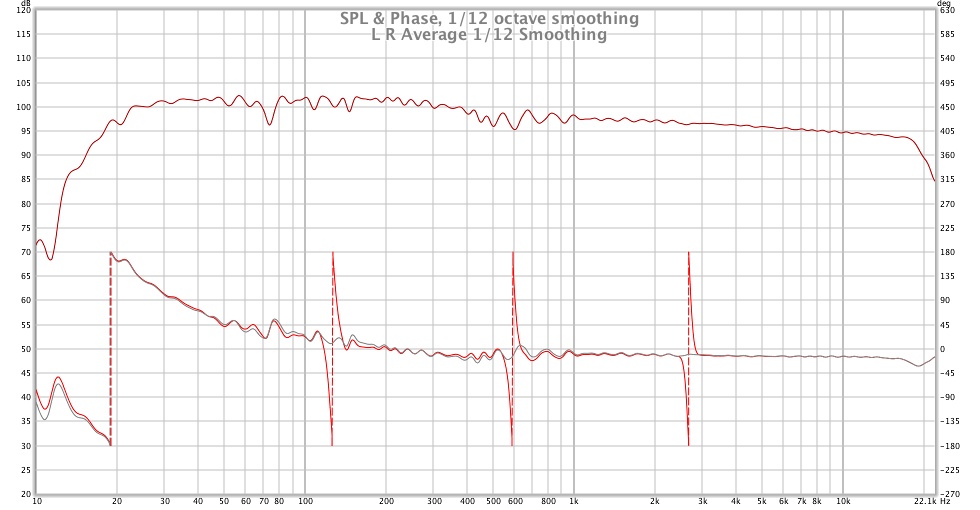

This is the Left and Right channels averaged after correction. This is the average measurement across the listening position used as a base so not an exact listening position measurement. I think it is a good representation of what I am aiming for though so take it for what it is.

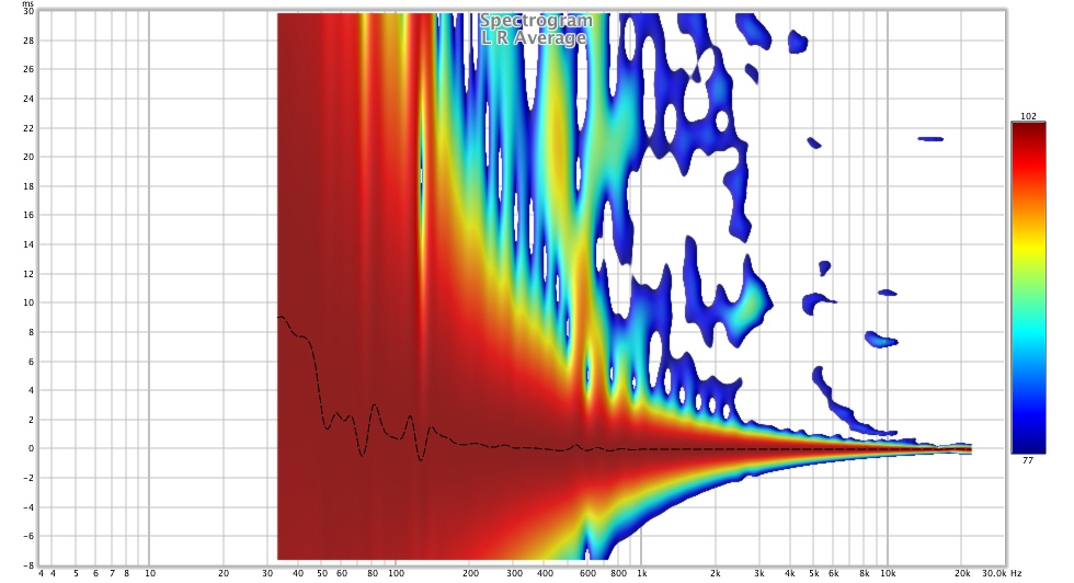

Thanks Byrtt, I don't think I can be bothered to mess with APL_TDA at the moment and the next Beta of REW should have a function that will make the graphs look more similar.Wow looks and sound hard work all over starts pays back, even room is untreated system starts looks as good candidate perform over average result into APL_TDA trial version, enjoy system and thanks sharing stuff.
For now this is the Spectrogram of the Left and Right Averaged, there are some issues but overall for no treatment I am happy. You can see the peak energy curve is a little wiggly below 200Hz, but it is a whole lot better looking than without correction.

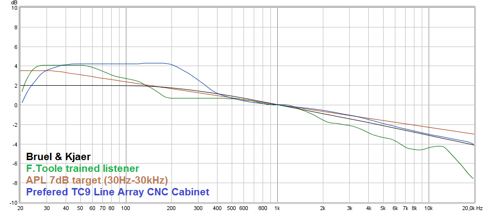

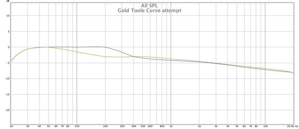

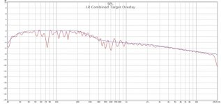

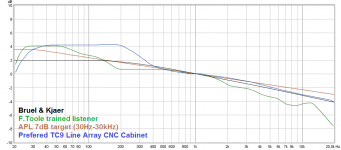

There is a reason it is similar. I tested with a Flat target in DRC and then used PEQ by ear in Jriver until I got something that I was happy with. Guess what it looked remarkably like the 1dB/Octave slope.

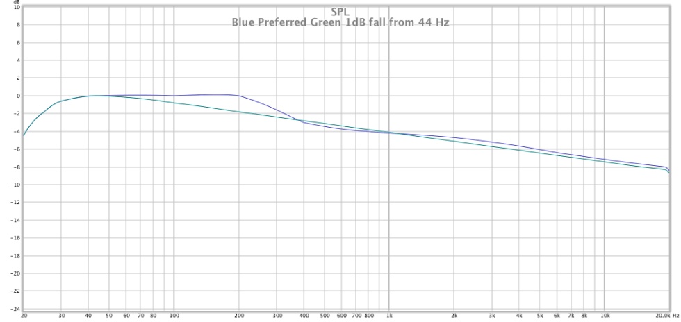

This is the Left Right Average compared to my preferred target

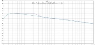

This is the preferred target against the 1dB fall off slope. I like at bit more in the 200Hz range, a bit less 500 to 800Hz and a slight knee at 2-3K, not very different though and I listened to the 1dB curve for a long time because it was hard to find fault with.

Yep I tried to make a curve like the Toole one but I didn't like it as much as the blue one. Don't now about shivers but I have heard some really good stuff, Diana Krall's Live in Paris is sounding very good and Giant Steps by Buddy Rich is fantastic. Get Lucky is really good and the bass drum and low toms in Steve Earl's Copperhead Road is very atmospheric.
Good point to wait for REW get new feature of similarity had almost forgot about that info myself, your current curve looks simply great and in my eyes far over average accounting result is at listening position.
...You seem to like it just a bit warm, just like me...
fluid is general warm
Looking at wavelet could maybe tell about the preference a bit less 500 to 800Hz.

120 Hz, 500 to 800 and 2.7K are where the reflections do some damage. But looking at the Spectrogram lowering the 500 to 600Hz region a little more might be worthwhile to try.Looking at wavelet could maybe tell about the preference a bit less 500 to 800Hz.
