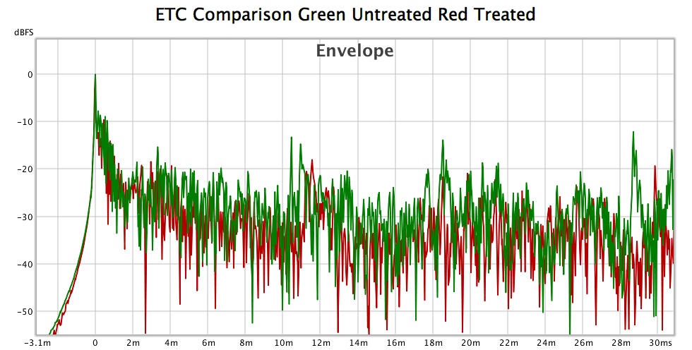

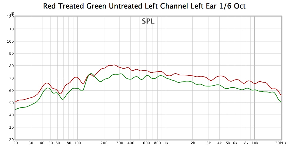

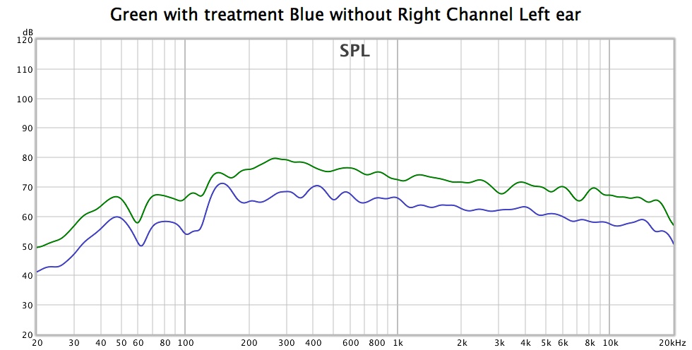

Here's a couple of comparison graphs showing the differences between treated and untreated, frequency graphs smoothed at 1/6 oct to try and show the overall trend. Less bump and dip easier to correct below 1K, above shows more dips probably because they aren't being filled in by reflections.

Not easy to read this but you can see the red is lower in level and less restless overall

What do you hear, as a difference between the two in listening?
It is obvious there is a definitive improvement in direct vs indirect sound.
Does it get "more quiet" in comparison? Less wild? I think this gives you an excellent base to improve upon with further processing. Most reflections are down below the -20 dB (which was my initial goal) and gives an opportunity to play with ambience addons later on.

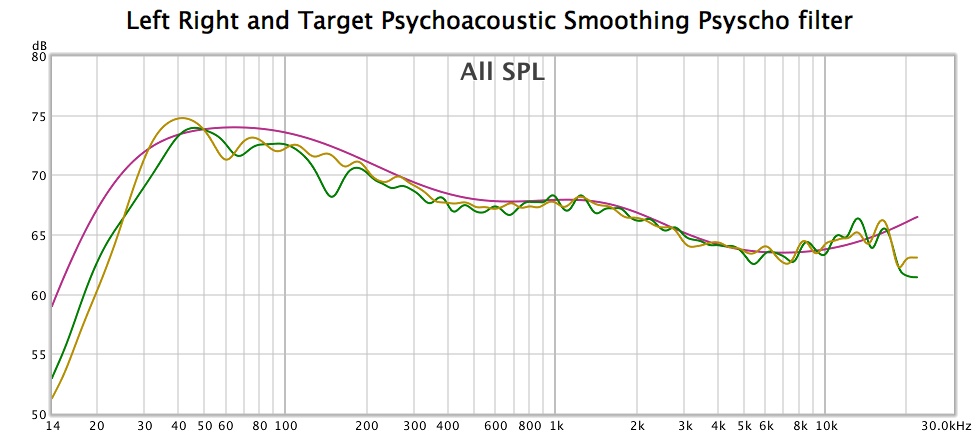

I have been testing out your new psycho filter to see what it does. I quite like it, very different to what I've been doing before as the windows are very short and using quite different exponents. I like the way it is not filling in the dips, which parameters are responsible for that part of it?
I had trouble on the first run getting the channels even. Round two with better tuned pre EQ is looking better, I haven't listened to this one yet but it looks much better 😉

Untreated looks better. Sounds? The blue ans green traces, why would anyone want to improve these - looks smashing. My experience of "damping /absorption" is that it sucks the life out of the music. Every time I tried, I lived with for a while but in the end always preferred the none damped. YMMV.
To me treated looks better below 600Hz less resonances being exited. The plots are smoothed with a fairly low scale value (used to show the general trends). Sound of a raw array with no EQ is not great, but if subs were being added to those plots they would need much less EQ.
There is something that has been lost from the damping panels which is why I want to try the ambient additions to see if I can get that back but not lose the clarity and less resonant low end that came from the damping.

Thanks for checking it out, and glad to hear there is some potential there. I think it could make a nice compliment to your acoustic treatment.
In the EQ stage, the dips are not weighted nearly as much as the peaks; this is simply the behavior of the psychoacoustic target stage algorithm, which in this case is what's generating the EQ curve. What I did adjust regarding the PT stage, however, is its resolution. It's Bark scale, so its resolution in the lower treble range basically matches that of the prefiltered response, but the Q-factor decreases above and (especially) below this range.
For channel balancing, try convolving "ImpulseResponsePrefiltered.wav" with "PsychoFilter.wav", and look at the L/R peak levels of the resulting response in Audacity.
BTW, Re your target: I recently created a target response file named (of all things) "PsychoTarget.txt", which matches the general trend I see with my anechoically corrected speakers measured at the listening position. It's similar to a linear tilt but the slope changes by a factor of 1.73X (root 3) per octave rather than 2X (root 4). Your target reminds me of that response but with "loudness compensation" applied...
According to that I need to reduce the right channel by 1.189dB I'll try it and see what happens.
