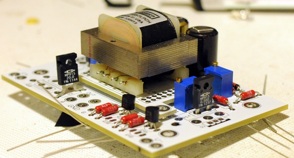

I just finished dry fitting the parts.
attachment.php
It seems that R13 and R14 are 0.5R caddocks (for IRFs), R2 is a 20R Caddock, a 9.1V zener for the led reference.
Are these correct? Also, what is the polarity mark on the Jensens? Or should I just align the letters and then the dot on the boards?
I m also a bit concerned about the zener polarity. Do they look ok?
Also about the FE, with 10mA jfets, I guess we only populate Q3A qnd Q4A right?
I also do not have an R1. Justin did you forget that one or it would not be included in the GB?
Thanks again for a nice package.

Also see post #41 for link to Jensen pdf, and post #144 for a nice pic of proper daughter card orientation.
Some good info in Tea's F6 blog about FE considerations. My understanding is you're good to go with one pair 10mA jfet and R11/R12 as supplied by buzz.
BK
Justin's mention of the offset makes perfect sense.
Basically you cannot solder the Jensen on the daughterboard in a wrong way unless you force it and bend the pins significantly.
You just have to be careful to follow the dots on the boards to attach the daughterboard
