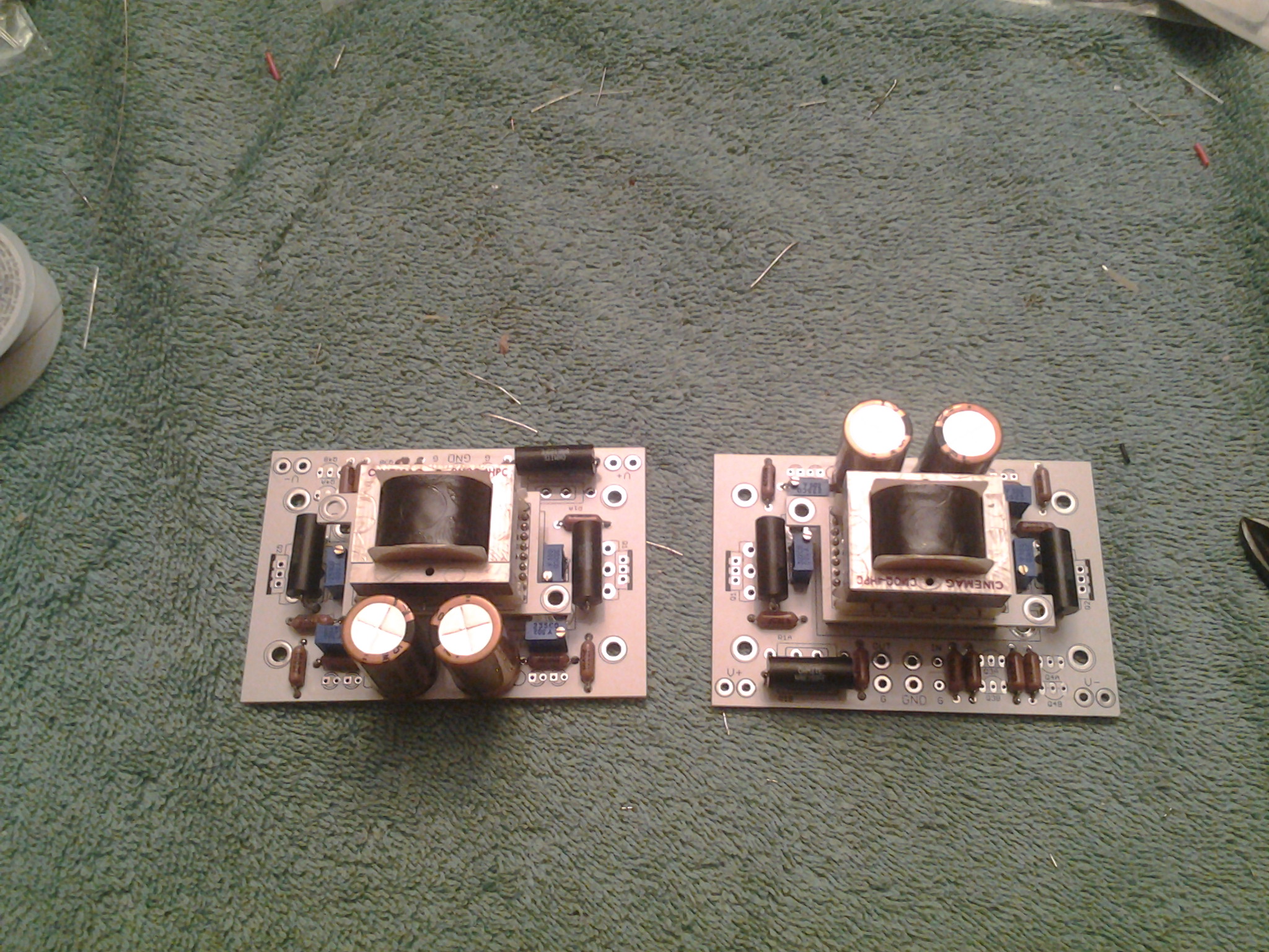

I am psyched!!! My Cinemags arrived on Monday and I ordered all the stuff from Mouser yesterday...should be delivered tomorrow.
Just need to tap some holes in the sinks and I should be good to go.
Only major issue is that I am using a PSU designed for a different amp. Currently it runs at 32V running at about 150mA per channel. Jacked up to 1.5A per channel I suspect around 28V according to PSUD.
I have enough jfets to run cascoded, 28V will be pushing it for the 2sj's.
Maybe run two pairs parrallel and degenrate them. But I would not let the voltage be the limiting factor.
Just bias lower to start.

What is the VA rating of your toroid? 28v wil not hurt the FE Jfets at all, assuming you degenerate them.
In case you didn't see, and I don't think I posted it here.
Here is my blog on the F6 board. Not a full blown construction guide, but gives a visual of a working board and the possible jumper spots.
Its a 300va antek. And yes buffered with degeneration is the plan.
