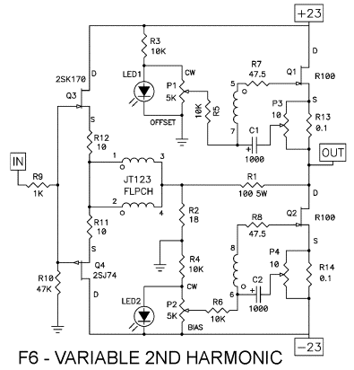

OK took the jfets out and jumpered the input to the xformer input. Is there anything else I need to do for unbuffered?
I can not get the mosfets to bias up now. Running 2 blue LEDs each rail.
Do I really jumper the source resistors? They are 0.5 ohm. I also have the harmonic pots in place. Do those really need to come out and be jumpered?
I removed the harmonic pots and no effect. I can adjust the offset but for some reason voltage is not getting to the gates.
Might have to yank the MOSFETs out next and see if something fried them when the jfets cooked those 2 resistors.
PLease post pics of boards. IF you pull the pots, you must jumper that position. Pull the mosfets, and test just the bias section. Post pics first as we may be able to spot something. You can test continuity on the board with DMM any questionable location.
Assuming the jumpers are on the pot positions near the source resistors -
Here is a pic from blog with jumpers over P3 and P4. They connect 'to the right' of the Pot.
It may just be that you need to bias the crap out of your IRF's.
Regardless of output FET types (R100 or IRF etc), this unit bias's up from nothing to a lot very fast. Always have the plug ready to pull!
The cost of the parts kit is $63.10. It includes all the components in this schematic. I am using PRP, Caddock, and Elna Silmic II. They are excellent quality for not much money. I will post a link to a GB sheet in next couple of days. I will also look into the the cost of both Jensen and Cinemag transformers and at that as an option. Do not forget about the toroid GB going as well. It is our best chance of getting a quality power transformer at reasonable prices.
