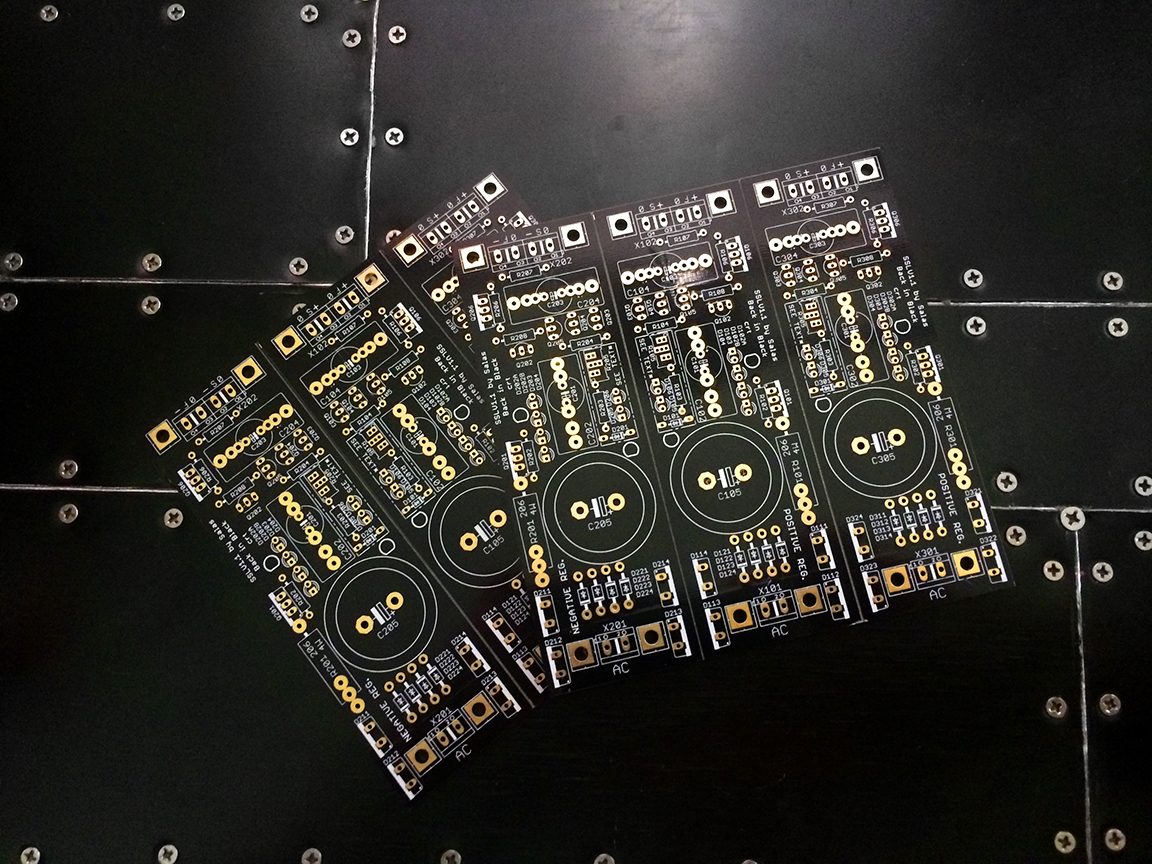

your goodies arrived safely to the West Coast. Boards are really beautiful and well made. Thank you for letting me in at the last moment of this group buy. I did a quick shot with my iPhone, so photography does not do the justice but they are solid.
Thank you and Salas for such a great product
