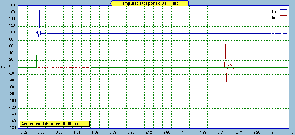

The overal area above and below zero must be equal over infinit time, and also dependent on driver characteristics. How this area distribution occurs depends on driver performance. Therefore, it is not necessary to have a large negative impulse immediately following the first positive one. Also bear in mind that if you use a Klippel system to do DC measurement, lots of drivers have DC. How fast the impulse goes to zero also depends on low frequency content decay.gedlee said:
This is completely wrong because there HAS TO BE a large negative impulse when there is a positive one because the average must be zero. And since the impulse response goes to zero very fast this average must be zero over the short term. And you say yourself that "The latter two impulses do not have this" and they must have!! I'm not going to argue this point with you its too fundamental.

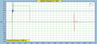

This is a tweeter with response of 30KHz. This kind of impulse basically has the kind of first and inverted relationship. The real difference between the second impulse in the 2nd impulse of the 4 comparision is that the peak of the inverted impulse in this one is not larger than the first part. Thus better.
soongsc said:... the peak of the inverted impulse in this one is not larger than the first part. Thus better.
That is completely ridiculous.

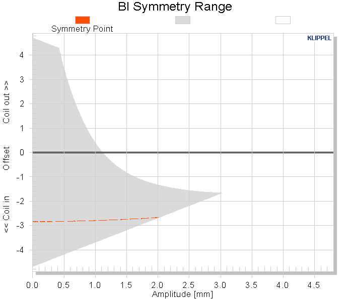

No. Because if you actually do the calculation of the condition you described, it would be very dependent on driver performance. I have not seen any driver that would measure perfectly symmetric on a Klippel system. So the response cannot be symmetric. This is very different from idealistic math models.gedlee said:
I give up. What have I been saying all this time if it isn't an explaination of the "theory"?
I don't see how Bl symmetry has anything to do with it. The issue is the actual acoustic response to an impulse. The driver is at rest, there is an impulse with some overshoot and damping, then the driver is at rest again. The total response in integration about the rest position must be zero when integrated to infinity. Integrate over a finite time period, sure, it won't be zero, but that's not what matters.
