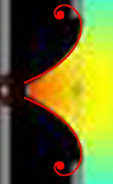

In the simple sims I did with the BEM software, it seems that in order to obtain optimum design of a horn/guide, it is necessary to consider wave travel starting from the diaphragm. I am sure Earl realizes this, otherwise he would not have considered designing a phase plug as he mentioned earlier in this thread.
The length of the part from the diaphragm is critical, especially in an OS wave guide because the exit of the throat acts like a lip of a wave guide, only at a higher frequency. Too short, there will be HOMs above certain frequency. Too long, then there seems to be some kind of reflection from the throat exit. From what I can see based on sims, it would probably be very very difficult to get a pure plane wave at the smallest section of the throat at all frequencies. So right now, I'm really wondering what the third wave guide in my test will be.

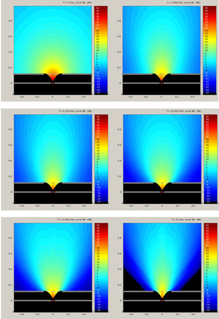

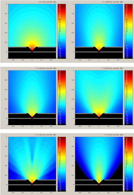

To give everone a feel as to what is going on, here is a new set of pics. Basically quite a ways back I posted a pic indicating how the throat, guide, size effect how dispersion is controlled which had inspired me. Also inspired by lot's of things mentioned in this thread by Dr. Geddes, this BEM software really is good to explore various options to get a general feeling what's going on. It's not coing to be accurate for a final call, but it's good enough for those without much math capability to get things rolling.

You'll be interested in the comparison between the profiles of waveguide you presented to us in your last message and a Le Cléac'h horn calculated using:
Fc = 650 and T = 2,7

Is it possible to show the pattern out to 1meter distance? It seems a good idea to look at different frequencies. I am interested in how various shapes effect the overall pattern, if the pattern looks funny, then I zoom into the throat area.
