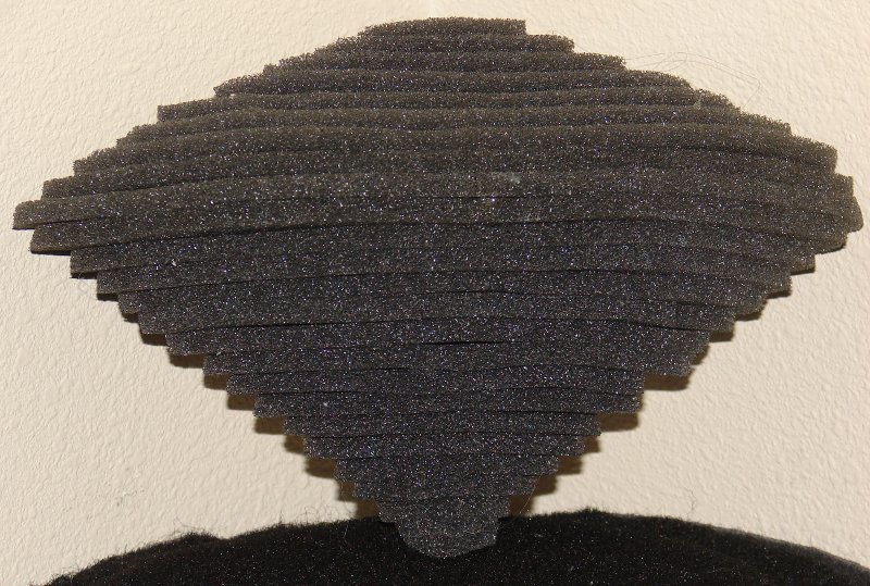

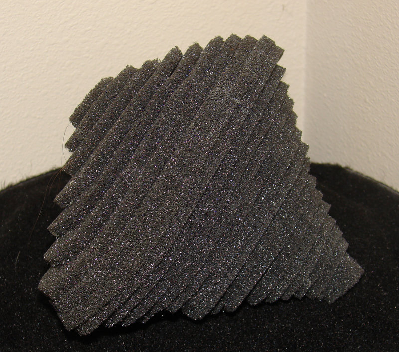

winslow said:The foam is an absolute pain in the rear to cut and shape. You can find the same foam for sale, but cutting it and making it look good is the hard part of using it. The palce I got mine only has it in 2" thick pieces.
This is the foam plug from the Unity horns that I was running in my car, documented on Richard Clark's forum in 2006.
Note the one I built is stepped (as I built it up layer by layer.)
- Geddes on Waveguides
