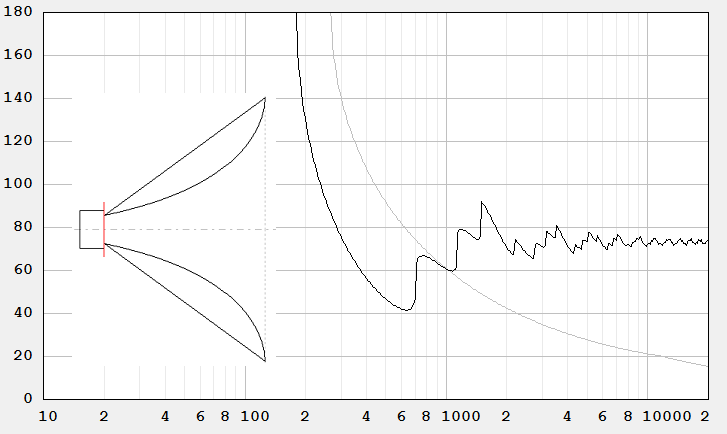

Smooth Horn Profiles using a C-Bezier Transistion Curve
Yes! And you want it change gradually, increasing away from the throat and decreasing towards the mouth; approaching conical in between. WHG

This is so simple today with a good cad program, I think that Solidworks does this with a simple spline and setting the end conditions to tangent. I think that is a Bezier curve it generates.
... but not necessarily simple.

4) All variants of the Bezier Curve are NOT the same. C-Bezier curves will exactly follow the loci of all the conic sections; others will not, and the latter is what you are likely to find in a typical CAD program. That is why I present this paper here.
5) It helps to understand the math behind the function, so you are able use it intelligently.

It is the horn profile we are dealing with here. Once its geometry has been established, it is rotated about the designated axis to form surface of an axisymmetric horn body. For an OS horn the profile is a hyperbola (a specific conic section) which approaches but only becomes a straight line at infinity. The ideal curve to use to depart from this geometry should not introduce discontinuities in horn profile curvature. To do this, use a transition curve to avoid such discontinuities that will otherwise be introduced. That is the issue plain and simple. WHG

I designed and developed hyperbolic horn shapes long ago, I do understand what can be accomplished with those shapes and I was doing that development with radial horns to correct the errors that were common to all radial horn designs at the time. This is what caused the pinched throat of any radial horn at the time, a discontinuity between the throat section and the horn flare. Mathematically they were always done incorrectly but it was expedient to produce the tooling that way. I was working with what I called hyperbolic exponential elliptical radial horn shapes long before I ever saw anyone else propose that idea. this was in 1976. There were no computer programs to do that and the math was not simple as we were working with elliptical shapes and it was all calculus.
Now when we are talking about what most say are conic horn shapes those are not typically an Oblate Spheroid, but a simple planar flat walled conic section. This is what Danley and others are doing to produce what they call constant directivity horns, not a horn with any curvature to the flare, that will never produce a true constant directivity across the entire bandwidth. All frequencies must see the same constant wall angle to conceivably produce a true constant directivity, anything else is as I say purely a semantic argument. It can only be accomplished with an infinite horn at that, so this is all just a silly argument. It truly is impossible, every horn shape is a compromise and all we can do is make the best compromises possible.
