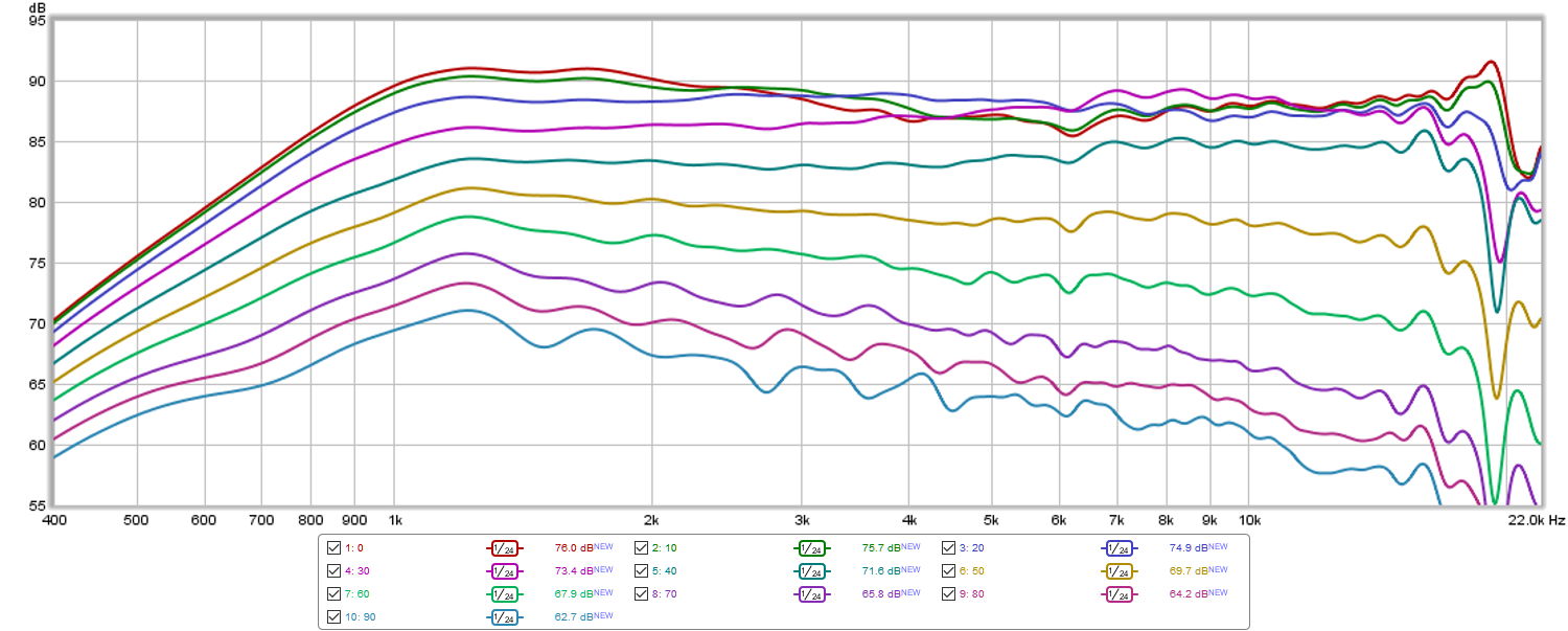

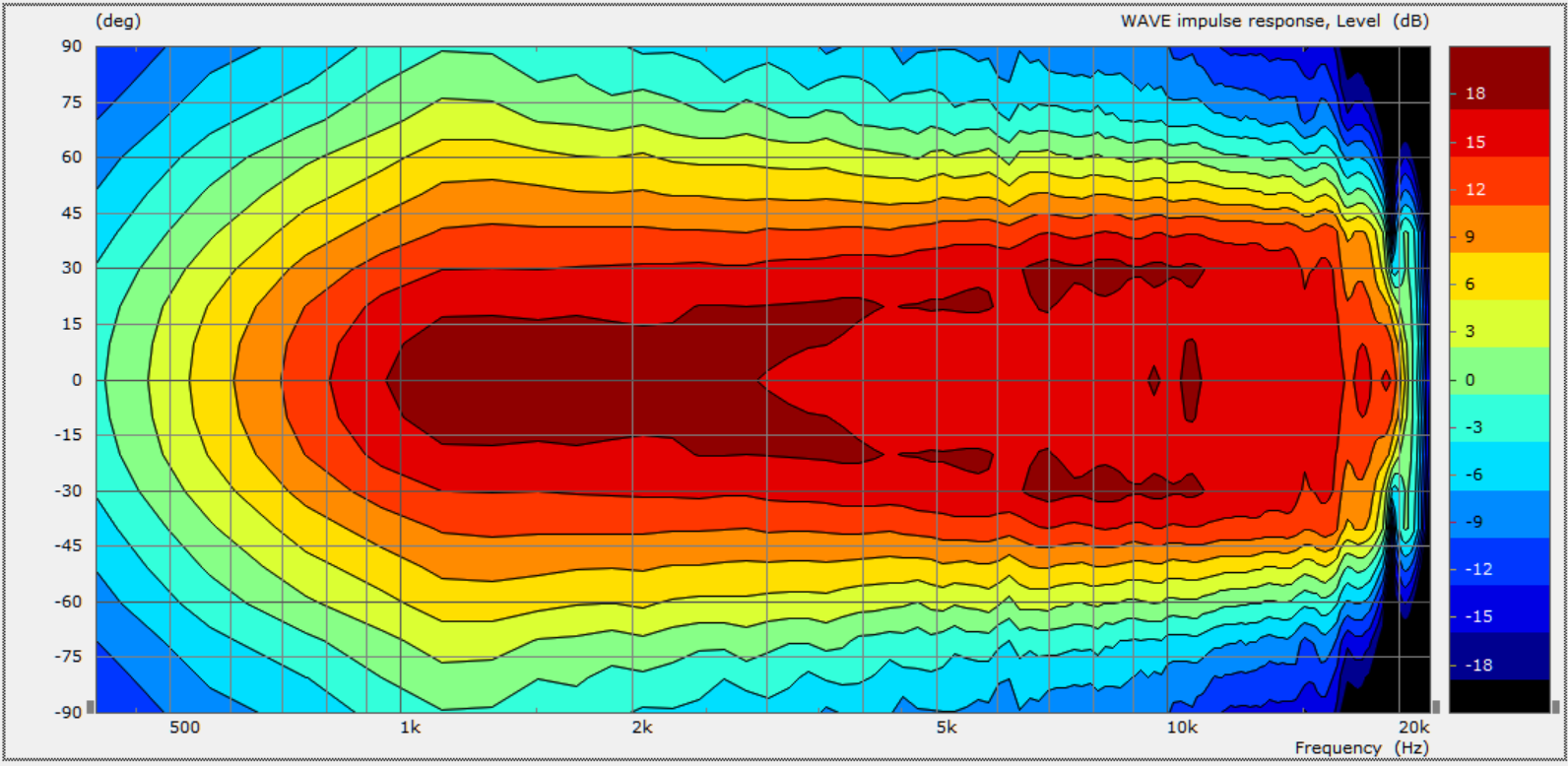

What I see people doing is very high resolution "traditional FR plots" and very low - smoothed - polar plots. Of course it is going to be hard to see in that case. But a high resolution polar plot is, to me, the ideal. It shows everything. Diffraction should show up in a hi-res polar map, or it isn't likely to be significant. Glass will not make a difference, it's just a pain to use (for me.)
Kindhornman - It seems to me that the inability of making something "perfect" is not a very good rational to ignore making it "optimum".

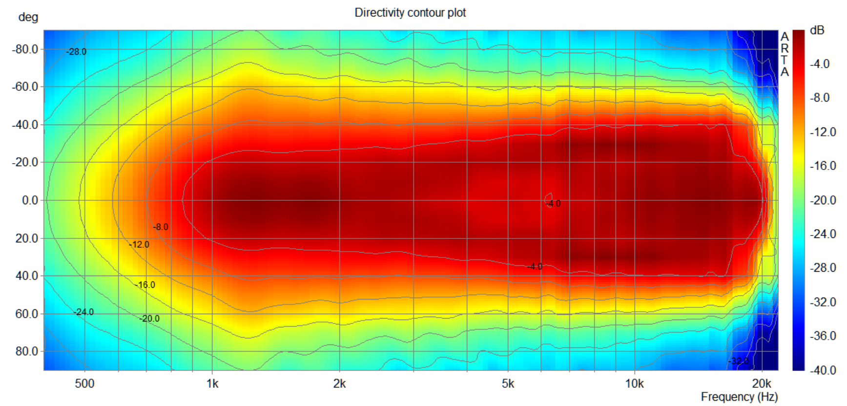

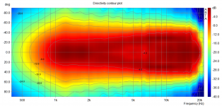

Ok, here's some data I got in-room a couple weeks ago. There's a 3.8ms gate and the contour plots were created from that data which is 1/24octave smoothed. Data was taken in 10° steps from 0-90. The wg is eq'd to 20° which is the listening axis. The device in question is a 90x60 EOSwg for a BMS 4552nd 1" exit cd. It's 18" wide where the mouth roundover would be tangent to a baffle, but the roundover continues to roll back to 180deg (no baffle). The roundover is too small (1.625" r) which explains the narrowing pattern from 1-2khz. I created the horiz and vertical OS profile in SolidWorks, set the cd entrance and the elliptical mouth shape, and let SW interpolate the rest.
First are the fr curves, second is an ARTA contour plot (note this is 1/12 smoothed), and third is a contour plot I created in VACS. I've never used VACS on my own data so I'm sure I can optimize the view more. I made the scales on the contour plots the same but ARTA doesn't allow near the kind of options VACS does so in the ARTA plot you see 4dB steps and I set VACS for 3dB. 4dB steps in VACS wipes out too much detail. The VACS data looks much more coarse to me but I can't figure out how to make it any better. At any rate, you can see that the off-axis response is higher in level than the axial from 6-10khz. This is something I've seen in many waveguides,but as Kindhornman says maybe this is "good enough" and not enough to worry about. As a perfectionist I do want to get it as good as I can though.
I could send you the data, Earl, but I didn't use your angle convention and there is no time lock. The data I've sent you in the past had the time lock goofed up but you were still able to create a plot from that. If this is ok with you I can import the data to Holm and create the file set you need.
