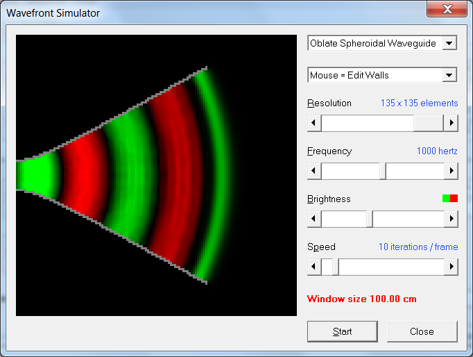

I have always considered that the actual wave-fronts would always be of a curved surface or more realistically a spherical wave shape that is simply distorted by the shape or containment of the waveguide until it exits the horn if larger than the mouth or forms earlier in the horn when the wavelength is smaller than the mouth diameter.
Of course it is not true and therein lies the fallacy of Webster's Equation.
The Webster plane wavefront model does however have its uses. For example, if you wish to model a bass horn, where the wavefront curvature is relatively minor and directivity is not an issue.

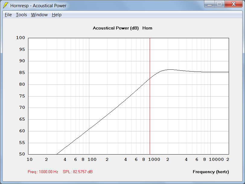

Less Quick Answer

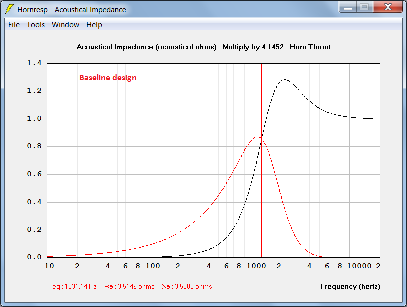

The acoustical power output is determined by the throat acoustical impedance of the infinite waveguide.
What sets the lower limit on an infinite waveguide with an ideal driver?

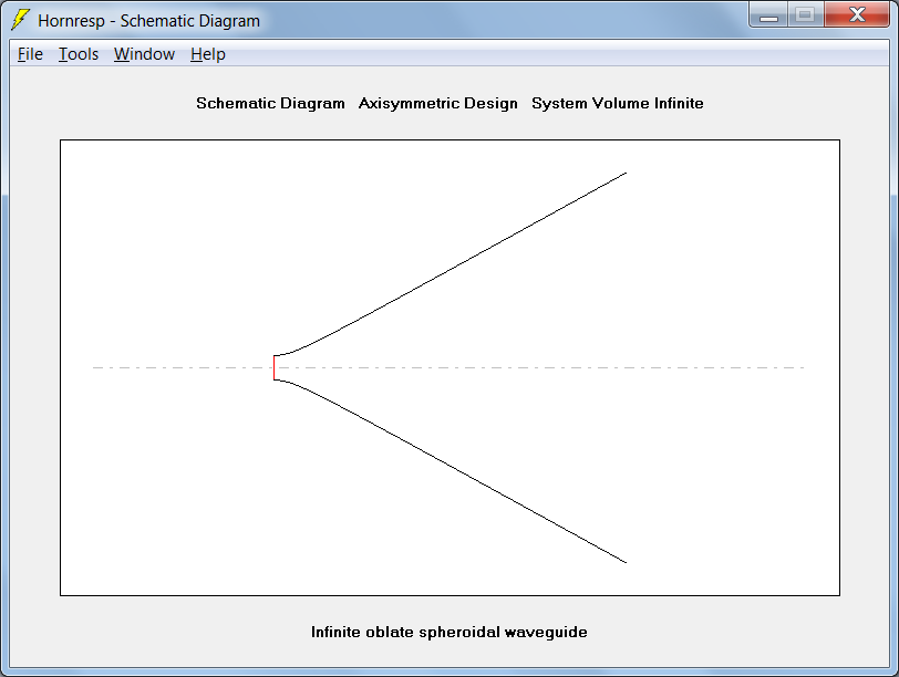

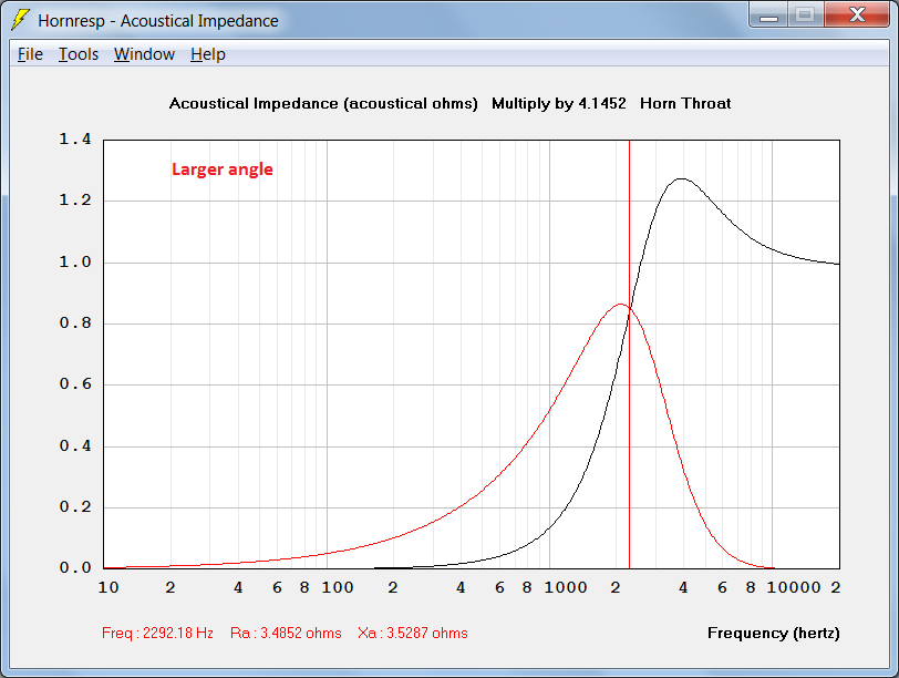

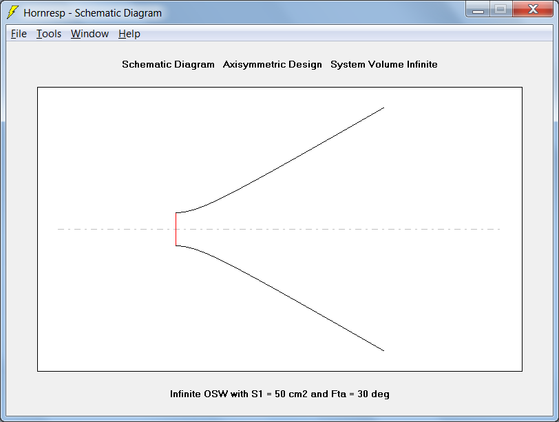

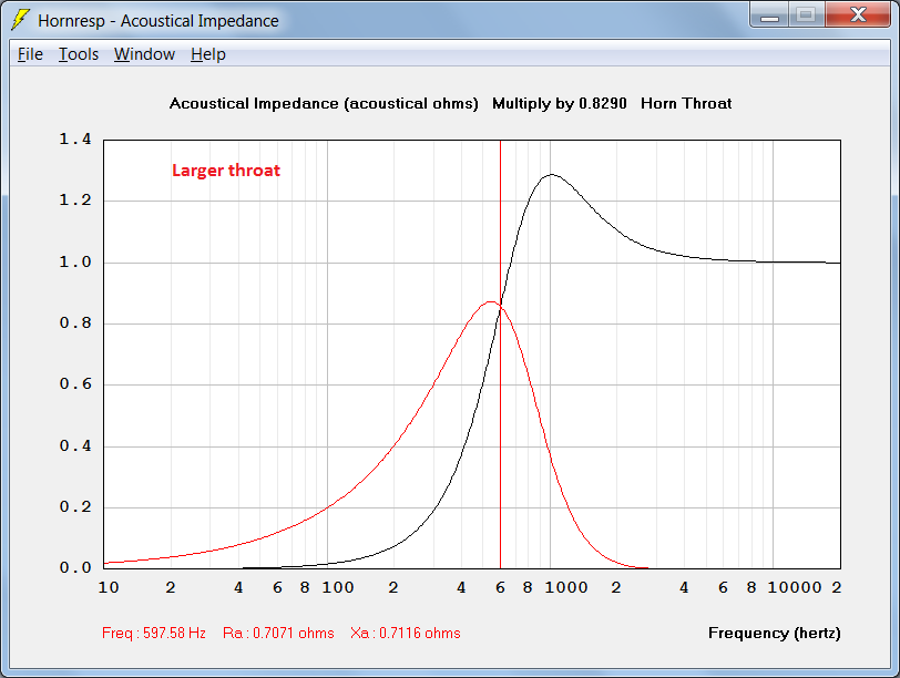

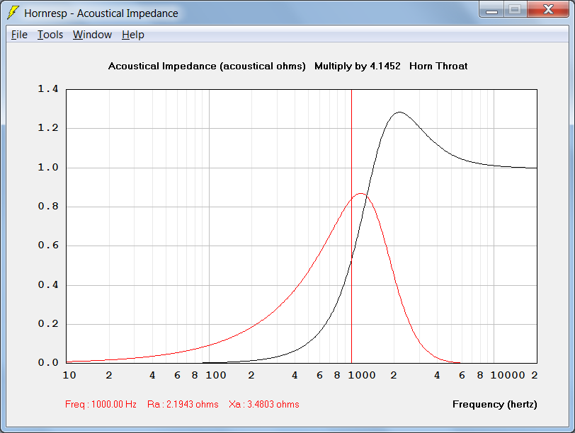

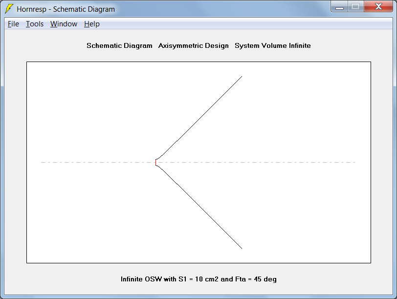

This limit is determined by the impedance, as stated, but the impedance is determined by the throat radius and the wall angles. As you can see it is basically a HP filter. A larger throat lowers the frequency and a larger angle increases it.
