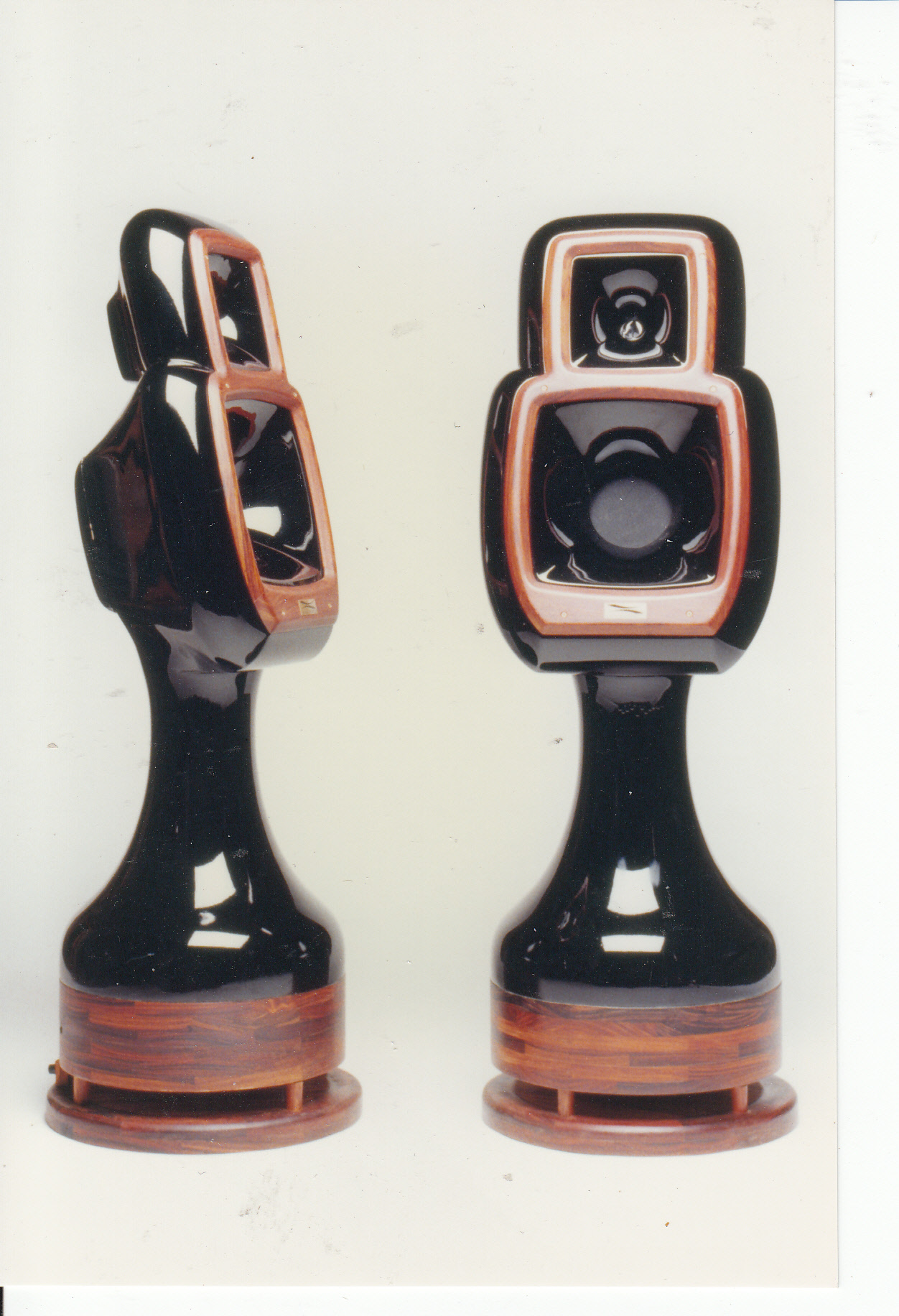

Have you ever considered an asymmetric exit mouth radius? No it wouldn't eliminate the standing way of a round symmetric horn but perhaps it could be handy in your desire for an asymmetric pattern for first wall reflections? Just thinking of the top here this morning. In the horns that I did for my strange looking speakers, my avatar, I used a four sided elliptical wall shape with the corners connected with a radius, nowhere are there parallel walls or sharp corner contours. I wonder if those would show the on axis hole you are speaking of, it has been twenty years since I last worked on those horn designs. These horns are symmetric about the axis, just not round and definitely not square. I seriously developed Hyperbolic Exponential Elliptical Radial horn designs many years ago but didn't produce them. I now wonder as I wasn't aware of the phenomena then of pattern flip if that would be and issue if the termination would include a large radius termination? I've seen some of your patented, now expired I think of so phase plug designs that were not symmetric about the axis, an idea that I also conceptualized but never pursued. I still wonder how well that could work with a matching waveguide as I just described above.

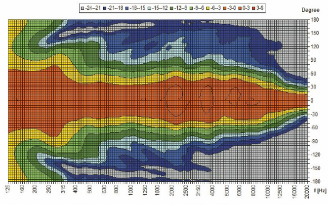

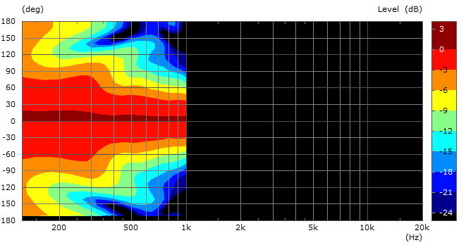

I think that ARTA can do polars like mine. There was a big discussion of this topic in another thread. But to be comparable with mine one must take ARTA data about every 5 degrees or its resolution will not be as good as mine at the upper frequencies. I use a ERB (Equivalent Rectangular Bandwidth) smoothing mechanism which ARTA cannot duplicate, but if ARTA is done at 1/24 th octave then it matches mine at the high end, but is sharper at the low end. This is probably OK, but the other way around isn't valid. ARTA does not calculate the DI or PWL for an arbitrary axis as mine does either. To me, these later two tell the most complete story.
The referenced plot is not an accurate display of reality 🙂
I n fact the measurement is very accurate as the comparison to a simple simulation shows. As I stated enclosure size is essential.
attachment.php
Simulation:
attachment.php
Measurement of M2:
attachment.php

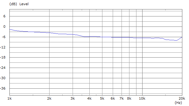

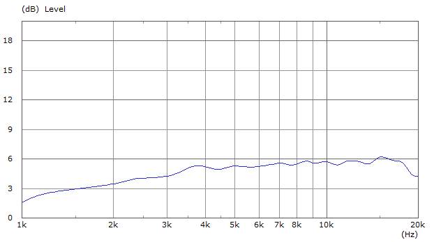

It seems rather simple math to convert these plots to a power response curve and show that. Can you pls do so as well?
Of course. 🙂
Average power response (equalized flat at 0°):
attachment.php
Directivity Index:
attachment.php
Please note that I use this horn from about 3-4 kHz upwards. It will be integrated in a 4-way design.

The NA-12 mouth is asymmetric and there is only a minimal hole. If I found this hole to be a major issue then I would have dealt with it a long time ago. If my speakers are setup as I recommend then one is virtually never on the axis with the hole. Competitors like to point to this hole as a "flaw" but they never acknowledge that my speakers are designed to work differently than the norm, so one cannot apply "normal" criteria to them. This hole would be a problem in a center channel, but in that case I do a different crossover that minimizes the hole with a slightly degraded polar response. In the NS-15 and NA-12 the hole is not an issue in either the side speakers or the center channel, although the center always benefits from a slightly different crossover.
