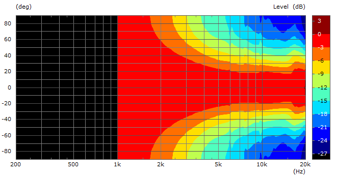

By your strict definition nothing that has been shown is "constant directivity". I am not arguing this issue with you anymore because we simply have different definitions.
This is your choice.
But your statement above "And btw. a hole at 0° means the same for directivity as a widening under higher angles. These artifacts are equivalent. In directivity and energy response you can't differentiate them."
This is entirely false simply because different angles represent different areas and as such different energies (since energy is a per unit area quantity. Thus a hole on axis, has a very small if not negligible effect on the power response, while a peak off axis has a huge effect.
I think we have different assumptions on how a speaker should be heard. Maybe there is a misunderstanding.
I always listen under 0° and I always equalize 0° to a flat frequency response, because I want correct direct sound. This is a basic setup for every "usual" loudspeaker and it this assumption is wide spread in the industry. When you equalize a hole on 0° you raise the power of higher angles, too. So it is indeed equivalent to a widening.
So you are correct in a non-equalized setup. And I'm correct in a equalized setup. But regarding directvity only (which equals to an equalized setup), you are wrong.

FredrikC - I don't think many people understand this issue - that the power of an axial point is way below that of an off axis point. It goes as sin( theta). Consider an extremely small wide hole of some -12 dB depth. One could not even detect this hole in the power response, but on a normalized plot this hole would become immense, way out of proportion to its importance.
Then there is the choice of axis. Why would I ever publish data that is normalized to an axis that I do not optimize for? If one want to see "flat and well controlled directivity then look at an S-15 at 20 degrees off axis - the intended listening axis. It is exemplary at this angle, but people keep looking only at the erroneous axial response.
No waveguide is perfectly "constant directivity", not mine not anyone's. What should be rated is the smoothness of the DI (Directivity Index) along the listening axis and over what bandwidth is it nearly flat, and how high is it over this bandwidth. That is what is perceptually correct. The rest is just arguments over unimportant aspects.
FolGoTT - you continue to ignore my point that the axial response is not the direct response when my speakers are properly setup (design intent.) This is not some arbitrary thing - it is a precisely defined and a logically derived approach to maximizing the sweat spot in a listening position, as well as minimizing the very early reflections found in a small room. both highly important aspects of loudspeaker design. If you refuse to accept my recommended setup then we really do not have anything to talk about because we are not using the same premise.
Loudspeaker should not have horizontal symmetric responses. The easiest way to achieve this is simply by pointing them inward, (outward works too, but with other ensuing problems like increased very early reflections.) One could make a system that "looked like" it was pointed straight ahead, but in fact had a non-symmetric polar response. That's just a lot more difficult and expensive and ends up just doing the same thing as turning the speakers.
It simply makes no sense to arbitrarily choose the "normal" vector of a loudspeaker as the reference.
The direct response needs to be near-flat and smooth, but the power response and hence the room response needs that as well. On needs to find that axis along which these two requirements are best achieved. It will seldom be the normal. Designing specifically for a non-normal axis is, I agree, a radical departure from the "norm" (pun intended) and it requires a rethinking of many of the "normal" way things are measured and displayed, but I'm perfectly OK with that. You aren't. I am not going back to the "old" ways, maybe you should look at the newer ideas and adjust your position accordingly.

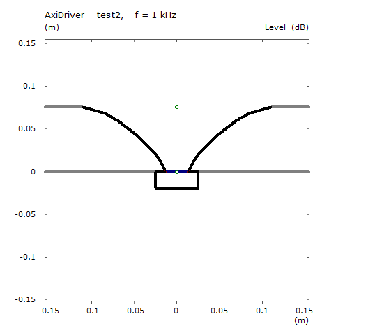

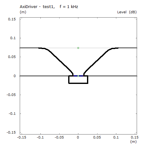

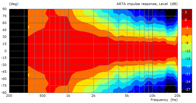

I'd be interested in knowing how the SEOS waveguides achieve such nice polars in the horizontal. The vertical isn't that great imo. One thing I've noticed in Earl's larger waveguides, the waveguides I've built, and other commercial offerings is a bit of excess off-axis energy in the roughly 6k-8khz region. Particularly around 30deg off axis. What I've noticed is that the level at this angle seems to rise and meet the level at 0deg. In my waveguides the 30deg measurement actually exceeds the 0deg in level by about 1dB at 7khz. As was said earlier if you look closely at some SEOS15 measurements the curves from 0-20deg also tend to get "mixed up" above 5khz. What causes this, and is it the fact that the SEOS and similar waveguides have such a high aspect ratio that the effect isn't as dramatic?
FoLLgoTT - considering Earl has a pretty flat response on his design axis (ok not ruler flat) isn't that fairly close to normalizing to the design axis? The contour plots you posted look to me like they are more "trad" horn designs which in my experience seem to be more consistent off axis....they just progressively narrow the pattern.
Yes, you are right. I missed that fact. 🙂

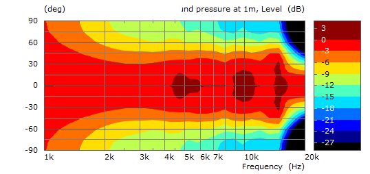

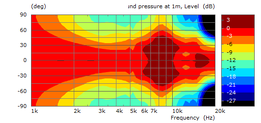

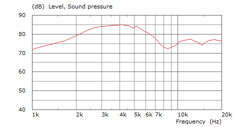

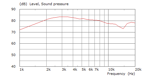

This is pretty easy. You have to optimize it by hand until directivity looks good enough. For simple designs I use AxiDriver which supports only circular waveguides/horns. For more complex designs 3D CAD and another BEM simulator is necessary.
Here are two examples. One is pretty conical with rounded edges and one is optimized in a half hour. Of course with more time the contour will get even better, but it shall show how much influence the contour has on directvitiy.
Conical:
attachment.php
attachment.php
attachment.php
Roughly optimized by hand:
attachment.php
attachment.php
attachment.php

Nils,
Do you know exactly what causes the dip around 14k in both profiles? I've seen the same thing in my sims...seems to be something going on across the throat, but I'm not sure what it is.
I don't know exactly. But the model is not exact in this frequency range. AxiDriver simulates a ideal piston driver. The reality is different. So I wouldn't optimize too much above 10 kHz. With a real driver it can behave differently.

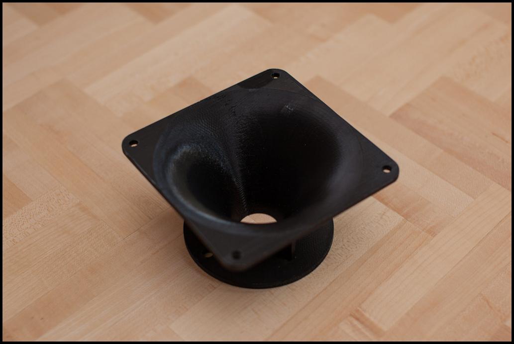

I 3D-printed a prototype horn a few months ago and the simulationw as very acourate. But it also differed in the highest highs.

I'm tired in posting pictures and proofs and from you comes nothing. Here is the last one.
3D printed device:
attachment.php
Simulation:
attachment.php
Measurement:
attachment.php
Note: the simulation is on an infinite baffle. The measurement was taken without a baffle.
