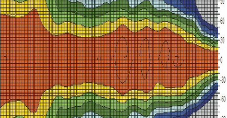

Directivity measurements of the JBL M2 can be found here. When scaled to +/-90° it looks like this:
This doesn't look that good. The directivity between woofer and tweeter is not well fit and beyond 10 kHz there is strong beaming. Neumann and Genelec does it better.
On the other side maximum SPL is very high below 1 kHz.

Your linked image fails to show the frequency scale......where they measured relatively even directivity all the way down to below 400hz which is quite an accomplishment of these measurements are accurate.
..........but more important seems to be the critical assumptions as to what makes a speaker sound good or bad based solely on objective data. We all know the room plays a critical roll in the overall performance and in the case of directivity in relation to the reverberant field, listening position and placement all bets are off if there's no consistency. I used the term ' relatively' to describe the M2's directivity measurements for just that reason........with all things being equal......which they NEVER are, this is pretty solid performance. Besides this, all the objective data and measurements in the world of the M2 can't convince me that what I heard was anything less than spectacular so at some point, we have to let our ears play their subjective role in the design and evaluation phase. A chef tastes his creations before serving and rightfully so if his palate is trained.

How was the plot captured? Has it been DSP'd to flat on-axis and then normalized to the on-axis response? If so, that is terrible performance. Nothing a SEOS can't do better.
