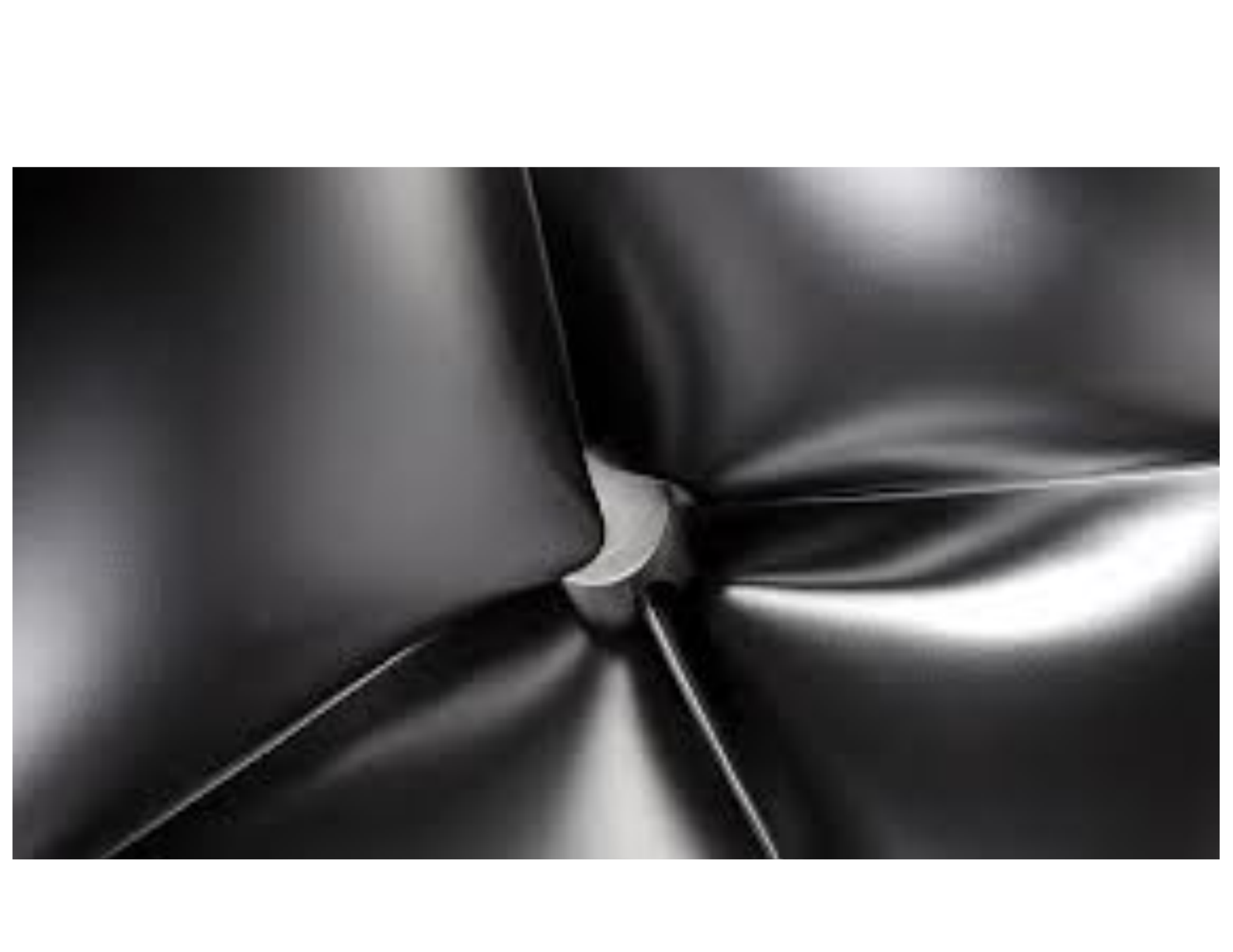

just run a search like this in google:
site:diyaudio jbl m2
There's tons of discussions of it here. There's a pic on the previous page. As far as I can tell, the M2 is basically an evolution of the biradial constant directivity horns from forty years ago, but with the addition of a rather clever diffraction slot. But it's still a diffraction slot.

ICW Design Issues
View the throat of an ICW as a short cylindrical segment deeply castellated by quadratic slots that lead abruptly to the four corner trenches in the horn face. (There could be more radially disbursed I suspect.) Then imagine how a acoustic wave might behave to those boundary conditions while diffracting around them and eventually radiating away from the horn face. In my estimation, the resulting process is sufficiently chaotic that there are no prominent HOM's formed to be heard; but somehow, in the far field, a broad wave front of uniform pressure emerges. The patent that covers this design, does not reveal details of the transformation process that is taking place, nor does it disclose why the wave spread is not bandwidth limited even when signal wavelength becomes comparable to and much smaller than, horn throat dimensions. I think for good reasons this information was withheld. Until process details become evident, successful design variants of this horn will remain in the realm of serendipity and trade secrets. WHG

Hi Patrick,
Yes, I have seen a lot of discussion about JBL M2 horn, but I have understood that You have made a horn like M2 but with different size or shape, so if it is the case, please show us some pictures. As I have understood in M2 design, it seems that exponential surface law flare is maintained applying diagonal "Karlson Koppler" V-shape surface expansion.
There are not so many real technical info about M2, so if You have something please 'distribute' to us.
