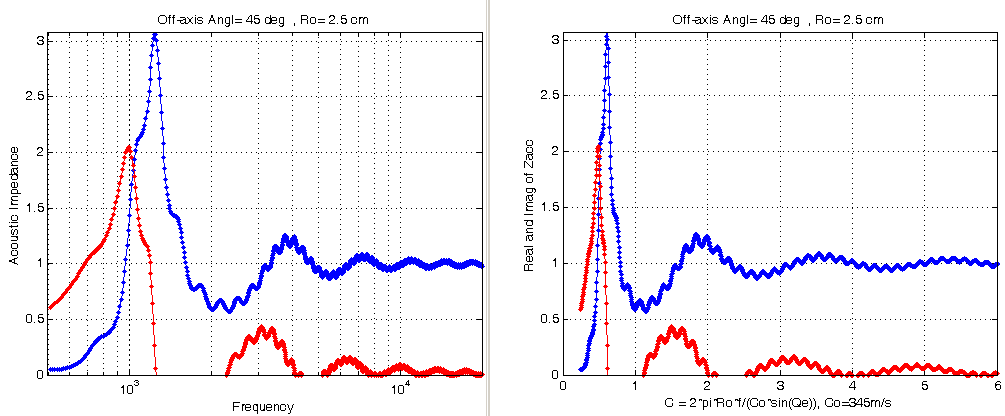

Hi Gedlee,
I have tried to do some calculations, and on the attached figure is the result,
but can You confirm.
Only what I have find is the presentation for 1-inch throat and 30 deg off-axis wall.
As shown in the post:
http://www.diyaudio.com/forums/multi-way/103872-geddes-waveguides-704.html#post4038689
Seems to me very comparable with my "work".
Bouncing on the curves is due to limited horn length, and mouth without proper "termination".
Regards
Ivica

Those certainly seem reasonable and if one of them matches my exact calculations then I would think that you are "good to go".
I have never given the impedance much interest. It was always the directivity that I was interested in. The device just gets EQ'd in the end so the impedance is just a secondary thing.

The thing is that for home use this is usually not an issue. The one thing that I would check is that your curves seem to be pretty high in frequency. The 1" 45 degree, which is what I always use, is shown to have its peak at about 3 kHz. This seems high as I recall, but could be possible. I always have a cut of about 6-8 dB at 2500 Hz - over the natural HP cut at these lower frequencies. I can usually get down to 700-800 Hz in the larger waveguides with a 1" driver. I have never had a LF issue, but in pro applications I have seen some drivers burned out from HFs. Usually when the amps were clipping heavily. Nothing is there to protect from this HF noise that just heats up the coil.

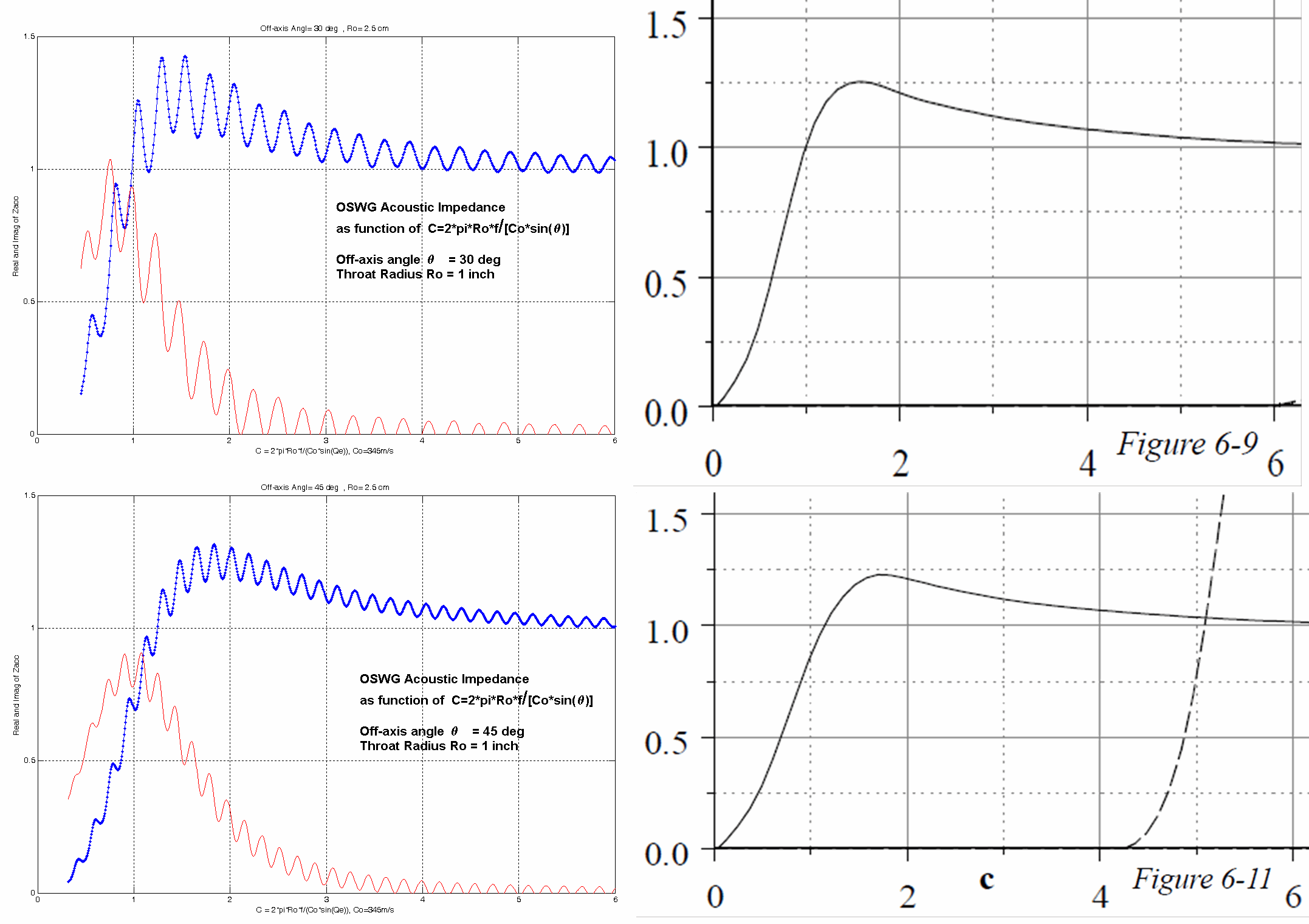

My book GedLee LLC Shows the 30° and 45° impedances for the first three modes plotted versus C = 2 Pi f a / c / sin(theta) - figures 6-9 and 6-11. With these two plots you can get all the curves you are looking for. I can't make it any easier than that. It does appear from this data that your curves are way too high.

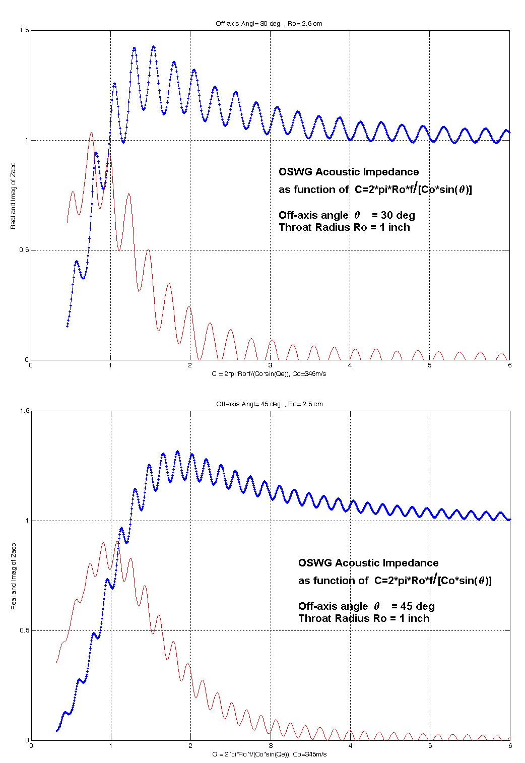

Hi Gedlee,
I have done rescaling my calculation concerning the define variable "C" = 2*Pi*f*Ro / (Co*sin(theta)), where Ro= throat RADIUS, Co, speed of sound in the air, f- is frequency.
I have attached the redraw figures for 2-inch driver ( Ro=1inch) with 30deg, and 45 deg off-axis angle. Looking at the mentioned figures 6-9 and 6-11 in Your book (Chapter-6.) it seems to me that my calculations are OK, but my previous attached figures are more practical for the DIY members as the acoustic impedance are shown as a function of the frequency.
I believe that on both figures You have mentioned (6-9, 6-11) from your book, are calculated for the 2-inch throat radius OSWG horn.
Regards
Ivica

Since the figures in my book are functions of c which contains the throat radius, they are valid for any throat radius. But if you look at the calculations in the book - from c to f - you will see that the peak in the 45 degree 1" curve occurs between 1 and 2 kHz. Half power is about 500 Hz. That is much lower than your previous curves showed.
Since the figures in my book are functions of c which contains the throat radius, they are valid for any throat radius. But if you look at the calculations in the book - from c to f - you will see that the peak in the 45 degree 1" curve occurs between 1 and 2 kHz. That is much lower than your previous curves showed.
Hi Gedlee,
Yes, You are right, I have done the rest of the calculations ( for 1-nch driver) and after 'rescaling' the graph the results are the same, so I believe that we can use acoustic impedance graphs vs frequency as correct presentations of Your work on OSWG horns.

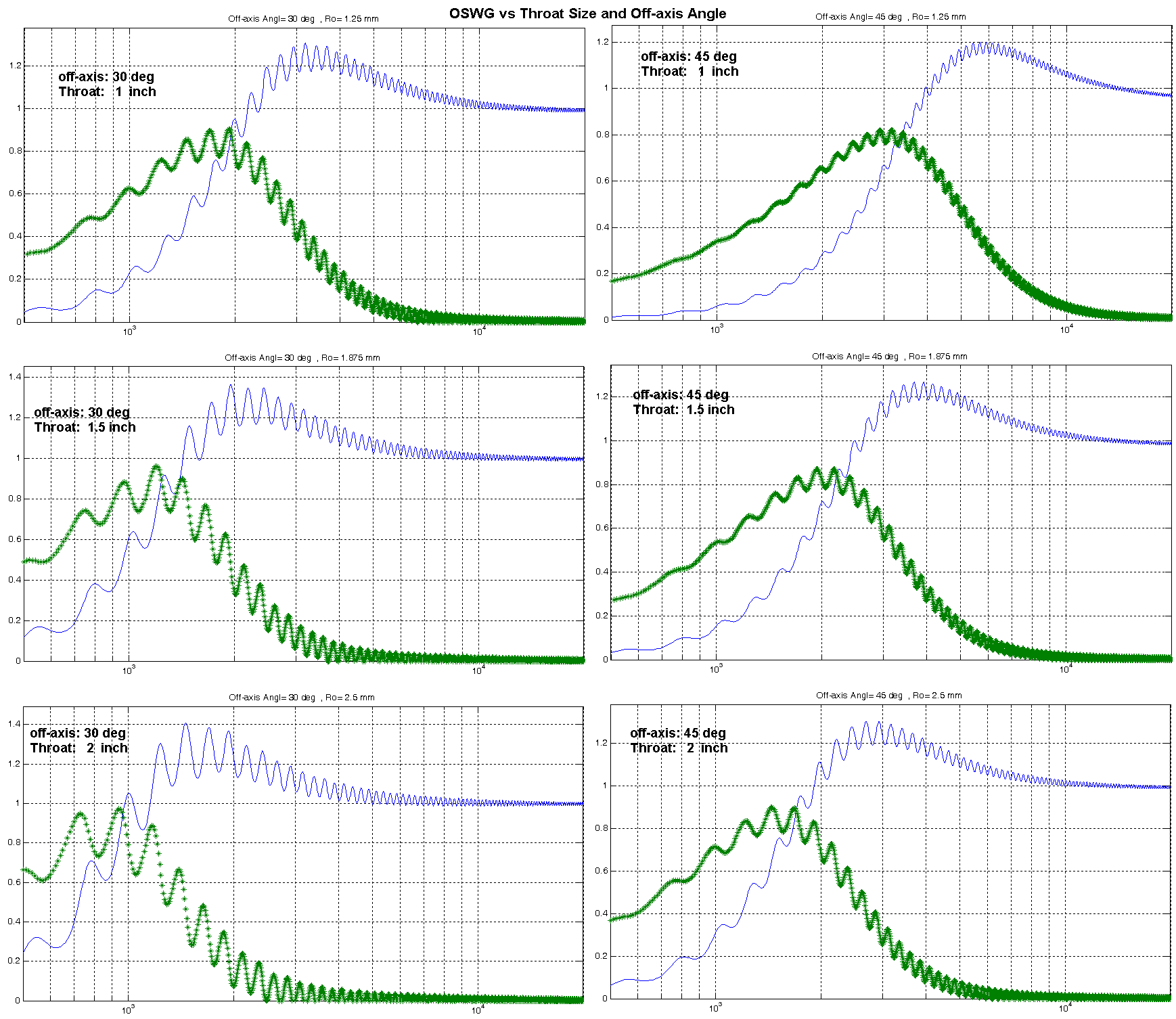

Hi Gedlee,
Yes, You are right (as usually), that in the books there have to be put more general solutions, but from time to time it would be useful (for the reader) to emphasize some practical suggestions, or conclusions. Such would make reading theoretical explanation to become more realistic. In mentioned Chapter.6, of the book, You are talking about HOMs, but as acoustic impedance here as derivative, is interesting thing to be noted, I think. So a kind of comparison can be made to the other known results.
So here forum member can use your results from the book, and in order to get real usual presentation impedance as a function of the frequency they have to recalculate all the data, or can use mine graphs presented in the:
http://www.diyaudio.com/forums/atta...waveguides-horn-impedance-vs-angle-throat.gif
for some most usual horn throat size and directivity angles.

Hi Gedlee,
Fortunately (or not) using the drivers with internal short horn, as JBL 2440, 2441, 2445, 2446, 2450, 2420/21/25/26 (and equivalent from the other producers) this short horn would improve LF loading. For example JBL 2446 with 46mm internal short horn (that would couple 1.5inch output from the phase plug to the driver 2-inch mouth)
