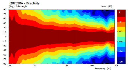

Sica Q07030A (80°):

Both radiate with even less than 90°. They don't show an on-axis hole (above 10 kHz the driver doesn't fit good enough on the Limmer). The contour is just different.

This is nonsense. You just have to optimize the contour manually and don't apply a simple mathematical model.

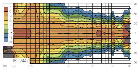

Dr.Keele about CD horn midband beaminig

It seems to me that mid-range beaming is something that can be expected, on almost conical horn, as Dr. Keele has shown years before, and has suggested to enhance horn wall flare in the last 1/3 section of the horn towards horn mouth.
"Keele_(1975-05_AES_Preprint)_-_Whats_So_Sacred_Exp_Horns.pdf"

Hi ivica - it is simply misunderstood that this "beaming" is a result of the treatment of the mouth more than anything to do with the contour. Small and Fincham also found this at KEF when they put a tweeter at the apex of the woofer. There was an axial hole, which initially they did not understand. I explained it to them because I had seen this before in simulations and in real devices. It is not evident in anything but a perfectly round device. Its location and depth depend on the wall angles and the mouth radius. The hole tends downward in frequency and lower in magnitude with wider mouths and wider angles. So worst case is narrow angle with a small mouth - i.e. a Nathan.
